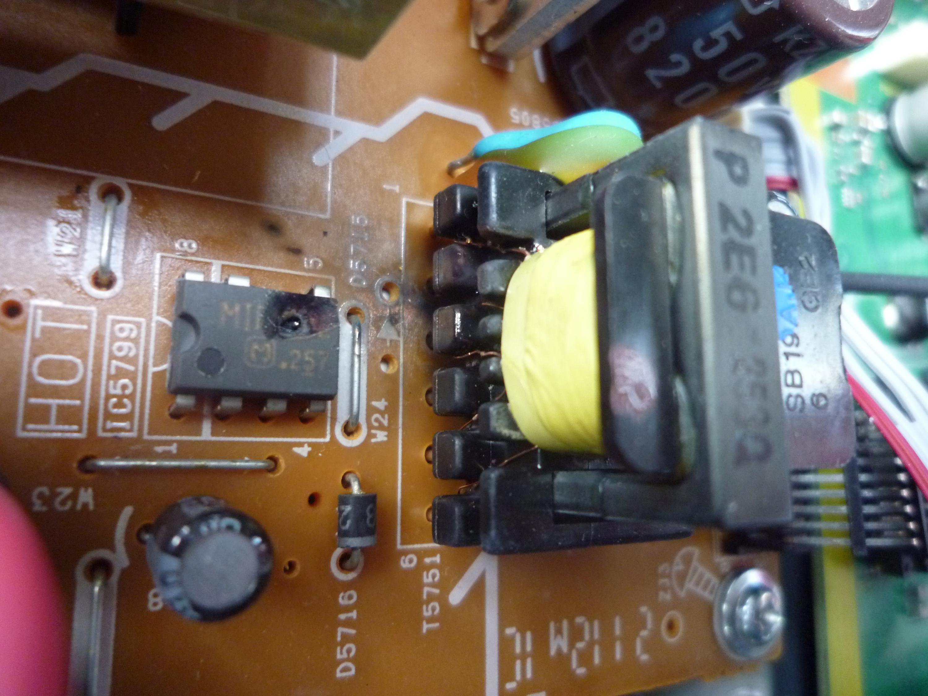

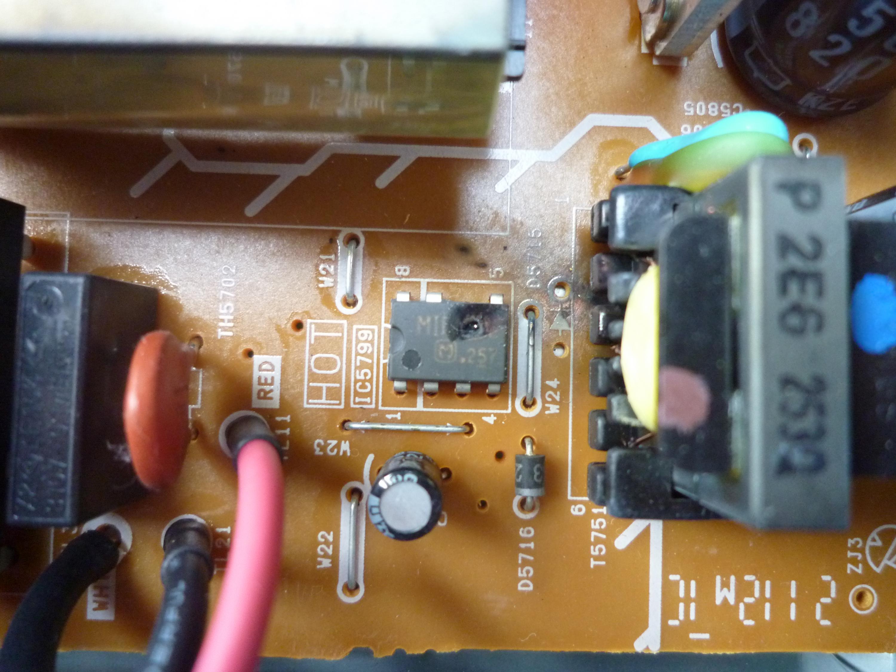

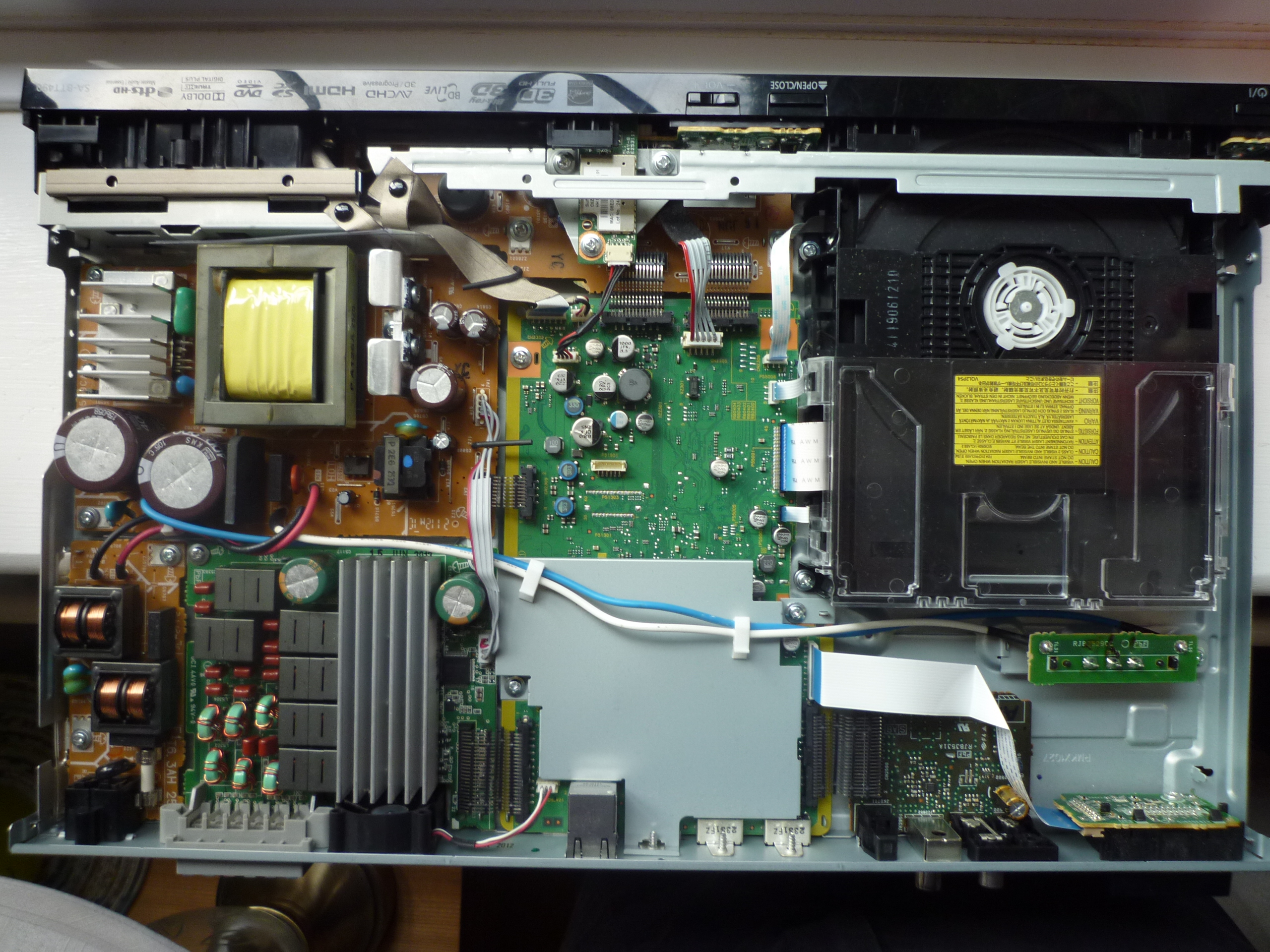

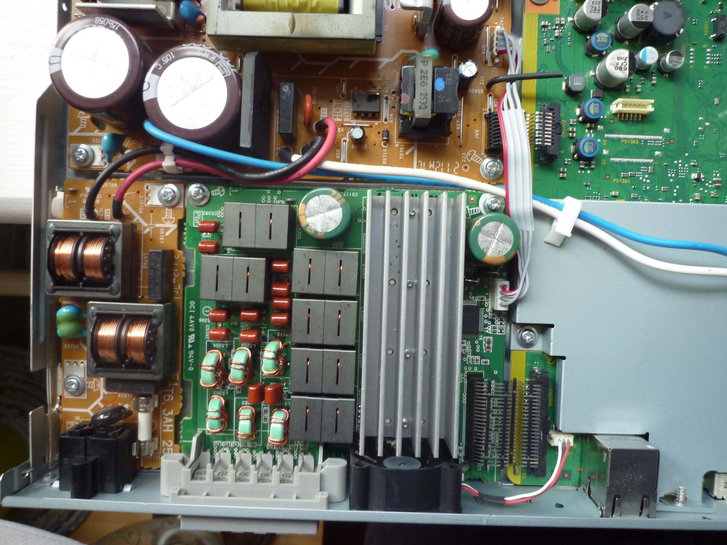

    Hi, have this Blu-ray disc player that is completely dead due to being powered by 220-240V while the duel voltage switch was set for 110-127V.
    The internal 250V 3AH fuse did not blow and the IC5799 has been destroyed.
    When the player is connected to 220-240V, I have 110V across the mentioned fuse.
    Having not repaired any disk players (only tvs) I'm stuck on what to check next?
    Thanks.
    • 31015
    Re: Panasonic Blu-ray Disc Player -SA-BTT490 - Dead
    that piece of shit looks familiar - alot like the SA-PT860
    the chip is probably:MIP4110MSSCF
    check any diodes near it, and dont forget to check for surface-mount parts on the underside.

            ic5799=mip2f2
