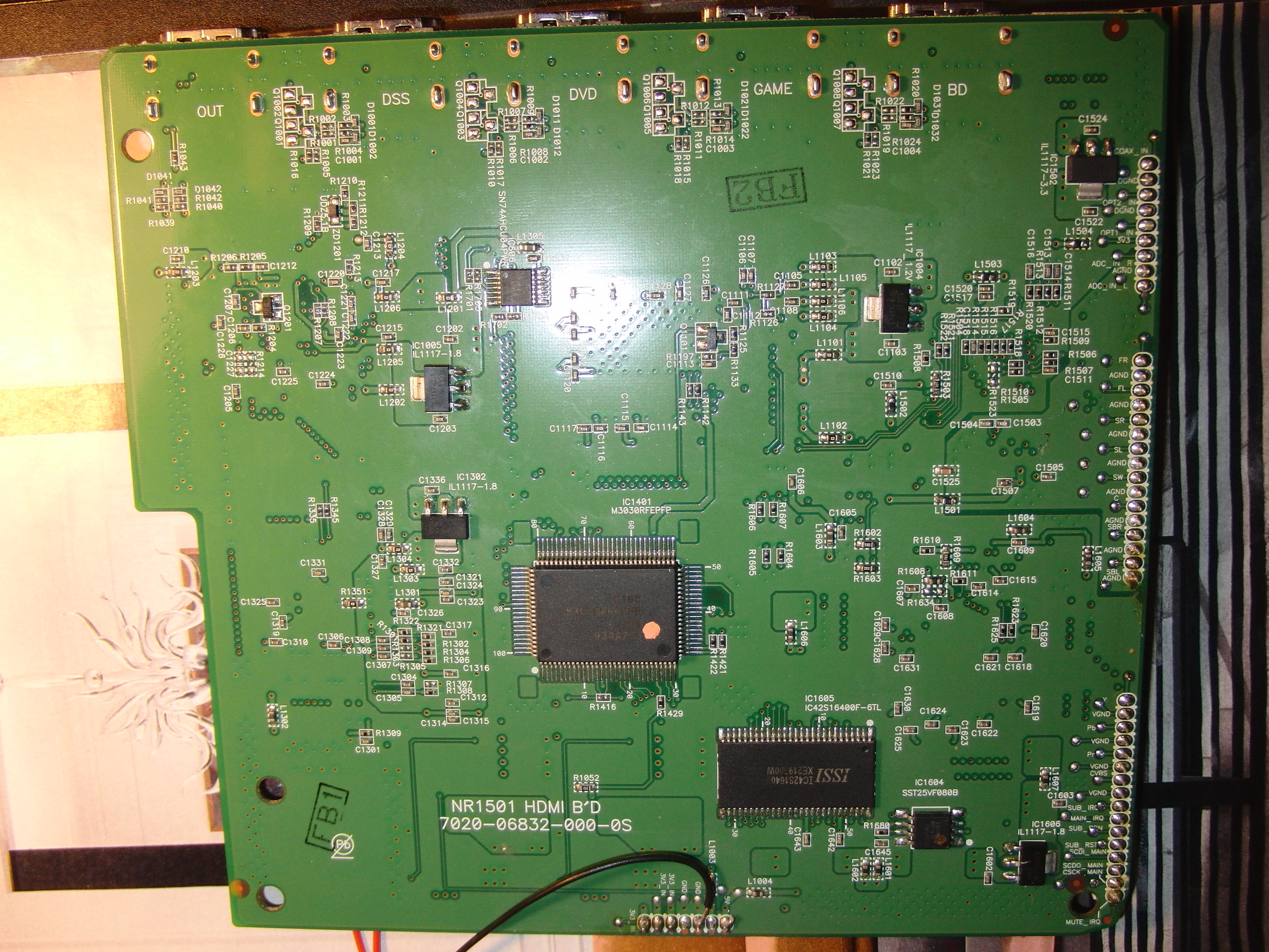

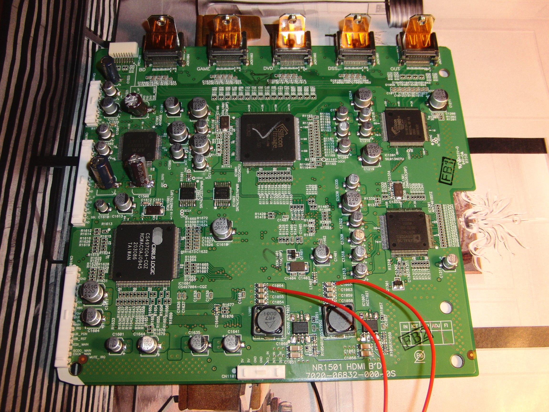

    Dear all,
    i need help with a Marantz NR1501 Audio Receiver. The displayed error message was CHK CPU. The analog Audio Part is working, the digital audio part not. The Service Manual says that some voltages on the HDMI Board are not correct. I checked the voltages on the CN1101 connector:
    5V to GND -> 4,95V
    3V3 to GND -> 12,7V
    My question is why do i have 12,7V on the 3V3 Pins? Maybe a shorted Q215 on the Mainboard? What is the function of the Q215 transistor on the Mainboard?
    The reading of the output from the both Buck Regulators AOZ1021AI:
    IC1007 to GND -> 4,05V
    IC1006 to GND -> 0,66V
    I am really frustrated. Many thanks for your support. I extracted some pages from the Service Manual. Please let me know if this is not correct then i will delete it.

      I powered up the HDMI Board with 5V from my lab power supply limited to 500mA. Then i recognized a warm/hot AK4588 IC1501 CHIP. I ordered a new one from china and changed the AK4588 but i still have the same error. The new chip will also heat up and the voltage will drop. I desoldered the chip and connected 3,3V and GND directly to the IC. But still the same. The chip heat up and get hot in a few seconds.
      The question is: Do we have a defective IC AK4588 or is it related to another part?

                OK now im sure it's not the AK4588. The problem was the missing ground at AVSS PIN 56. If i connect this PIN to GND the power consumption is about 100mA and i think this is OK. But i still get the Error CHK CPU. I tested all the caps near the regulator IC's but they are OK. I also checked the DATA and CLOCK Lines between the Main and Sub CPU. How can i test I2C communication? Does it work with an Arduino? I can not find the Datasheet of this IC1401 (M3030RFEPFP). I think i will resolder the CPU and SUB_CPU. The problem is i can not find the firmware for this device.
                For CHK CPU the service manual says:
                Indication of communication error between main CPU
                (MAIN PWB/IC102) and sub CPU (HDMI PWB/IC1401)
                ● Points to be checked
                1) Voltage of main CPU (MAIN PWB/IC102) and sub
                CPU (HDMI PWB/IC1401) is supplied properly.
                - 3.3V SUPPLY : IC102 (MAIN PWB), IC1401
                (HDMI PWB)
                2) Oscillation of two CPU is normal.
                - IC102 (MAIN PWB) : 16MHz
                - IC1401 (HDMI PWB) : 16MHz
                The 3.3V power supply is working and it's connected with the two CPU's. The main CPU will get the power from StandBy Board. The Sub CPU from IC1007.
                @Khron666 The Caps are all from SamWha. I replaced some of them with high ESR. I have a scope at my work. Should i test the output of the voltage regulators for ripple current?
                Thanks in advance - Foppel

                    That 12v seems to be normal, since it's the INPUT to the two (switching) 3.3v regulators on the HDMI board. It comes from a winding on the transformer through a plain ol' bridge rectifier.
                    Can you measure the supply voltages for / around the cpu's that the service manual indicates? I'm quite sure the pinout is on the schematics, or at least you can find the (ceramic) capacitors that are filtering those supply rails. Ripple might be worth checking - if those electrolytics are unsuitable (or dead/dying), they may well be the ones screwing things up.

                      Hmm i checked all the caps and resistors near the CPU's but they are all correct. But at the IC1401 the 10nF Caps are a bit low. I get the following results:
                      C1405 8,5 nF
                      C1406 8,7 nF
                      C1407 8,7 nF
                      At the IC102 i get the following:
                      C261 10 nF
                      C262 11nF
                      C263 11nF
                      Will it help to change the caps at IC1401? I think i will give up soon. The last thing i try is to power up the 3,3V from my lab power supply and check all the VCC Points near the CPU with an old Tektronix scope

                                      I've been working on two NR1501's for a few days now, with different defects.
                                      One had similar problems with digital signals. Analog signals only worked with Source Direct enabled.
                                      I discovered that when heating up the HDMI board with a hair dryer digital HDMI and analog normal signals are working again. Cooling one part of the HDMI PCB, the HDMI audio stopped and eventually all HDMI signal went dead.
                                      On both receivers I've discovered pretty strange behavior with a 1.8v regulator on the HDMI board. Its IC1606 (in the corner, near the connectors on the right)
                                      This regulator was oscillating and gave me an approximately 1.5v DC with AC on top of it.
                                      According to the datasheet of this IL1117-1.8v regulator an output capacitor with a ESR of not more than 0.5 Ohms is recommended.
                                      I looked up the capacitor on the diagram, its C1604 on the component side of the board.
                                      This capacitor had on both HDMI boards an ESR way above 0.5 Ohms. One had 12 Ohms, the other was 15 Ohms.
                                      So I replaced the capacitor on one HDMI board with a normal radial electrolytic capacitor of 100uF/16v.
                                      Now the unit is playing perfectly all analog and digital signals.
                                      Hope this helps you or any other that is trying to fix a NR1501.
