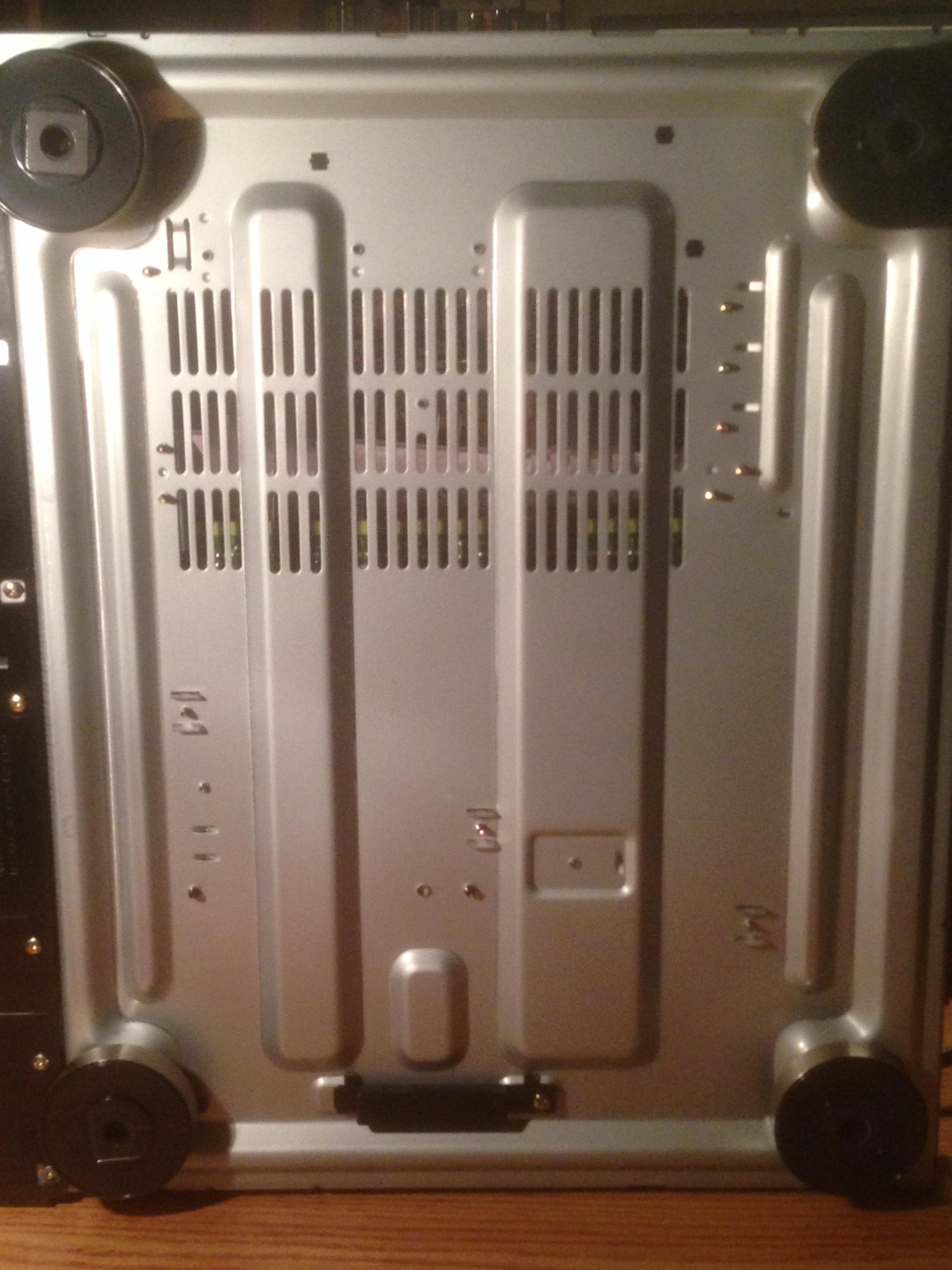

    Hey all,
    I just replaced a couple of caps on a Pioneer VSX-41 that I picked up for free. Now it sounds great, but the cooling fan is not running. Does anyone know if it is supposed to run full-time, or is there a heat threshold that needs to be reached before it is activated?
    Thanks in advance!

          The fan is electronicaly controled So it looks like it only comes on when needed.

              Can I see the bottom of the unit? Some of these Pioneer have perforate bottom cover that you need to nip off the fingers to remove the bottom cover, it was made like that for servicing.

                  This one doesn't seem to be designed that way. The perforations are under the fan and heat sink, not the board.
                    Re: Pioneer VSX-41
                    Nope, not made for easy repair.
