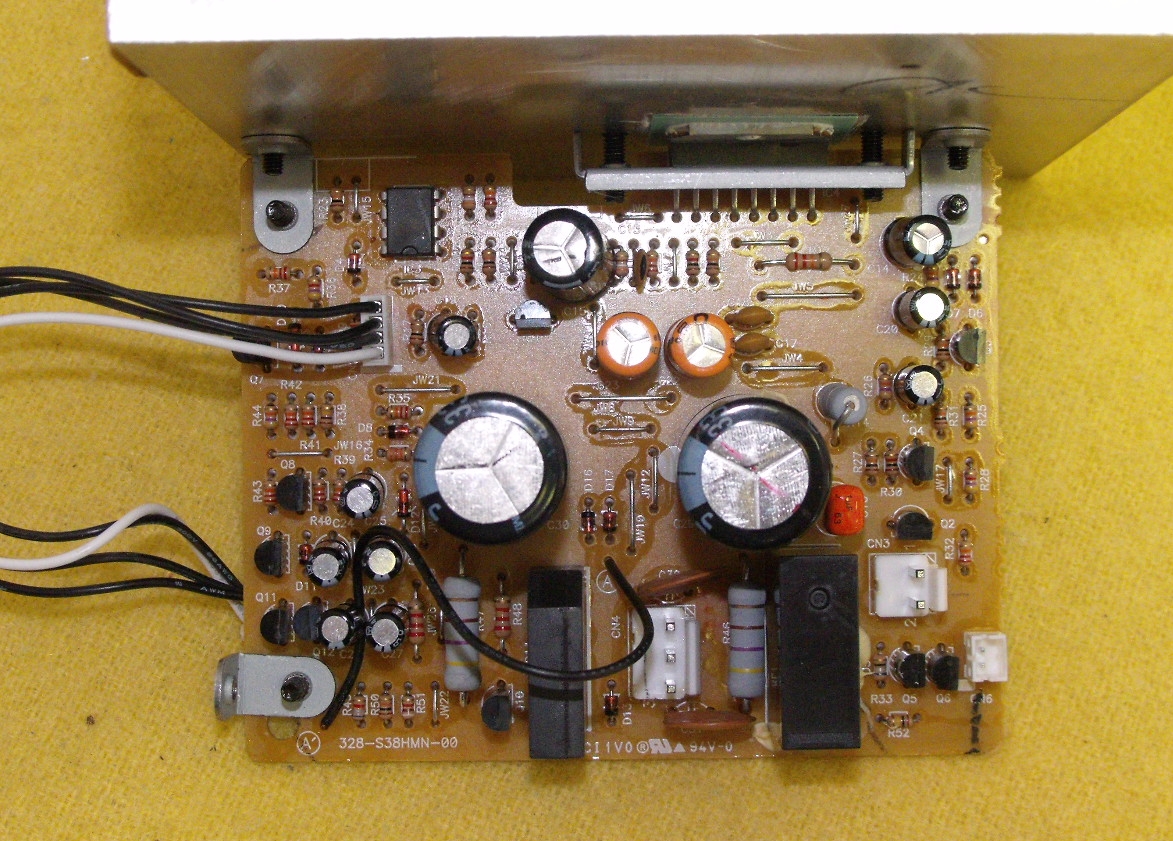

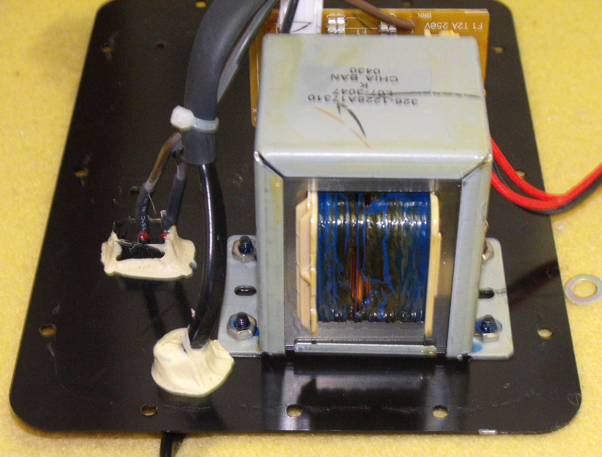

    I have a Kenwood SW-38HT subwoffer from a surround sound system that's not working. The person I got it from said they mistakenly left it on for 2 days. So they pulled it apart and seen the fuse was blown so replaced it with of course the wrong size (larger) and turned it on then said there was smoke and pulled the plug right away so that's when I got it. You can see in the picture some of the covering from the transformer is melted. I put a new fuse in but had the wires disconnected that went to the other boards from the transformer board and the fuse stayed good so I'm hoping it was unplugged in time. Anyway I am new to working on audio equipment and what I have checked so far is that all the caps "look" ok and I do not see anything burnt or any bad solder joints so I'm at a loss what to check next?
    Re: Kenwood SW-38HT
    Can you post the pictures of the whole chassis so I can see how all the boards are connected together?
    The thermal fuse inside the transformer may have blown open.
    Service manual:
    Download and post it on this thread.

        I think maybe it might be the transformer I plugged it back in and tested for voltage on all three wires that come from it to go to the other board and got nothing.

          No continuity through the primary winding...?...is the usual test.

              You should be able to check the the primary DCR of the transformer on pin 5 and pin 1 as shown in the service manual, may be the thermal fuse inside the transformer is blown.
