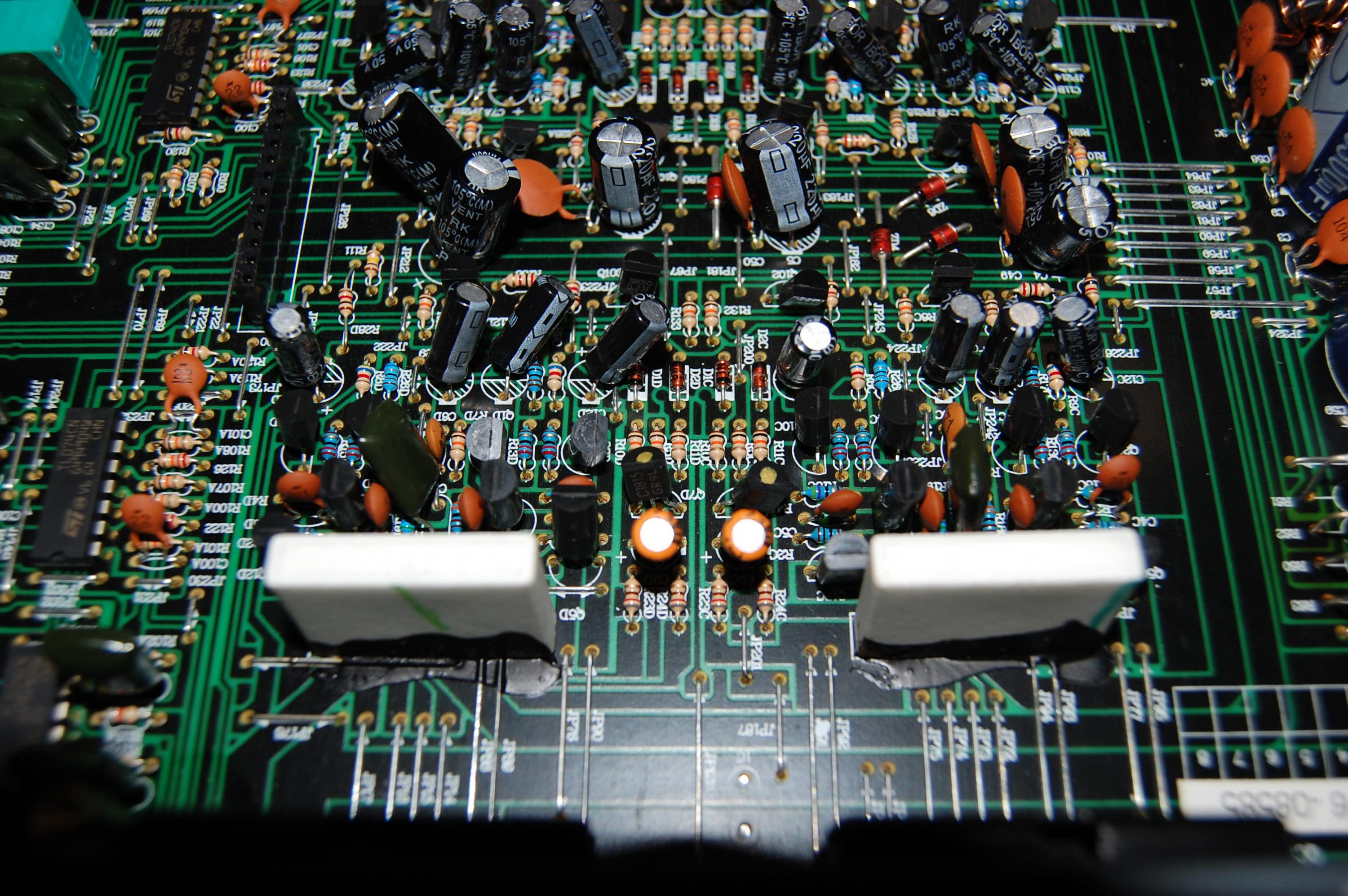

      I'm getting frustrated with this amp.
      The schematic doesn't match 100% with my amp. It seems like they were two versions out there judging by the top cover differences.
      There is no variable resistor and I can't find that RT1 either.
      I have cut the power(after the two main capacitors) to the finals(VCc+/-) and protection mode is still on.
      I don't know how to do measurements and the FETs to be installed on the heatsink, it's almost impossible. This is a single layer board and the layer is at the bottom, can't reach it. I guess, I will end up removing the board and re-installing it a few(20x) times.
      I have to be sure that the power supply delivers what it should deliver first, no?
      I can't find the 7815 section either.
      Another thing is, how to discharge the amp, because it takes forever to drop the voltage? I have sparked a couple of times the FEts, while trying to remove the PCB.

        Re: Infinity 475a car amplifier 75Wx4Ohm
        It seems like the VH+/- is missing.
        I'm measuring +/-0.2V across C57 and C56.
            OK, I have tried measuring with Min/Max Peak and it showed 30V, but then shut it off.
            I'm trying that way to measure, but not all components can be reached.
            For example C56, is against the toroidal transformer and C55 against it.
            So, I'm guessing that something is still shorting in the amp section, to cause this shut down.

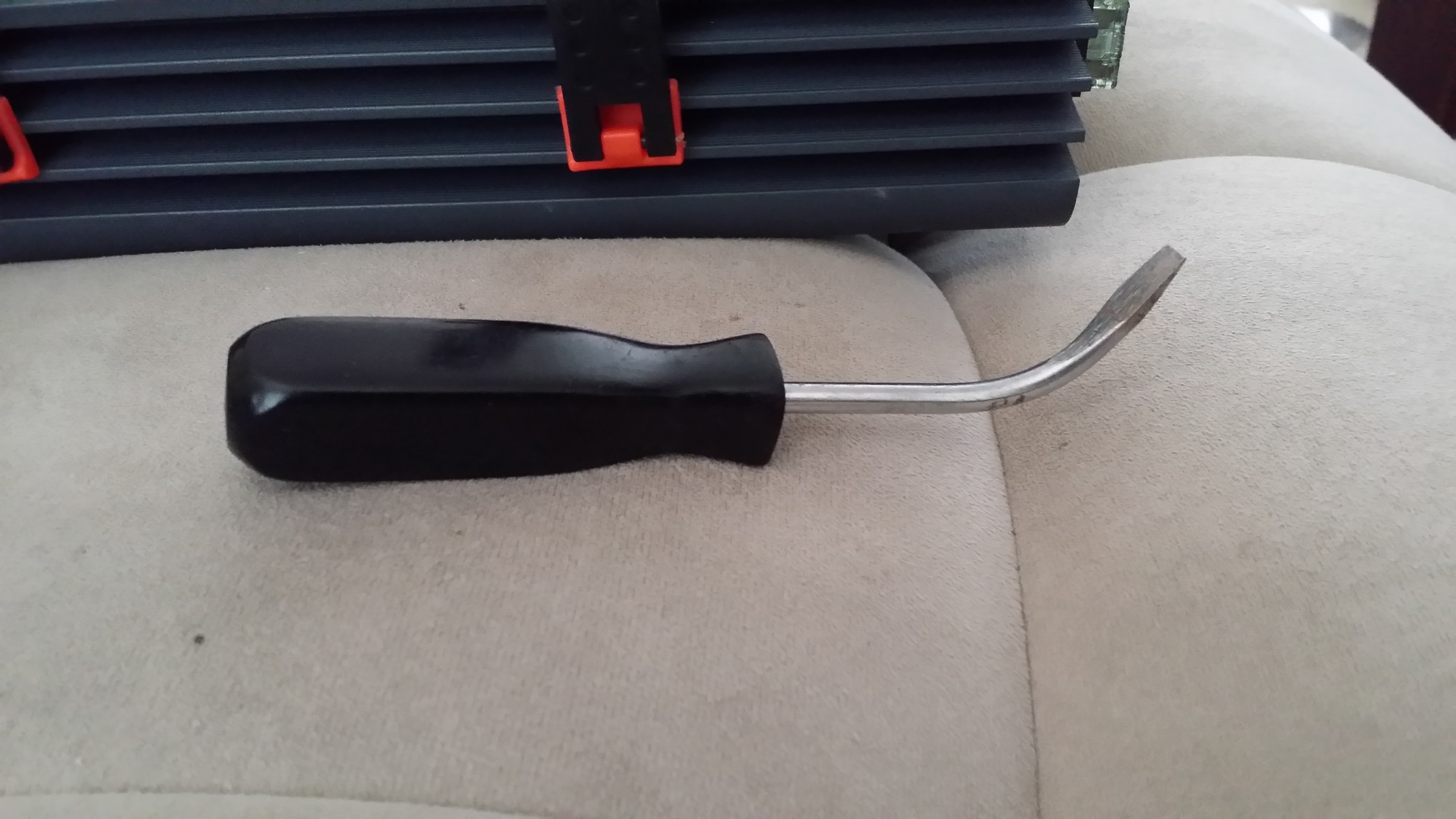

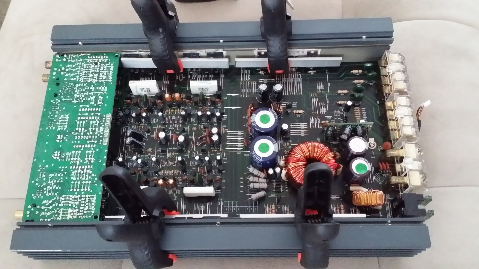

                        CN4 shows 32.12Kohm and the RT100 starts around 480Kohm and is going higher and higher.
                        This is how I have it set up for easy testing. Some Aluminum strips, some clamps.
                        To remove the original clips, use a bent screwdriver, like one I made one for myself.

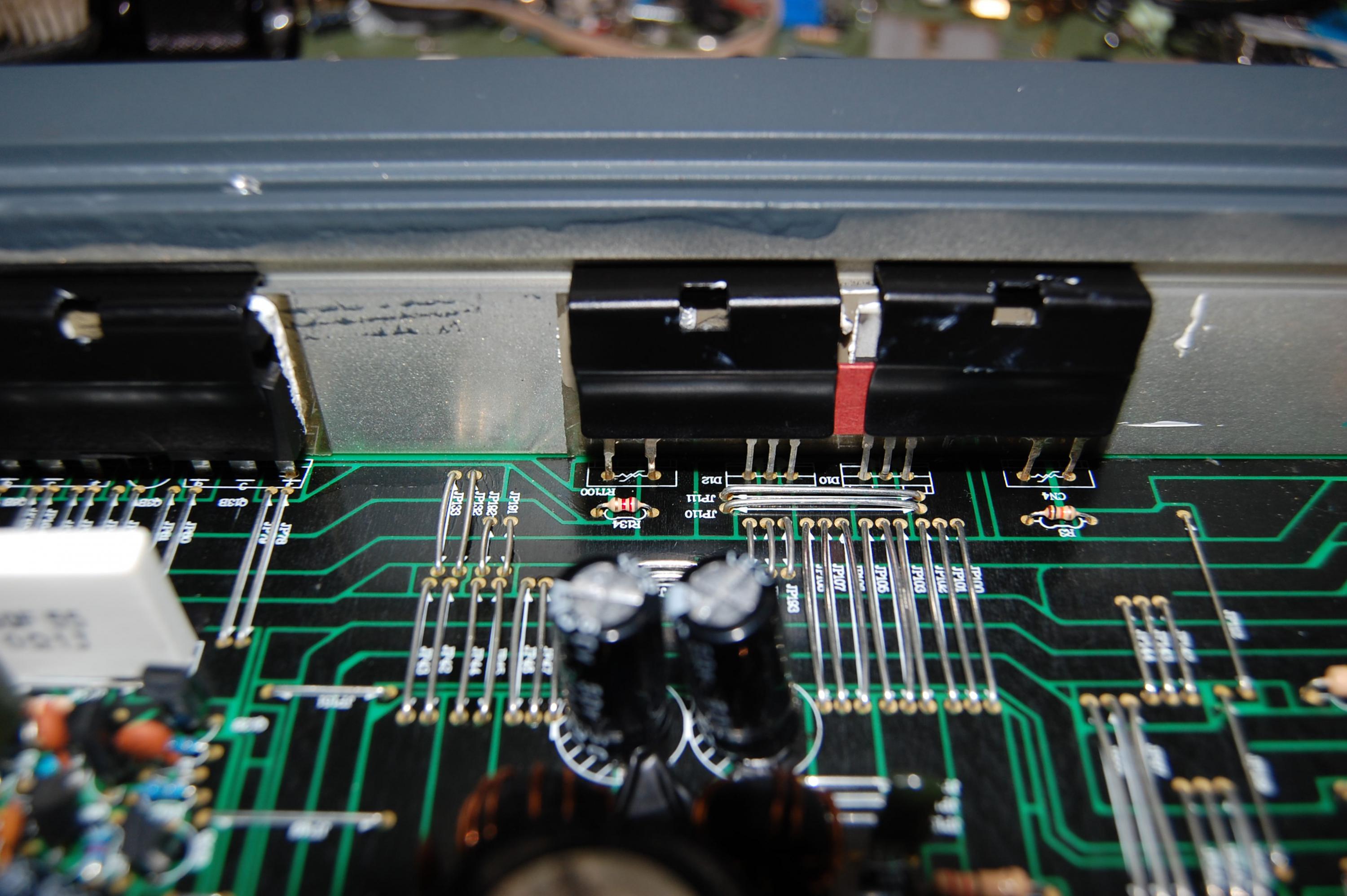

                              I had blown transistors and I have replaced them already.
                              I even had blown off traces at the transistors. All that is done and I still have the protection on.
                                Did you check all the transistors mounted on the heat sink for shorts? If they are none, check the big resistors on each output transistor and their driving transistor. If the driver is bad, unit will stay in protection too.
                                    Can you believe, that I'm back to repair this? It's been 5 years already!?
                                    I have found a leaky transistor, Q12B.
                                    Replaced it and the first time I turn it on, it turns on OK(blue LED is on). The power supply is only a 5A one. That could be a problem? Turning on this amp, maybe spikes higher then 5A?
                                    If I turn in off and then on again, it goes into protect mode.
                                    I have soldered two wires, at the pin #9 and #10, at TL494 and when it's not in protect mode, I have two nice square waves.
                                    If I turn it off and then on again, protect mode is on and the two square waves are gone. It shows a negative straight line, at both outputs. -29V is gone. +29V is always present.
                                    I have even replaced TL494 again, just in case. All the transistors/diodes, on that daughter board check out OK. It could be a bad capacitor somewhere?
                                    • tibimakai
                                      • Jan 2012
                                      • 3680
                                      #38
                                      It is all good. I guess, it was my power supply, as it was discharging, "causing" the protect mode?!
                                      If I kill the power instantly and apply it again, no more red light.
                                      It is fixed.
