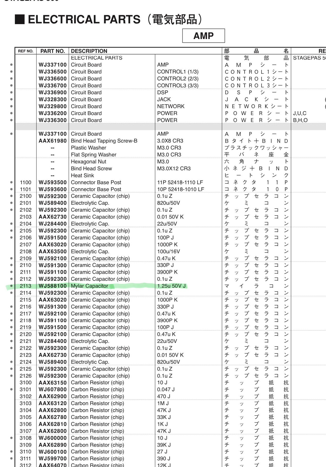

    Those caps that look like a woman's handbag are called Mylar capacitors. This one is a 1.25uF 50V 5%. Just match something film up, jam it in there and call it a day. I also added the service manual, you may need it.

                I don’t think it matters much as it is close enough. 1.5 seems to be an easier find than 1.2uF. If you include worst tolerances they aren’t much off. Order a couple. Look at the schematic I attached, find the amp board and that capacitor and check around if everything else is still in speck. Other than that, give them neighbours a nice long sound check.

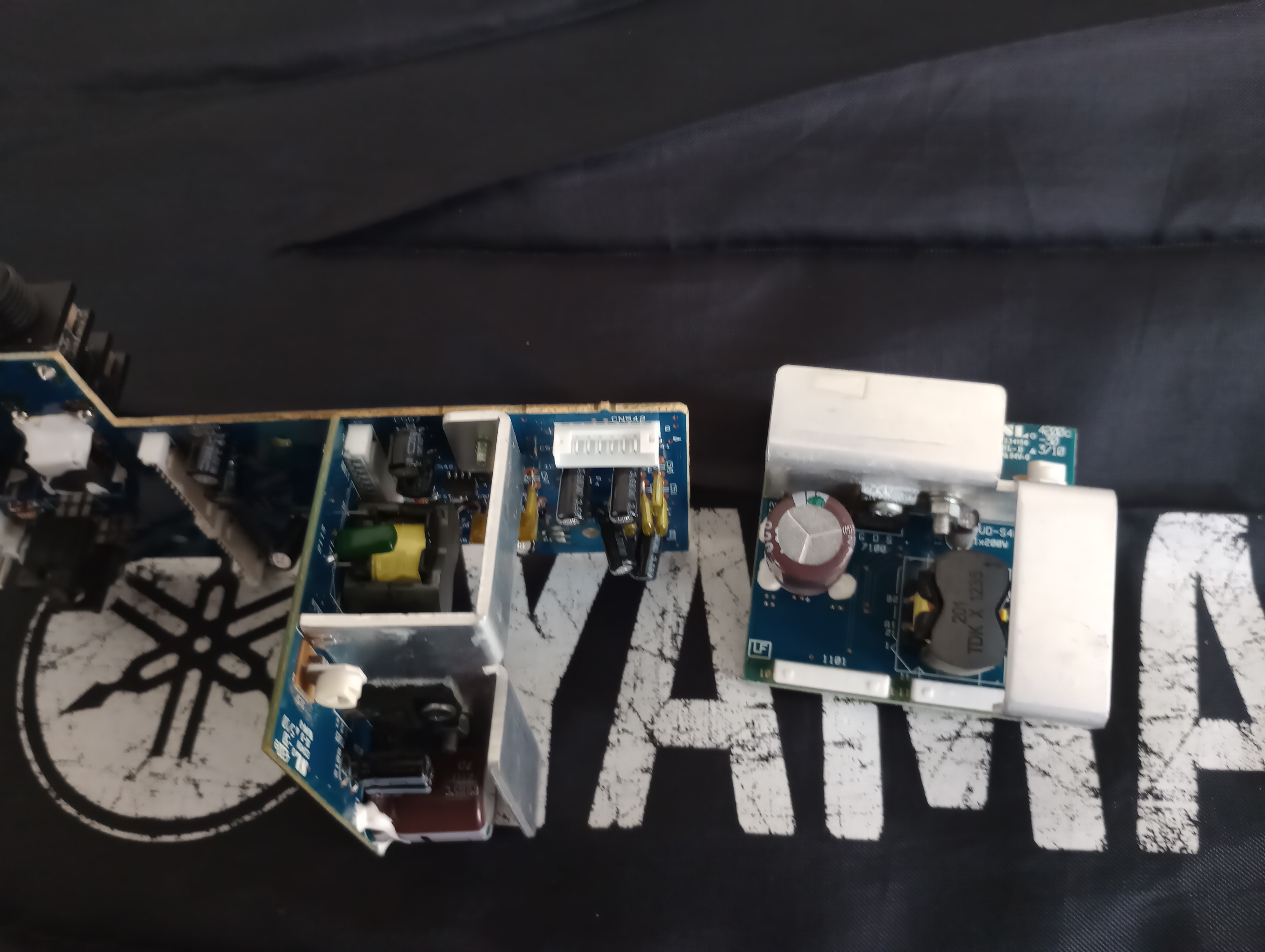

                  Thank you CapLeaker , just replaced the capacitors, but no changes. Doesn't wanted to switch ON. How I push the switch in ON position, in 1 second I can hear a click and is switching OFF. Any Ideas what to check?
                  Can't see anything blown/damaged, nothing smelling as burned.
                  • CapLeaker
                    Leaking Member
                    • Dec 2014
                    • 8231
                    I suppose it could be very well something else being wrong with that amp. That cap didn't go poof for no reason. It turns on and goes click and off? Is it some sort of protection mode? There supposed to be an error LED somewhere I think it is tied with the power LED. Look at the block diagram. There is a troubleshooting chart in the service manual. By rights, start with the PSU and verify all voltage rails are there. Try maybe disconnect that broken amp board and just let her run on the other one and see if she starts. My guess it that there is a shorted transistor (s) and maybe a few bad resistors on that amp board. After all, the amp needs to be able to protect itself if it detects DC on the output or over current.

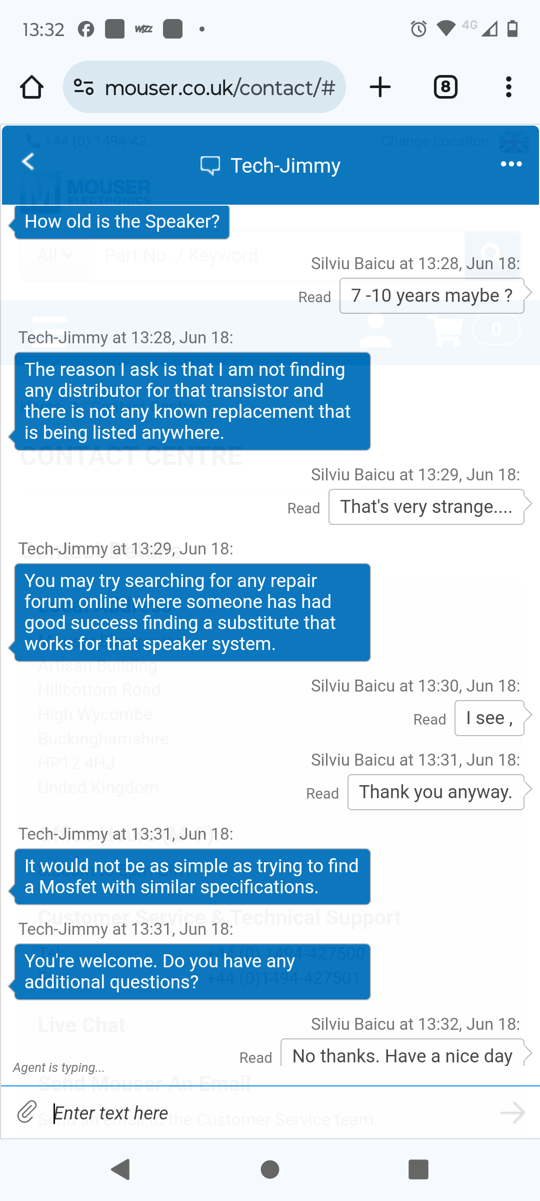

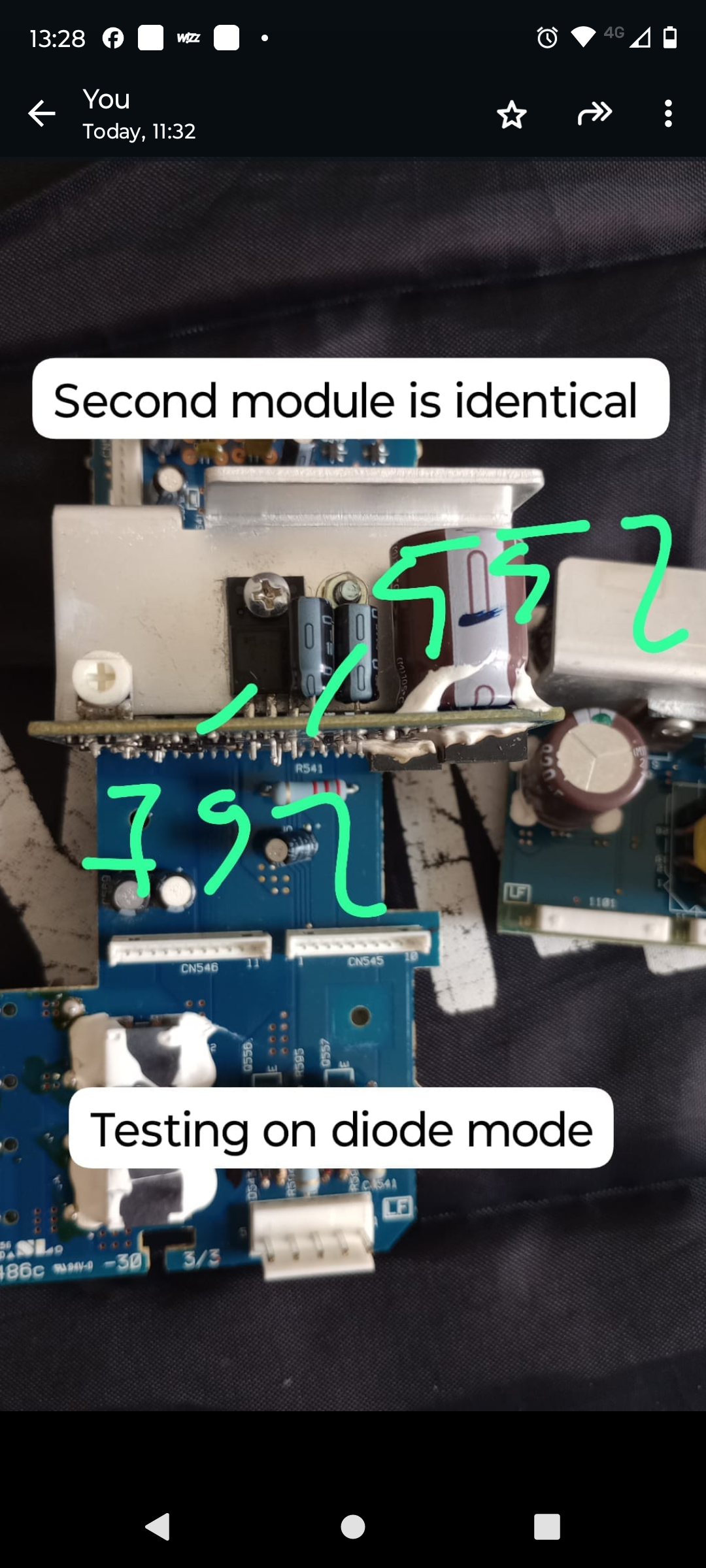

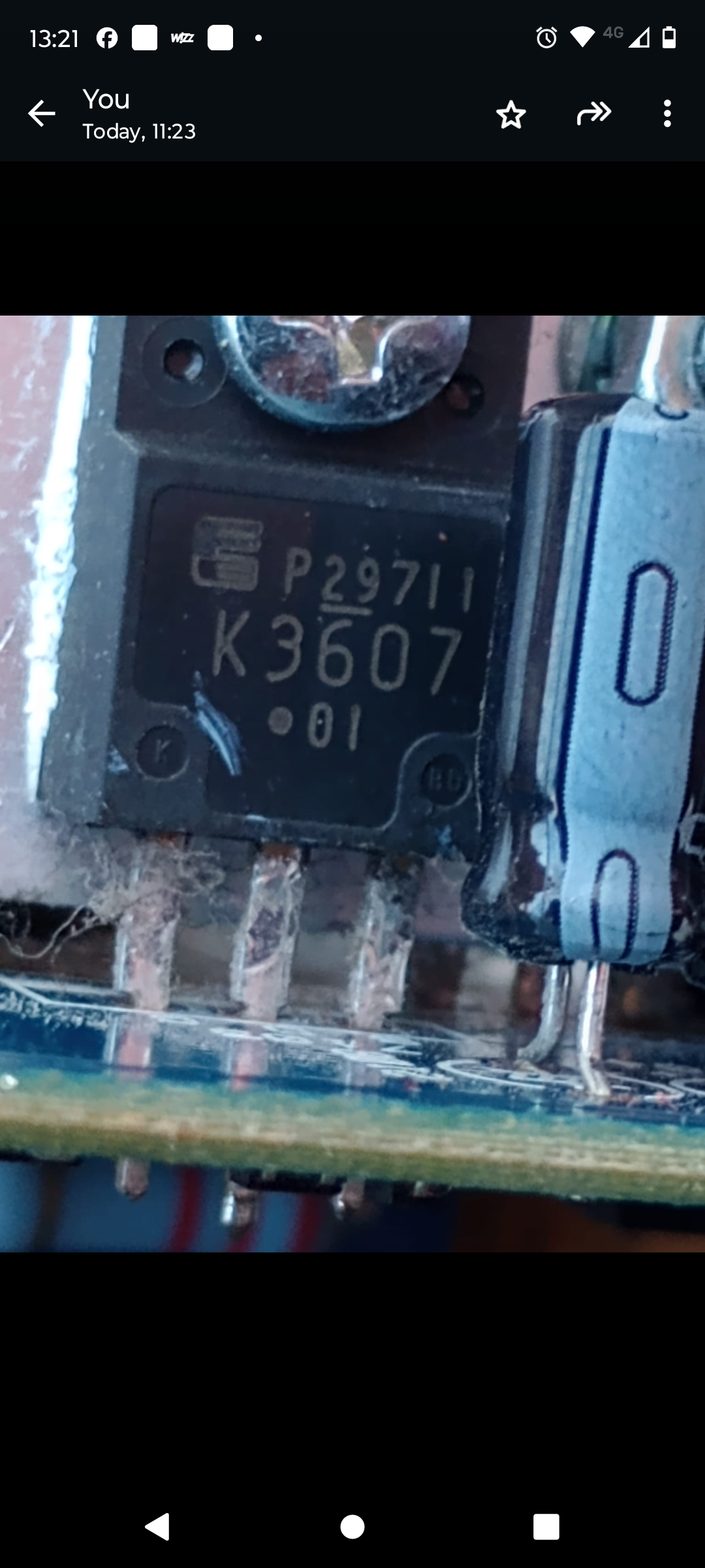

                      Hi. Got some free time for checks, and found both transistors as bad. Also speaking to mouser seem that is impossible to find anywhere this transistors . Any Idea please?.
                      • CapLeaker
                        Leaking Member
                        • Dec 2014
                        • 8231
                        2sk3607 order from littlediode.com
