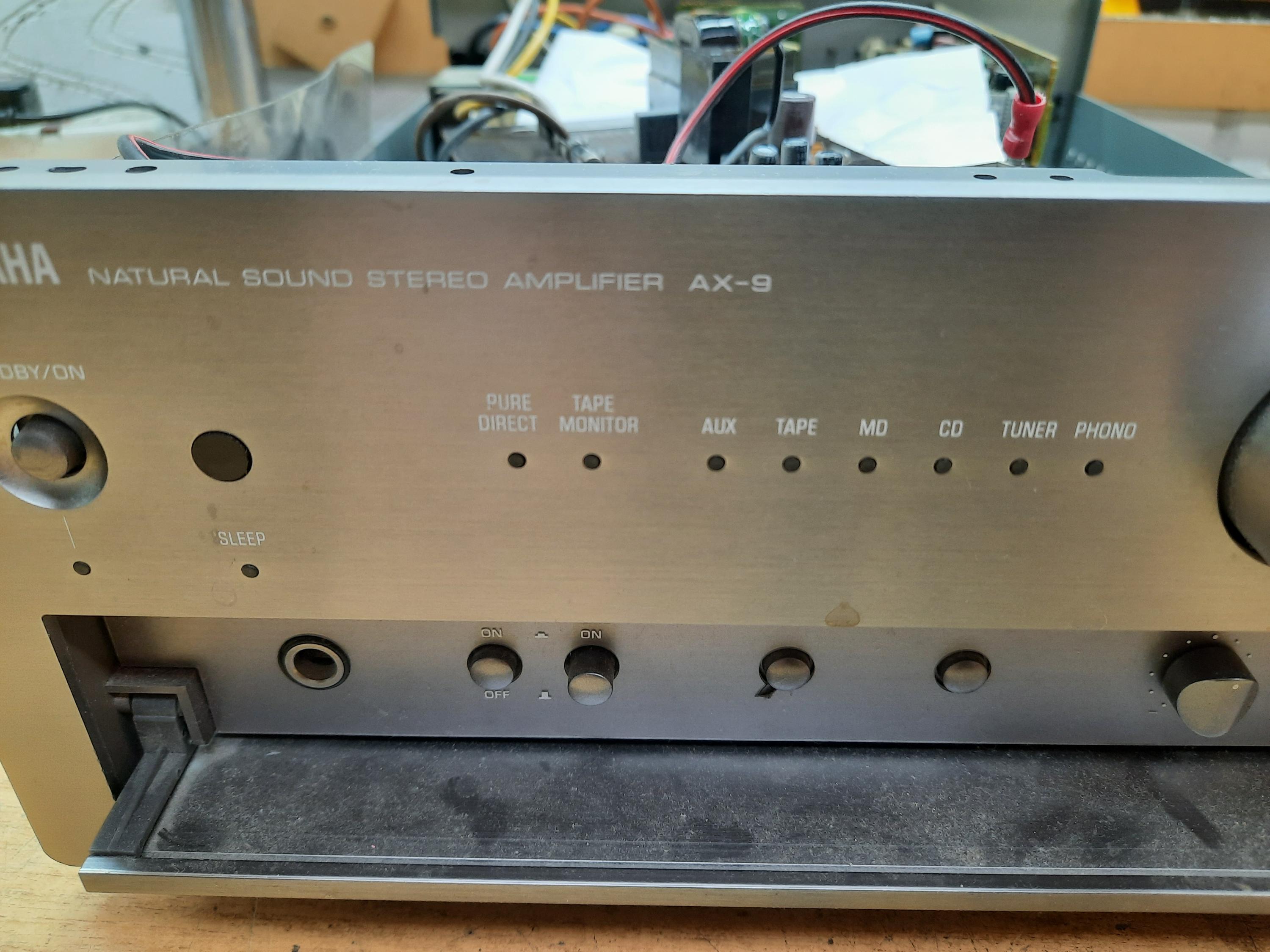

AX9 Yamaha amp , no functions , schematic / advice please .
  • zen
    • 511
    This one seems to power , as the RED LED for standby goes out , or on as the case may be & relay clicks over , but none of the LEDS for any of the inputs light .
    Suspecting a micro controller type issue on front board .
    Anyone worked on these units ?

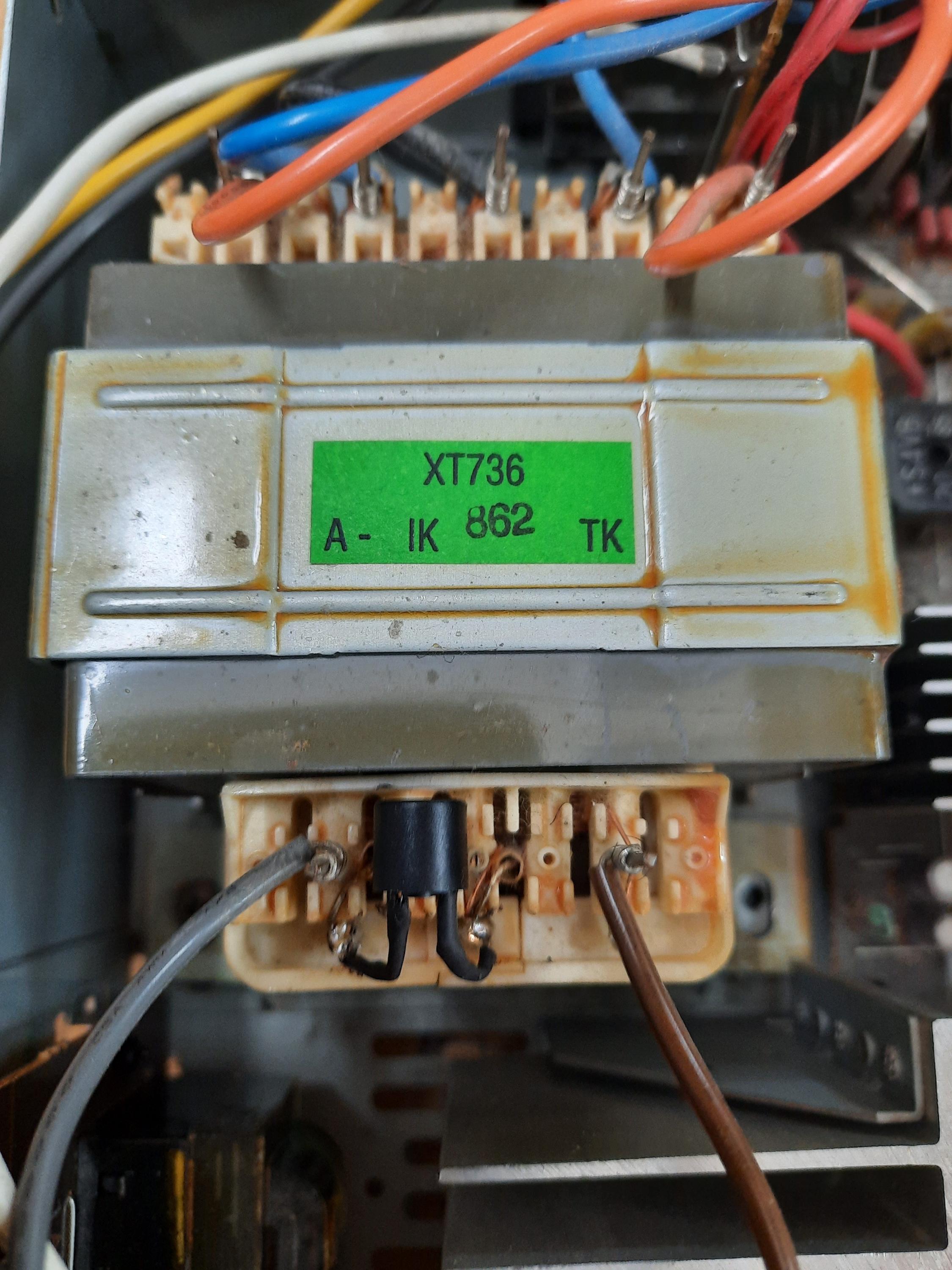

    Re: AX9 Yamaha amp , no functions , schematic / advice please .
    Led myself astray on this one .
    Turned out to be the primary side of main transformer O/C
    Thermal fuse had popped .
    Strapped a Wickman T2.5A across the original for now just to test amp , then will find something more appropriate to use
    Amp now working .
