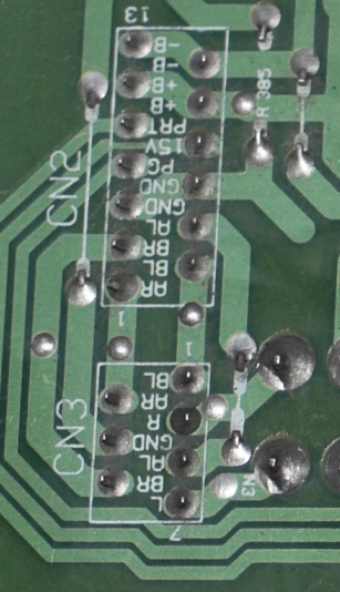

            #45
            Originally posted by R_J
            I doubt there is a DC problem with the amp section, if there was the protection circuit would engage and you would not have any output. it is likely something in the signal path that is at fault. If you can access the plug AKP1044, use a metal pin held by your fingers to inject signal (hum) at pins 1 (right channel) and 3 (left channel)
            dont know if that is a good or a bad news, i did not find the converter so i used these 3 pins as mentioned in the pic and there is clear sound coming to the head phones from both left and right pins
            plz confirm that my assumption is correct on these pins
            this means there is no issue in the path of the input signal?
            if so, where is the problem then?!

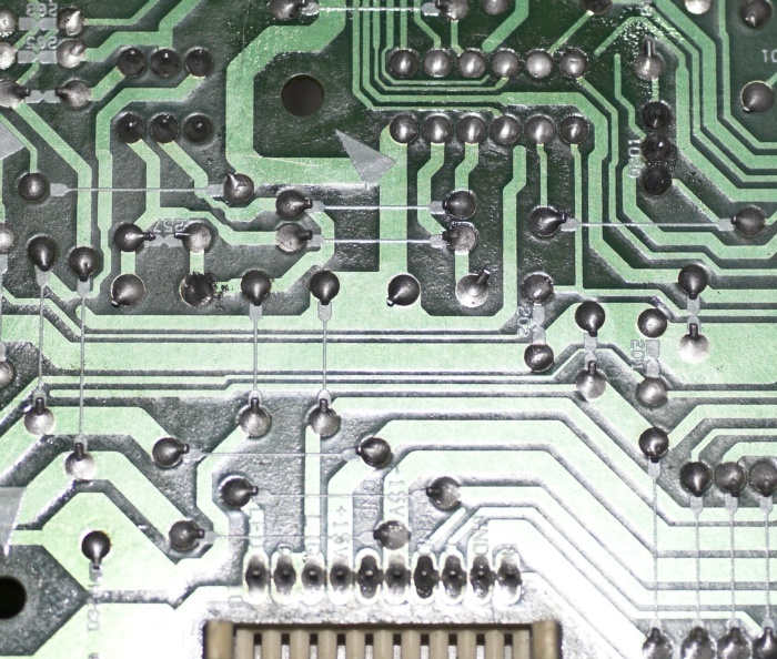

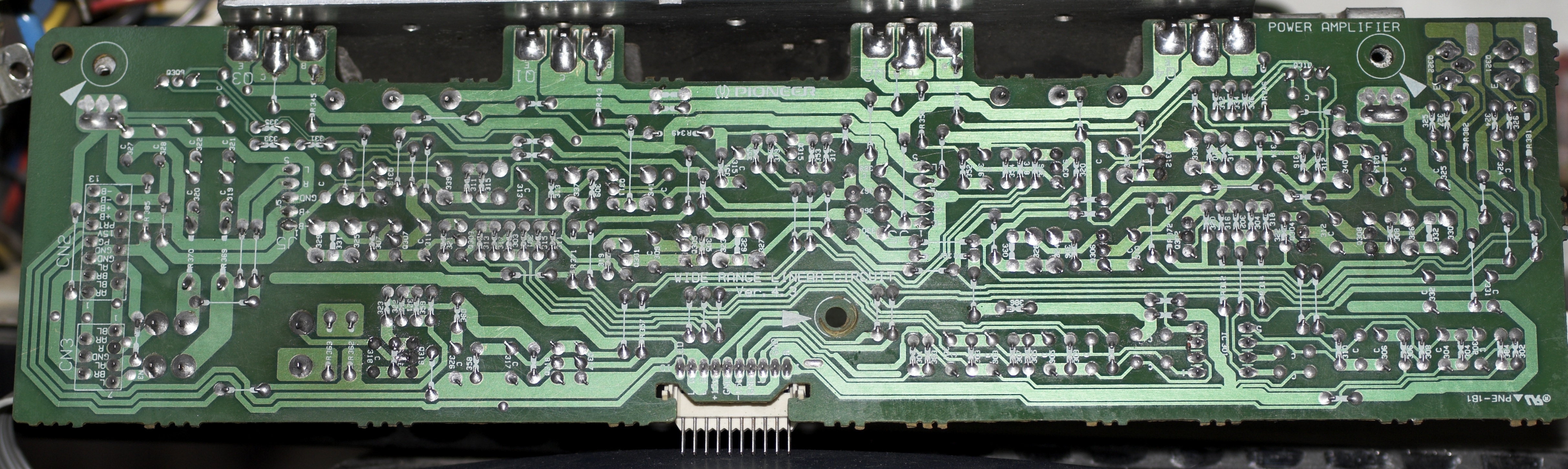

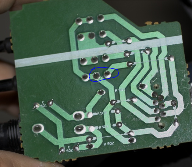

            can you please guide me where is that AKP1044 connector on the actual pcb?
            attached is the pcb after cleaning and re flowing some joints (already tested and worked at that stage before the assembly)
            if the connector is not on that pcb where is it?
            thank you

                #47
                ok i found the connector u meant, it is on the pic i sent
                R makes sound, L no sound when touched!
                so?

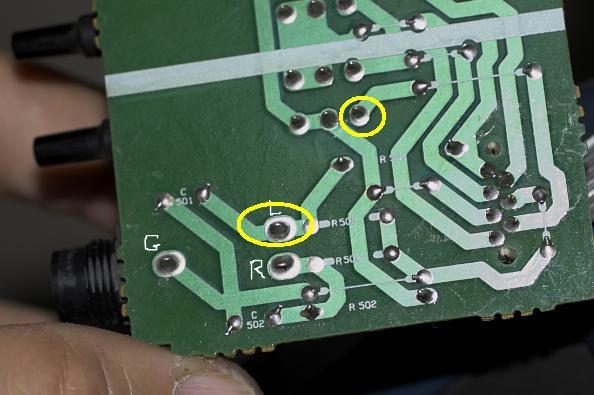

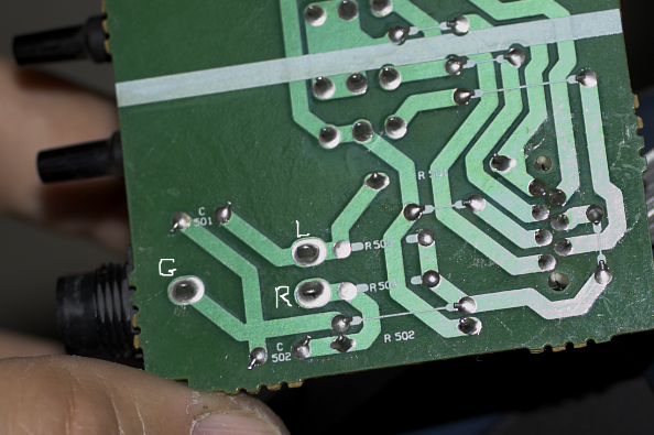

                        If you have audio at the headphone jack then I would start by resoldering the connections on the speaker switches and the connector pins as well
                        Looking at your picture of the headphone jack, it looks like the (L) contact needs to be resoldered I suspect others are bad on that board as well

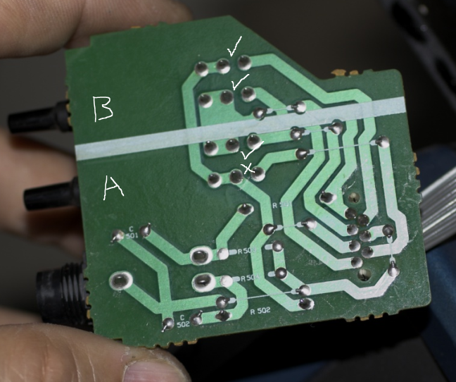

                                #55
                                i thought to test the connectivity of these switches
                                B is perfect which is the one i am using all the time
                                A connect / disconnect only the one marked right, X is always ON no matter what
                                is that right or wrong? can this cause all that issues including the very faint sound on the phones?
                                i really dont want to pull these out unless i am sure it is the issue coz it is a lot of work
                                the 2 switches are both crimped to a single steel plate, for that i will have to desolder the 12 pins at the same time in order to be able to pull it out!
                                thanks

                                  #56
                                  i am assuming that "x" issue (connected all the time) should not be the problem coz whether A switch is on or off the output is not affected as far as B switch is good and ON and that by itself is worrying me

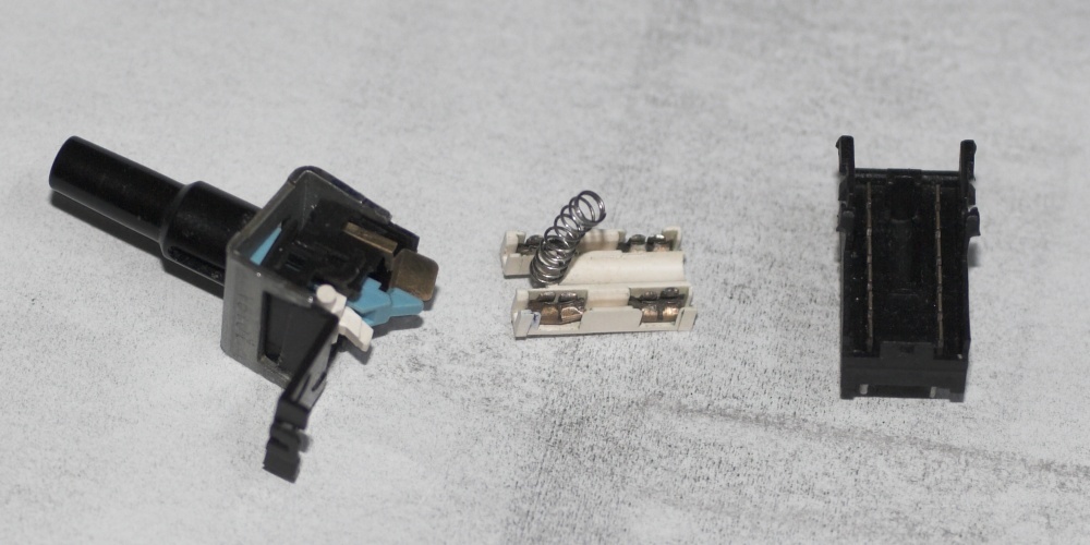

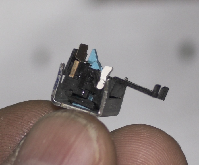

                                    #57

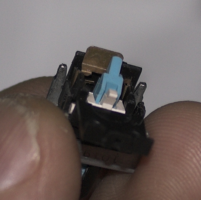

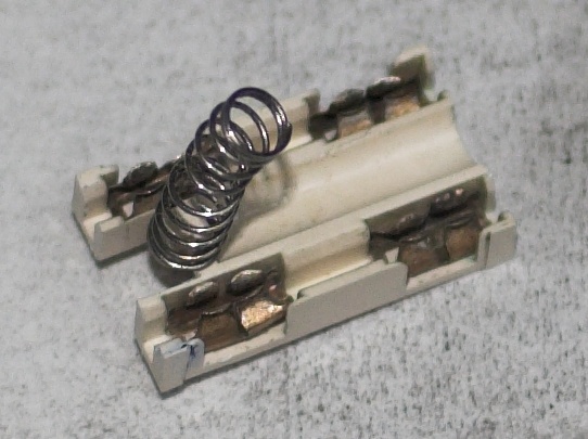

                                    ok finally some good news
                                    i re soldered again and add a re flowing /soldering to the relay pins and some other pins that looks they have little solder (close to the connector)
                                    there is sound on both channels , but for few seconds and when i tried to press on the direct switch there was noises (which is not news, i know it have issues) but the news is that the relay started to go on/off quickly, so i decided to power off the unit immediately to check
                                    now i removed the direct switch

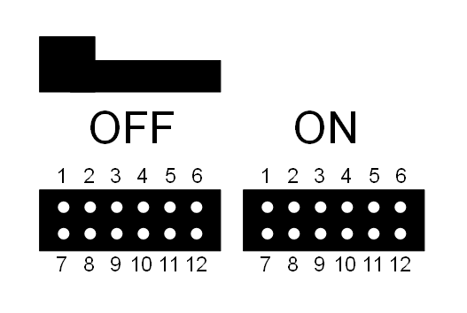

                                    and disassembled it, it is complex and have 12 pins!
                                    for that i need to know what is it doing first , so that i can check before re soldering it
                                    the main issue for me with these switches is that in addition to its 4 copper moving pieces there is also a small copper plate, i am not exactly sure what it does, apparently the unit cant work/produce sound with that switch being pulled out coz it has a function in both on/off states
                                    i have uploaded pics for the switch and also a drawn diagram which have 2 copies to make it easy for you to mark for me the connections should be made between pins on the OFF and ON states, plz pay attention to the orientation, the pins shown assuming a direct view not x rayed and the bulk is on left side
                                    lets finish this i hope
                                    thanks

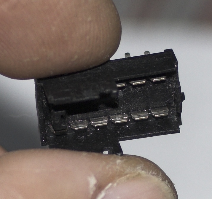

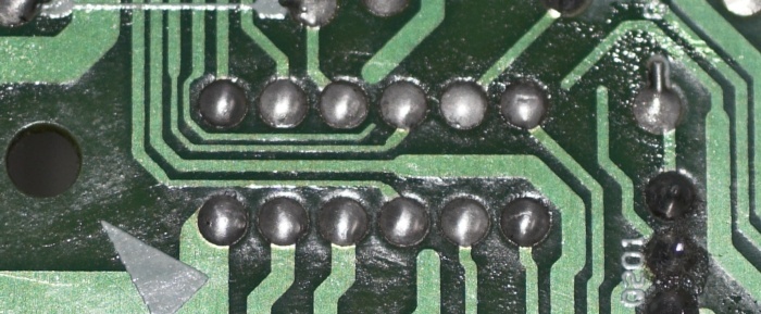

                                      #58
                                      in addition:
                                      also here is a pic for the front panel, showing the 12 pins
                                      i would like to first solder them to the "direct switch" OFF state without using the switch, just to make sure and make it easy to diagnose
                                      plz let me know how should i blob / wire them without the switch, just mark for me the connected pins and i will do it
                                      thanks

                                          #60
                                          plz dont forget to tell me about these 2 pins specifically coz i did something, i desoldered both using the copper wick (completely clean) and i did test the switch (both pins isolated from the pcb), and it works perfectly it does d/c and connect them so the short is not from the switch, however when i test the pads continuity they are always connected, so i want to know if that is ok or they should not be connected all the time at any state
                                          the other pin does d/c / connect, the other B switch is perfect also, it is important coz it could mean something, however like i said keeping A on with B on fine and it have never been a problem but just want to make sure
