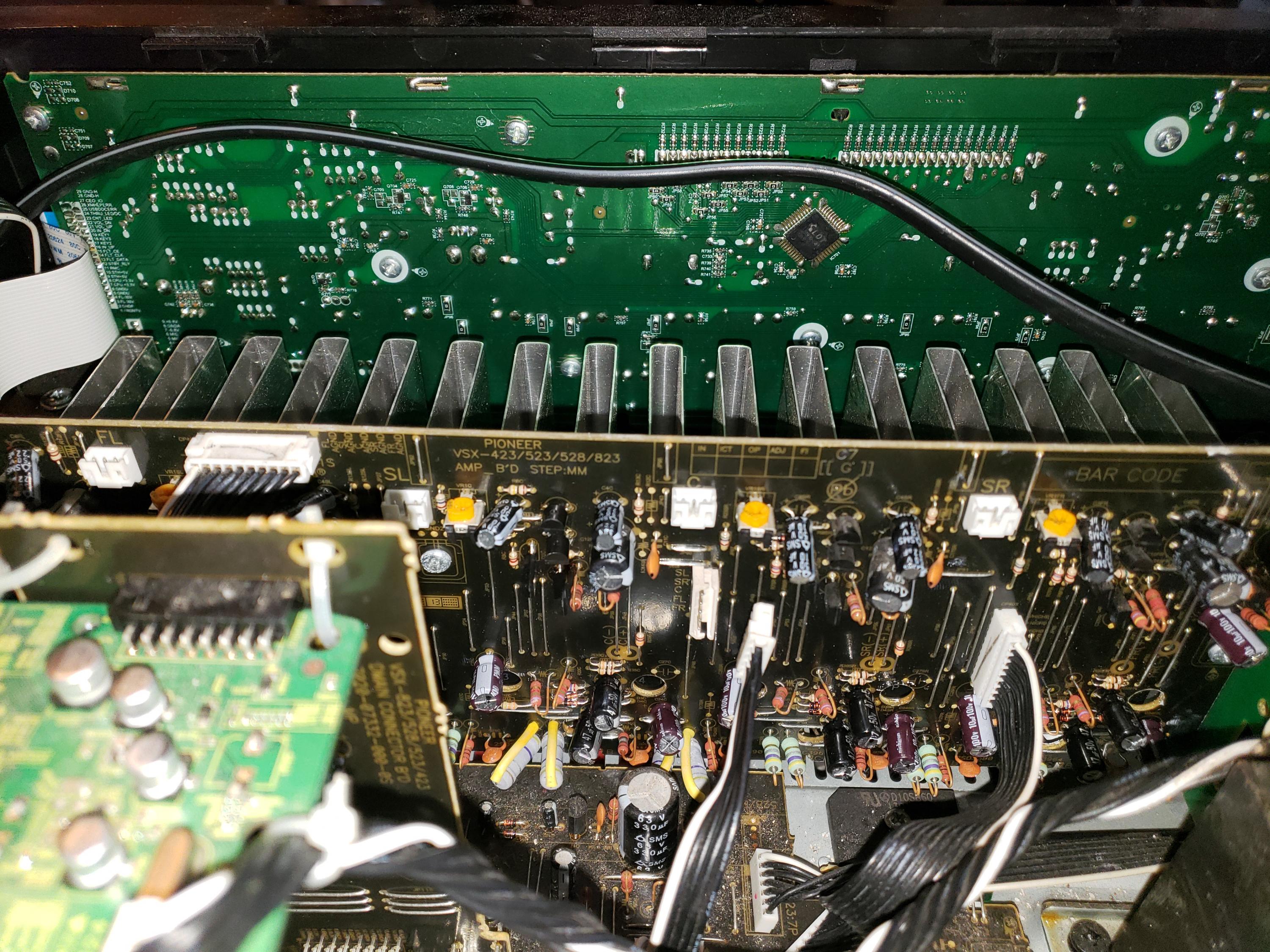

    Hi folks,
    New audio equipment repair and I could use some help.
    Picked up VSX-523-K Surround sound amplifer.
    Upon power up for the first time (been sitting for a while) loud popping noise and smoke..
    Disconnected, opened up and found many popped caps on the amplifier board.

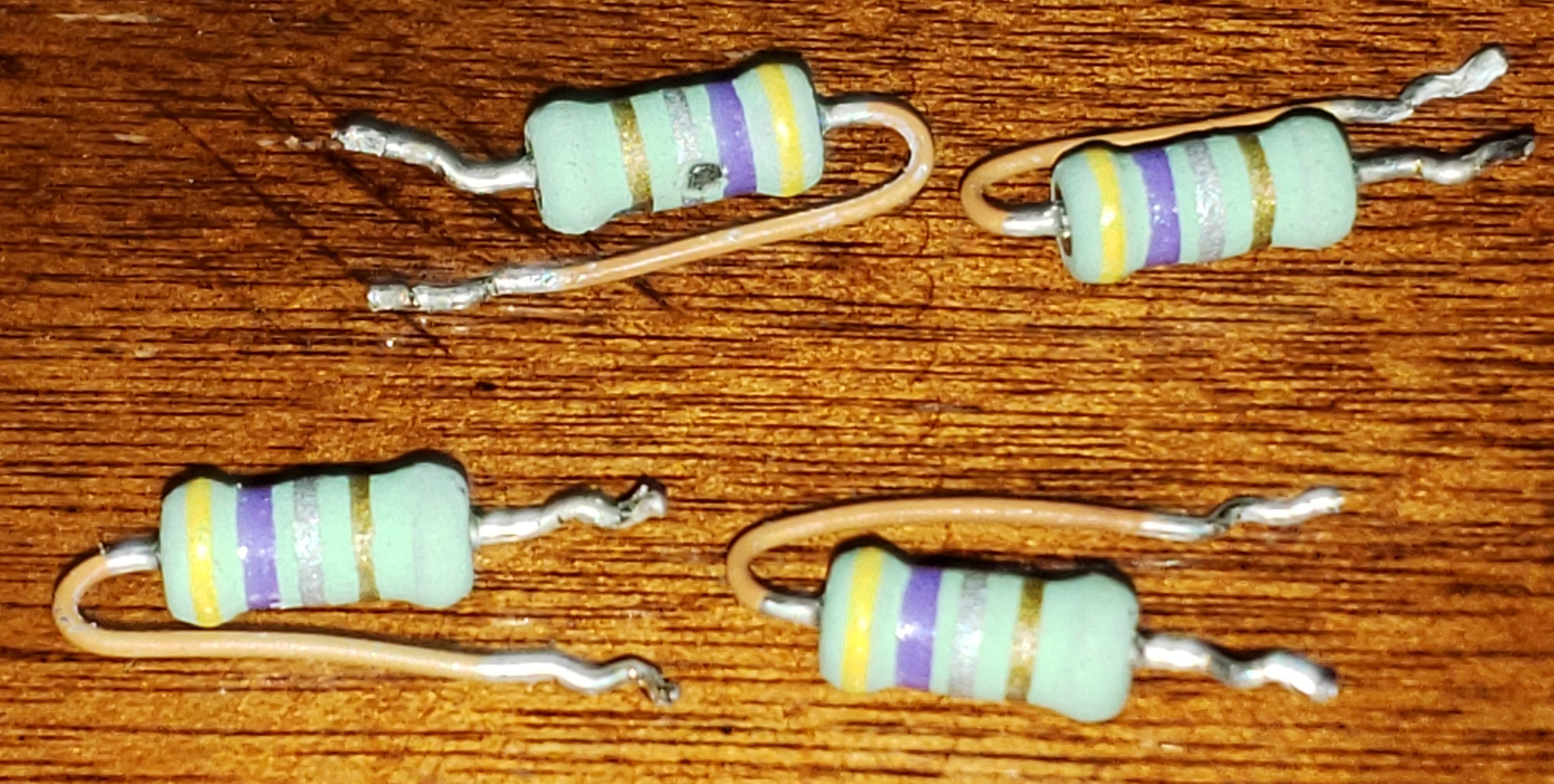

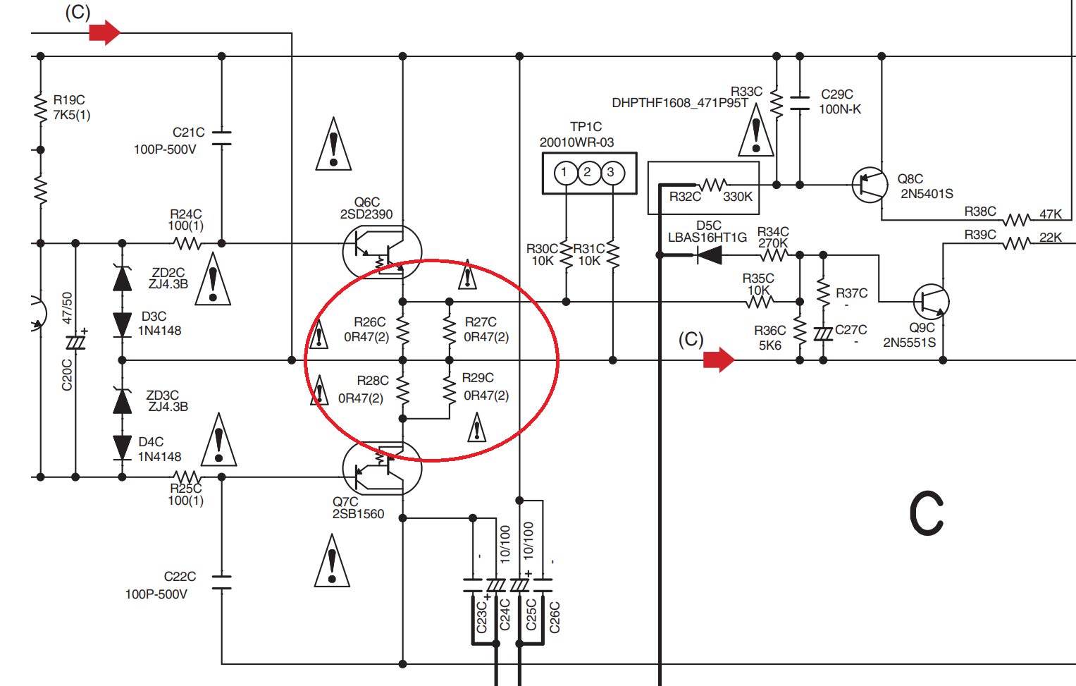

    Replaced all, replaced A992 BJT, and pre-amp transistor and power transistor. I found 0.47 Ohm resistors that are blown or have gone High impedance and I'd like to replace.
    On the service manual, it shows these as 0R47(2) (assuming this is a 0.47 Ohm, 2W?)
    Question is .. what type of resistors are these? Flame proof, coated, .. ?? I see the leads have insulation of some kind. Just making sure I replace with appropriate resistors.
    Thank you

    Re: Pioneer VSX-523-K Amplifier - Identify resistors
    If the 0.47ohms are blown, then the final transistors are as well.
      q6c and q7c will likely be toast .. i guess the resistors will likely be wirewound non inductive .
      also other components could be blown .

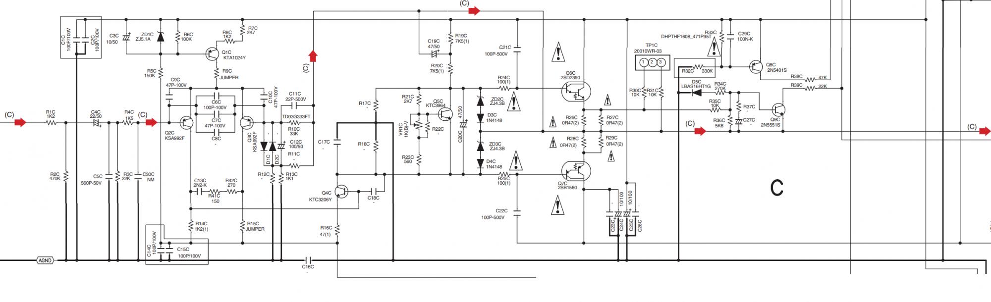

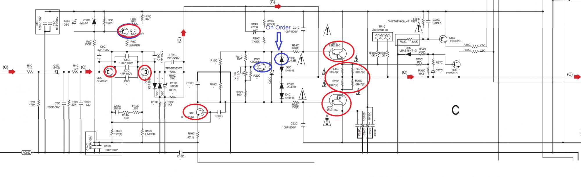

      • jason123
        • Oct 2015
        • 1134
        So, Channel C seems to have the issuse (Had the blown transistors and output caps)
        In addition to all the Electrolytic caps being replaced, I replaced all the components in Red circuit.
        Then I found the items in Blue circles blown and these are on order.
        After replacing the components in Red, I'm getting "OVERHEATING" and OL 19 errors.
        Does ZD2C being shorted explain this? or could there be more components that are / could be bad? I tested as many components as I can on this channel
        Thank you
        • petehall347
          • Jan 2015
          • 4442
          • United Kingdom
          maybe best to renew all diodes in that string .
          • petehall347
            • Jan 2015
            • 4442
            • United Kingdom
            those ksa992 that make up the diff amp need to be closely matched for vbe and hfe .
            • jason123
              • Oct 2015
              • 1134
              Planning on it. Can't find the original zener part (zj4.3b), replacing with NZX4V3B.. hope that would do it
              • jason123
                • Oct 2015
                • 1134
                I tried, bought the a992, 10 taped and i used 2 of them. Hfe is within range of original, though not exact. That wouldn't cause the overheat issue, would it?

                • petehall347
                  • Jan 2015
                  • 4442
                  • United Kingdom
                  no it would alter dc offset .
                  shorted diode and bias transistor would .

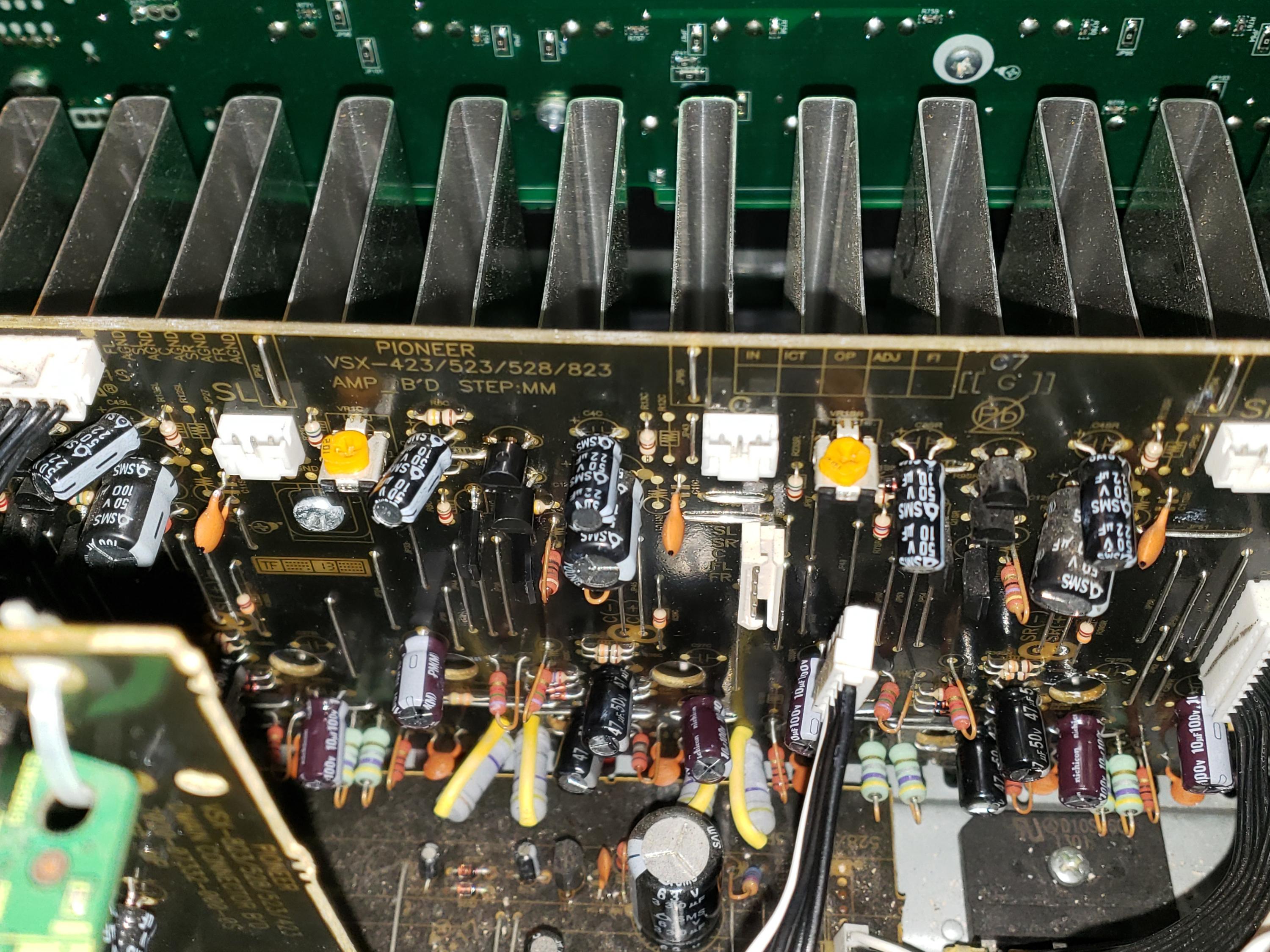

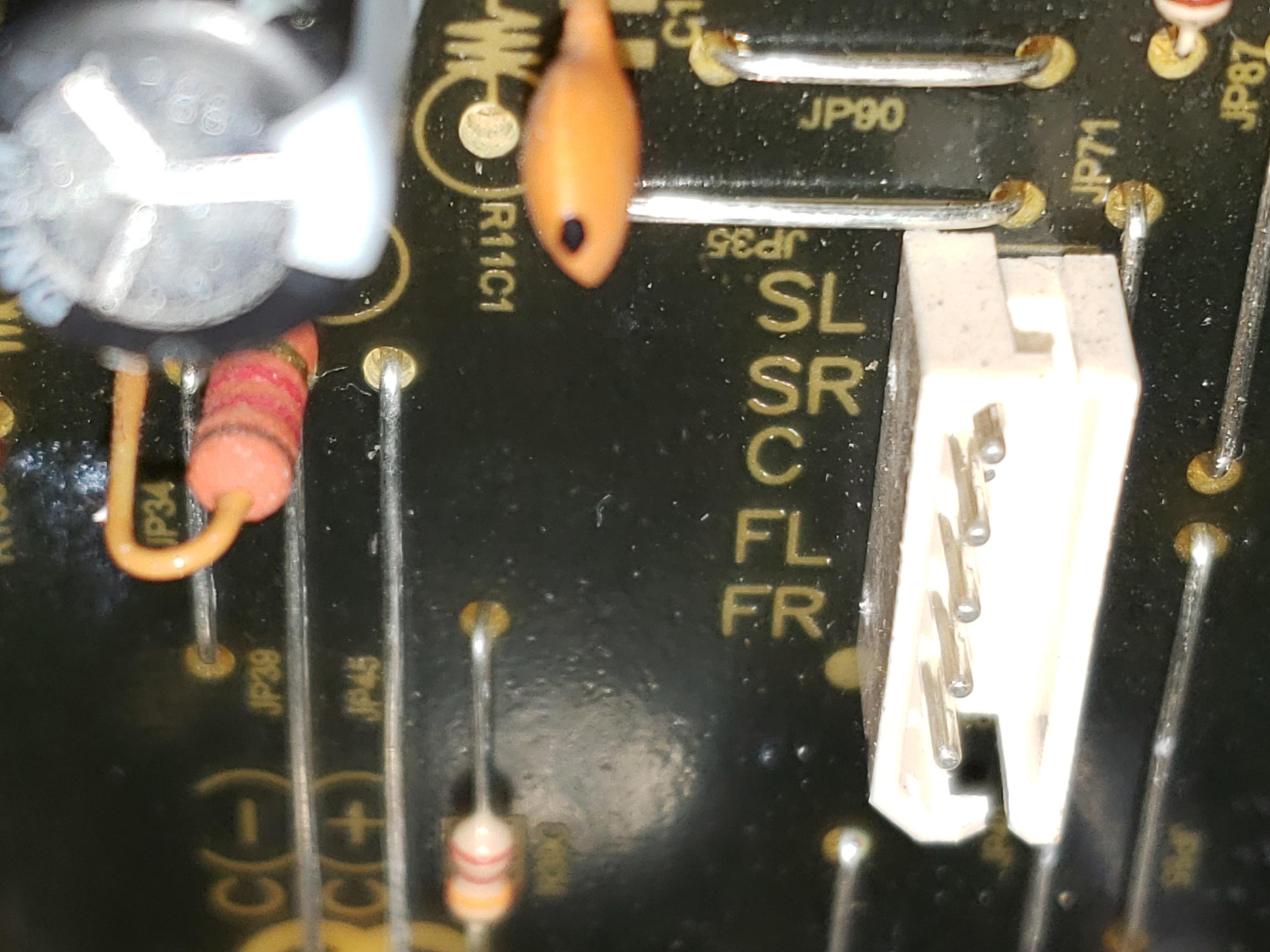

                          Sorry. I will get a better set of photos but the cable i am referring to is unplugged in the photos
                            That plug is CP402, it connects the amp board to the relay contacts that connect to the speaker out terminals, It also connects DC_DET3 and DC_DET4. There is likely DC voltage on one of the outputs causing the amp to detect the fault.
                            Check the DC voltage on the pins of CP402, I suspect there is Dc voltage on pin3 (Center channel you repaired)
                            Did you check/adjust the idle current on the center channel?

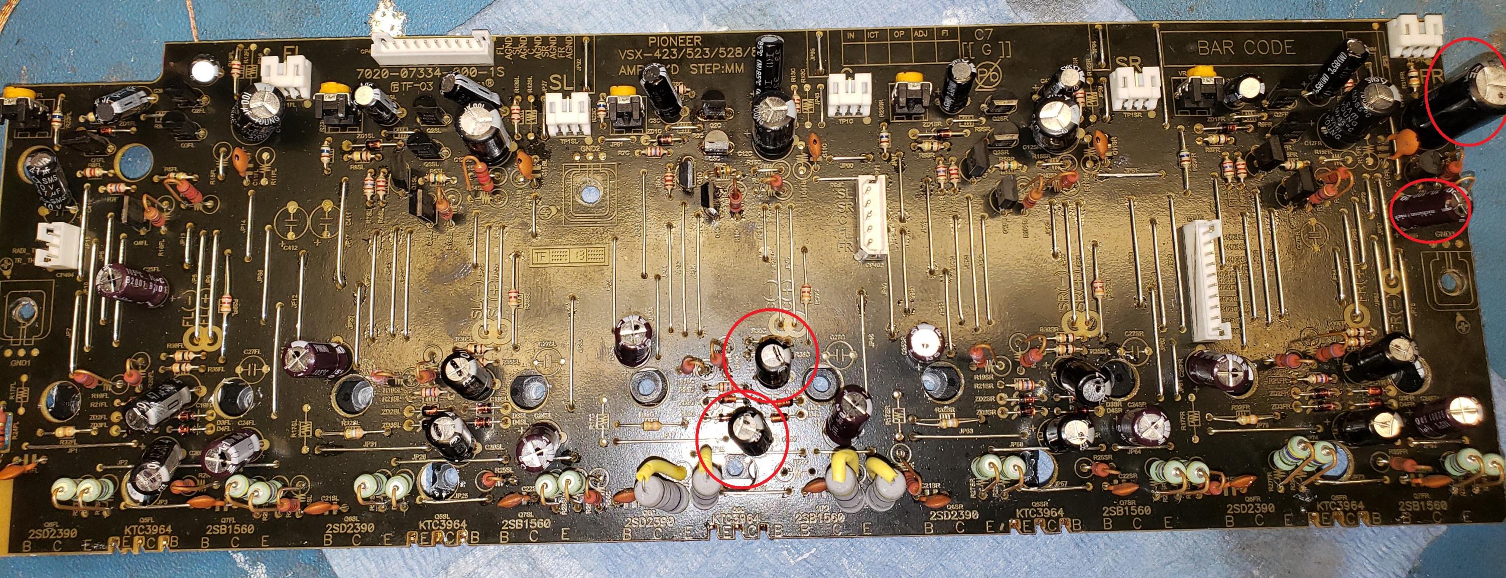

                                    Hi R_J
                                    Attached shows the 4 caps that were popped. I replaced all these caps in addition to all the caps on the lower part of the board, near the large transistors.
                                    It turns out the C channel seems off when I check the bias voltage (With center connector disconnected, as I didn't know how else to measure, since the amp goes into immediate HDMI blink with the cable connected.) The bias voltage on that channel is 0.xx mV. All other channels except for the SR channel (See below) read 1.7 mV.
                                    The channel that has DC bias is the SR channel, it's showing over 318 mV (Manual says below 2 mV.) I checked all the components on the SR channel and no apparent bad parts. Replaced the A992 transistor and the KTA1024 and KSA3206, since I bought enough for channel C. Upon replacing these, I power up the amp, and a spark / smoke from that SR transistors sections I replaced. Took apart, replaced again, but haven't powered up. awaiting any suggestions.
                                    Back to channel C, I see that R25C is open (should be 100 Ohm, and reading 1.3 Meg Ohm) One on order. On schematic it says 100 (1), does that mean 1 Watt? seems very small for 1 W resistor. all other resistors seem to check out.
