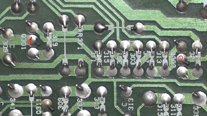

    shorting the leads gave me 0.4 ~ 0.5 ohms, so it looks like the resistor is off, the unit is about 24 years old but rarely used
    i have already tested q321 outside the pcb and it is good (is not that the regulator u mean?)
    if the the regulator is gone then the resistors cant be a fusible i think, however the resistors really look like normal ones, they dont have the extra while band, what kind of amps should it blow at, i can make a test on the semi good one and see when it will fail with my volt station? i also need to know how to determine them fusible or not when i buy them to make sure, i looked that up and could not find an answer, plz let me know

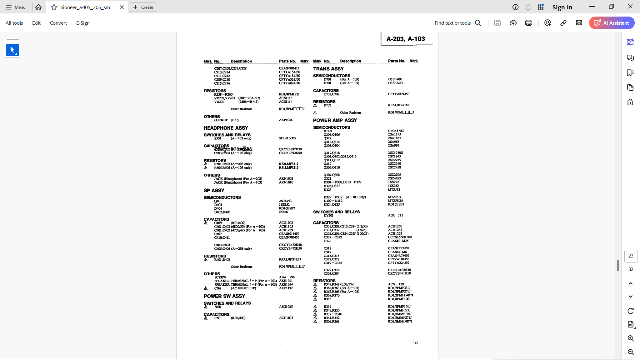

    attached page 19 from the service manual i have, it is terrible pdf, can u share the one you are looking at? i could not find any other better version, it is the only available one
    thanks guys so much
    Just look at the schematic and trace it. The +15V regulator isn't on this board PA board. Just test the two voltages at the connector...
    You looking at the wrong page 19 again. On the schematic the two resistors are We got the info from looking at it like this:

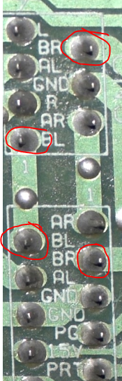

                                  #36
                                  right down dirty testing . lick your finger tip and touch where the arrow is pointing . expect a loud hum from test speaker . Click image for larger version

                                      #38
Name:	Screenshot from 2024-05-11 01-58-04.png
                                      i would like to do so but can u plz tell me where is that capture, perhaps the page number or a wider capture, i cant figure out where is that section
                                      thanks

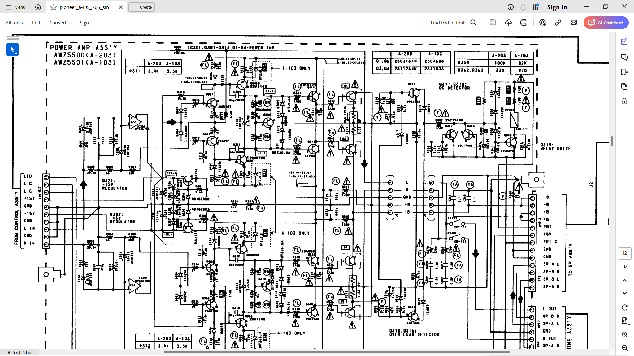

                                        #39
                                        thanks
                                        hope this helps
Name:	Screenshot from 2024-05-11 11-23-00.png

                                          #40
                                          hope this helps
                                          yup i actually found it before i read ur post, however i wanted to make sure where it is on the board
                                          attached a screen from the board, where should i short with my wet finger tip?
                                          thanks a lot
