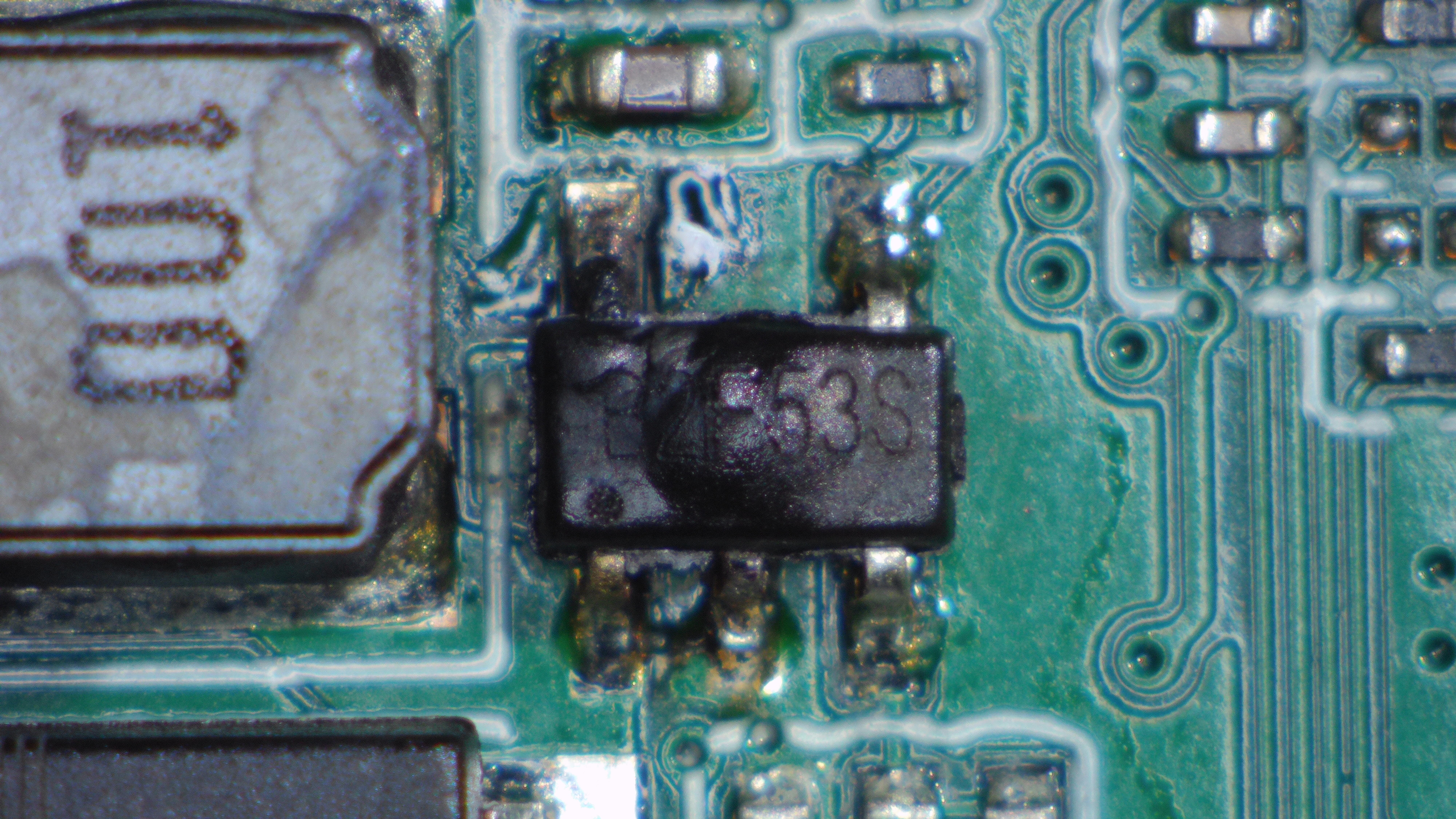

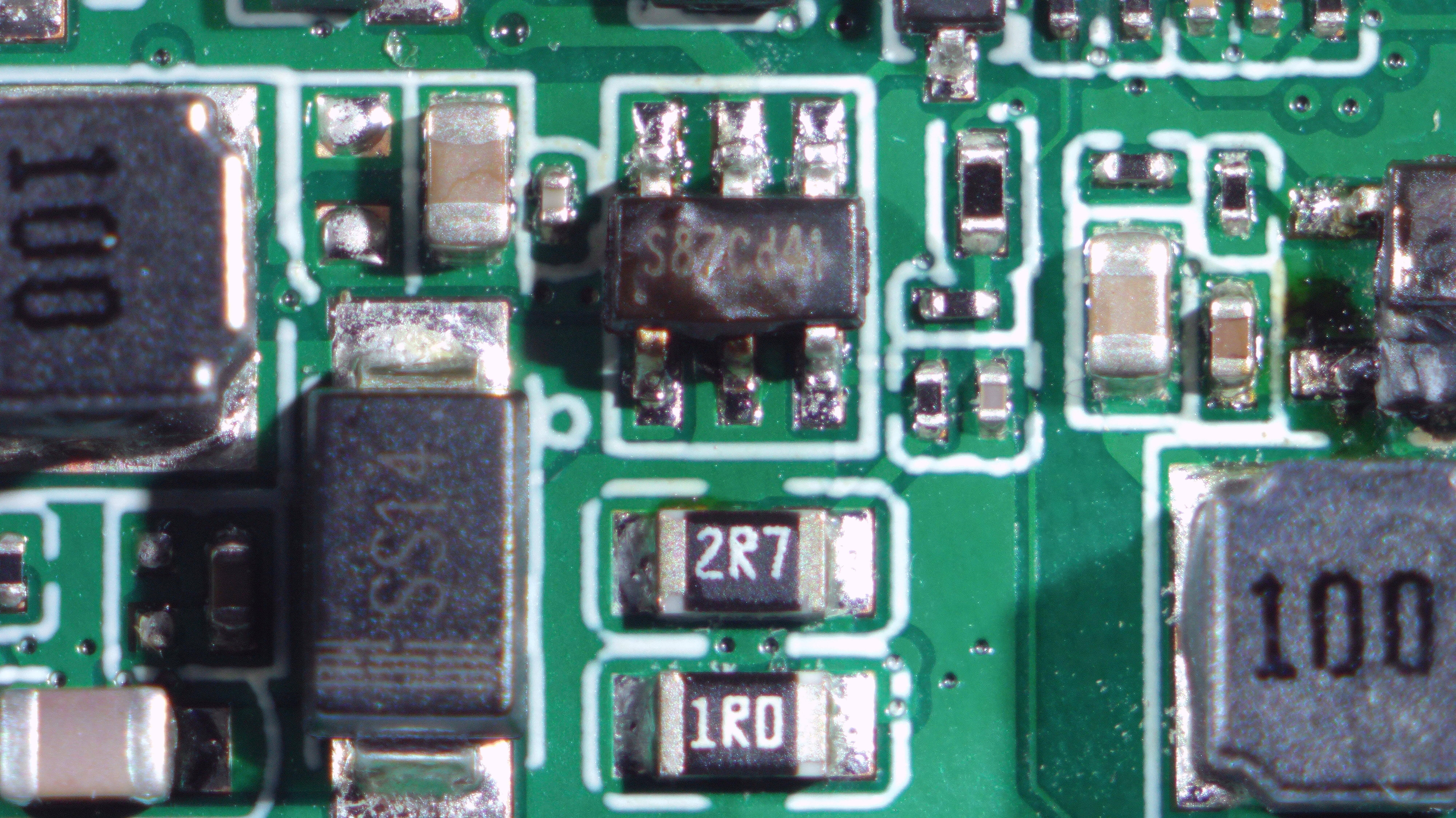

    Can anyone identify this two component?
    Marking : S87Cd41
    Click image for larger version  Name:	2024_0322_220118_001.jpg Views:	3 Size:	4.42 MB ID:	3240617
    Marking : B2F53S
    Click image for larger version  Name:	2024_0322_220413_002.jpg Views:	3 Size:	4.43 MB ID:	3240618

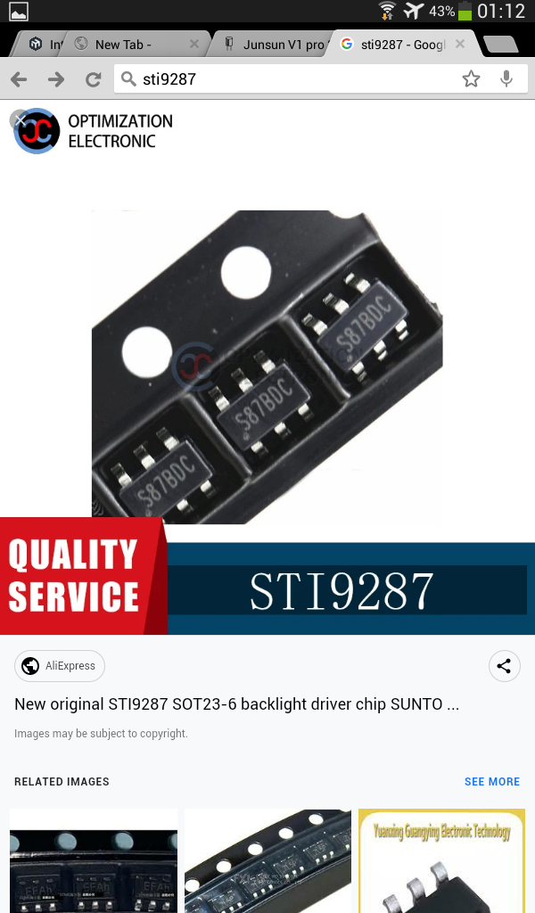

    S87 = STI9287
    https://datasheet.lcsc.com/lcsc/2009...87_C842664.pdf (datasheet)

      Maybe this, check pinout against datasheet

        Is B2F the Vdd supply for the SoC (CMS8S6990)?
        https://www.semiee.com/file2/b200ba7...9xx_V1.0.6.pdf

            For Member Harp and Trucglacier : it's the good component.
            The B2F: Not the VDD supply for the SoC CMS8S6990.
            For Member stj : The guy who brought me this GPS had wired it wrong. No shorted ceramic caps.

              I would be concerned as to whether Vin has punched through the ICs and clobbered the loads. To this end I would measure the resistance between Vout and ground, and between Vin and Vout.

                I removed the component B2F53S and the values are good between Vin and Vout and GND.
                As this component is not identified I cannot go any further with the repair.
                • truclacicr
                  • Apr 2019
                  • 327
                  • australia

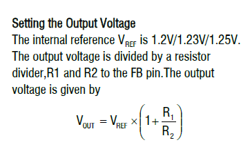

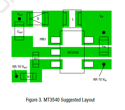

                  Can you determine the pinout?
                  It might also help to measure the feedback resistors, as this could tell us the FB reference voltage. Common examples are 0.6V and 0.8V.
                  It would also help to know which chips are powered by this IC, as that might tell us the output voltage.
                  Lastly, it might be worth identifying the manufacturers of other ICs, in case the designer used the same IC maker.

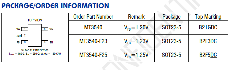

                    B2F5dc = MT3540-F25
                    https://www.lcsc.com/datasheet/lcsc_...25_C883495.pdf (datasheet)

                      Click image for larger version  Name:	2.jpg Views:	0 Size:	4.90 MB ID:	3241273 Click image for larger version  Name:	1.jpg Views:	0 Size:	4.23 MB ID:	3241272
                      Thank's truclacier for your comment, this help me.

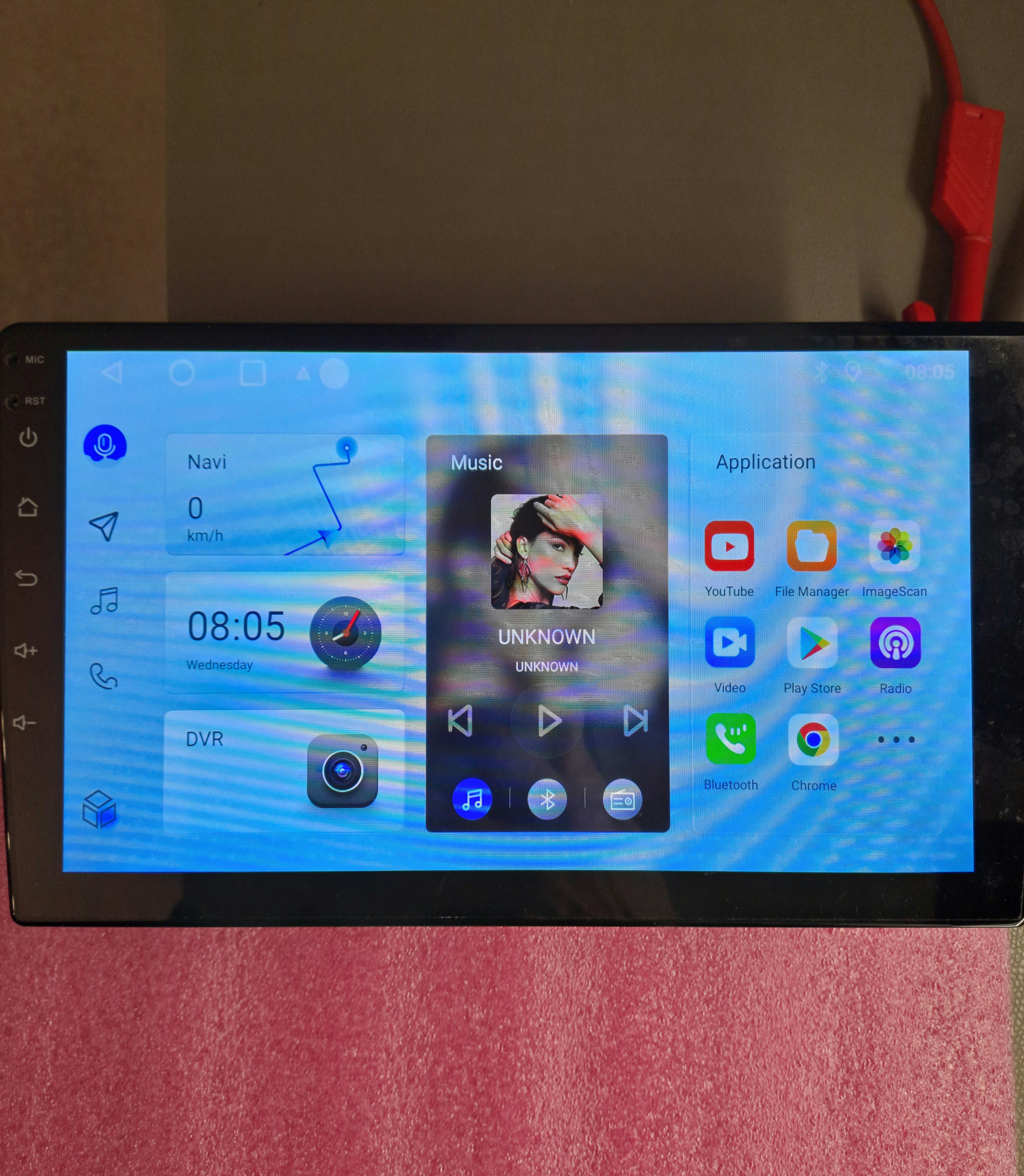

                        Hello, The car radio is repaired and work's fine, thanks to the members who took time to identify the components.
                        Click image for larger version  Name:	20240406_194259.jpg Views:	0 Size:	7.36 MB ID:	3248761
