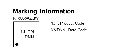

    Dear all
    someone please help me how to find the ic. for example 13 FG is RT8068A. on schematic and i need to substitute.
    i found one 13 ED. how do i find this datasheet!
  • mon2
    • Dec 2019
    • 14660
    From the datasheet:
    So YM = date code.
    Therefore, 13 ED = 13 FG
