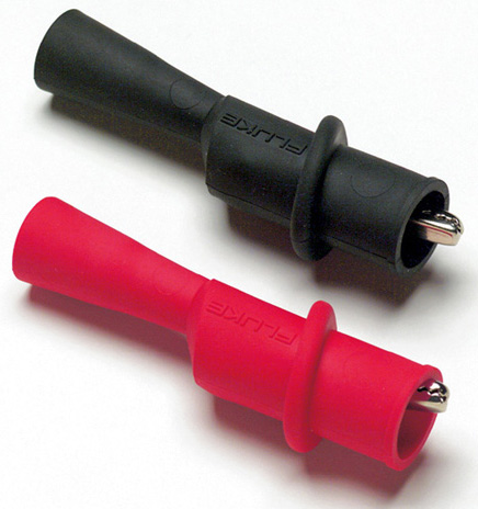

                    I'm using a fluke 289 and have the amp connected to an isolation transformer.
                    The Fluke 289 will easily survive those voltages safely. If your 289 came with some aligator clips, now is a good time to use them. Even if you can only use the black clip, then at least you can probe one handed (keep the other in the pocket) as redwire mentioned.
                    Make sure the clips have a good hold/grip before applying power. You don't want the clip to come flying out and causing a short.

                      I did buy the whole kit which included the alligator clips. I will definitely use them. Thanks.
