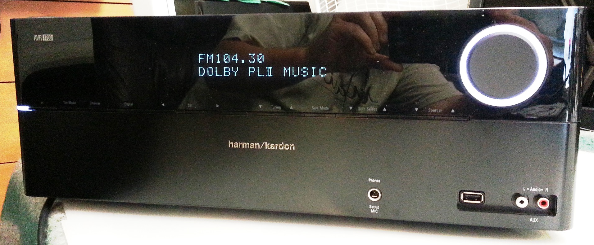

                            Re: Harman Kardon AVR1700 won't power up
                            Thank you for correcting me.
                            The original transistor's housing, it was all plastic.
                            Here is a picture with the unit running. Both are less then a year old.
