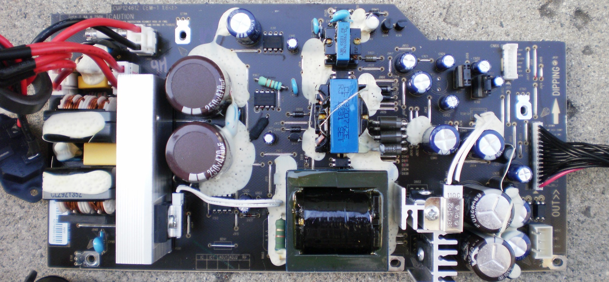

    I have picked up this receiver really cheap and I'm thinking to keep it if I'm able to repair it.
    The only thing happens is the power light turns on, nothing else. Display is completely black.
    I have done some measurements and found a missing +/- 45V, +/-12V, D+5V at the power supply.
    Here are all the voltages at the three connectors:

    Soon I will have some pictures too with the power board.
    First time I'm, working on an audio equipment, but I have some experience with LCD TVs and monitors.
    Any help would be appreciated.
    I have the PDF file for it, but it's to big for this forum.
    I will have to do something, to be able to put it here.

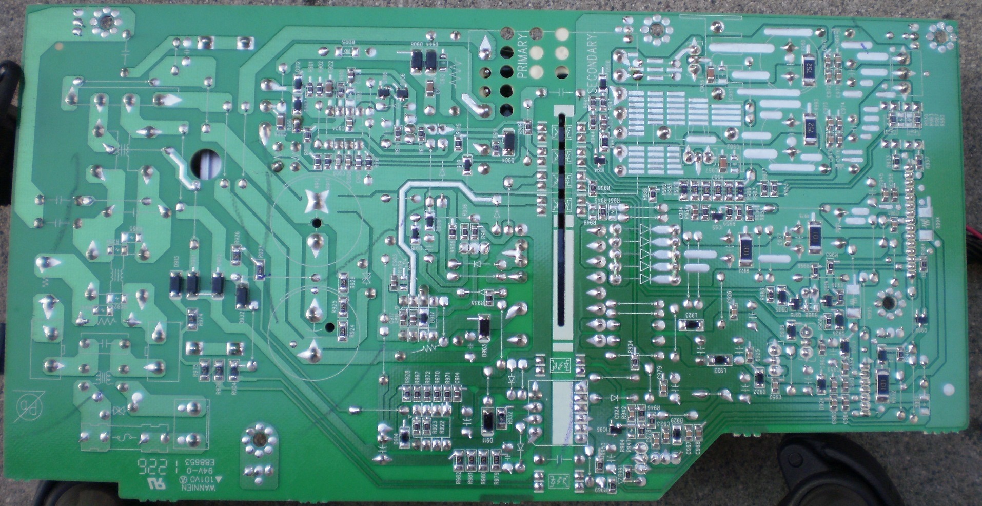

    Re: Harman Kardon AVR1700 won't power up
    Here are the pictures of the PS.
    For now, here is the link from elektrotanya:
    PS is page #96.
    It's not the best quality, but I don't know how to get a page out of a PDF file.
      Judging by those voltage readings, i'm thinking that only the stand-by section is working (as it would be, for as long as the receiver's plugged into the mains).
      Can you figure out where each of the voltages from CN66 are coming from? ie. from which transformer. ST+5V is definitely coming from the smallest transformer, but what about the rest?
      As a second step, you'll want to see where the PSU gets is "turn on" signal, and trace that back to its source.
      What brands are those capacitors?
        CN66 goes to the display PCB which is a pretty big board.
        It seems, that the voltages: ST+5V, +34V are coming from the smallest transformer.
        The +/-12V comes from the middle transformer.
        I think that the turn on signal is coming from the HDMI board. If I unplug that connector (BN65) it won't turn on.
        I'm not home right now, so I will check the capacitors when I get home.
        They don't seem bad, but I know that it's not enough to just look at them.
        Thanks for you help.
              Here is a PDF page of the PS.
                  I have done some measurement in the primary area and I have noticed that the PWM IC ICE2QS01 doesn't have any voltage at it's pins.
                  https://cdn.badcaps-static.com/pdfs/...482e511f29.pdf
                  This power supply should have 400V? The main filter caps are 250V.
