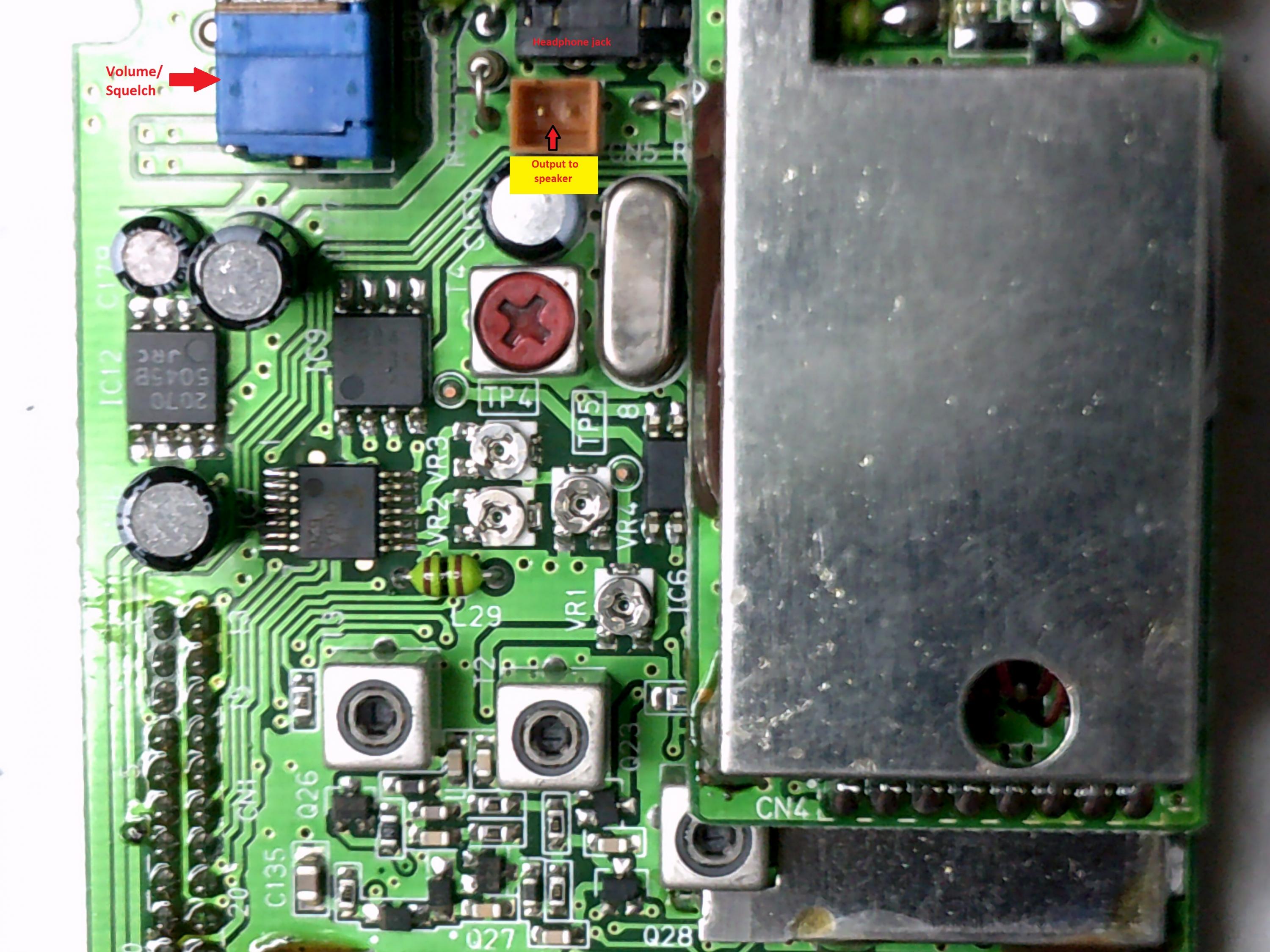

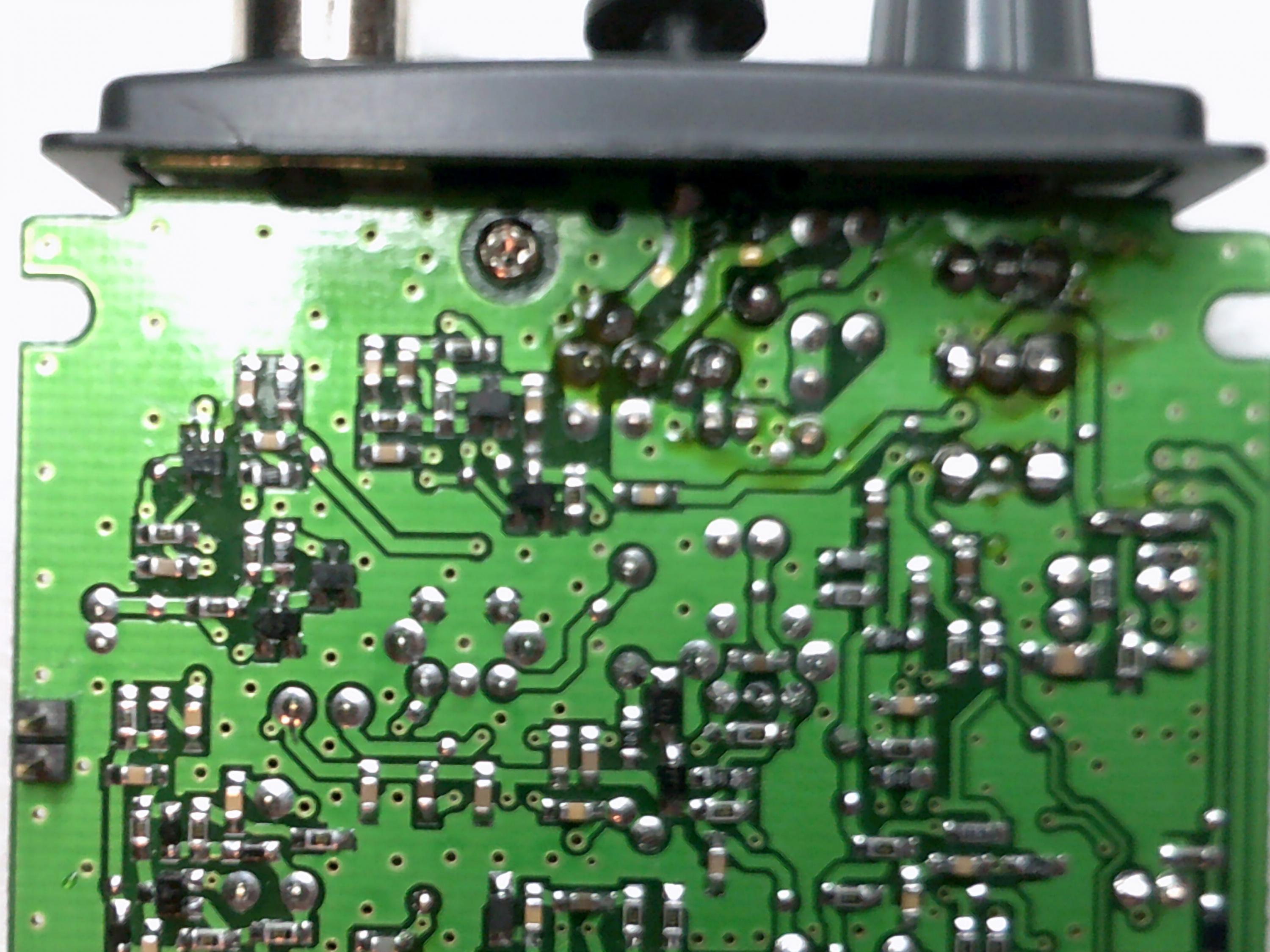

    This scanner volume does not work. I can hear the National weather frequencies(I use because it is always on) with my ear against the speaker but when I turn the volume knob up or down the volume doesnt change.
    I dont know where to start, the volume/squelch knob does not seem damaged and I don't know if/how it can be tested.
    I can hear a change in static sound from adjusting squelch(normal) so I assume that part of knob works.
    Any advice?

    I found this at radioreference.com
    Quote: There's a known issue with the volume pots on these things going bad. Mine did the same thing right at the one month mark. Question: if you put the speaker right up to your ear can you hear squelch rushing very very faintly as you turn the knob?
    Looking at the schematic, there are a few components between the discriminator output and the audio amp. The beep signal is inserted AFTER the volume pot. I agree and think the volume pot is VERY LIKELY the problem.
    I found the part number
    12429163 from RSU(radioshack unlimited)
    It is $16 if it is still avail.
    I wouldn't mind an alternative. From what I read it is 50kohm volume and 10kohm squelch.

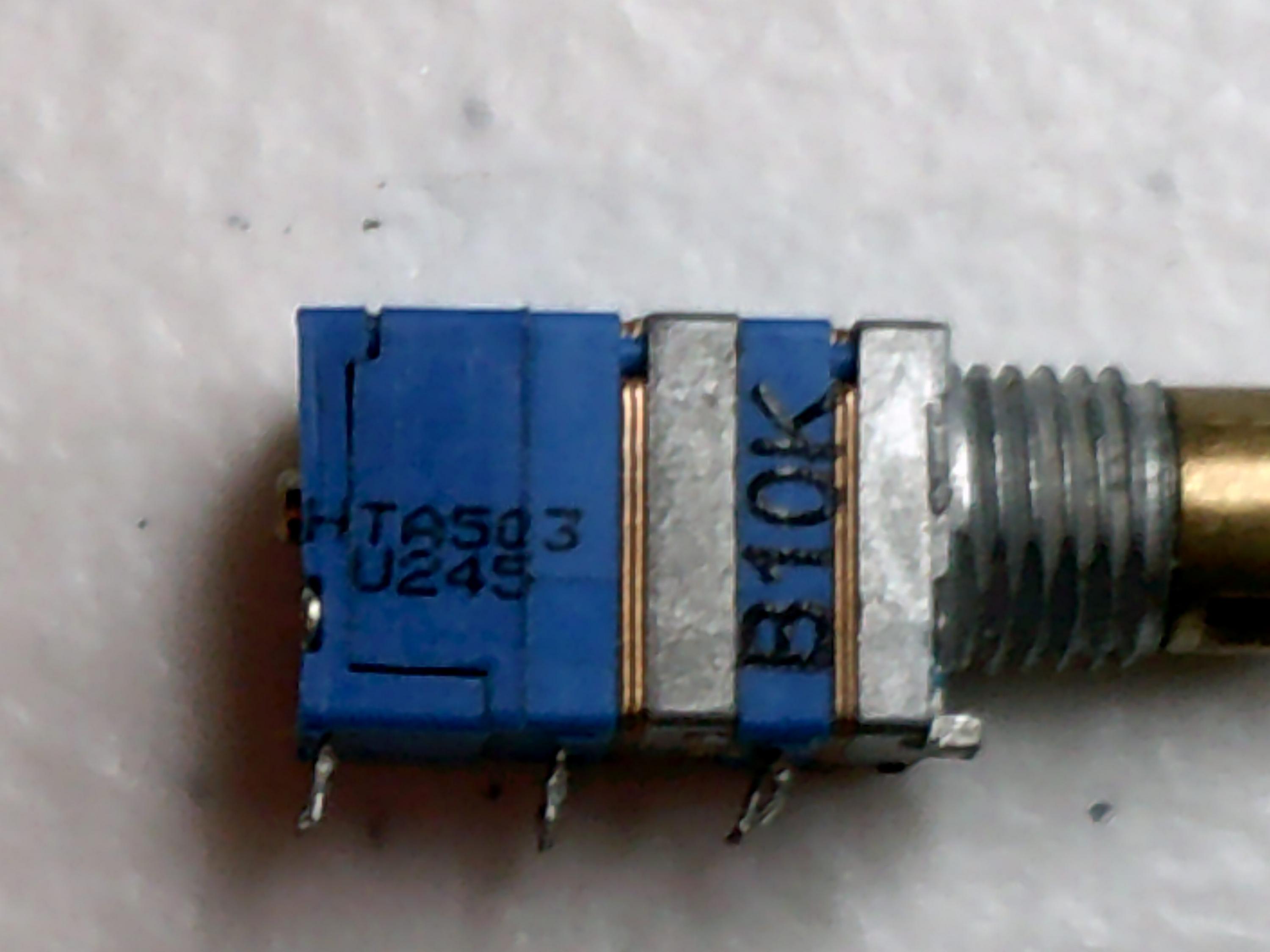

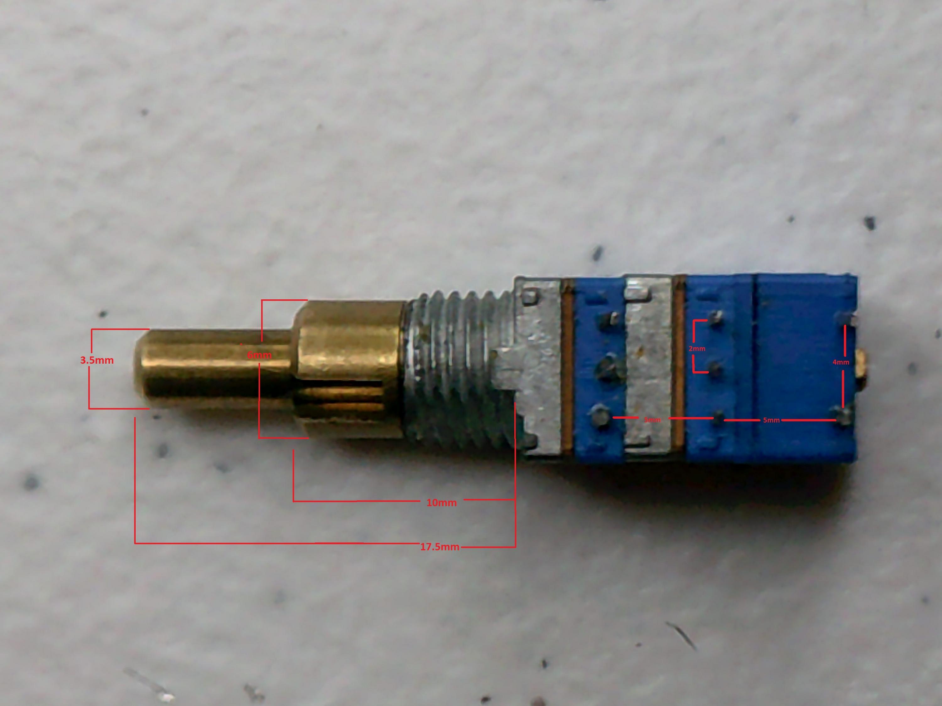

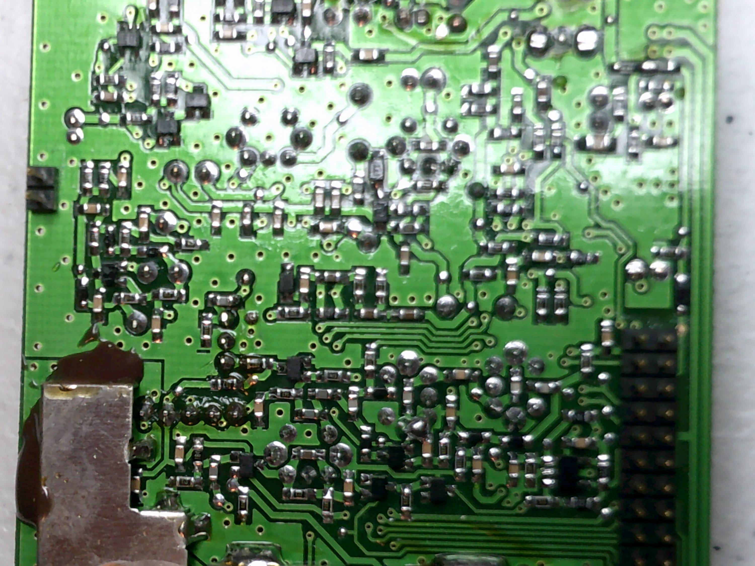

      I pulled the pot and volume side tested bad.
      Im not sure if I can match up a replacement.
      pot # HTA503
      U245
      B10K
      I took measurments the best I could and posted on pic.

        I decided not to fix after finding out analog scanners will be obsolete soon with the digital switch. Plus the part is out of stock.

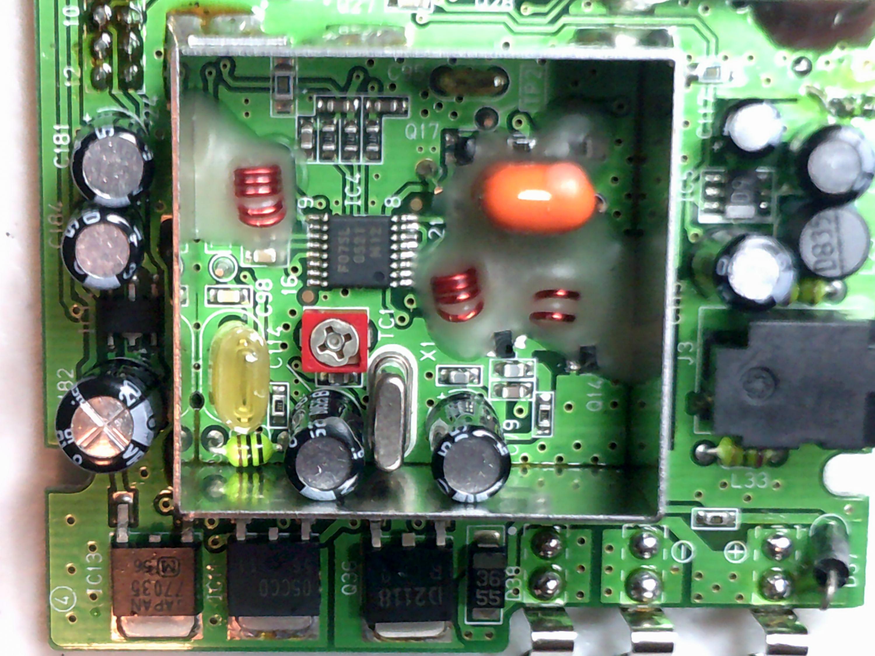

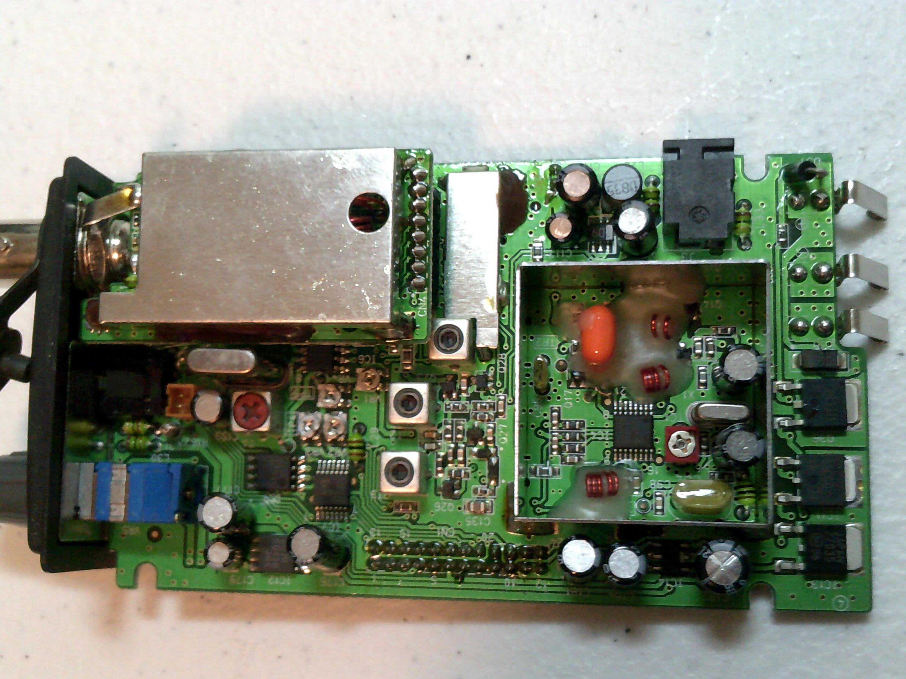

            Please note that you also have at least one bad capacitor on the board (first picture, lower right corner)
