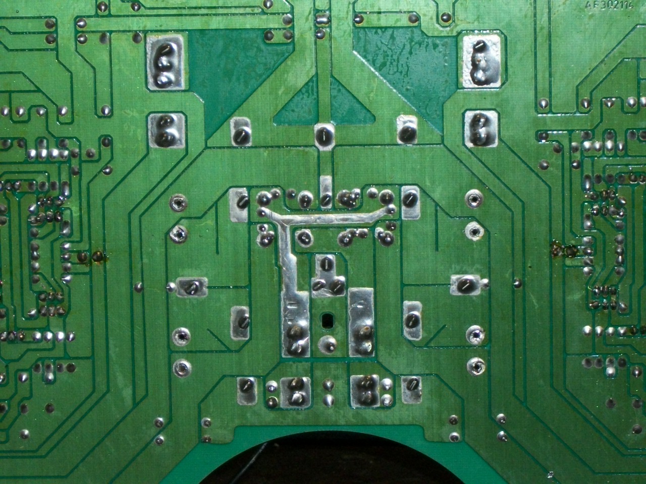

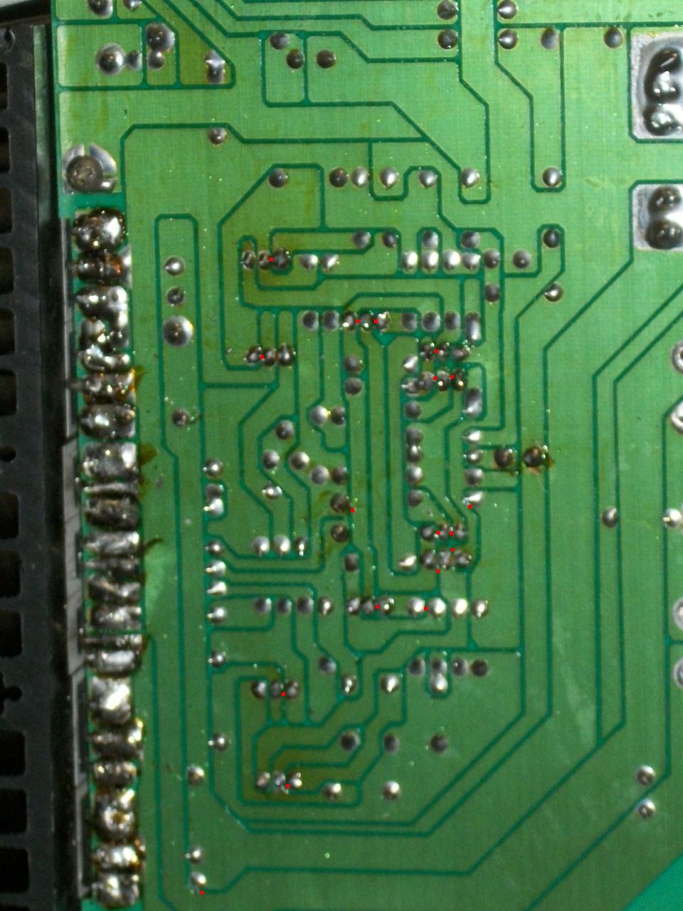

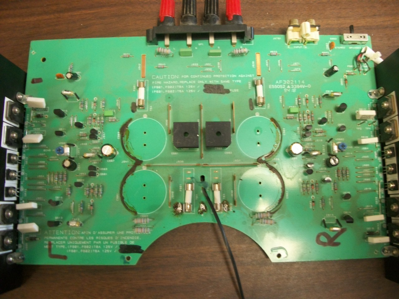

    I am trying to repair an amplifier that keeps blowing the mains fuses, So far i have identified 7 Bad main transistors and 10 Bad audio power transistors, the really confusing part is that it blows both side fuses and they seem independent of each other, so I am having a hard time determining what they share and I am starting with the main caps. They are Rotel 8200uF 50VDC, I do not own an esr meter yet so I pulled them out of the loop, all have tested the same, but I'm not sure good or bad, I set my ohm meter to 20K ohms and it starts out low and rises to 1980 or so and then goes to OPEN, So I tried 200K and get the exact same results, almost to 20 then OPEN CIRCUIT, IS This NORMAL? I know it is a rookie question, but I'm a rookie so it's okay, If this is normal My nest step is to check the two bridge rectifiers, I checked them in circuit and they seem fine, Did not pull them out to check, BTW Since I found bad main and audio transistors I have replaced them all. Any advice or help is very much appreciated, Thank you

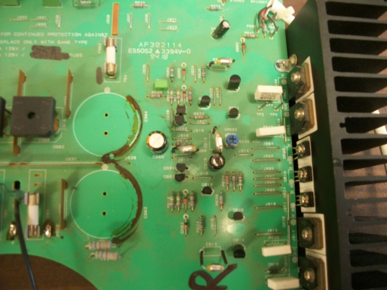

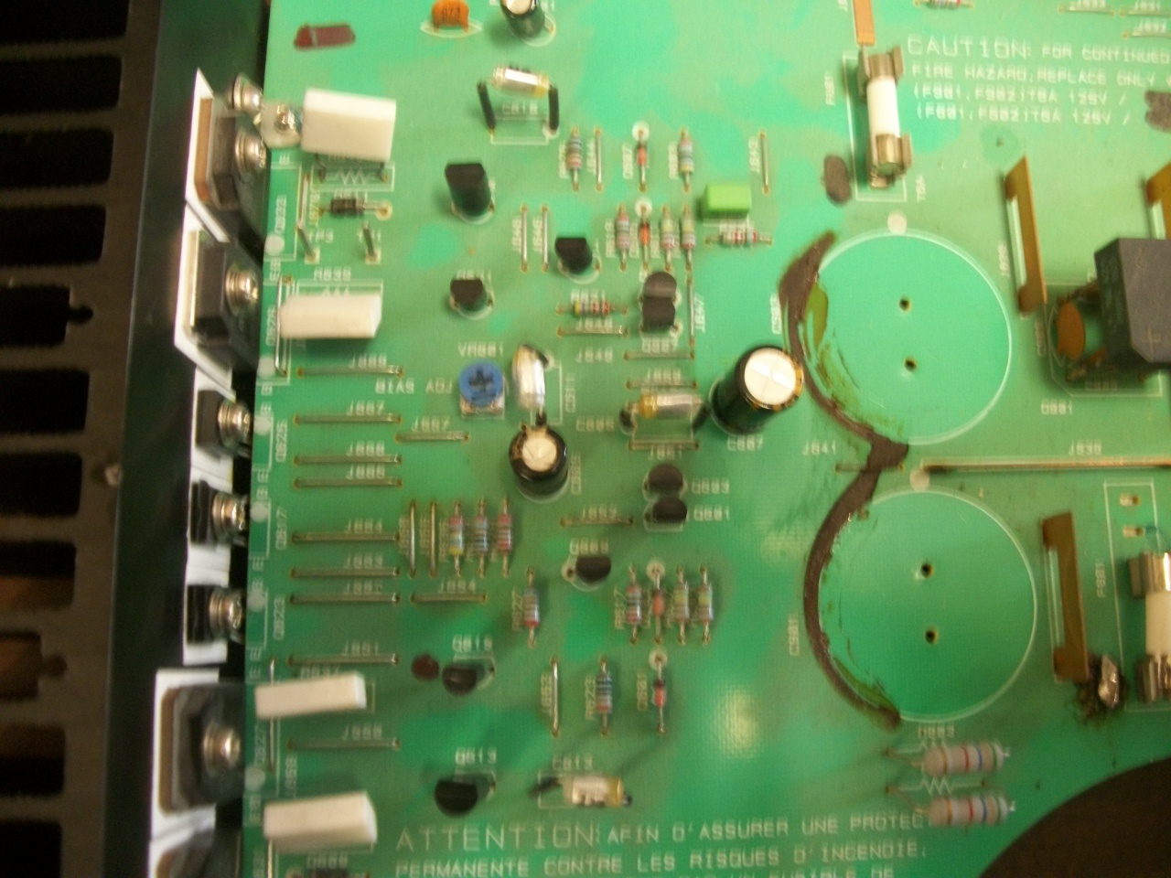

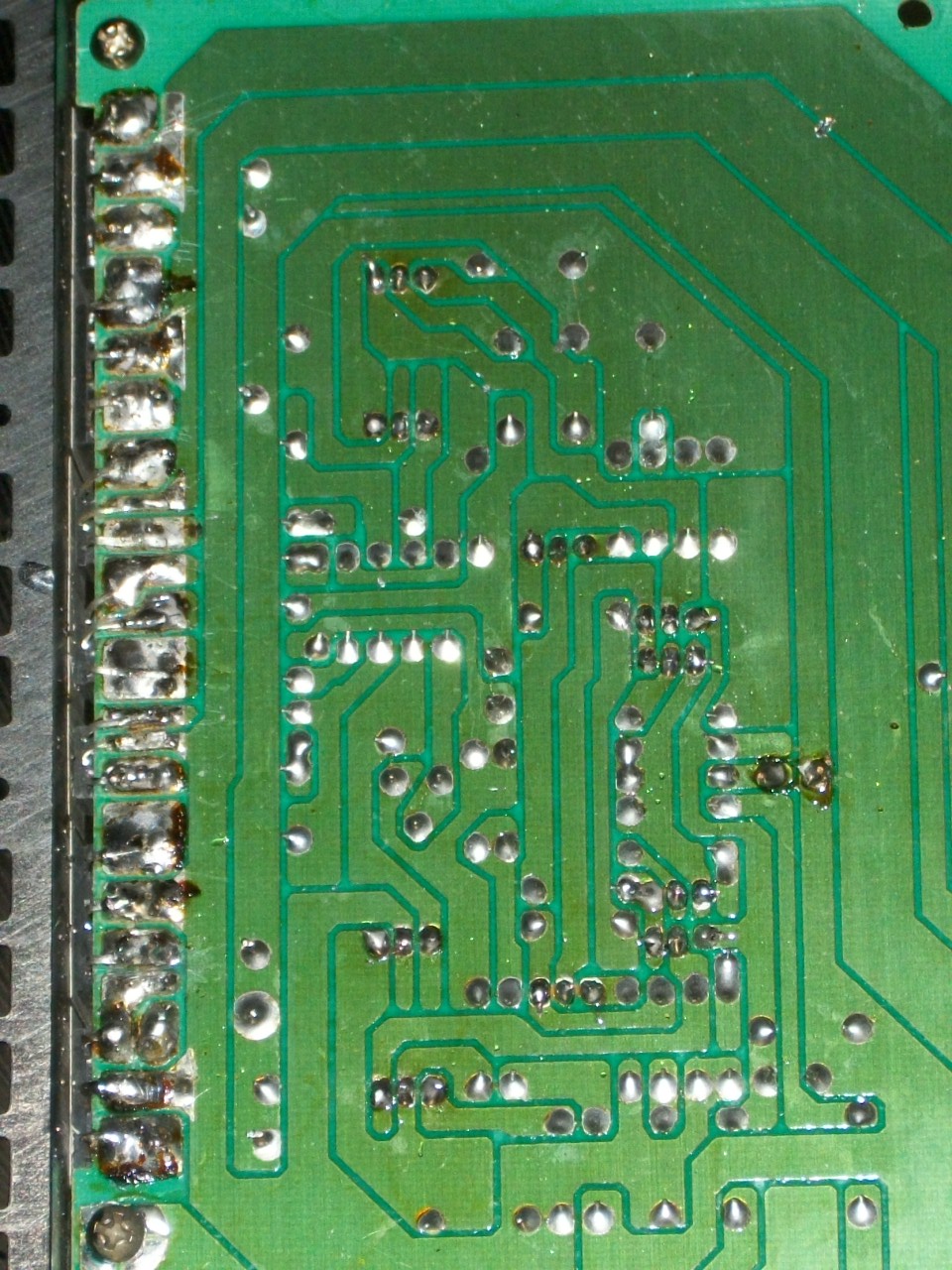

      can you post a pic of the back of the board - are the brown semicircles old
      glue or have the caps leaked. There are 4 fuses does it blow all 4?
      If you have replaced the transistors were you sure to use isolated ones to replace isolated ones?

            Yes all are isolated from the heat sink if that is what you mean selldoor, also yes it is old glue, I should have mentioned that, sorry. and it only blows the two mains not the output fuses. and I don't know what a bipolar transformer is, and I cannot measure the voltages on the caps in circuit before the fuse blows immediately. would you like a picture of the back of the board still?

                        In the middle pic on the last block of three top right looks like a blob of solder? is it and has it bridged the two traces?
                        Seem to have been a bit generous with the solder,have you checked the transistor legs for shorts?

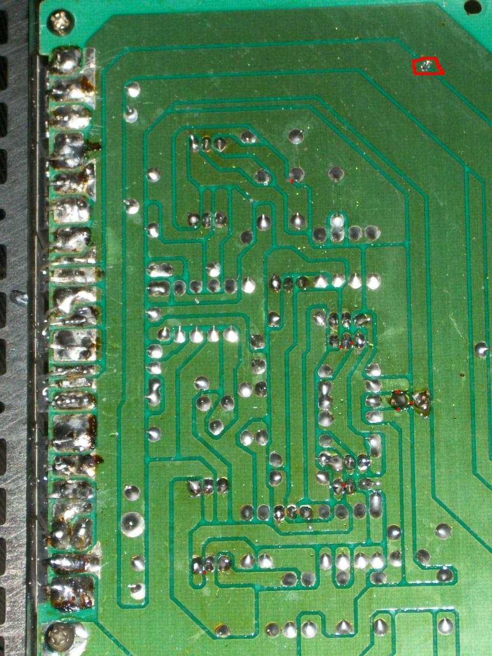

                                  "My horse sense tell me if the fuse blew it was to save the stuff downstream"
                                  Tends not to work like that - fuse is to prevent faulty machine from damaging mains wiring.
                                  Whilst you said you had checked for shorts but now may not be so sure perhaps you can have a look at the joints I have marked on your three pics.

                                      thanks selldoor, Ill have a close look.
