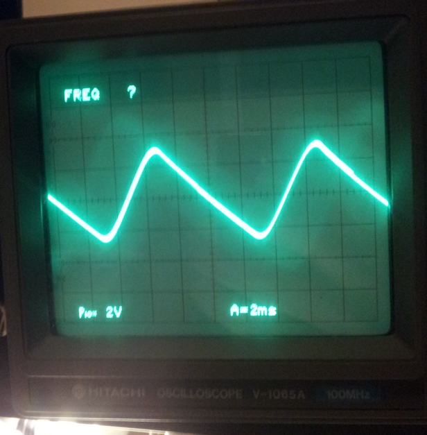

    I'm troubleshooting this onkyo surround reciever. It's old, but high quality. (Integra A-SV810Pro)
    The problem is bad contact in the main speaker protection relay.
    My first thought was to replace the relay. However, I measured the ripple on its' coil voltage to be about 5V, which seems quite a lot on a 12V line.
    What to you think? Is this a normal amount of ripple of this application, or should I investigate the PSU board? (the reason I'm asking is: I'll have to disassemble the whole chassis and probably even cut a few wires to get to the PSU board. This amp is not service friendly at all)

    FIVE volts?!?!
    In other words the voltage is oscillating between 7 and 17V?
    That doesn't sound normal at all.

      I believe it would mean 5VAC on a 12VDC line.

        >>However, I measured the ripple on its' coil voltage to be about 5V...<<
        Measured how? With what? Meter? Scope?

          Re: Onkyo reciever, exessive ripple on +12V? how much is acceptable?
          I measured the ripple with a scope.
          I've attached a picture of the readout.
          It is not on the +50 or -50 lines though. This amp also has +12, -12 and +5, and this was measured at the positive side of the coil in the speaker protection relay (schematic page 2, part RL601).
          As a start, I had a look at the board called DC Power supply (schematic page 3), and replaced a bunch of 10uF Sanyo caps that had an ESR of about 3-6. Put in new parts measuring about 1.5. All the major capacitors seem fine, at least when I measure their ESR in-circuit.
          The result is... no sound. I must have broken something on the way. I'll post back with more information when I've made some more measurements.
