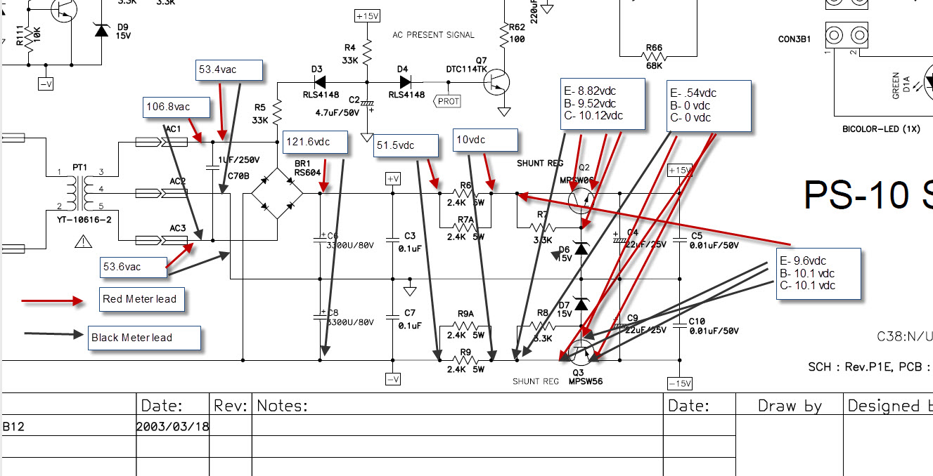

                      #170
                      Re: Infinity PS-12 Powered Subwoofer Fired Amplifier
                      BudM,
                      Sorry for the delay - Busy at work
                      Voltage from transformer -
                      AC1-AC2 -53.4vac
                      AC3-AC2 -53.6vac
                      AC1-AC3 -106.8vac
                      After Bridge - 121.6v DC
                      voltage to (R6-&A) and (R9& R9) 51.5v after 10v
                      For Transistor MPSW06 (NPN) - which meter neg to GND( Neg side of rectifier bridge)
                      E- 8.82vdc
                      B- 9.52vdc
                      C- 10.12vdc
                      For Transistor MPSW56 (NPN) - which meter neg to GND( Neg side of rectifier bridge)
                      E- .54vdc
                      B- 0 vdc
                      C- 0 vdc
                      If it put positive meter lead to the (+) on the bridge
                      E- 9.6vdc
                      B- 10.1 vdc
                      C- 10.1 vdc
                      C4 and C9 are both brand new

                        I see why your Voltage readings are not right, the Negative of the bridge is for -50V power supply with ref, to circuit GND, the + of the bridge is for the +50V power supply with ref. to chassis GND. You use the wrong GND ref. for the Voltage testing.
                        May I ask if you know how to read schematic? If you know how to read schematic then you will know where the circuit GND is.

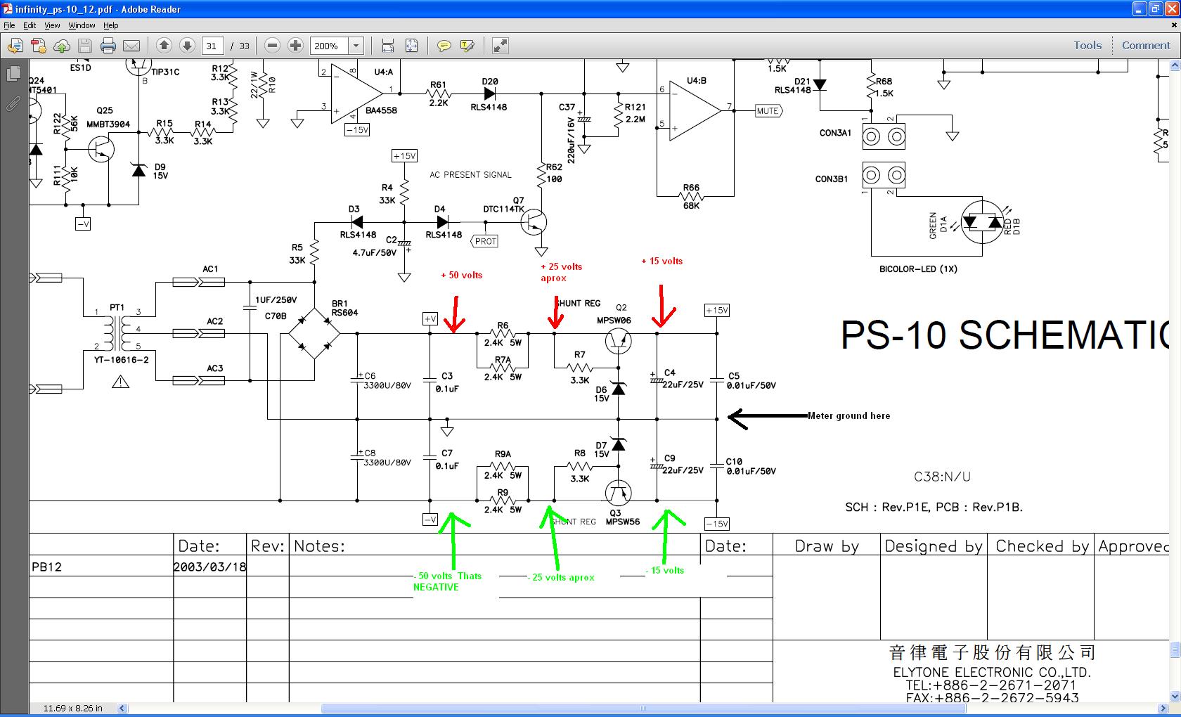

                          #172
                          BudM,
                          Thank you for taking to time to stick with me. Based on your comment i guess I am incorrectly testing the component(s) - I have attached how i have been testing. Can you please enlighten me to the correct point for GND ref and i will be more than happy to supply the data to help get this working
                          The second image after looking at the schematic again - I green circled the GND ref- is this correct?
                            #173
                            That Triangle symbol (center tap of the power transformer) that you circle in green is the circuit GND, the amplifier runs on +/- power supplies (+50V, -50V) that are ref to circuit GND.
                            You AC for each half of the transformer shows 53.4VAC, the the DC Voltage as measured on each main filter caps C6, C8 with ref to circuit GND should be = 53.4VAC *1.414 =about 75VDC, the caps are rated at 80VDC so are you 100% that you are getting 53.4VAC as shown in your diagram?

                              #174
                              Budm,
                              Well I re-measured the voltage at the C6 and C8 caps with ref to the circuit GND- on C6 I had 50.8VDC and on C8 I had 70.8VDC.
                              So for the hell of it - I reinstalled the original Caps ( replaced both due to one was slightly bulging) and rechecked - now both Caps are at approx 71vdc.
                              For Transistor MPSW06 (NPN) - which meter neg to ref GND
                              E- 11.46vdc
                              B- 12.02vdc
                              C- 13.0vdc
                              For Transistor MPSW56 (NPN) - which meter neg to ref GND
                              E- .74vdc
                              B- .20 vdc
                              C- .20 vdc
                              I wonder if the defective Caps I bought did further damage to other components
                              • R_J
                                • Jun 2012
                                • 9625
                                #175
                                When you measure the voltage on the caps was the voltage on C8 -70.8 volts (negative voltage)
                                It seems like you have open R9 & R9a
                                The likely reason the voltage you measured was high is because the resistors are open and with no current flowing the cap charged up to peak voltage.
