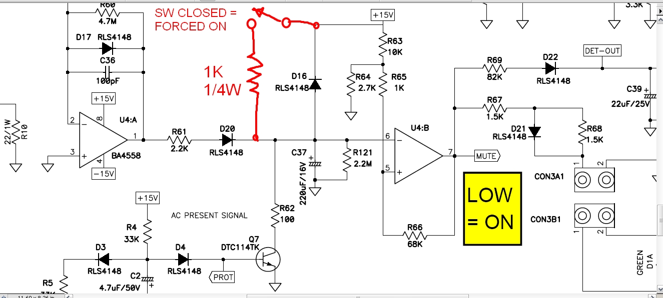

    Re: Infinity PS-12 Powered Subwoofer Fired Amplifier
    Originally posted by budm
    The time constant of C37/R121 determine how long the amp will stay on AFTERr the audio signal is no longer present, the larger the cap the longer it will stay on, the schematic shows 220uF, you can try 470uF for longer ON time.
    YAY! Budm is here.
    Do you have any idea why the volume would be lower than original considering we changed a few components (that we believe are equivalent) and used metal film caps (just for the bypass caps)?
    Last edited by jiari; 05-24-2018, 02:15 PM. Reason: clarity on where Metal Film caps were used.

              #146
              Originally posted by jiari
              You can also just completely bypass the auto sense circuit if you want (though not preferred). We should see if we find any other problems first.
              I can post a picture of how to do it if you want to go that route. It seems that the signal reaching the sensing circuit is too low.
              Please, can post a picture? or explain?
                #147
                FORCED ON circuit.
                • sachs
                  • May 2015
                  • 5
                  • Brazil
                  #148
                  [QUOTE=FORCED ON circuit.[/QUOTE]
                  Thank you. The sound of my PS410 is very good, no flaws and the only flaw is that the relay turns on and off in long dialogue movies. Any tips?
                  • jiari
                    • Apr 2018
                    • 23
                    #149
                    You do realize that the PS410's auto on/off circuit turns off after ~10 minutes of no signal. Dialogue should be going through your centers and I doubt your sub gets any signal during that time. The behavior you are describing sounds normal.
                    As Budm noted, you could change a capacitor so that the sub stays on longer after receiving a signal.
                    https://www.badcaps.net/forum/showpo...&postcount=140

                        #151
                        You need to check or replace C37.
