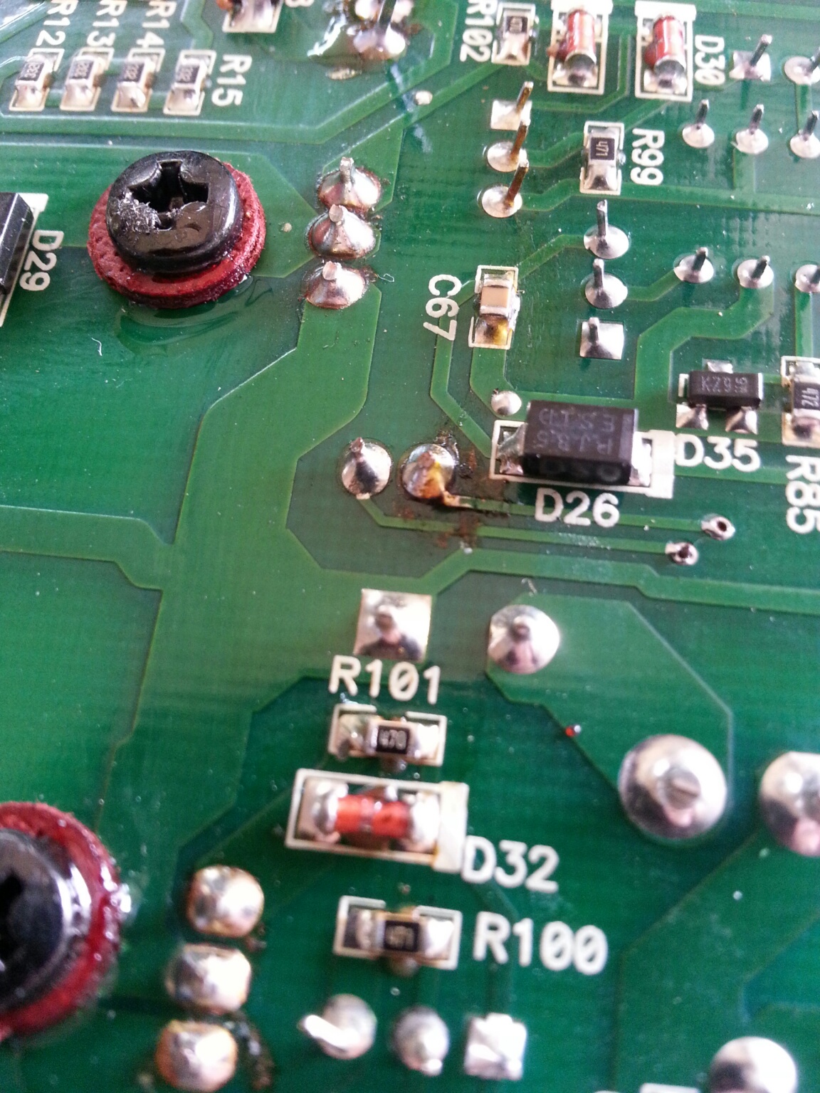

          Re: Infinity PS-12 Powered Subwoofer Fired Amplifier
          I have the same problem with the capacitor but my circuit board has burned much worse than the first posts. Is there just the one capacitor or is there a very small resistor or cap on the bottom of the circuit board next to where the faulty cap is connected? Also can anyone give a link of where to find the capacitor needed, the link in an earlier post doesn't come up with the same specs.
            ^ See the picture linked originally, and below, there is nothing directly under the capacitor but between the solder pads for it and the outermost screw securing the heatsink, there are a pair of diodes and resistors on the back of the board.
            Also moving away from the heatsink, left in the picture towards the edge of the board, there's one cap, then an inductor, then a 2nd cap on top of the board. That second cap does have a chips capacitor on the back of the board situated between it and the inductor.
              Okay thanks, just making sure there isn't anything else like one of those small diodes or resistors located where the burn is, I guess the board just shorted there then?

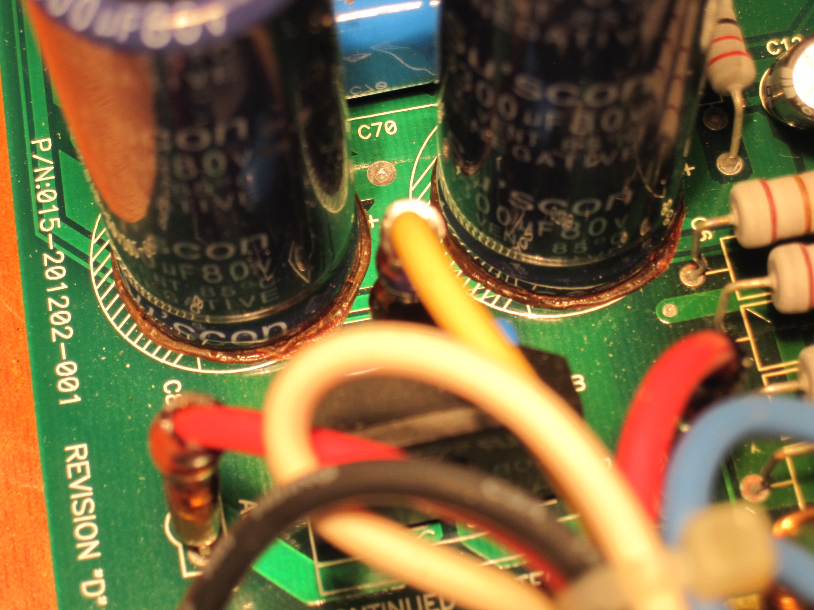

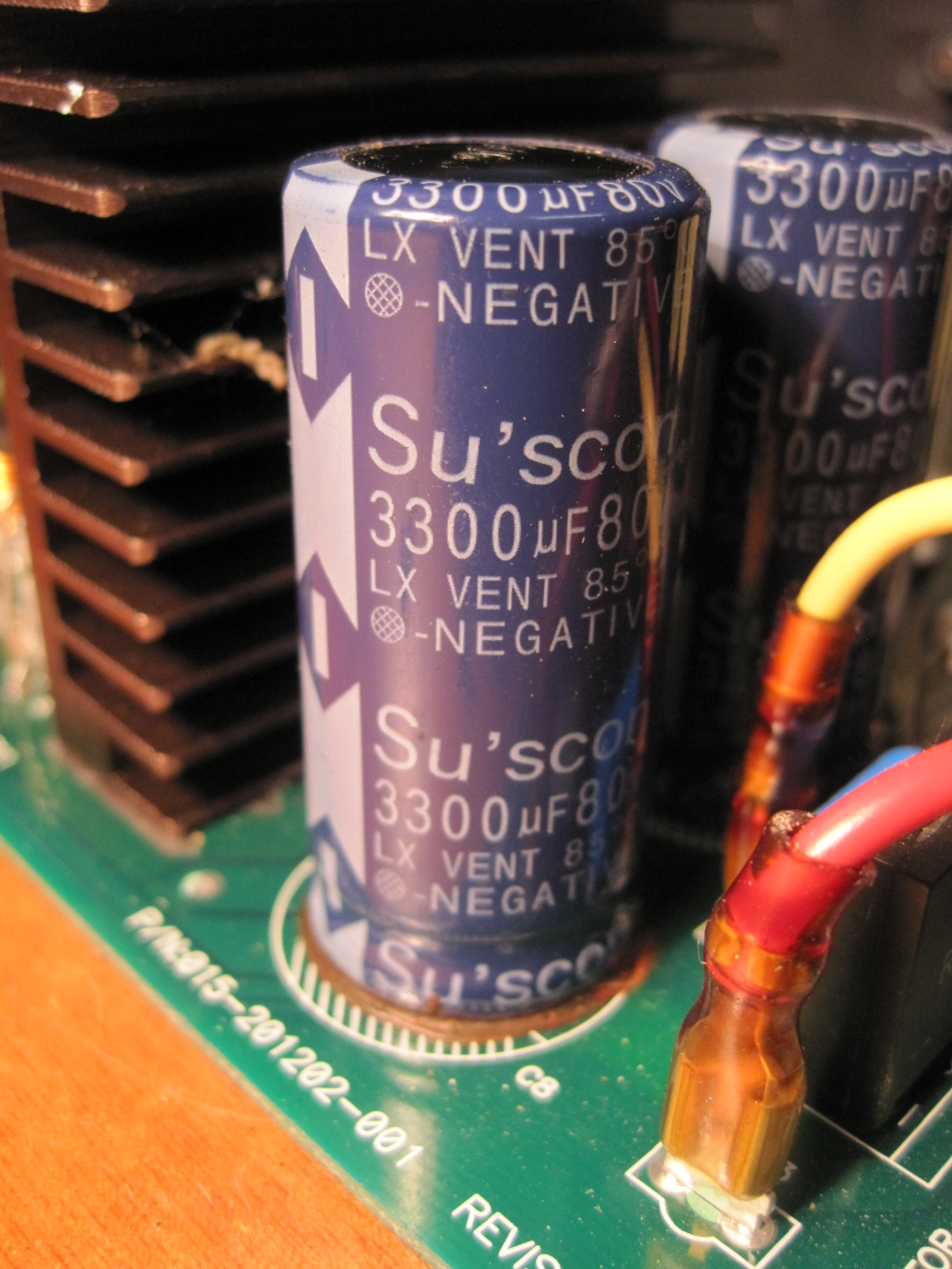

                            #33
                            Working on mine at the moment PS10.
                            Are these Caps considered leaking or would this be adhesive to secure them? This way if it is adhesive i'll leave it be and check with esr.
                            That TH1 thermistor seems to have become a lil extra warm..
                            can someone direct me to a part # for replacement and new pad , As I've tried to cross ref the part number on digi key andd mouser but couldnt locate.
                            TIA

                              #34
                              TIA
                              Wow the factory did a terrible job of cleaning that PCB, though I've also seen a lot worse.
                              The substance under the capacitors is just an adhesive to keep them from vibrating around and wearing the seal and leads. They look fine, though if you ever were to replace them it might be good to apply some adhesive yourself.
                              It appears that it wasn't the thermistor that got hot per se, rather the heatsink and the potting material or whatever it was degraded due to being a bad formulation or something. I wouldn't worry about that too much, would just lather some fresh heatsink grease on the thermistor and put the clamp back on unless it completely crumbles away when trying to attach it. If that happens you could just bend the metal portion of the mounting clip a bit so it holds the thermistor against the heatsink without the black material and put a bigger glob of heatsink grease on it, or maybe a dab of silicone caulking between the clip and thermistor.
                              What is unclear is whether yours has any symptoms of malfunction, or is this just an inspection type servicing?

                                #35
                                In your third picture, it looks like that capacitor on the bottom right is slightly bulging.
                                Yes, those big capacitors are held down with some extra glue.
                                That thermistor, it's hard to say what happened.
                                I don't see any smoke marks around it, so I guess it was the same thing 999999999 said.
                                BUT, the crumbly stuff around it could be conductive .. some glues do that when they get old!

                                    #37
                                    The board uses bad brown glue, you need to remove them since they become conductive and also corrosive. The thermistor is part of the output stage bias circuit to protect it from thermal runaway, you can mount it back in place but you have to make sure it make contact with the heatsink since it is for sensing the temperature of the heat sink which the output transistors are mounted on, I use heat sink compound on it. When the temperature goes up, the resistance goes down to reduce the bias current through the output transistors.
