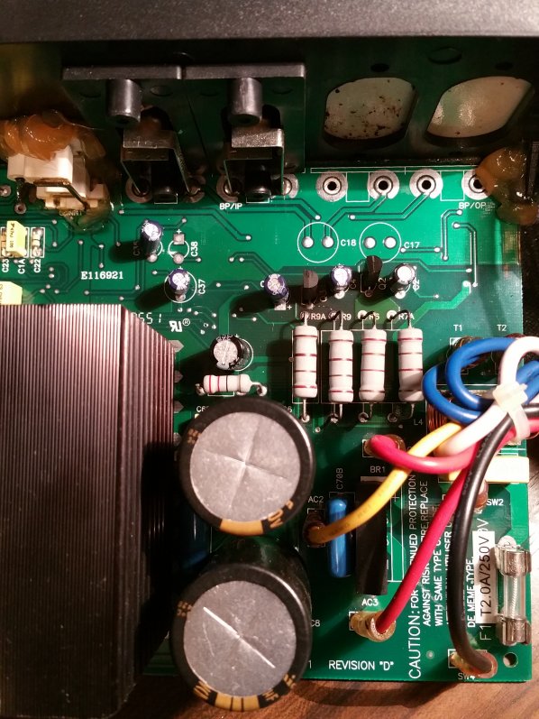

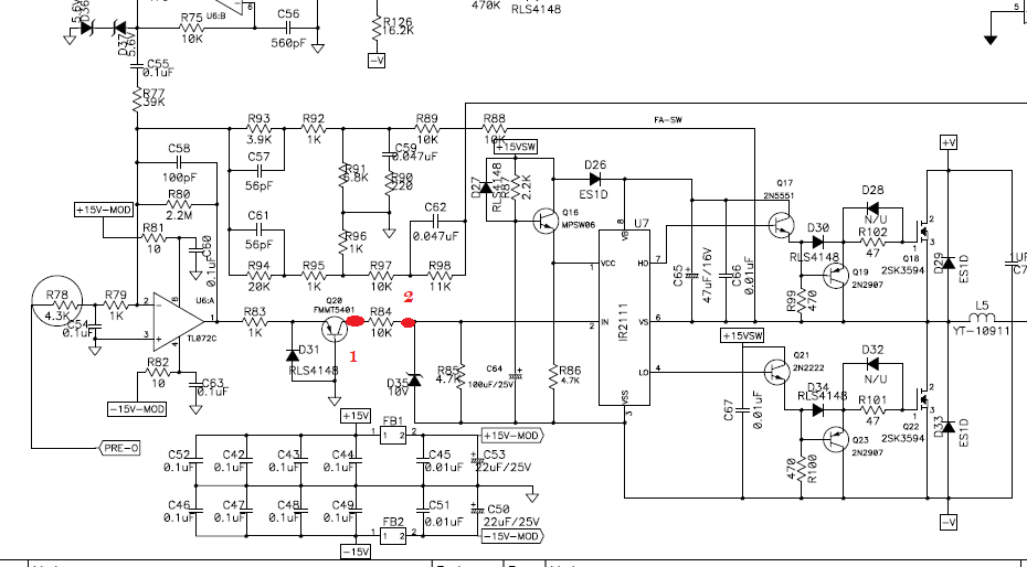

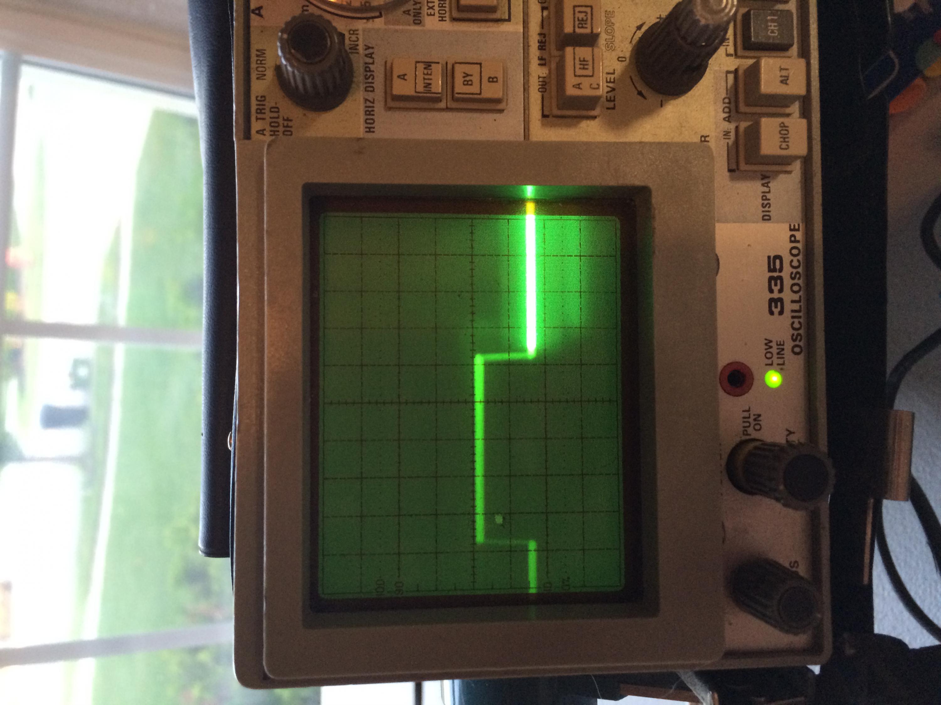

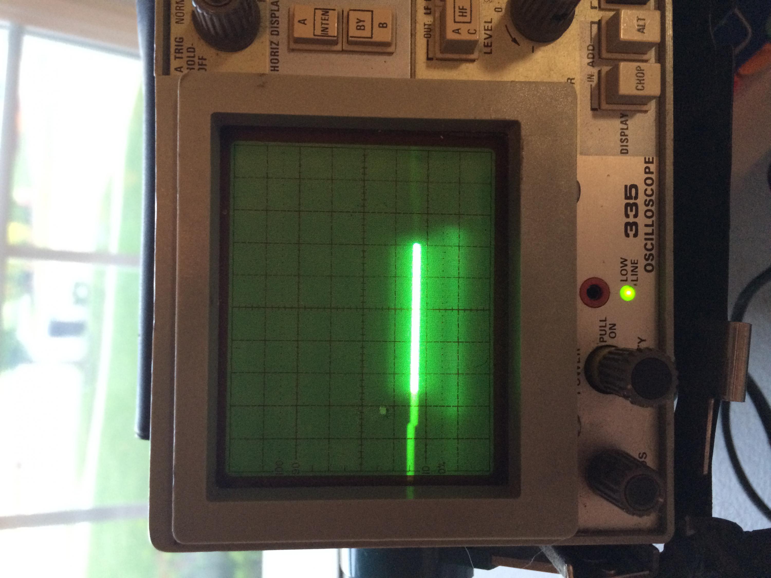

                                      #78
                                      Re: Infinity PS-12 Powered Subwoofer Fired Amplifier
                                      Hi All,
                                      I hope you can help! I have a PS210 (Service Manual Attached) which will not produce any sound. The power supplies look good, and I have been applying a signal to the Amp, and following it with an O-Scope. Here is where Im at so far:
                                      The signal looks good on side 1 of R84, then is pulled low on the other side side 2. Scope images attached. I dont think the signal should be Low on side 2 of R84 should it? what should I do next?
                                      I am a DIY-er, but am new to electronics and repair, Help is much appreciated!!!

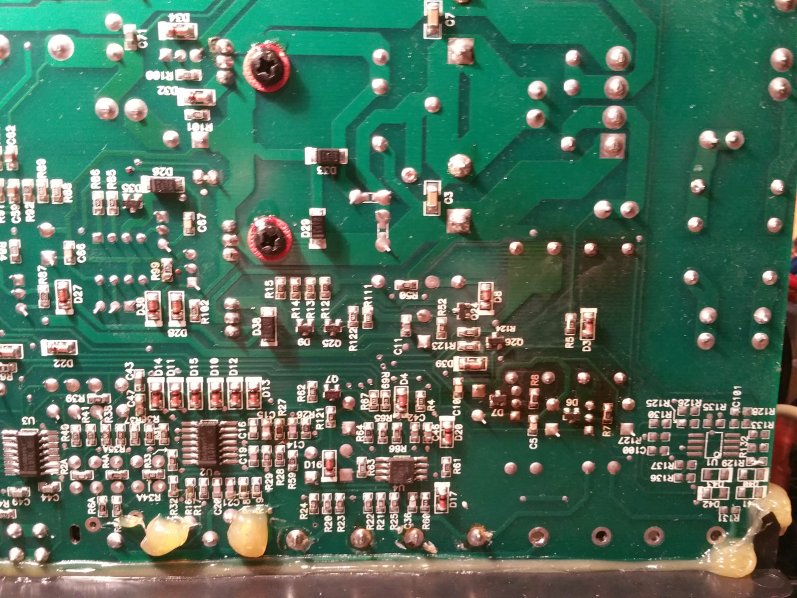

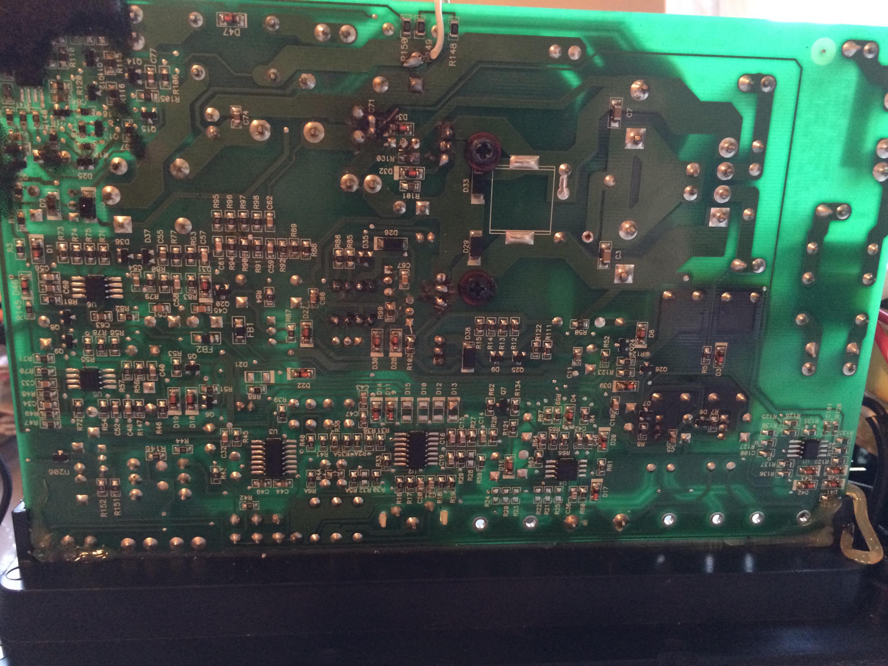

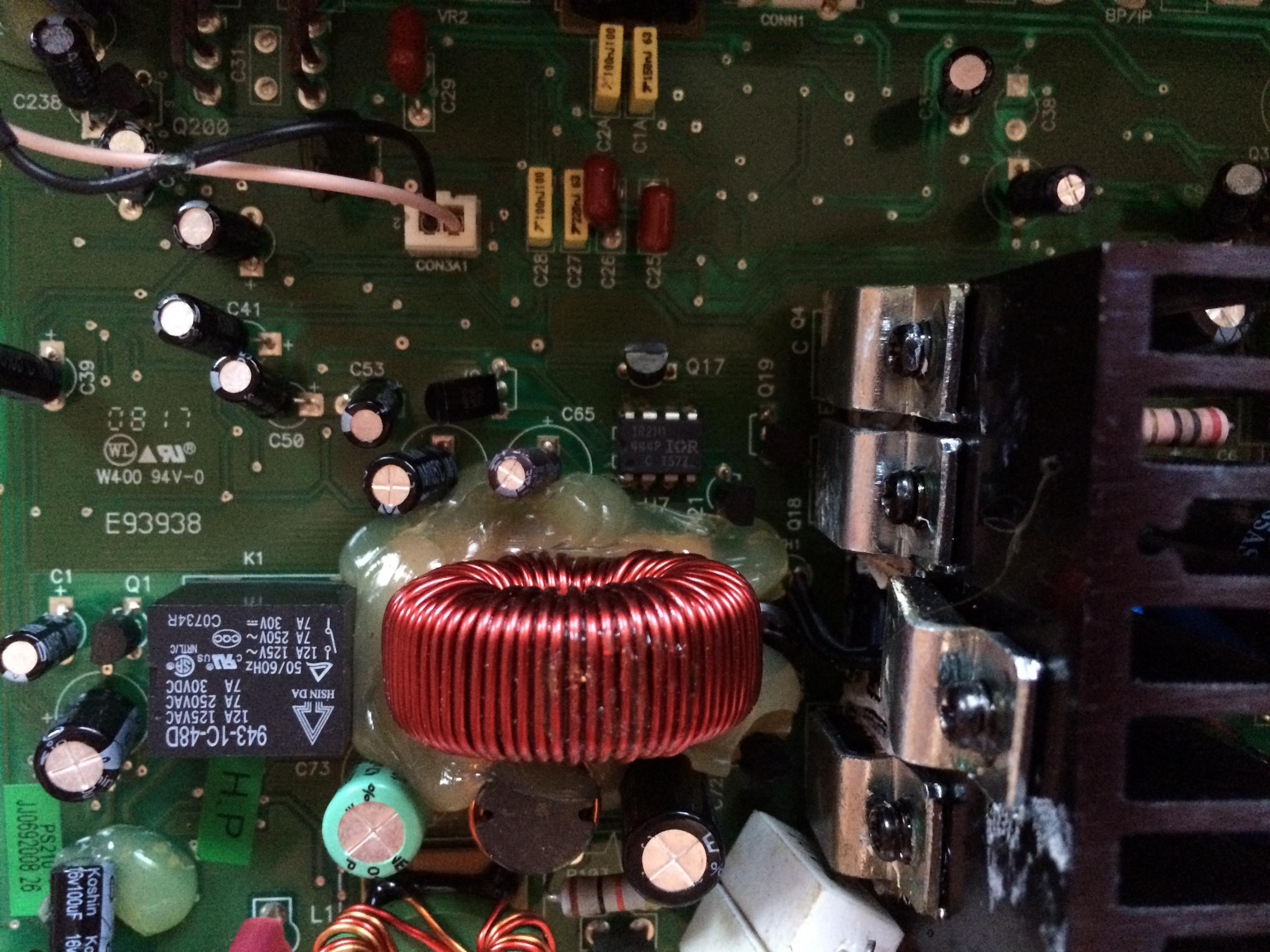

                                        I also have a PS12 which had died a while back. Started off making popping noises on occasion then quit. When I first opened it up I immediately noticed that the C6 cap (3300uF) had a bulging top. (black plastic but definitely pushed up) I made an assumption that was the problem and ordered two new caps. Got them in and swapped them out. When I moved the cap that was bulging back and forth I could feel something inside moving around, definitely not normal so I figured that was the problem. However when I installed the new caps it still didn't work. That's when I searched the net and found this thread! My LED also fluttered between red and green, (95% red). I cranked up the volume and adjusted the bass output +10 db from the receiver and it just fluttered away between red and green (now about 50/50), relay clicking madly. I tried putting an 820 ohm resistor across C2 as suggested in the thread and it went to green. It appears the caps that failed were all SAMXON, so I'm going back with Nichicon. The new C6 and C8 were 25mm instead of 22mm but they fit just fine! You can definitely notice where the board has been heated up due to those 5 watt resistors! So in addition to C2, I'm going to change out C4 and C9 while I'm at it due to excessive heat... and C78 and C12 to replace the bad actors ( SAMXONs)! Soooooo, I have ordered a few more caps and hopefully in a few days I can give you the results!
                                        First pic shows new 3300uF Nichicons caps already in place (albeit tight)! Second photo better displays heat problem!

                                          #80
                                          Yeaa.... PS12 is FIXED!!! Thanks for the information! Burned it in yesterday with about 5 hours of hard rock thumping! Changed out all caps in high heat area and all Samxon caps. Total of 8! Hopefully I want have to go back in, but it would still be advisable to help solve the heat issue!
