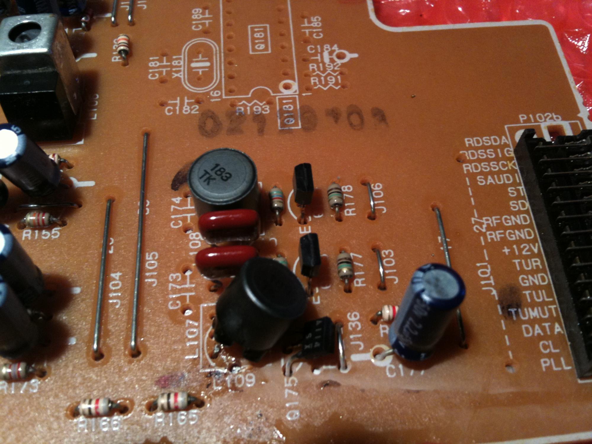

              I found something suspicious on the FM/AM daughter card. A component lead was broken. Anyone know what this component is and where I can find a replacement. Could this be the cause?

                Re: Onkyo receiver/amplifier
                "L" indicates that it's an inductor/coil..
                    Originally posted by steve2
                    I tried uploading the manual 3 times, but it keeps failing. L109 (for 120 volt USA and Canada) models Part # NCH-2140 or 231092 (onkyo #). The schematic has it as a 102j which I don't know if is 1000uh? Yes the 102J is 1000uh, 1mh. The J is 5% tolerance.
                    Measure L110. the value will be the same.
                    Just to be sure about the problem, short L109, and see if the FM work properly, in both channels.
                    L109 are just part of the MPX output filter so, shorting it with a wire link doesn't cause any problem.
                          Thanks for the help. I searched for the part but could not find the exact part at mouser or digikey. I found the following parts. Would these work? The dimensions of the original part are about 7.5 mm diameter, and 10 mm long.
                          http://ca.mouser.com/ProductDetail/F...1HsY9HzTj8k%3d
                          http://ca.mouser.com/ProductDetail/T...N6NKnHdL2dU%3d
                          http://search.digikey.com/scripts/Dk...=445-3778-1-ND
                          Also, I read up on the MPX filter, and understood that it notches out the 19 KHz pilot tone that indicates stereo info so that it doesn't mess up the audio while recording to tape. Is this the only downside to disabling the MPX filter?

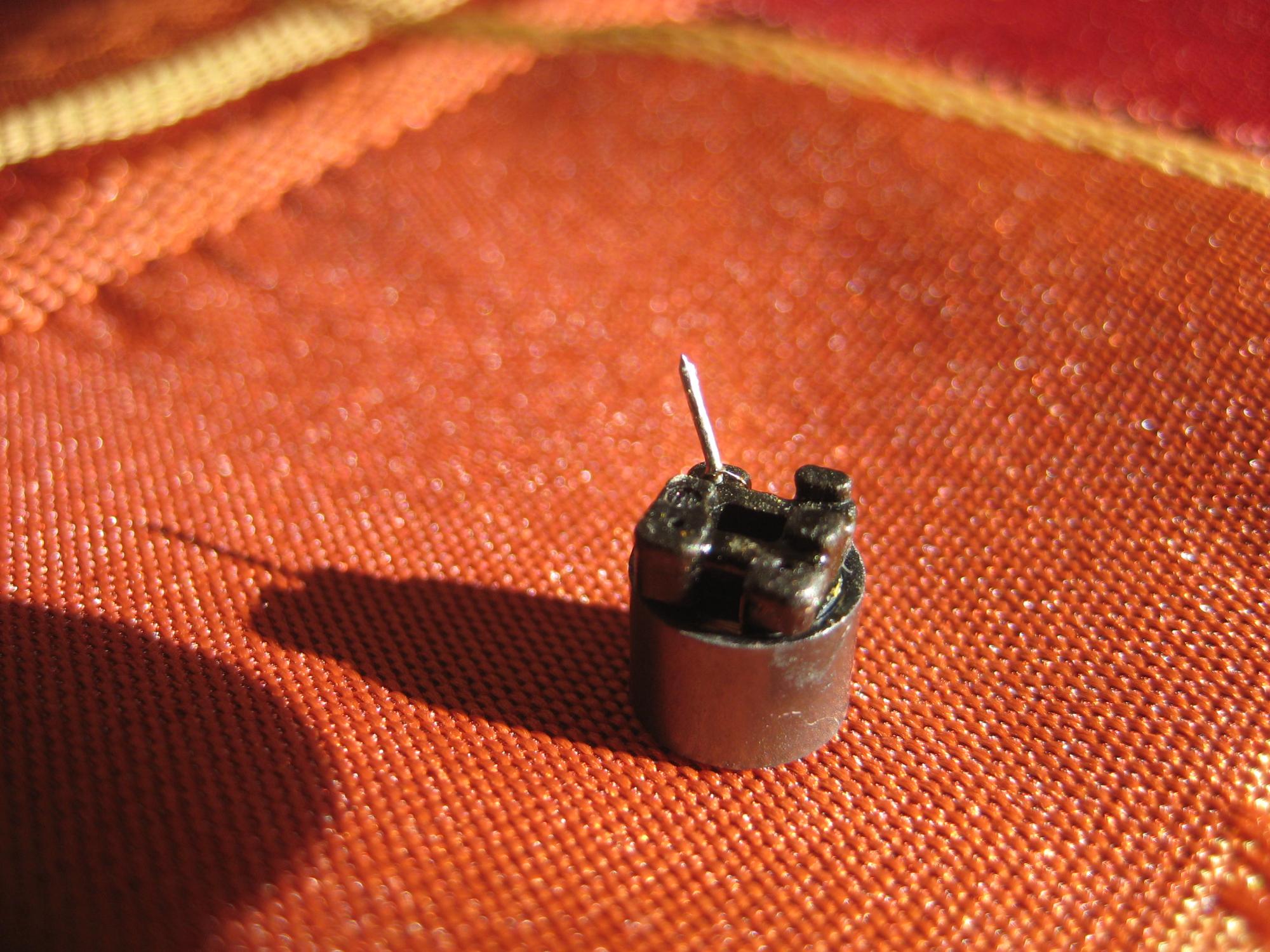

                            Not sure if I am seeing right, but how many leads are on the L109? Looks like 2 broken and more still in the board. Is there no way to solder the leads back together?
                            • lmcancu
                              • Oct 2009
                              • 158
                              There are only 2 leads. I tried soldering it it place, but it did not bond. It seems the broken lead is ripped from the base. I'll try removing it from the board to see if I can reattach the lead to the base.

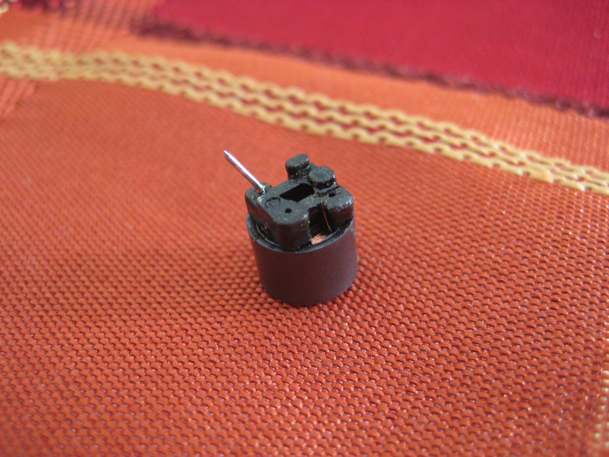

                              • lmcancu
                                • Oct 2009
                                • 158
                                it looks like its going to be difficult. My eyes aren't very good anymore! I removed the inductor from the board. The leads are attached to the plastic and then there is a very find wind from the inductor coil on them. For the lead that is broken, it is no longer in the plastic and the inducutor coil is barely next to the platic hole. I would need to figure out a way to attach a lead from an old capacitor or somehting like it to the plastis base, and solder the wind onto it of which there is very little.
                                  I am the same with the eyes. I wear a magnifier visor when working small parts. I would try what you said and solder a piece of fine wire to the existing piece to make it long enough to reach the new post.
                                    Ok, I tried fixing the inductor with no luck. Much too delicate for me! I took Tude_dude's advice and shorted L109 and now both speakers are at the same level. Only catch is that I'm not sure if the Stereo mode is gone now? There is no indication on the display that the FM channel is is Stereo mode, and it seems like both speakers are the same. Anyone know if the display should say Stereo when the FM channel is Stereo? Is this a side effect?
                                      Yes, when the transmission is in stereo, the stereo display must say so.
                                      But the inductor is after the stereo decoder, so without any influence in the stereo operation.
                                      See if the receiver have a switch for stereo mode, many have...
                                      In the pic we can see the inductor L109 have written 183, this means 18 with 3 zeros, so the value is 18 mH or 18000 uH.
                                        I got the spec from Steve and in the schematic L109 says 102j. 102j is 1 mH with 5%. Are you sure about the 183 markings? Maybe the schematic is out of date?
                                        Also, I'm thinking the inductor is also used for the pilot tone detection as well as removal and makes the stereo detection not work since the inductor is shorted.
