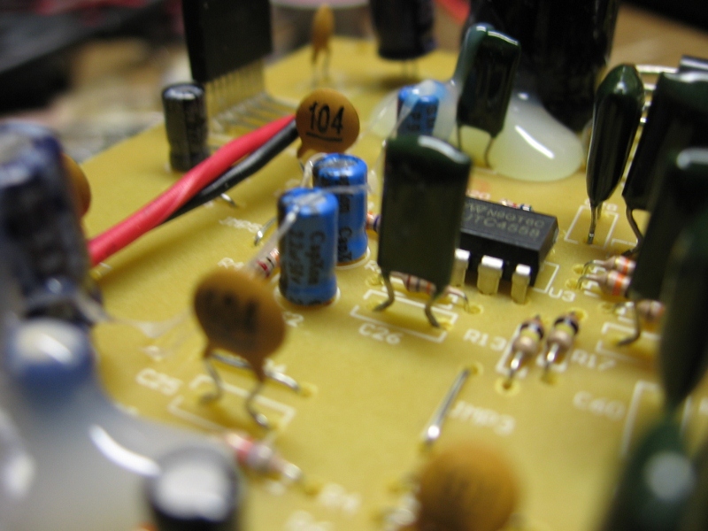

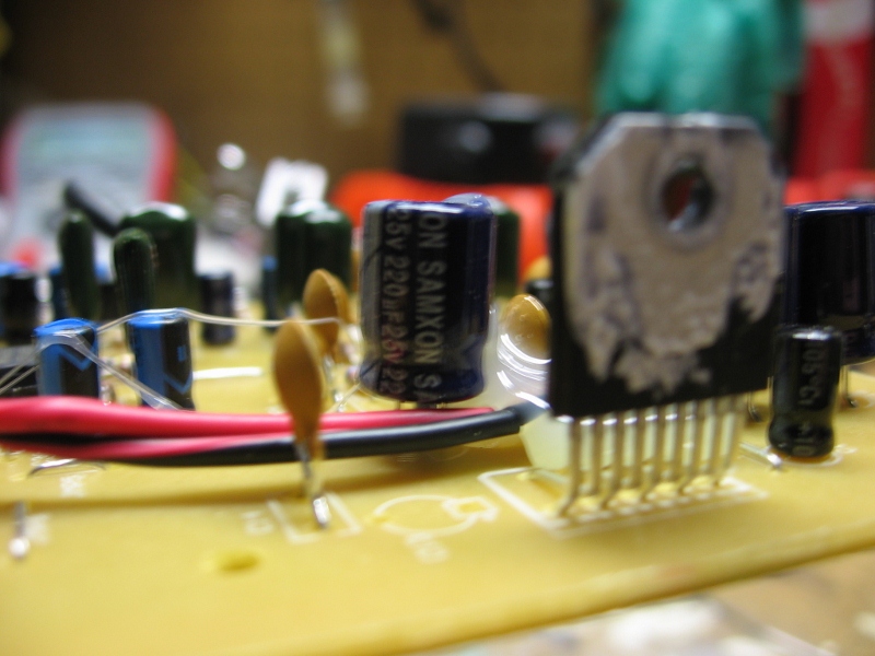

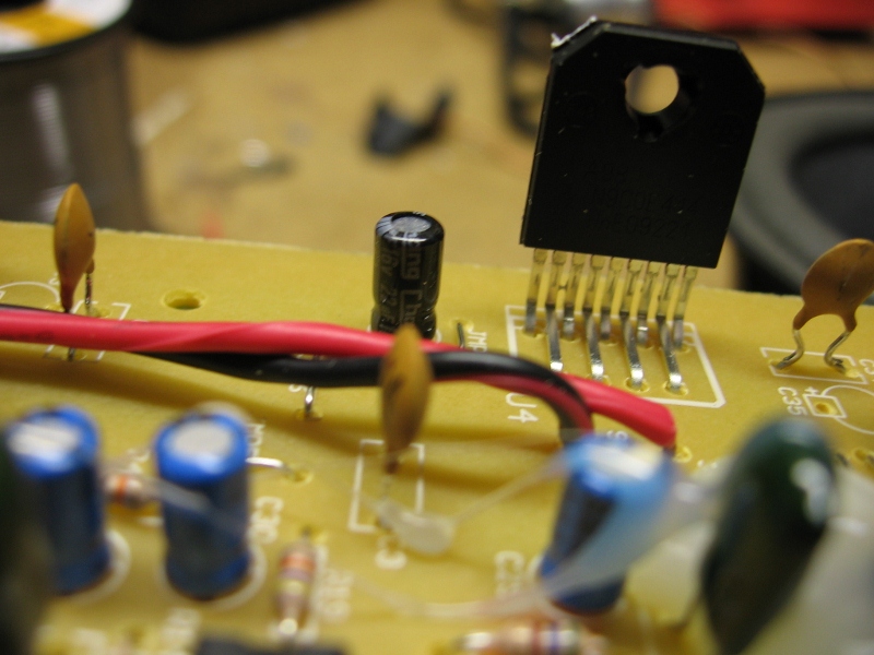

    I'm making this thread because I have the resources and I'd like to share it with anyone who is interested, whether you are a member of the forum or not.

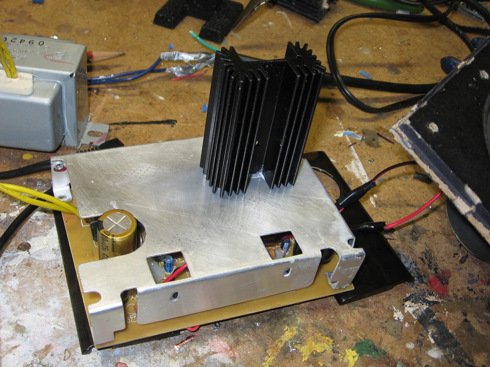

    If you are curious as to what the quality of these cheap Logitech 2.1 setups are...look no further. You've come to the right place.

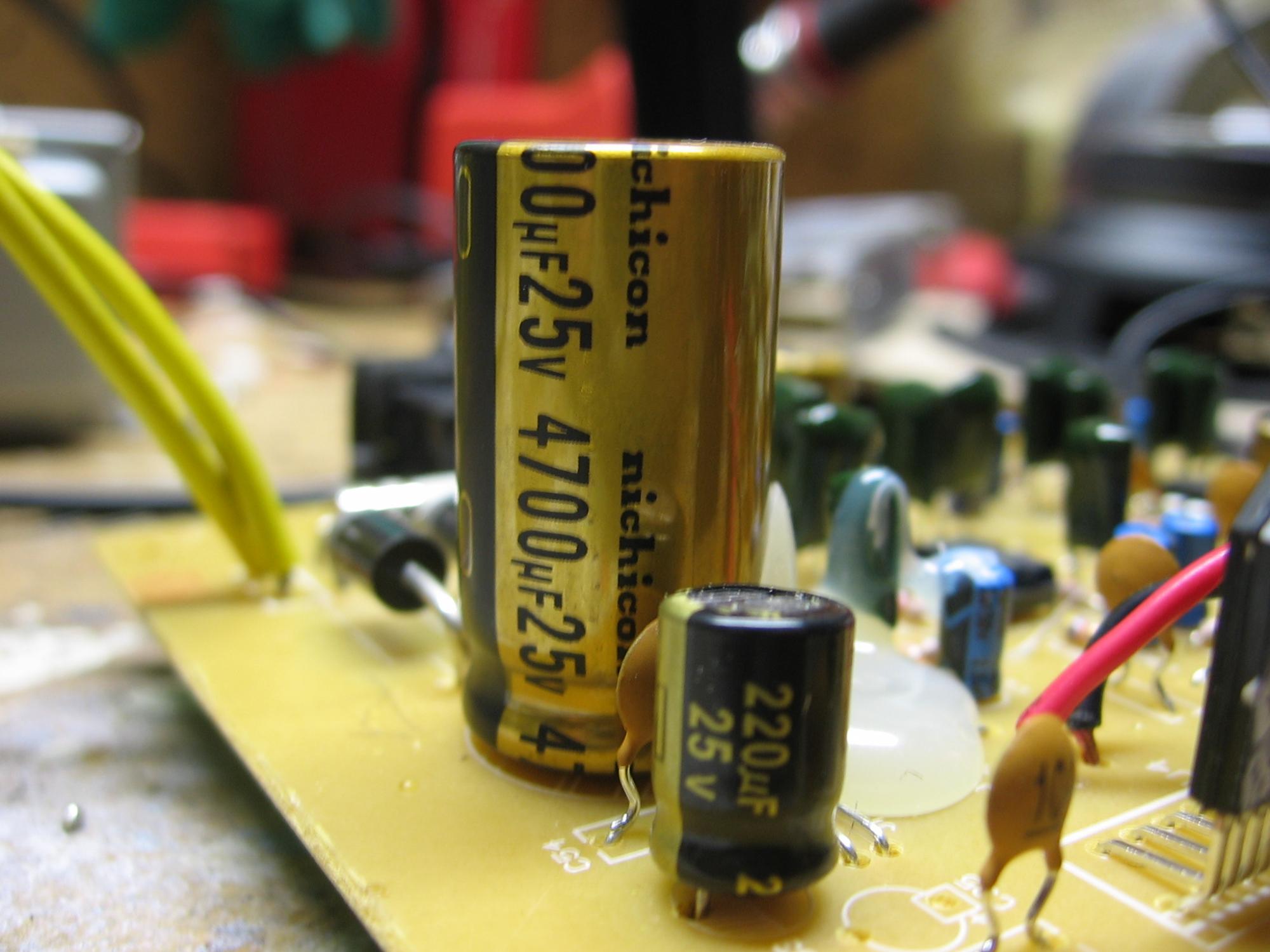

    I've always wanted to know how crappy my $35 Logitech Z313 speakers were inside. They look nice and flashy from the outside, but I've always been a skeptic of the internals.
    So, I've got pictures of the amplifier board. In short, it's a piece of crap. However, you can't expect too much more for the price point. If this was a $100 2.1 setup, then I'd expect some decent components, but for something retailing this low, it's to be expected.
    But that still doesn't take away from it being junk.

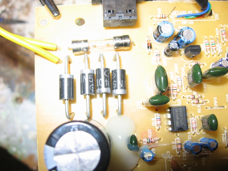

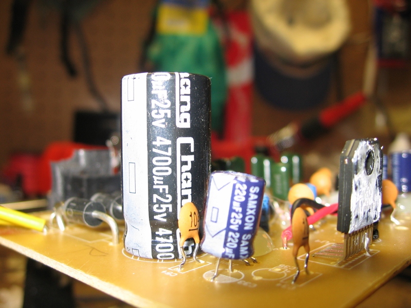

    Capacitors are by:
    -Chang
    -CapXon
    -Samxon
    Changs are trash.
    CapXons are trash.
    Samxons are actually regarded as being pretty good, on par with Teapo, but still not the best.
    The rectifier circuit is 4 x 1N5401s. Pretty dodgy there. I really wasn't expecting a unicase bridge rectifier, but it would be nice.
    Heatsink (not pictured) has about as much effectiveness as a sheet of aluminum foil.
    Soldering job is pretty good for a simple through-hole board. There are no SMD parts, so no worries about trying to replace SMDs if you need to.
    Not the worst board ever, but you can tell that Logitech cheaped out. Again: It's not like they had a choice if they wanted to get a big profit from them, but it's always a bummer to see a name brand company use such shoddy parts.
    Here are the pictures:

          I'm actually recapping it with some Panasonic FMs and Some Nichicon Muse FGs/KWs.
          The sub is only a 4ohm. I'm also replacing that with a decent 8ohm.
          Spent about $30 on parts and hopefully breath some life into it. I kind of destroyed the sub box while opening it...so I'll need to build a new one of those....not like that's hard at all.

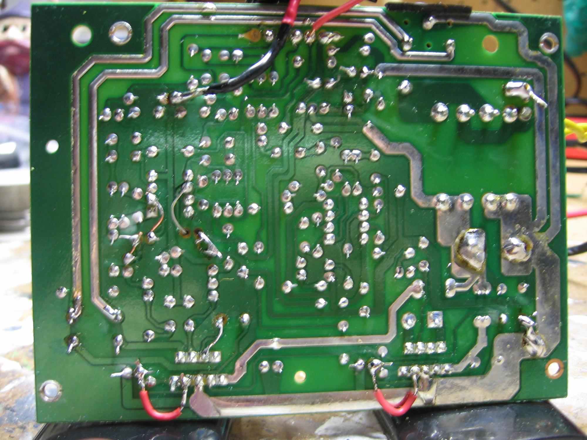

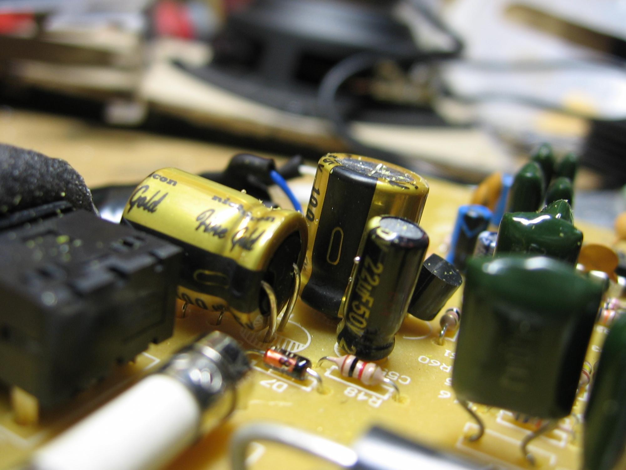

                      Well, I recapped about 75% of the caps. The other 25% I didn't even bother with. The traces/pads on the bottom of the board were so small that I would rip the pad off every time. So I decided to suck it up, and deal with a few SamXons/CapXons. They stink but I recapped all of the more important ones. The caps I didn't replace were of the small variety. 2.2uF and 0.22uF: So I doubt it will really matter in the end.
                      The caps I did replace work well though I struggled a lot with desoldering. This board clearly wasn't meant for any time of rework and thus I wound up ripping off about 50% of the pads that I worked with. It's unfortunate, but luckily I was able to jumper all of the connections that were lost during desoldering.
                      It works!...somehow. I attached a picture of the back of the board and it looks bad. It actually looks much better in person, but from the picture it looks terrible.
                      Caps include Nichicon FW & FG and Panasonic FM. Also replaced the fuse with a ceramic type.

                        Kind of crappy to see those two op amps one for each channel. They're there for preamplification since the input signal isn't strong enough to drive those heatsunk audio amps.
                        Opamps aren't the best for preamplification. They get the job done but they're not a top choice by any means.
                        There are specific preamp ICs made for this. There are even integrated audio amp ICs that handle the preamplification and final amplification on one IC.
                        On the positive side very simple circuit design and very easy to service should it be required.

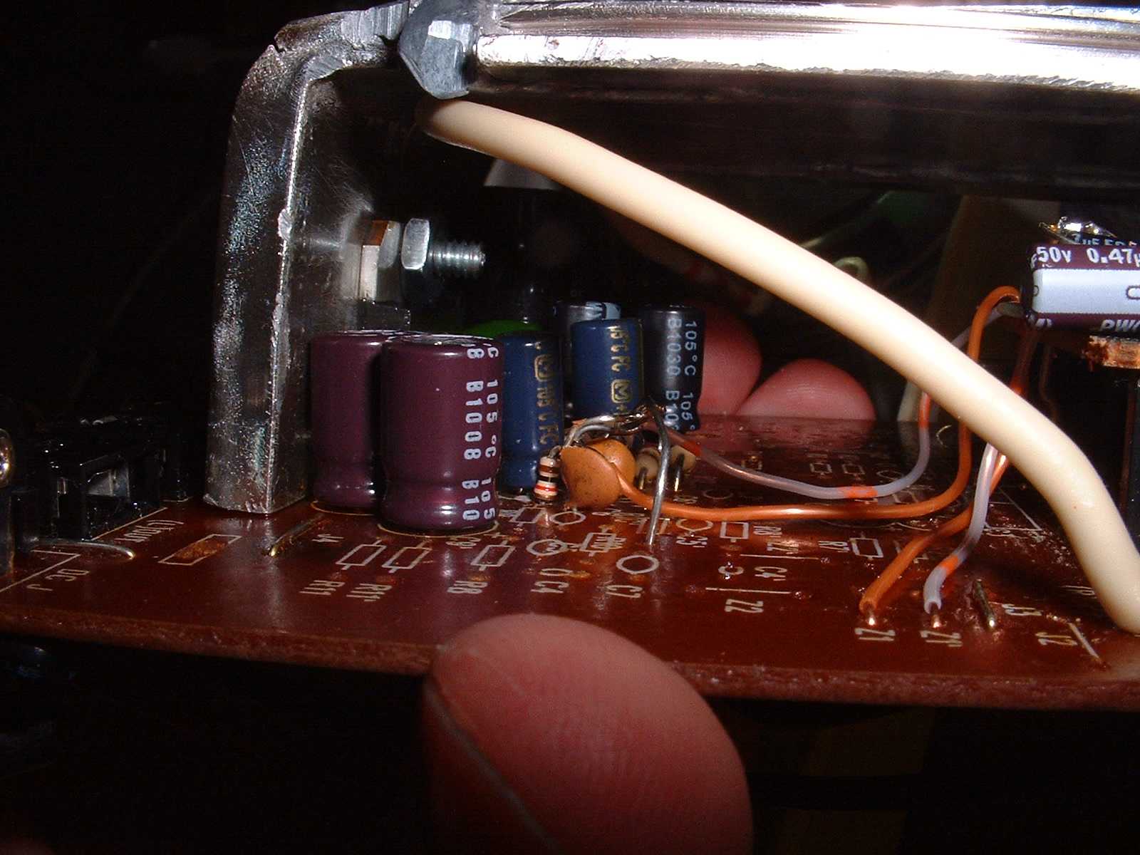

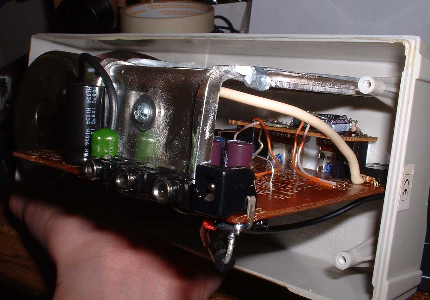

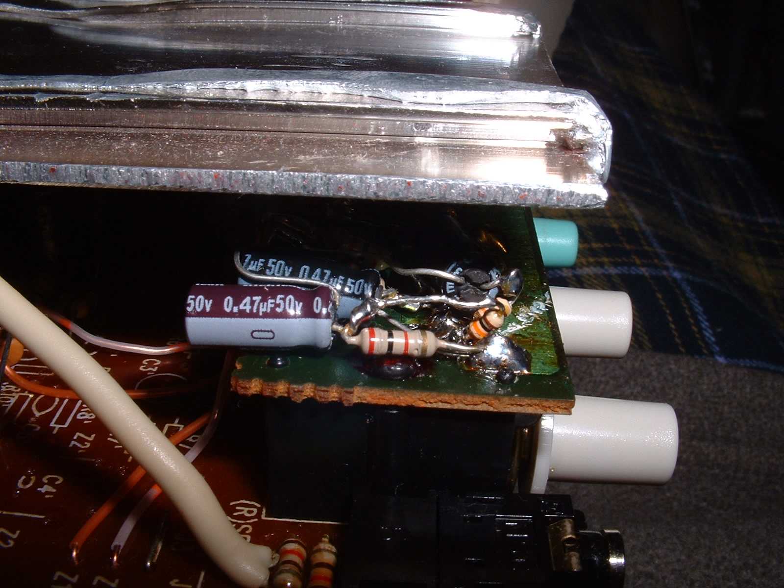

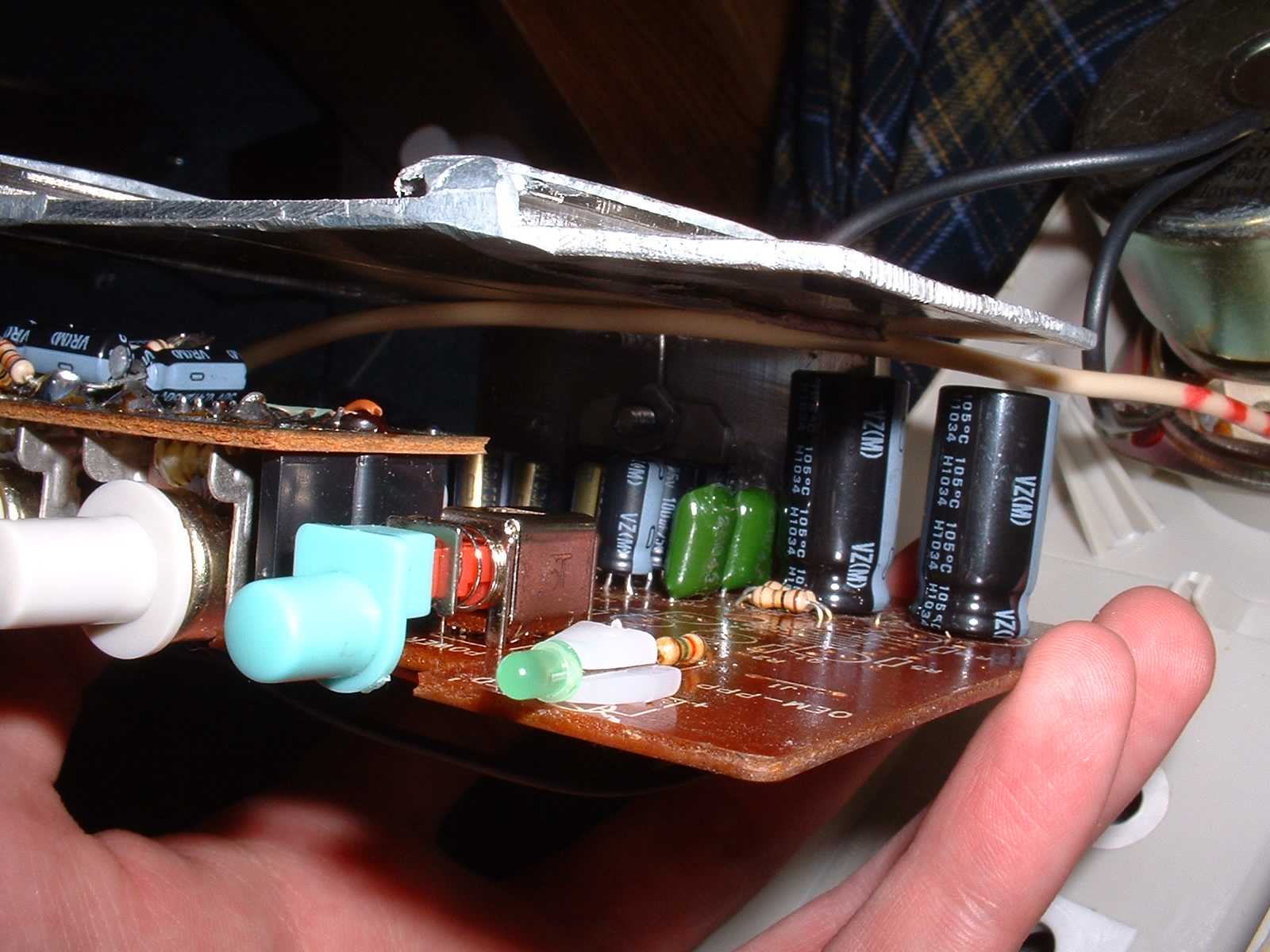

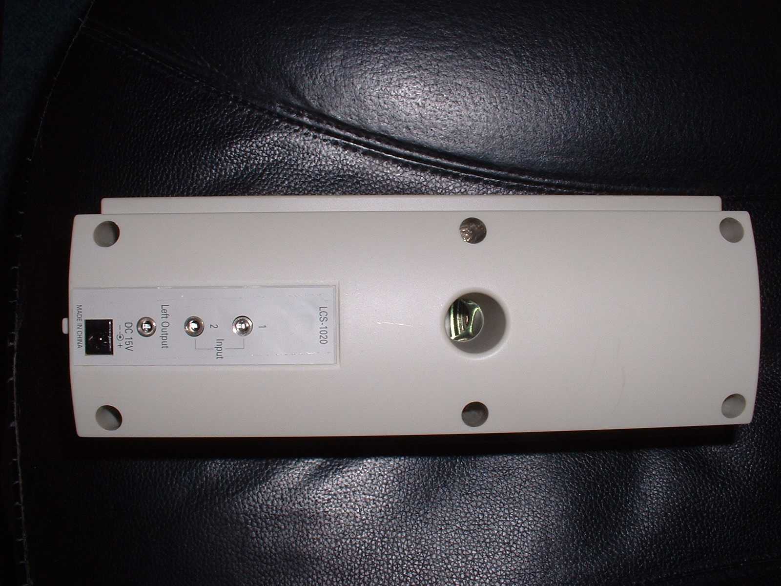

                            By far, the worst I've seen for 'puter speakers was in Labtec LCS1020s.
                            The power IC was a TDA2004. There was a 2SC945 in each channel, attempting to play preamp, but no decoupling whatsoever. Biasing? You're kidding!
                            The final was set up for some ridiculous gain- 48 or 50-odd dB, in an attempt to recover the low level, humming, distorted, NASTY signal from the 'preamp.' That's right, a negative gain preamp.
                            I cleared all that junk and redid the whole damn thing. I kept the TDA2004 and changed the resistors in its feedback loop, lowering the gain to around 34dB. That was to match the insertion loss of the new passive tone control I designed for it. The loss was 8dB. Not having that stupid preamp anymore and increasing the size of the SVR cap, the amp was nice and quiet. Headphone output before was a joke with all the hum. I made a bigger heatsink, too. The one it had was making accidental contact with the IC.
                            I changed the caps too
                            Pix coming soon
                            -Paul

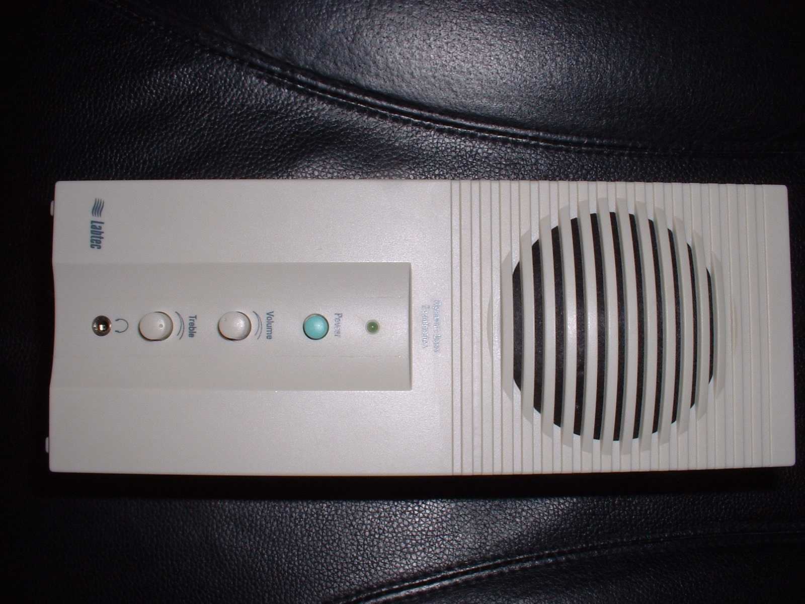

                              Labtec = Logitech
                              Logitech sells outdated stuff under the labtec label. usually with a slightly different/cheaper casing.
                              a bunch of webcams my brother had were labtecs. internals were all logitech, but very old hardware designs. hell.. even the driver installed itself in c:\program files\logitech, despite the fact it had labtec logos all over the place lol
                              edit: the .inf files were also (c) Logitech

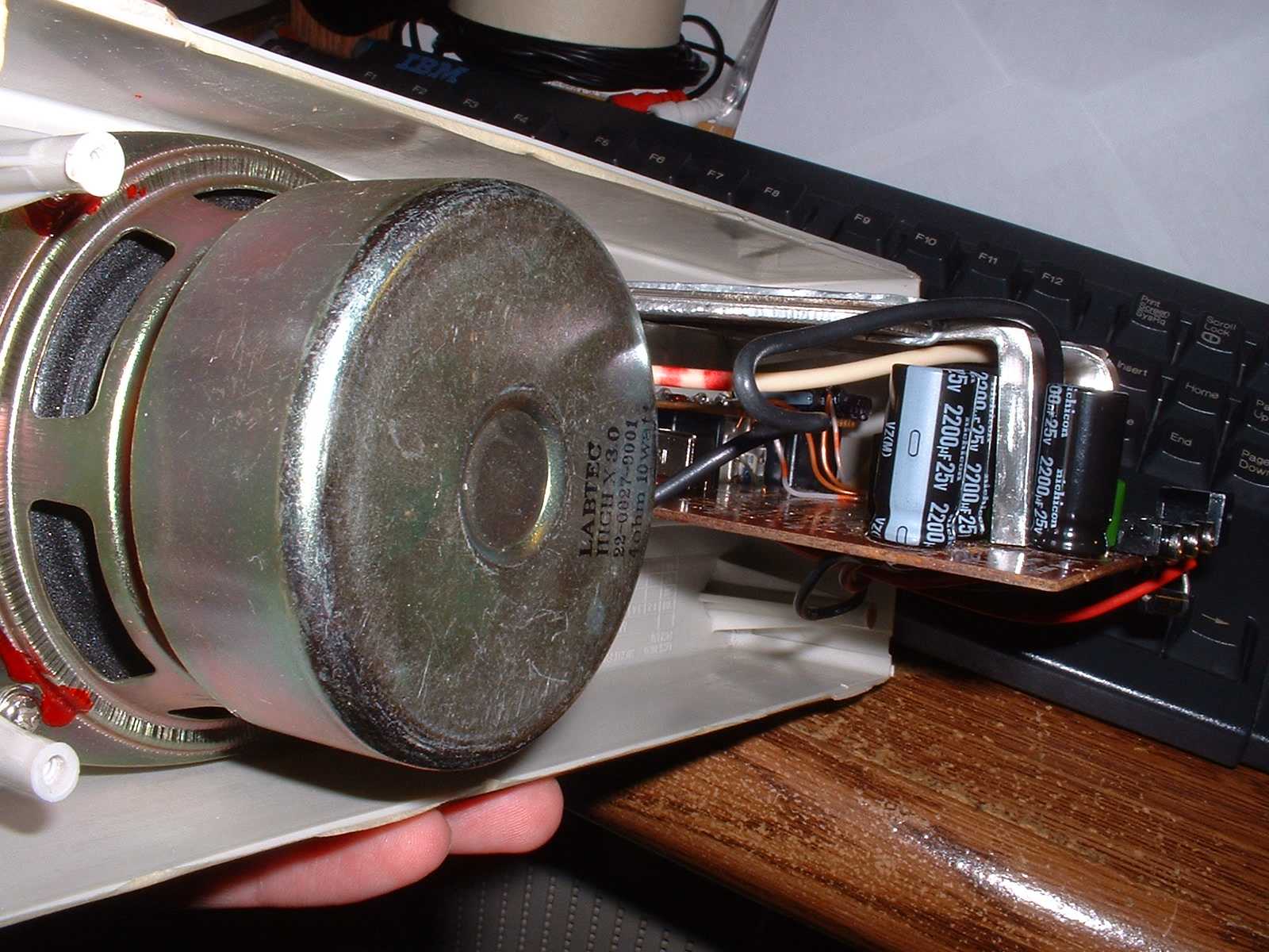

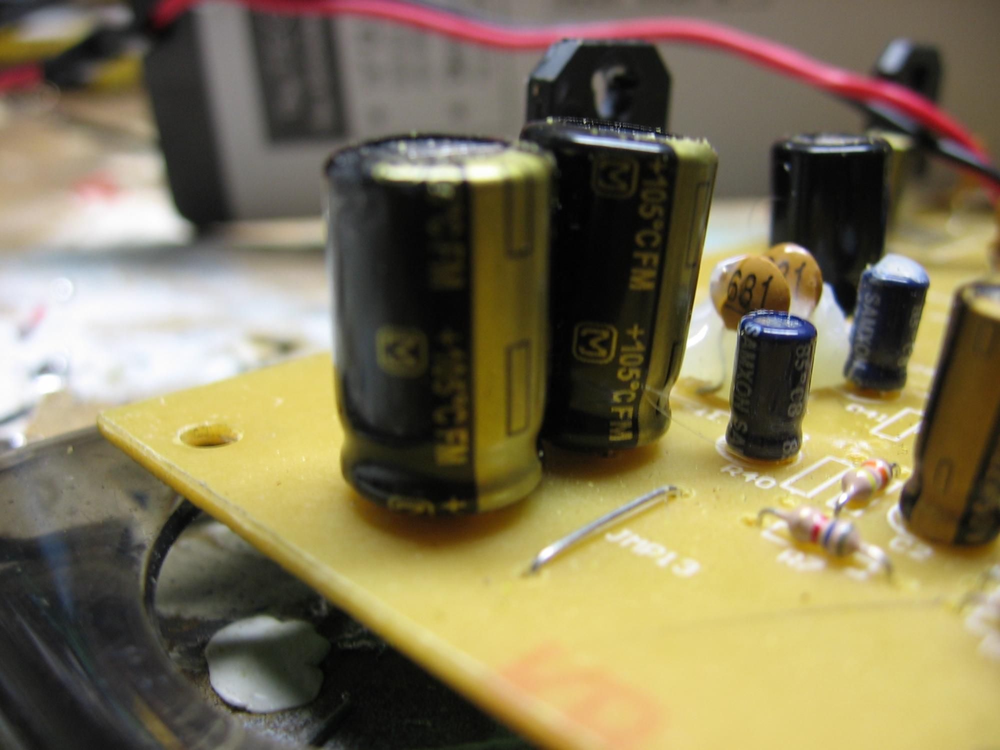

                                These are waiting to be picked up, so I got some pix...
                                This thing looked like one of those baby boom boxes with all the untrimmed leads. But it'll never be the same- I mean it actually has a reasonable heatsink and sounds good now.
                                The new tone control is just a few resistors and caps, high-current traces were jumpered, and a reverse polarity protection diode was added. This takes a 15v, tip *negative* adapter. The cable from the other speaker was shielded #28, like the cable for a PC mike but more brittle. It's 18/2 now.

                                  Wow you did a good job not ripping off the solder pads. The solder side on my Logitech board was absolutely atrocious. I think I've learned my lesson to not mess with things that are already crap to begin with.
