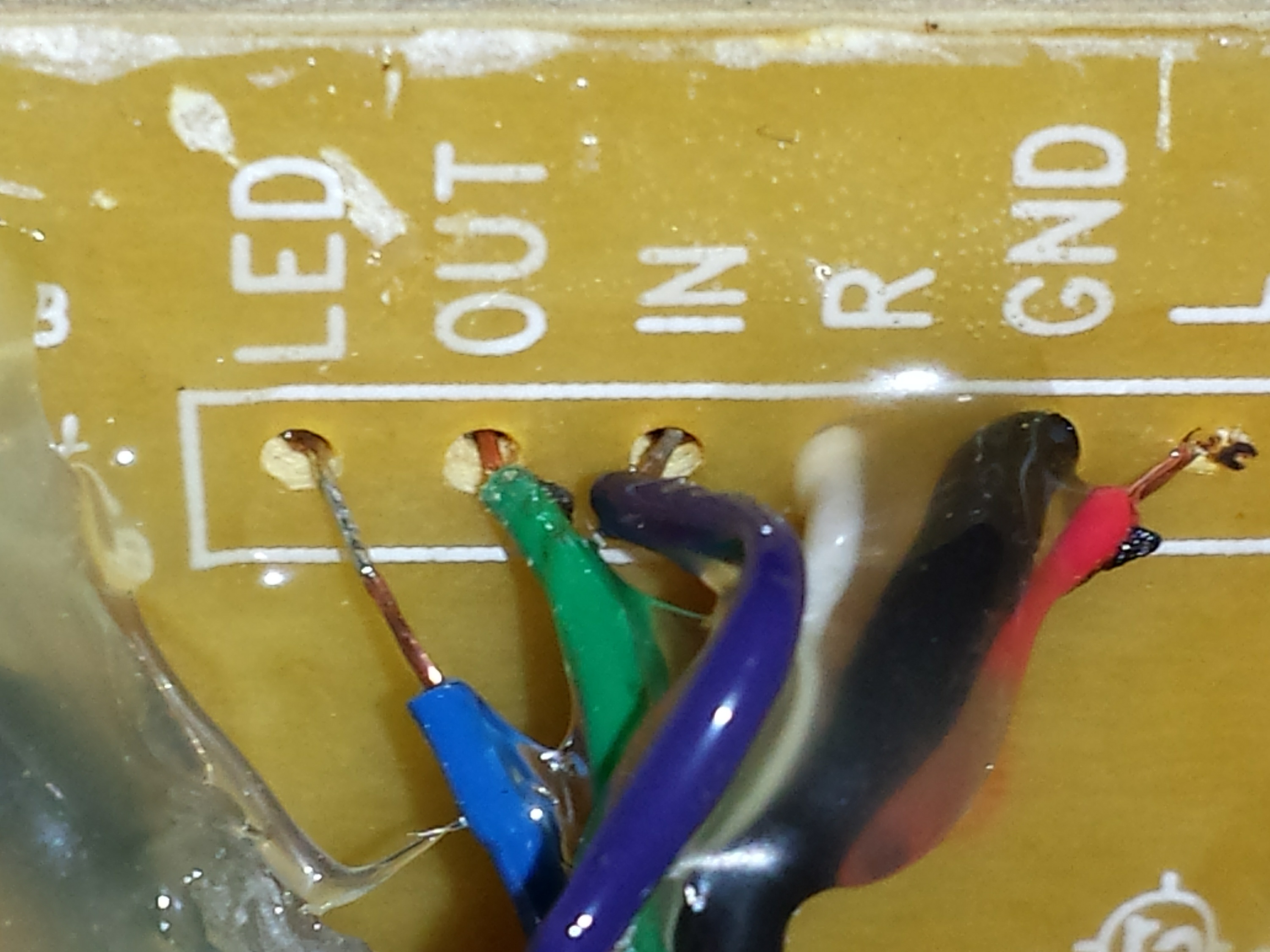

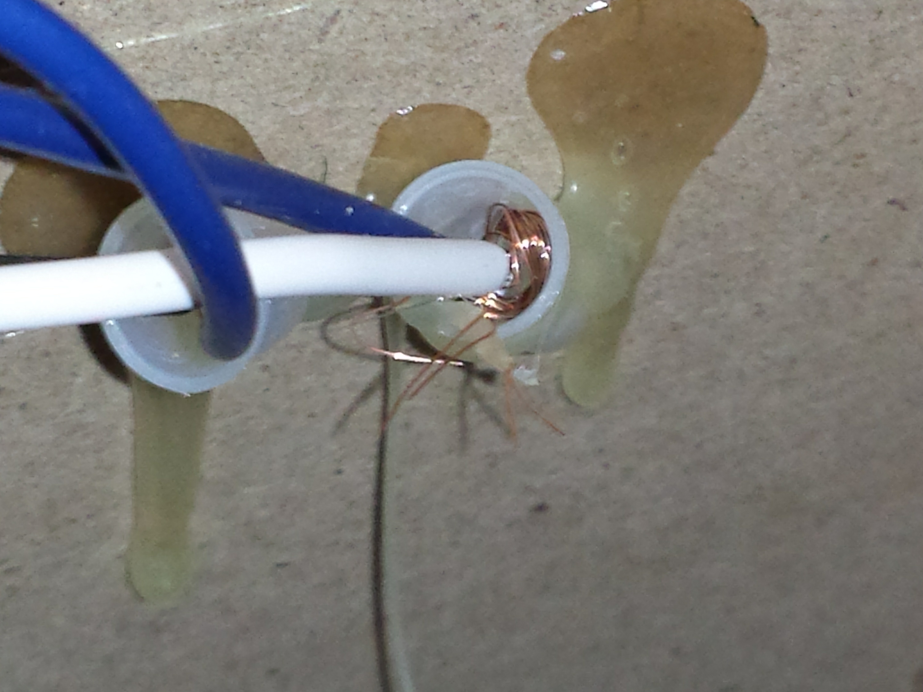

                I have it figured out. Not fixed yet, but pretty sure it's the input wires. When I remove all the input wires I just get the normal hum but not the static. I thought maybe it was the jack, so I cut it off, but still the same. Tried replacing it with a headphone wire, but it became way worse. I'm thinking it's the cheap wire acting like an antenna, but that doesn't explain why only one side does it. I'm going to order a high quality shielded cable for it and see what difference it makes. Also, mine is a revised version. I made some changes, among them, cutting off the wire nuts which had wires sticking out of them, and soldered/shrink wrapped the connections. And the hot glue, they went nuts with that.
                ------------signature starts here------------
                • lookimback
                  • Aug 2013
                  • 1489
                  #48

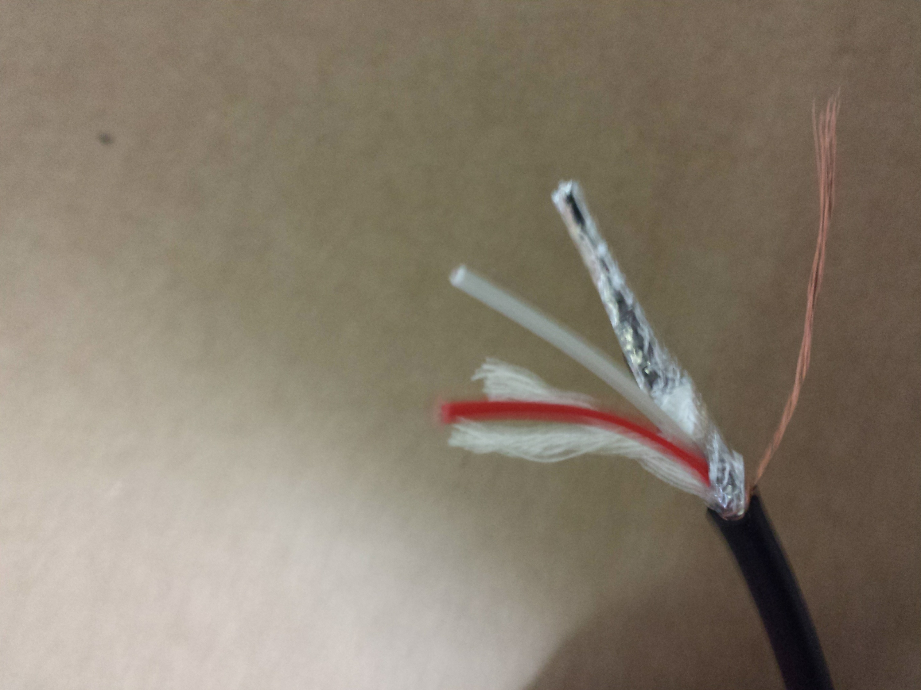

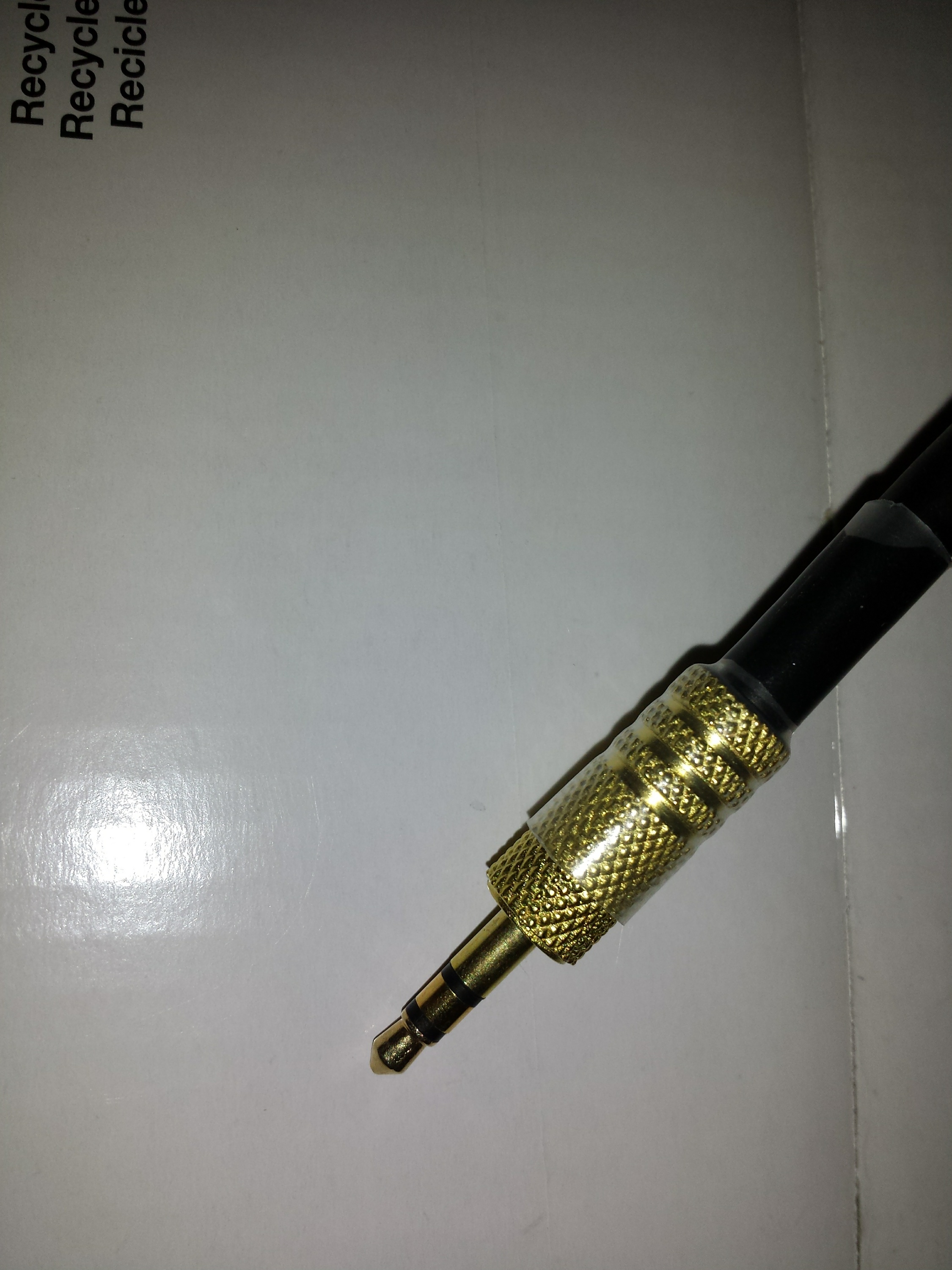

                  Re: Internal Shots of the Logitech Z313
                  I was correct, it was the cheap cable acting as an antenna. I replaced it with a really good shielded cable. This cable is a 1/4" in diameter and came with gold plated jacks on the ends. I had to drill out the hole it goes through, but my step drill made quick work of that. Also had to lose the ferrite because the cable was too big. I lost the pads so I just soldered the wires to the test points that were about a 1/4" away. There's no static at all now and it sounds way better.
                  This is the cable I used. $12.95 for a 20' length.
                    master hoarder
                    • May 2008
                    • 12175
                    • Bulgaria
                    #49
                    Nice work! I'm a bit surprised that a crappy cable can cause so much trouble, though.
                    I would probably have added a 3.5 mm jack input on the speaker instead - that way you can put any cable you want.

                      #50
                      I actually thought of that after it was done too.

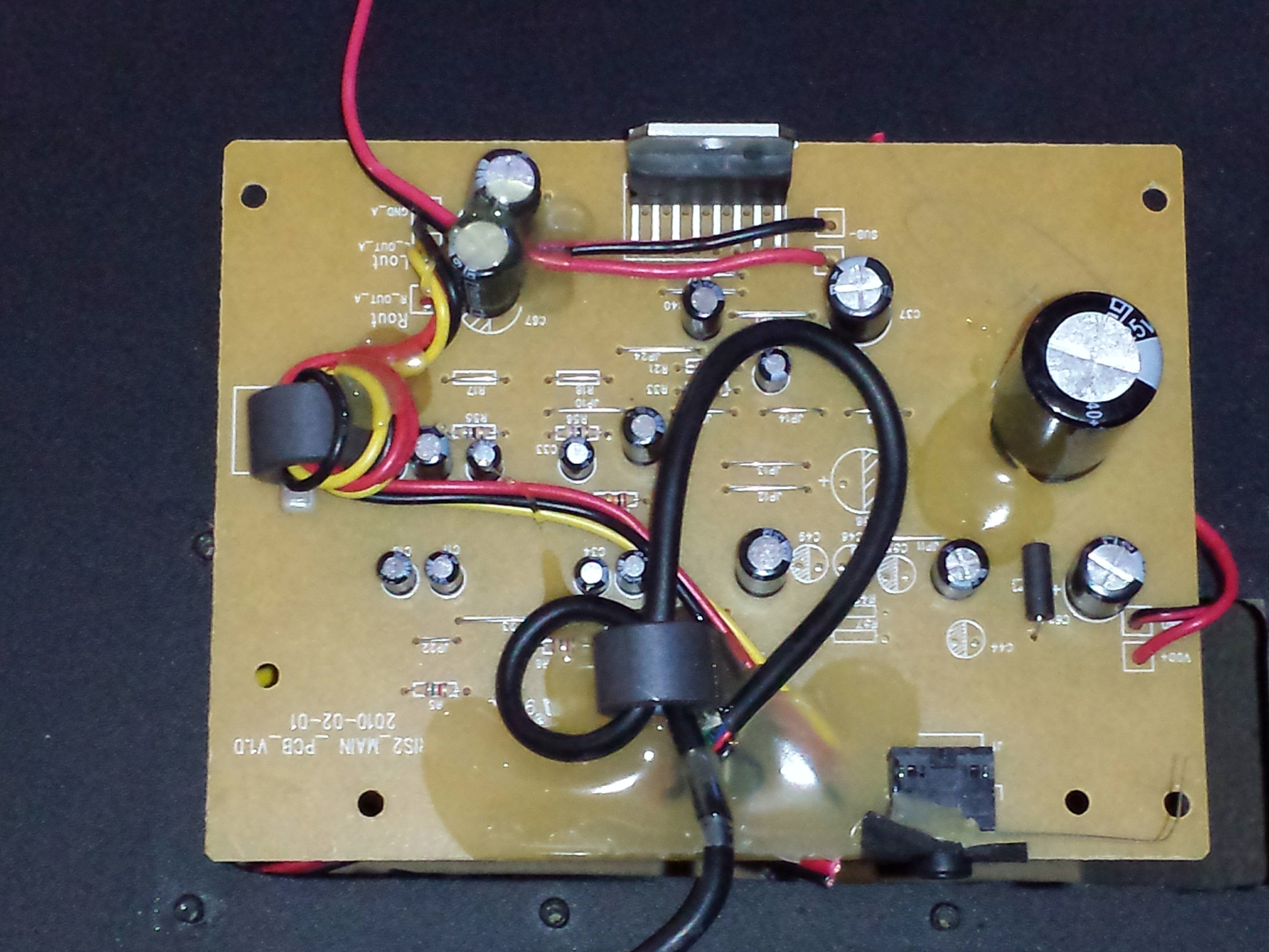

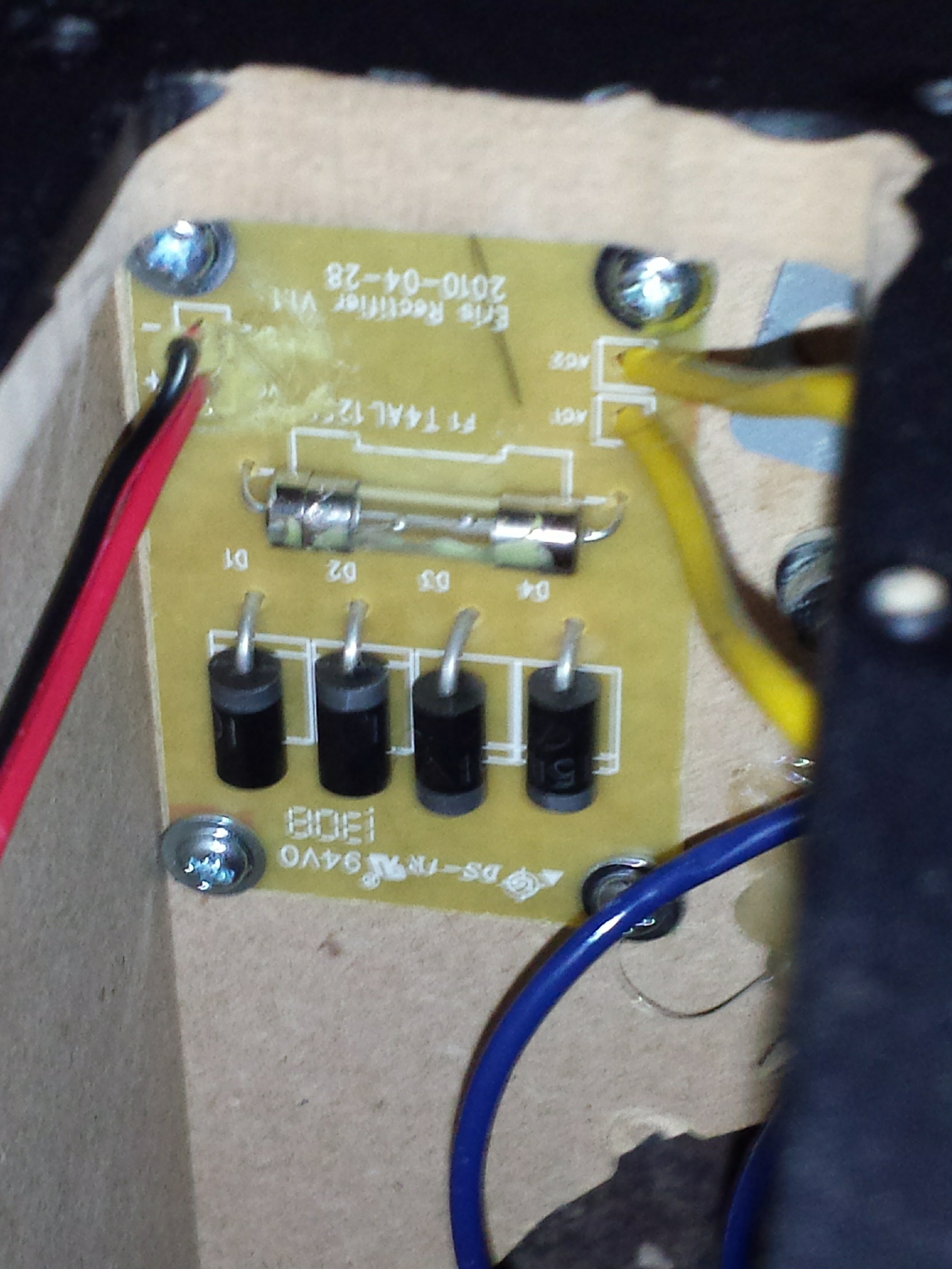

                        Hi, i have a problem with this speaker, the power board don't shows any output voltage..
                        I start to repair it, but see that is bether change it...
                        Need to know the output voltage and amp..
                        Is it 12v 1amp?

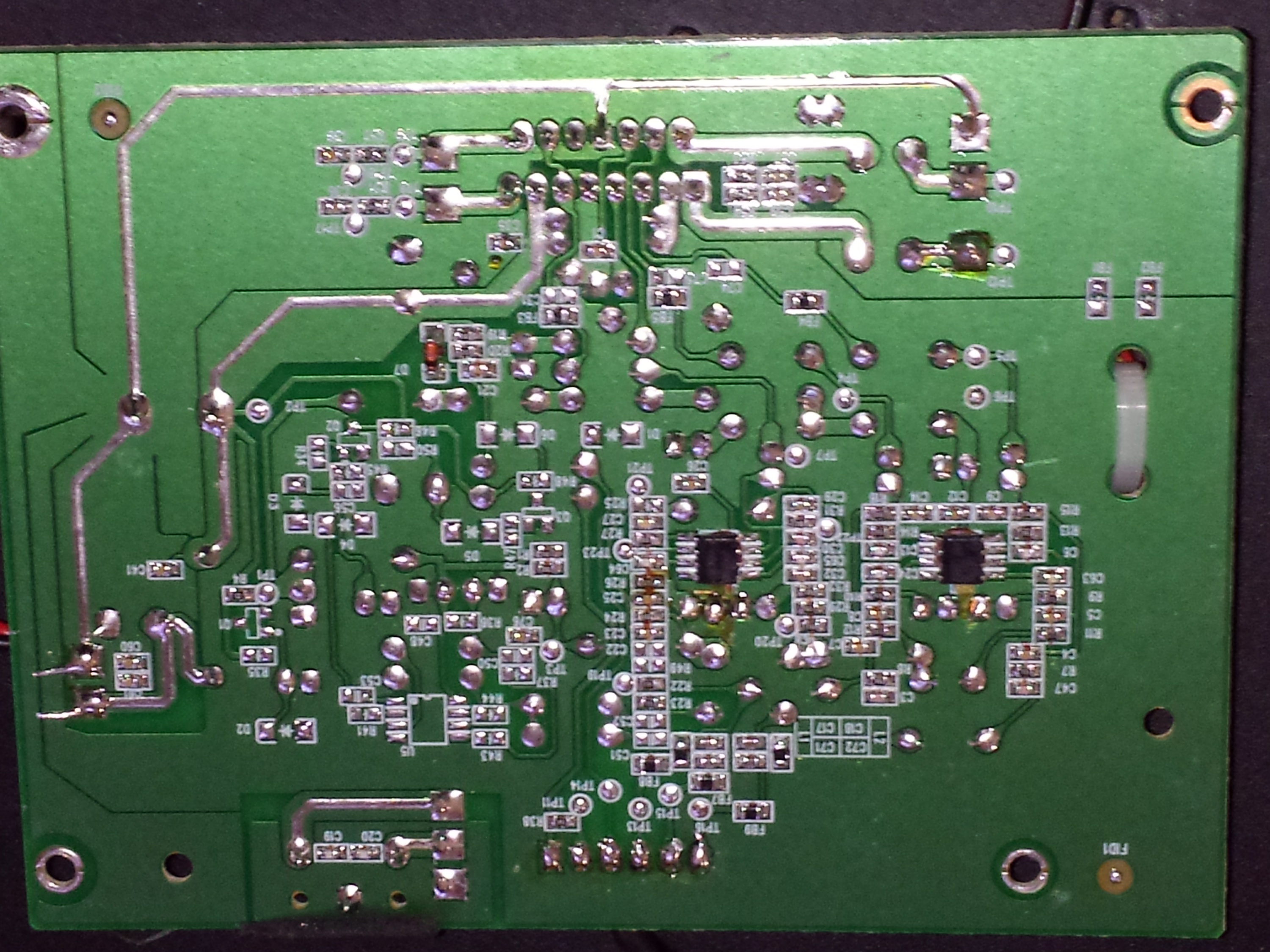

                            Does anyone have a circuit diagram for the Z313 amp, power supply, wired remote?
                            • lookimback
                              • Aug 2013
                              • 1489
                              #54
                              I bypassed my remote. Speaker wires are red, white, and black, black being common. Then the green is a ground, which is for the LED. That leaves you with blue and purple, which are 5vstby and PS_on, though I can't remember which is which, I think blue is stby. I simply shorted purple to blue on mine.

                                Can anybody write output voltage of the transformer of this speakers ?
                                • mockingbird
                                  • Dec 2008
                                  • 5484
                                  #56
                                  The large filter cap is 25V 4700uF, so you're looking at a 12V transformer, but it will output more than 12V without load.

                                    I have disassemble the control pod of my Z313 a few months ago.
                                    Problem is that I have lost my notes regarding the wiring.
                                    Can any body tell me how to connect it?
                                    What I am sure is the wiring of the ground, The red and white (connected to the potentiometer).
                                    What I don't know is the wiring of the three remaing wires (blue, purple and green).
                                    I think, Blue and purple are connected together (through a switch) and green is connected to the Ground. I also Think the Led is connected between the green and the ground.
                                    Can Anybody confirm this? Or better, Have a scematics of the circuit? with the colour of the wires.

                                      I believe blue and purple are connected through the switch. I can't recall which is which. One is going to be standby voltage, the other is PS_on. Green is not ground. Black is. I think you are correct that the LED connects between green and ground though.
                                      If you have a multimeter, you can test for voltage on blue and purple. The one with voltage, probably around 5vdc, is going to be PS_on. I think blue. I bypassed my control completely so I no longer have it to look at.
