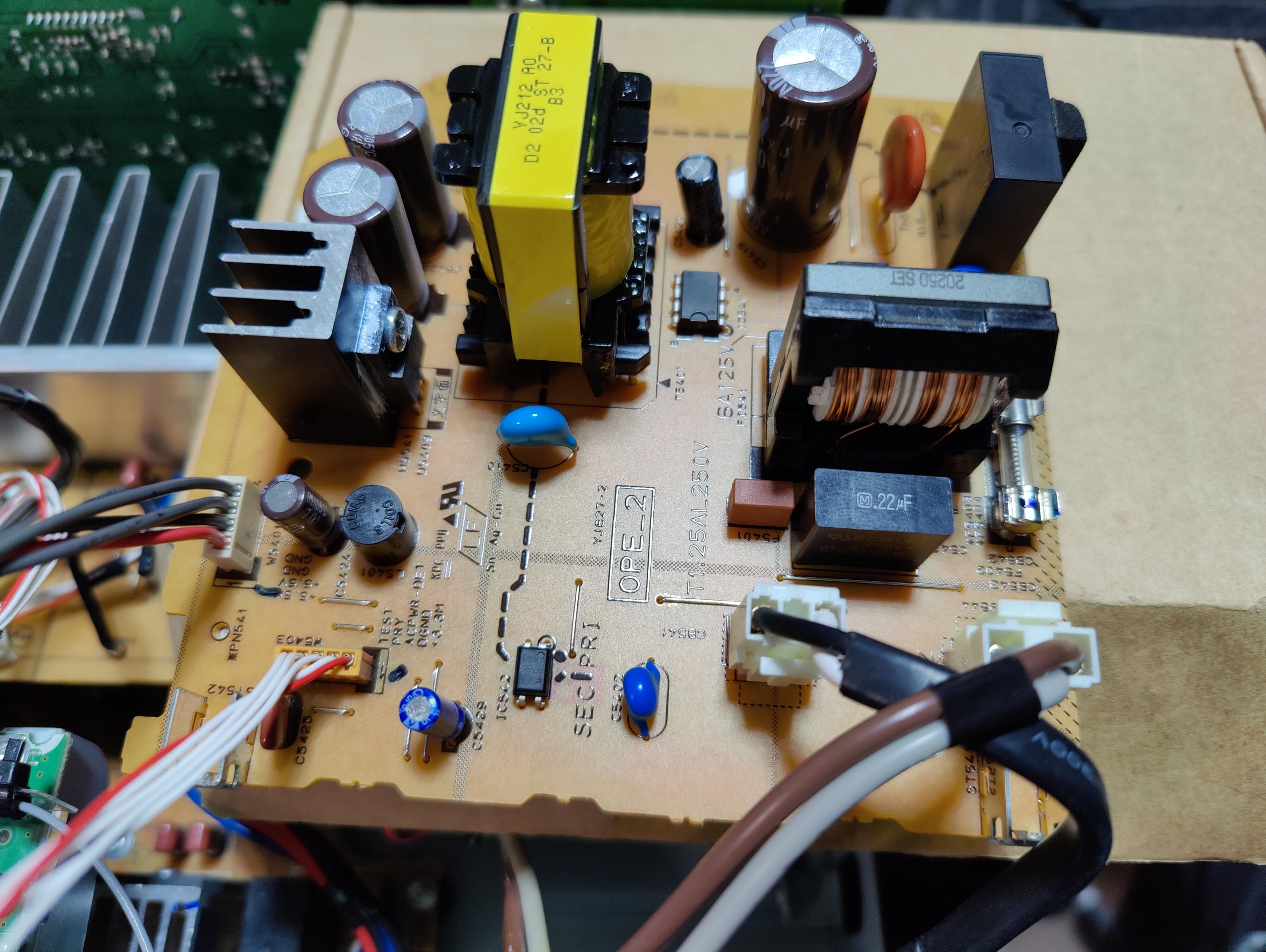

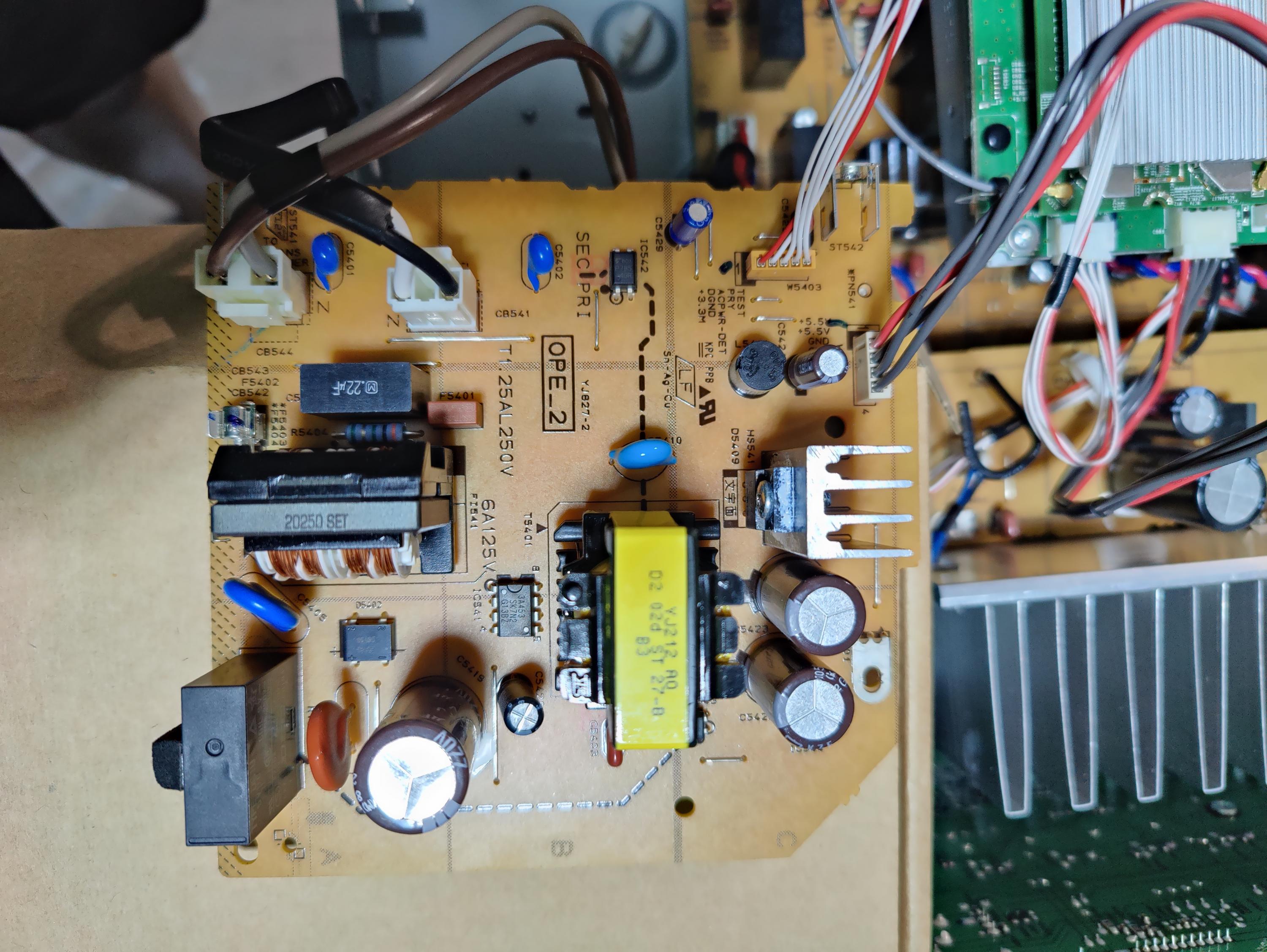

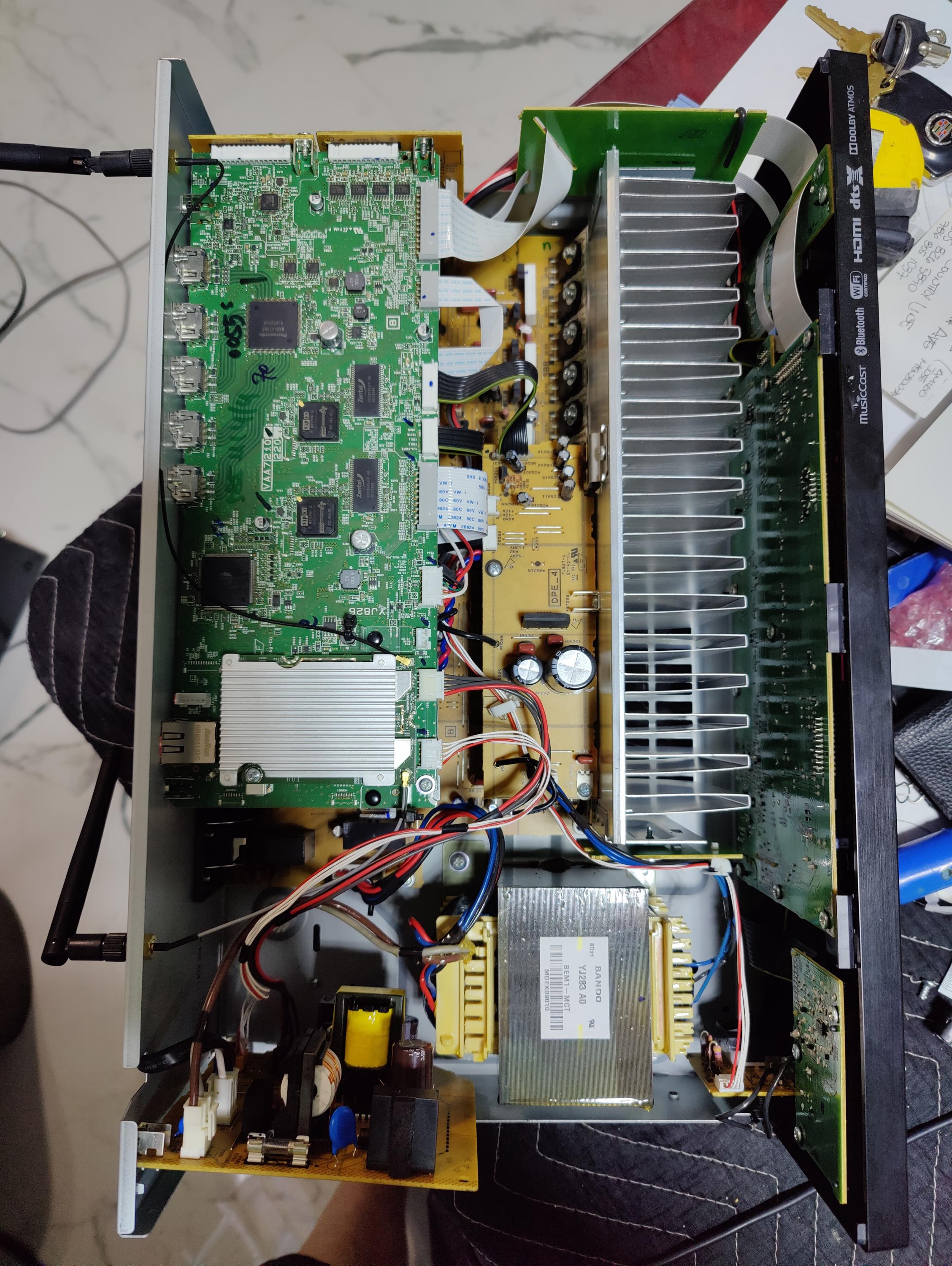

    YAMAHA AV Receiver RX-V585 No Power
    120v ok, No voltage on the connectors, Fuses OK, 165v DC on the main capacitor

    Re: YAMAHA AV Receiver RX-V585 No Power
    Standby circuit is defective, are you sure F5401 is good? Also check F5405 (2A/63V)
        Are you sure you are not getting any 5.5 volts from the standby circuit?
        Check the voltage across C5419 and C5420

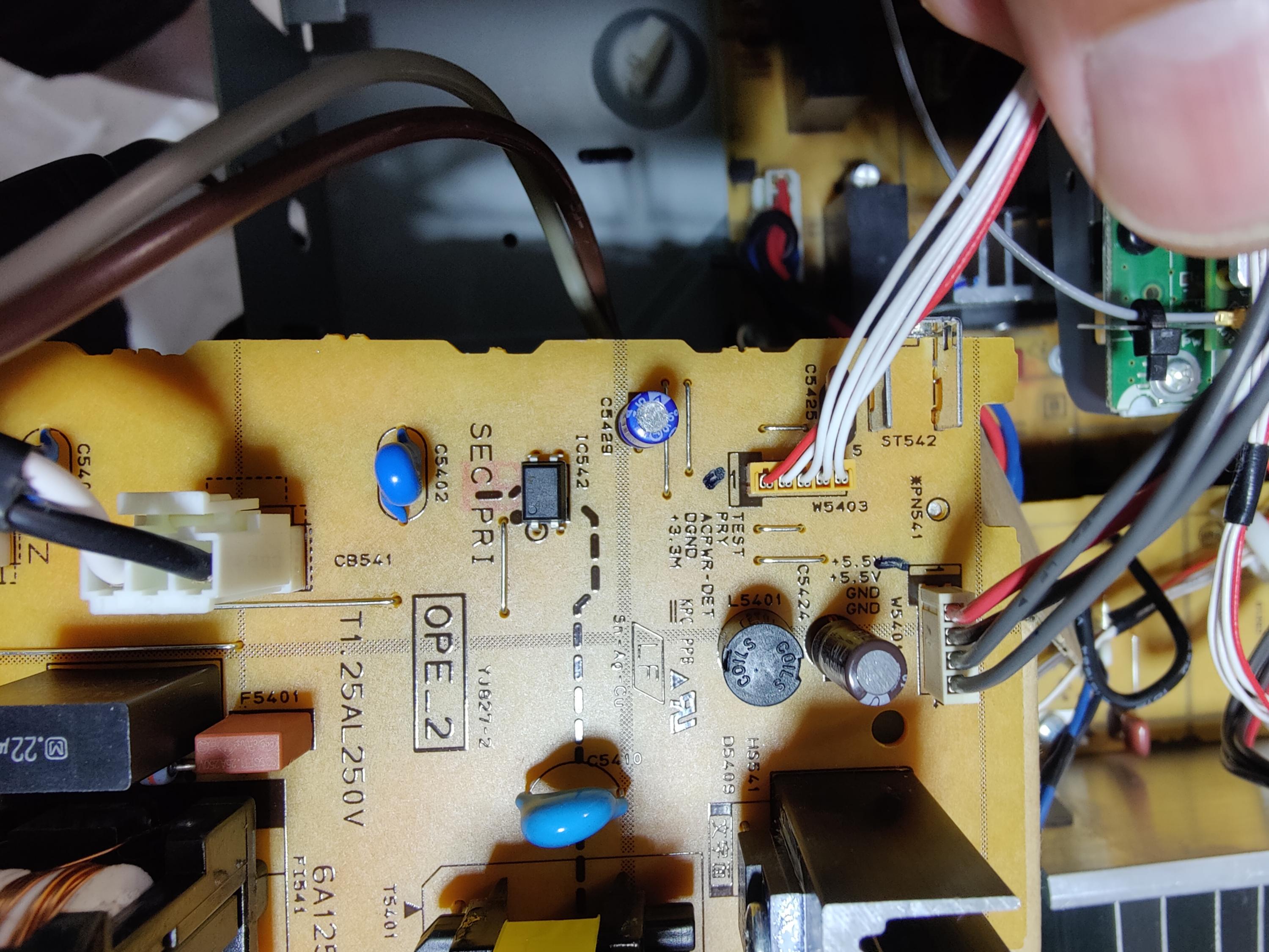

          C5419: 161v dc
          c5420: 9.7v dc
            C5420 is for the vcc voltage, it needs to be 15 volts to start up. Try replacing C5420, Check that there are no shorts in the secondary side like D5409.
            Check the solder connections on the transformer and check R5407 (47Ω)

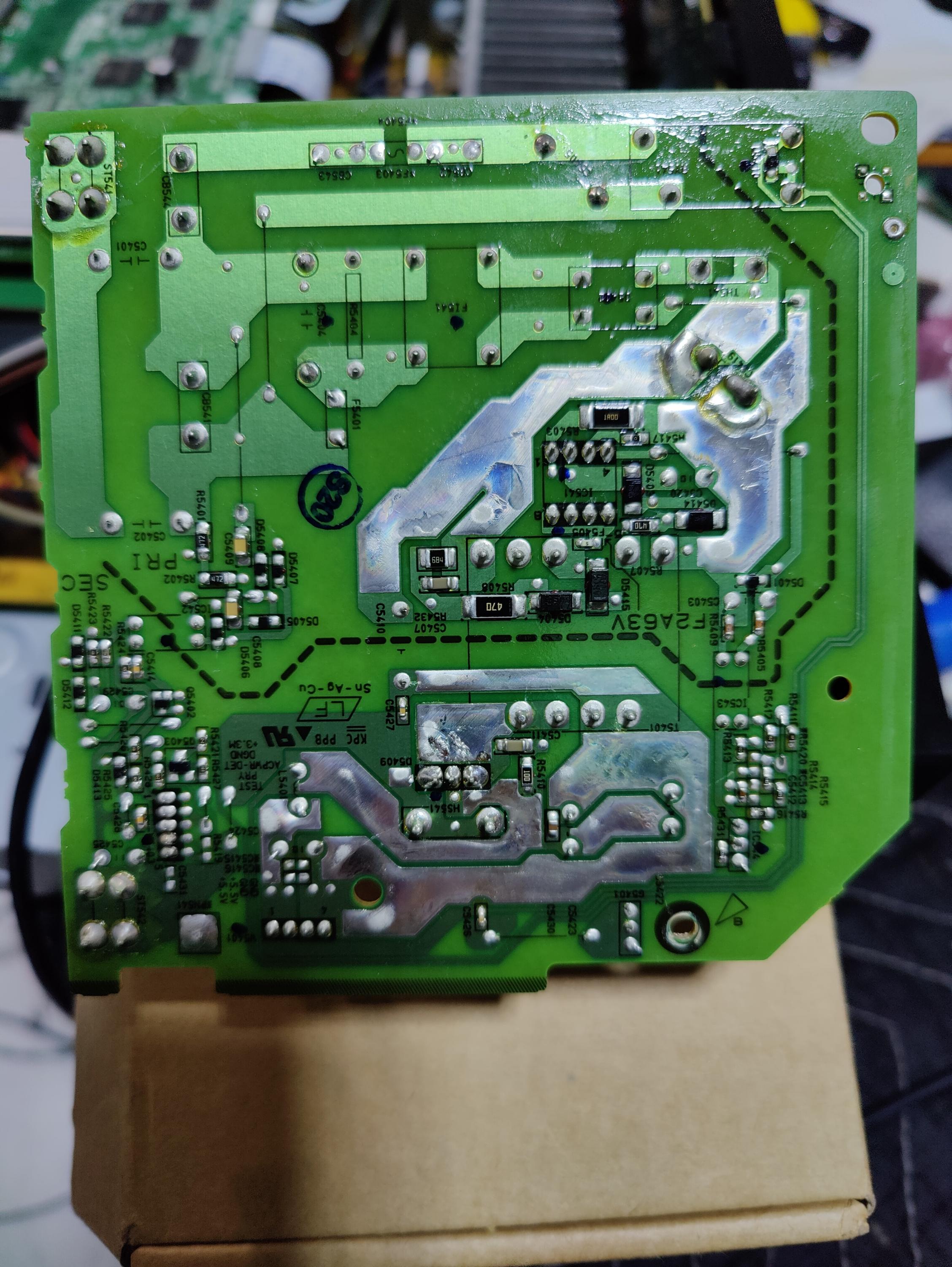

              C5420 replaced, R5407: 47ohm, transformer connection resoldered, no shorts.
                Are you getting any voltage at all on the secondary side across C5423? if not it may be that ic541 is bad and not operating, the circuit is very simple and only has a few components.
