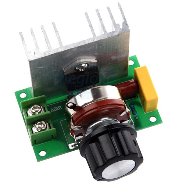

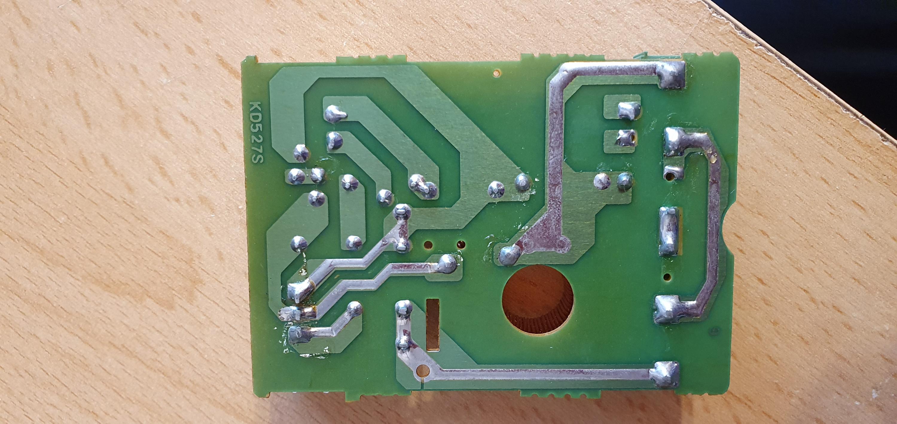

    Good day folks. What I'm trying to achieve may seem pretty simple and although I found lots of discussions on the topic, it's hard for me to settle on a definitive answer, so I thought I'd ask for more opinions.
    I have a small inline duct fan which looks like this, which I want to slow down, the reason being overall noise. I have no idea what type of motor this is, because I can't exactly take it apart to inspect it without ruining it, but perhaps we can work it out by examining its behavior.
    Two things I've tried: a variac and a cheap light dimmer (triac+diac inside of it). The variac worked great: as I lowered the voltage, the fan slowed down and didn't give off any immediate signs that I shouldn't be doing what I was doing.
    The dimmer was less than ideal: other than the fact that the motor slowed down considerably as soon as I moved the slider a small fraction, which made the slider virtually useless, the motor buzzed quite noticeably and I was afraid to let it run like this for too long, fearing the triac might pop.
    I also have one of these that I could try, but I reckon it's the same exact thing as the dimmer I just tried, since I see the same exact components, with the exception of the inductor. The light dimmer also has a large inductor, but other than that, they seem virtually identical: diac, triac, potentiometer, capacitor. I heard about different kinds of dimmers and stuff like "phase angle control", but wouldn't know how to measure and analyze any of this stuff without a scope, which I don't have. I think all garden-variety hardware store dimmers will be like this and wouldn't be much better...

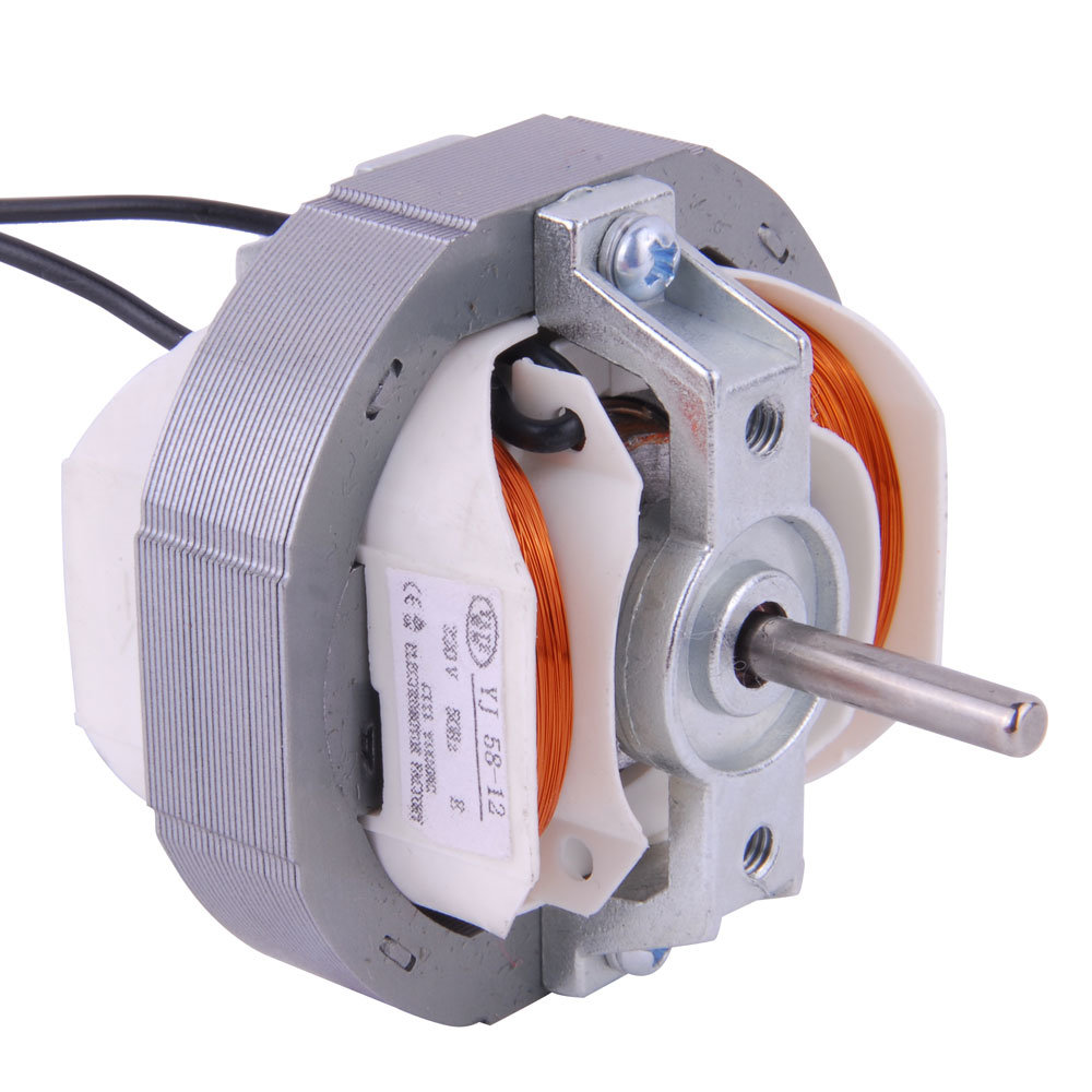

    Based on these observations, I believe we're dealing with a shaded pole motor ? The variac (transformer) solution seemed to work the best, but I'm definitely not going to dedicate a big variac to this one sole use, neither am I willing to invest in VFDs to drive a small motor, so I think I'll have to compromise.....

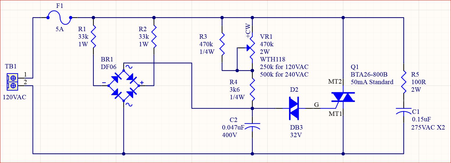

    Re: AC Fan motor speed control ideas
    http://electronics-diy.com/schematic...controller.png
      I belive that is a "dimmer", is it not ?
        M1 appears to be a motor

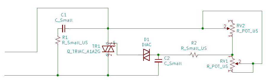

          But it could also be a lamp in the case of the dimmer
          Here: I drew the schematic for the ones I got off Aliexpress. They look about the same, save for the snubber (?) network on the left and the dual pot setup on the right (RV1 is a trimmer). I didn't bother to add values for the components too, so they're just as kicad spat them out....
            Yes these tiny boards all tend to be TRIAC phase control lamp dimmer circuits just like the wall mount.
            If cheap is the only way to go, that's what you get with phase control. The buzzing is expected, you can stick a inductor in series to dampen out some of the buzzing. Probably have to hack the pot/series resistor for more reasonable values for your motor - system behavior depends on the motor, control device, and also the load... together...
            There are specially made "motor" "dimmers" that you can get too... usually they're like "high" "medium" "low" "off" and not a continuous function in between.

                                OP, your fan uses a similar "round" shaded pole motor:
                                Use a triac based motor speed control; looks similar to a light dimmer but has off/hi/lo markings.

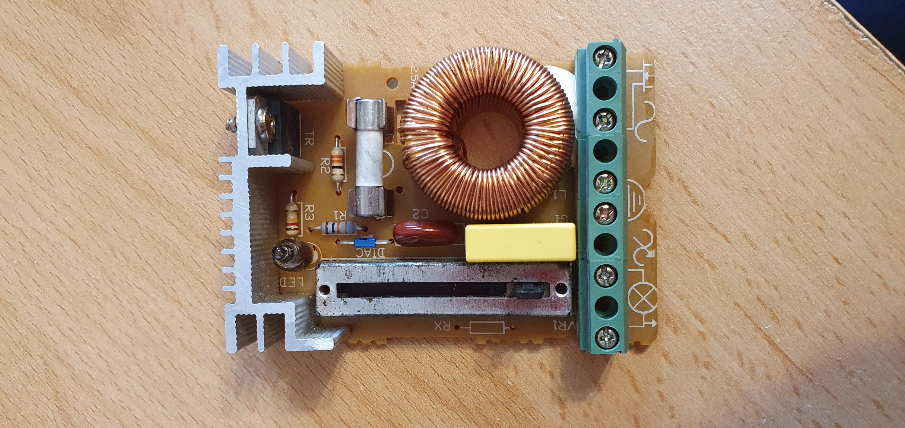

                                  Just for reference, here's also the first dimmer I tried - the one with the slider, whose buzz I wasn't too satisfied with. It actually does have the coil you chaps mentioned, so that's probably one positive thing going for it. I haven't analyzed it yet, but I reckon it's the same exact circuit thing as the one on Aliexpress, just with the coil and the little neon lamp, which I'm not sure affects the functionality in any way, other than to offer a visual indication of the setting.
                                  Trouble is, one faint nudge on that slider down and the motor already slows down a lot, so I'd probably have to modify it a bit...
                                  Still, I'd much prefer a transformer since it appears to run more smoothly, but what specs should the transformer have ? Should it be rated close to the same power as the motor ? Does the secondary voltage matter ? Do I just wire the primary in series with the fan ? If so, then with no load on the secondary (open circuit), would the fan run at its full speed ? My fan draws 14w according to its label, by the way.

                                    For better control range, a triac dimmer with the extra (cap reset) diodes works much better. I use the Ali "4,000W SCR" board (hint: it's a triac) with motors and fans and it works IF the pot is the right value for your mains voltage and other resistors are not just copied. This schematic is after I fixed it. No EMI inductor on it. Look for a small bridge rectifier to tell it's the right one.
                                    Your dimmer might just be junky and need resistors or trigger cap size tweaked. App note on dimmers AN1003

                                      I don't really need a range of speeds, but rather two settings: full speed and low speed ("quiet"), which I plan to use a time relay to switch between at certain hours when it's "nap time", so once I'm satisfied with the noise level, I would no longer adjust anything anyway, hence why fixed solutions like series resistance are also acceptable. A continuously adjustable circuit just makes it easier to find said sweet spot, as opposed to trying out different solutions which yield a single fixed speed at any given time, plus it's more professional and possibly more efficient.
                                      I came across those SCR devices like in the last picture, but thought they're the same thing as my triac setup and wouldn't perform any better in the long run, so I disregarded them...
