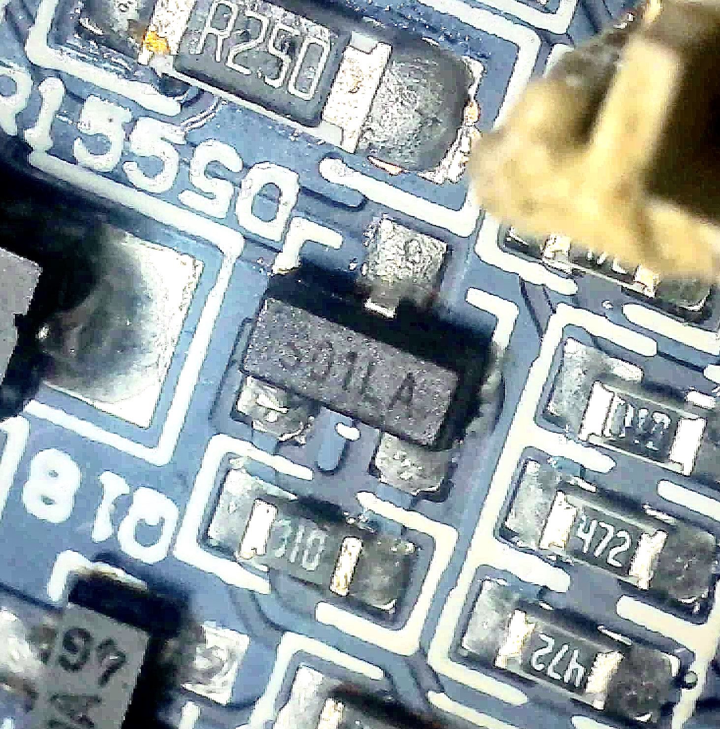

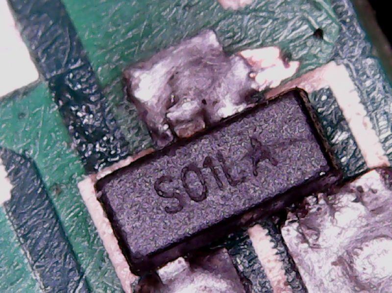

Vileda VR102 identify a component
  • Pr0jectN1ne
    • Aug 2019
    • 10
    • Ireland
    Vileda VR102 identify a component
    Hello, I need help identifying this component. Bottom right leg is shorted to the left side.
    Looks like it says 301LA.
    Thank you.
  • R_J
    • Jun 2012
    • 9535
    Re: Vileda VR102 identify a component
    It could be due to the low value of the resistor across the pins, is it marked as D5 on the board?
    Last edited by R_J; 12-08-2022, 09:56 PM.
    • redwire
      • Dec 2010
      • 3906
      Re: Vileda VR102 identify a component
      It looks more like smd marking S01LA but I cannot find it.
      • Pr0jectN1ne
        • Aug 2019
        • 10
        • Ireland
        Re: Vileda VR102 identify a component
        Originally posted by R_J
        It could be due to the low value of the resistor across the pins, is it marked as D5 on the board?
        Even off the board its shorted. yes I believe so its marked d5.
        • Pr0jectN1ne
          • Aug 2019
          • 10
          • Ireland
          Re: Vileda VR102 identify a component
          Originally posted by redwire
          It looks more like smd marking S01LA but I cannot find it.
          yea I tried 301LA, 501LA, S01LA but no luck.
          • R_J
            • Jun 2012
            • 9535
            Re: Vileda VR102 identify a component
            Originally posted by Pr0jectN1ne
            Even off the board its shorted. yes I believe so its marked d5.
            D5 would suggest a diode, how does it check to the center leg, It might be a dual diode, is there another one on the board with the same markings?
            • Pr0jectN1ne
              • Aug 2019
              • 10
              • Ireland
              Re: Vileda VR102 identify a component
              Originally posted by R_J
              D5 would suggest a diode, how does it check to the center leg, It might be a dual diode, is there another one on the board with the same markings?
              I followed the centre pin the ground of the motor that's not spinning for the brush. There's quite a few of same package but different markings.
              • redwire
                • Dec 2010
                • 3906
                Re: Vileda VR102 identify a component
                You'd have to trace out how the motor is switched on - is it this mosfet or a N-ch somewhere else. If it shorted I would think the motor will stay on.
                Otherwise this is a motor back EMF diode. It's not a (reversible) motor needing a 4-mosfet H-bridge?
                "S01" I found as SOT-23 P-ch. MOSFET by Samhop Microelectronics Taiwan.
                STS2301A -20V/-2.6A 95mΩ
                STS2301 -20V/-3.4A 60mΩ
                There's no marking code data on the website or datasheets to confirm. One part uses a 3 digit marking with tiny manufacturing code rotated.
                Many other generic makers of the 2301, as a NXP2301P, AO2301 etc. out of the third-world.
                • CapLeaker
                  Leaking Member
                  • Dec 2014
                  • 8118
                  Re: Vileda VR102 identify a component
                  I found an S01 as a FJX3001R pre biased NPN, SOT 323. I can’t tell if it is an S or a 3.
                  Last edited by CapLeaker; 12-09-2022, 09:53 AM.
                  • Pr0jectN1ne
                    • Aug 2019
                    • 10
                    • Ireland
                    Re: Vileda VR102 identify a component
                    Originally posted by redwire
                    You'd have to trace out how the motor is switched on - is it this mosfet or a N-ch somewhere else. If it shorted I would think the motor will stay on.
                    Otherwise this is a motor back EMF diode. It's not a (reversible) motor needing a 4-mosfet H-bridge?
                    "S01" I found as SOT-23 P-ch. MOSFET by Samhop Microelectronics Taiwan.
                    STS2301A -20V/-2.6A 95mΩ
                    STS2301 -20V/-3.4A 60mΩ
                    There's no marking code data on the website or datasheets to confirm. One part uses a 3 digit marking with tiny manufacturing code rotated.
                    Many other generic makers of the 2301, as a NXP2301P, AO2301 etc. out of the third-world.
                    I had a look again and I found another one the same for the other motor and that motor spins. I don't know much on this but I try.
                    • R_J
                      • Jun 2012
                      • 9535
                      Re: Vileda VR102 identify a component
                      Is the other device marked as D? if it is how does it check, does it check like a dual diode, or like a transistor?
                      Where is it in the circuit?
                      is it across the motor?
                      Post a clear picture of the whole area of the board
                      Last edited by R_J; 12-10-2022, 06:54 PM.
                      • redwire
                        • Dec 2010
                        • 3906
                        Re: Vileda VR102 identify a component
                        I think D5 is the large part under the Q18 silkscreen and might not apply. You can a current-sense resistor R155 as well.
                        Usually you'd see a N-ch. mosfet turning a motor on and off. If it's reversible, then a P-ch up top on the H-bridge.
                        The only part that doesn't fit is OP finds the part shorted yet the motor will not run. If true then there is another problem, or it's the gate shorted.
                        • lotas
                          • Jan 2016
                          • 4555
                          • Russia
                          Re: Vileda VR102 identify a component
                          Similar to ST2301A.
                          • R_J
                            • Jun 2012
                            • 9535
                            Re: Vileda VR102 identify a component
                            Thank you lotas, that sure looks like it.
                            So I guess the D5 designator IS for another component.
                            Last edited by R_J; 12-11-2022, 01:16 PM.
                            • Pr0jectN1ne
                              • Aug 2019
                              • 10
                              • Ireland
                              Re: Vileda VR102 identify a component
                              My apologies on not replying, Yes the gate was shorted.
                              I'm guessing this is the one. https://www.aliexpress.com/item/4000312333823.html
                              Thank you so much for all the help. Hope it works.
                              Shall i upload a full pic?
                              • 5mall5nail5
                                Help identifying connector for ASUS 4090 Strix RGB LED connector
                                by 5mall5nail5
                                Hi All -
                                I had replaced my ASUS 4090 Strix cooler with a waterblock and put the stock cooler on the shelf. Was moving it and snagged my sweater on the connector and pulled the wires out of the pins on the RGB connector. I tried to get them back on but its too small so I opened the stamped pins and tried to solder but its not a good repair and the wire broke on reinstallation.
                                Looking to replace the connector on the cable side and get pins to crimp onto a new cable. Bought random JST and such but nothing is correct. Can anyone help identify the connector and possibly matching...
                                05-04-2025, 07:47 AM
                              • thesame
                                DVR HIKVISION DS-7208HWI-E1/A BOARD DS-80104 REV 2.2 help identify burnt components
                                by thesame
                                Hy guys , i have a DVR board DS-80104 REV 2.2 that was powered wrong, i have some smds on the board that are blown and i can't identify them , maybe if someone has this board somehow and we can identify the smds', i have searched online and i can't find a schematic.
                                The smds are SOT-23-6 , one of them i think it has the marking ADJF since i found another one on the board with this marking , but the other one it seems that it starts with AG or it looks like. I would really apreciate if someone could help me identify those IC's .
                                02-27-2024, 04:31 AM
                              • silver60618
                                Lenovo Legion 7 - Help Identify IC
                                by silver60618
                                Hi gang, its a long shot, but working on Lenovo Legion Pro 7 motherboard NM-F091, and trying to identify this component near GPU with marking "eHFQH" that is burned and shorting the board. Looks like power management IC
                                I couldnt find any schematic or boardview. The CPU side also has same chip. Any way to identify this chip? or take measurements from the good chip to determine what it is?
                                Any help would be appreciated...
                                07-02-2025, 12:16 PM
                              • chth96
                                How can I identify varistor which have been blew up?
                                by chth96
                                I mistakely pluged 100v japanese retro game console to 220v outlet.
                                So It seems that glass fuse and varistor have been blew up.
                                I can identify that voltage and ampere value of glass fuse(250V LF 1.6A),but It is impossible to identify varistor type in my sega saturn PSU(YAMAHA 35M07U XR258)
                                Is there any way to identify varistor type in my sega saturn PSU?
                                Any reply would be appreciated.
                                EDIT:
                                It seems that I finally found out what type this black varistor is. It is Panasonic ERZV05D221 “ZNR” Transient/Surge Absorbers (Type D) Varistor Voltage...
                                11-26-2023, 08:52 AM
                              • avneeshshrotria
                                Mac Pro 5,1 2010 CPU Tray Damage
                                by avneeshshrotria
                                Hey guys ,
                                Need assistance with a Mac Pro 2010 5,1 single cpu , cpu tray .
                                Ive bought the computer used , it’s really been through a hard time.
                                Someone has managed to pull components off the bottom side of the cpu tray!!!
                                I need assistance in identifying the components and the values of
                                1. CG410(missing)
                                2. Q2400(TWN. Marking on it) , Q2450(TWN. Marking on it) (this marking does not correspond to any specific IC as far as I can tell , need help to identify!l )
                                3. Q2120 (missing) ,
                                4. R2444(missing)
                                Im attaching a couple...
                                04-11-2024, 02:20 AM
