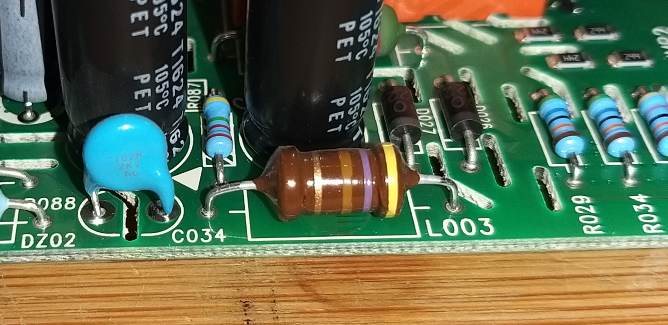

    Condenser tumble dryer component id
    Any idea what ohm this resistor should be?
    Reads, in-circuit, 2.2ohm with board disconnected but looking it up should be a 270ohm resistor. My eyes are seeing 4 bands - yellow,violet,brown,gold.
    The components either side of it read higher values so don't see the need to remove from the circuit i.e diode, caps and resistors seem ok.
    And what wattage is this likely to be? 3W

    Re: Condenser tumble dryer component id
    that's an inductor, if it has low resistance then it's o.k.
      Out of circuit the resistor reads 2.2 ohm, same as in circuit.
      It must be a 2.2 ohm res, if it was bad it would be open circuit, not shorted! Right?
      Thanks, just saw your post. And oh yes. just noticed the L003 ref on the board too, doh!
        It is a 470 microhenry coil, NOT a resistor, the 2.2Ω is likely your meter leads plus the inductor DC resistance which is likely under 1Ω.
