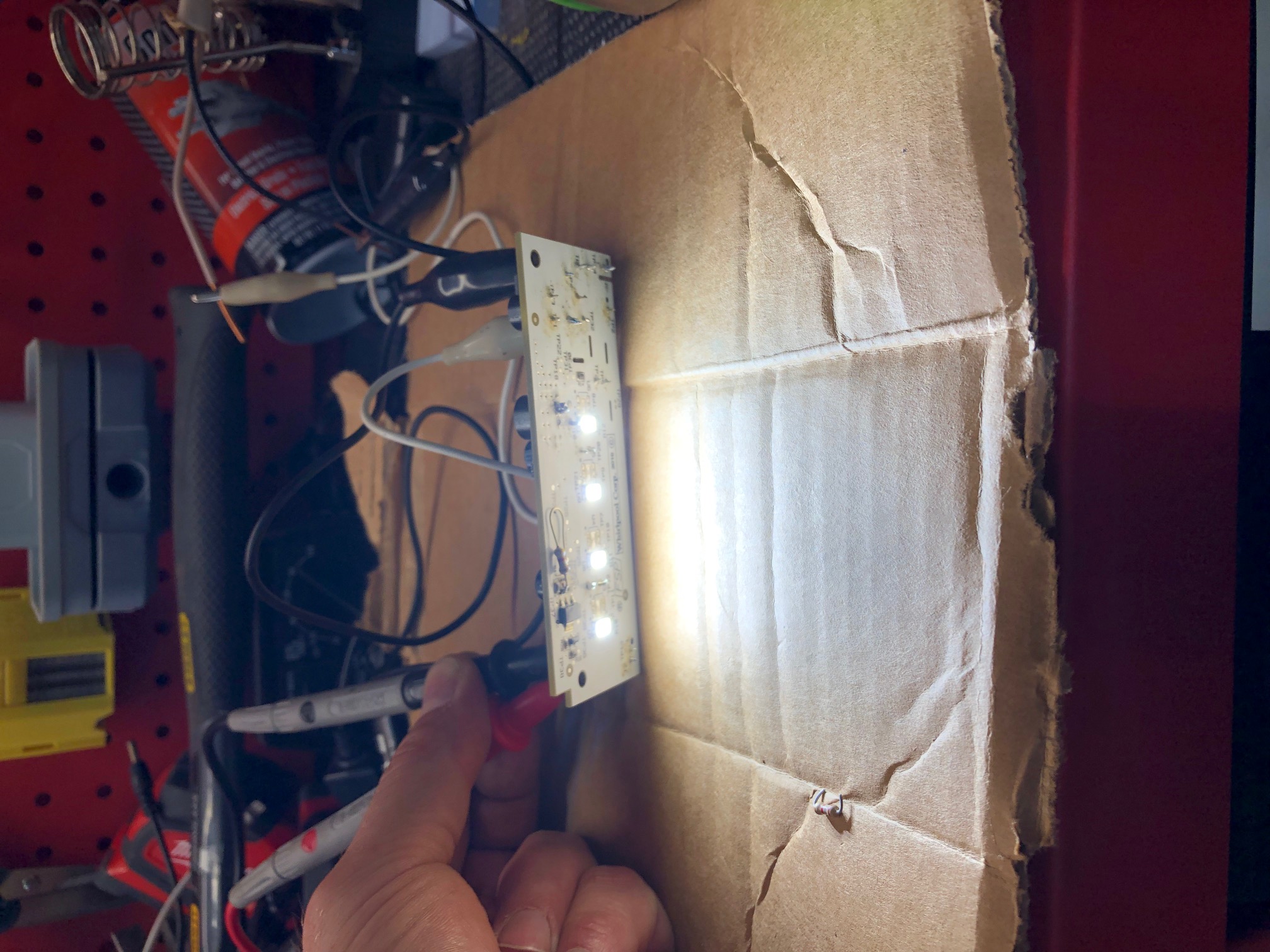

Whirlpool Refrigerator LED lights flickering
  • Dave125
    replied
    Re: Whirlpool Refrigerator LED lights flickering
    Originally posted by Kenmore
    Bluto -
    I'm facing the exact same problem on a Kenmore fridge; apparently many domestic fridges used the same set of three Whirlpool LED PCBAs.
    However, on my control board, R15 (LED side of the board) is obviously toasted. Since your R15 appears to re unaffected, could you tell me the value marked on your R15?
    The adjacent R17 is unaffected, and is marked 910 ohms. I've done a lot of research on this problem, and others have reported both R15 and R17 as having been grossly overheated, enough to obliterate the markings. I have not been able to locate a schematic.
    I'll take some photomicrographs of the toasted R15 on Monday, and post them here.
    did replacing R15 fix the problem?
    Leave a comment:
  • bluto
    replied
    Re: Whirlpool Refrigerator LED lights flickering
    Originally posted by Kenmore
    Since your R15 appears to re unaffected, could you tell me the value marked on your R15?
    My R15 reads just under 138 ohms. It looks like the number is starting to blacken, I think the code number is 1370 which would be 137 ohm +/-1%
    Leave a comment:
    replied
    Re: Whirlpool Refrigerator LED lights flickering
    If you replace LEDs modules
    I would recommend that you look at the specifications of the type LED that you will be using
    and make sure that they are not being over driven by too much current and voltage you will need to know how these LEDs are wired this is going to be very important to know
    Last edited by sam_sam_sam; 04-15-2019, 05:40 PM.
    Leave a comment:
  • Kenmore
    replied
    Re: Whirlpool Refrigerator LED lights flickering
    Bluto -
    I'm facing the exact same problem on a Kenmore fridge; apparently many domestic fridges used the same set of three Whirlpool LED PCBAs.
    However, on my control board, R15 (LED side of the board) is obviously toasted. Since your R15 appears to re unaffected, could you tell me the value marked on your R15?
    The adjacent R17 is unaffected, and is marked 910 ohms. I've done a lot of research on this problem, and others have reported both R15 and R17 as having been grossly overheated, enough to obliterate the markings. I have not been able to locate a schematic.
    I'll take some photomicrographs of the toasted R15 on Monday, and post them here.
    Leave a comment:
  • redwire
    replied
    Re: Whirlpool Refrigerator LED lights flickering
    I kinda thought an LED is to blame, see all four have the "black dot of death" in pics?
    Maybe the primary cap failed and then it hiccuped and killed the LEDs. It's not like they run for very long or get hot (in a fridge), unless Whirlpool overdrives them.
    It looks like the PCB uses SMD 5630 LED's with 4-pin package and thermal pad, around 1/2W ea. Also has footprints to take SMD 5050 6-pin LED with thermal pad. I'd order a bunch of new LEDs.
    All that electronics to light up four LEDs with fade effect. 38 testpoints
    Leave a comment:
    replied
    Re: Whirlpool Refrigerator LED lights flickering
    are the led's in series though??
    Leave a comment:
  • bluto
    replied
    Re: Whirlpool Refrigerator LED lights flickering
    Oh noes, the flickering is back today! Arrgh... I don't know what to do next.
    Maybe isolate the fade in bit and just tie the gate voltage of that transistor to Vcc? I might have to buy another one so I can experiment on the original.
    This thing really shouldn't fail en-mass like what I have seen online as described above.
    @stj, I don't think it is a bad LED because all 4 along with the other two LED modules connected to the output port are all acting up at the same time (intermittently).
    Leave a comment:
    replied
    Re: Whirlpool Refrigerator LED lights flickering
    it's probably a bad led, i see the board is designed to take 2 different styles.
    Leave a comment:
  • bluto
    started a topic Whirlpool Refrigerator LED lights flickering
    Whirlpool Refrigerator LED lights flickering
    I have a Whirlpool side by side fridge that is not even 2.5 years old. Recently the LED lights inside the fridge and freezer started acting up. Instead of fading on when the door was opened, the lights would just flicker slightly. Closing the door and re-opening would seemingly fix the problem. The problem was intermittent, but I figured it was only going to get worse so I decided to do something about it.
    After some Internet searches, I determined that I was not the only with with this problem. There were dozens of reports of the problems with the same light module as what is in my fridge (W10515058). There were people that said they light failed when the fridge was just 19 months old. Some folks said they replaced the flickering module (spending between $75-$150) and it failed again in a year or two. There were some helpful videos on removing the module that also had some dubious fix suggestions.
    To start with, I removed the module following the instructions in this video: https://www.youtube.com/watch?v=pCY2iaOFgN8
    The module has two connectors. The first provides 120v to the board to power the lights when either the fridge or freezer door is opened. The second connector provides DC power to the other lights in the bottom of the fridge and freezer. Once this module is removed, all lights in the fridge will not function.
    Upon examining the module, the first thing that strikes me is how well it is made. It is a multi layer board with mainly SMD components. It also has a conformal coating over the board and all components. There is no fancy control logic chip, so I would surmise that the the fade-in effect is orchestrated by a simple resistor-capacitor timing circuit. And this board operates in a nice, constantly chilly environment for 15 to 20 seconds at a time... So what excuse does it have for not lasting 10+ years?
    I am going to take a stab at this and say that the problem is with one of the electrolytic capacitors on the board. There are a total of three of these capacitors present, a 3.3uf 400v (C6) and 2x 100uf 50v (C7 + C8). The first one appears to be the primary side filtering capacitor as it is near the 120v connector and in between the 4 diodes that seem to be the rectifier. The issue that I see is that the brand of this capacitor is 'Lelon' which happens to be on our bad capacitor list here. The other two caps are 'Nichicon' which are on our good list.
    EDIT: Replacing C6 did not solve the problem! I am still working to find a permanent fix and will update the thread when a solution is found.
    EDIT: September 2021:
    port443 seems to have found the solution to fix these boards:
    Originally posted by port443
    Confirmed and solved.
    My board had burnt-looking R15 with board lacquer damaged on top of it.
    Board needs 320+ degrees Celsius of iron temperature to melt the lacquer.
    Soldered 150 Ohm 1/2 W huge resistor in place of that bugger: there's a lot of space available around.
    Looking at all discussion, it looks like a design mistake: the wattage of resistor was not calculated right.
    slim_jim also fixed his light and noted:
    Originally posted by slim jim
    I repaired mine this way also. My original R15 chip resistor was scorched but not blown. One end had broken free. The old resistor checked 135 ohms.
    The light fade-on effect is absent, possibly because I used a 150 ohm resistor instead of 135.
    Thanks port443.
    Last edited by Per Hansson; 09-27-2021, 10:17 AM. Reason: Add: Edit September 2021
  • reessi
    ACER BM320 Monitor - Horizonal Flickering Lines After a While
    by reessi
    The monitor started off showing flickering thin (1 pixel) lines horizontally every say 3mm..
    They are black on the right and gradually fade to nothing on the far left.
    They start either after 5 mins or up to 2 hours after so annoying for testing.
    They flicker continuously very fast! With a slight pause milli-second every second.
    Initially I cleaned the LVDS cable and connected to the T-Con and then it worked fine for 3 weeks but not sure if this was just co-incidence.
    I tested each half by removing the first the left flex from...
    06-03-2025, 09:58 AM
  • wnlewis
    Whirlpool RDE3340W electric Range needs On-Off-On rocker switch, McGill 0801-1059, FSP 686605, Whirlpool p/n 865745
    by wnlewis
    I am trying to track down a replacement rocker switch for a Whirlpool RDE3340W electric range.
    The rocker switch was made by McGill under their part number 0801-1059 and supplied to Whirlpool by FSP under their part number 686605. Whirlpool's original part number was 865745.
    The switch is an On-Off-On type (SPDT) designed for use with either 115 VAC or 230 VAC. It is not lighted.
    Are there any current switches that could be substituted for this switch?
    01-04-2025, 09:32 PM
  • DrvLikHell
    Fixing an I-Inc IF281D for the 3rd time, now with added flickering!
    by DrvLikHell
    Hello everybody! It's been nine years and I'm back again with the same monitor that several people here helped me fix back then. The first time, I replaced two caps as was recommended here and the original problem was solved. Then it started acting up a few years later and I came back for a parts list and replaced a few more caps (I didn't make a post about that and don't remember which ones), and again the problem was solved. This time, however, I'm not sure if it's caps.
    The monitor stays on but certain colors will flicker. Generally it's darker colors like dark greys or dark blues,...
    07-05-2024, 02:54 AM
  • mikey5791
    Help repair Panasonic fridge not cooling
    by mikey5791
    Hi all forum members,
    Few days ago, i might have forgotten to close my home fridge freezer door completely. The next day, the ice cubes and frozen meat almost melted halfway and the freezer doesn't feel cool. I shut it off, wipe dry and let it air dry for one whole day. The next day i switched on the fridge, the compressor run for a second and it shuts off(no vibration and no sound at all) only the internal freezer compartment fan is running but is not cooling even i switched on a full day.
    After shut off, i dismantle the rear water pan holder and reached to the compressor wiring....
    07-16-2025, 02:01 AM
  • Jaysean
    Acer VN7-591G-70RT Display Flickering
    by Jaysean
    Hello Badcaps coummunity hope you all are having a bless day,
    Hope I didn't post it wrong kinda new at forum site rules and tradition
    So I'm dealing with screen flickering problem on my laptop.
    I'm not quite sure if it's the display cable or the screen itself that's causing the issue,
    so I'm turning to you all wonderful expert on Badcaps for some guidance. Your help is much appreciated!
    [Screen Flickering](https://i.imgur.com/xK9vHqc.mp4)
    [HDMI port to external display seem to work be working](https://i.imgur.com/snSC24e...
    10-27-2023, 10:22 AM
