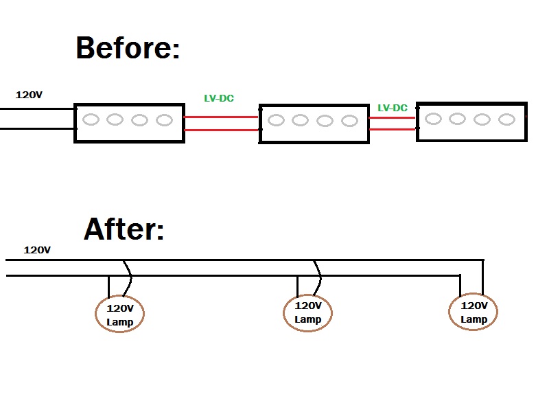

                    • bluto
                      • Oct 2007
                      • 560
                      #30
                      Re: Whirlpool Refrigerator LED lights flickering
                      Originally posted by Log_on_Bob
                      OK, here is the link to the outfit that used some LED found at Home Depot for all three lights and though I have not looked at the other two lights there appears the other two have their own circuit boards. They are a business and most likely why exact part used is not mentioned, I get it.
                      https://sunnyappliancerepair.com/ref...n-jose-ca.html
                      The guy in that link did exactly what I was suggesting. Except he cut off all the connectors in order to just crimp connectors onto the ends of the wires. What he has done to the two down line lights is to feed them 120v instead of DC output of the top LED board. So the lights are all getting 120v (wired in parallel)
                      Edit: I studied the pictures in the blog post a little more and this may not work... The output plug on the top LED has red & yellow wires. The lower fridge light has what looks like red and gray wires. And the freezer light has yellow and gray wires. The lower fridge and freezer lights will have to be in series. I guess a 120v LED might work with only 60v, but more study is needed.
                      Here is a diagram:

                        I would try fit in a COB LED board with 110V circuit $0.99 on fleaBay, 3W.
                        The larger square COB boards are are too high power, at >30W.
                        A G9 LED bulb might work too.
                        Some irony a simple circuit is 50X cheaper than what Whirlpool came up with, for a 4W LED fixture.

                          • bluto
                            • Oct 2007
                            • 560
                            #33
                            The lower fridge and freezer lights connect to the second connector. On those the modules the circuit board looks the same but it is only populated with the LEDs, all other components are omitted. The arrangement is that all the LEDs are in series. If you unplug the lower fridge light or the freezer light, all three will stop working.
                            See my diagram above for a visual representation.
