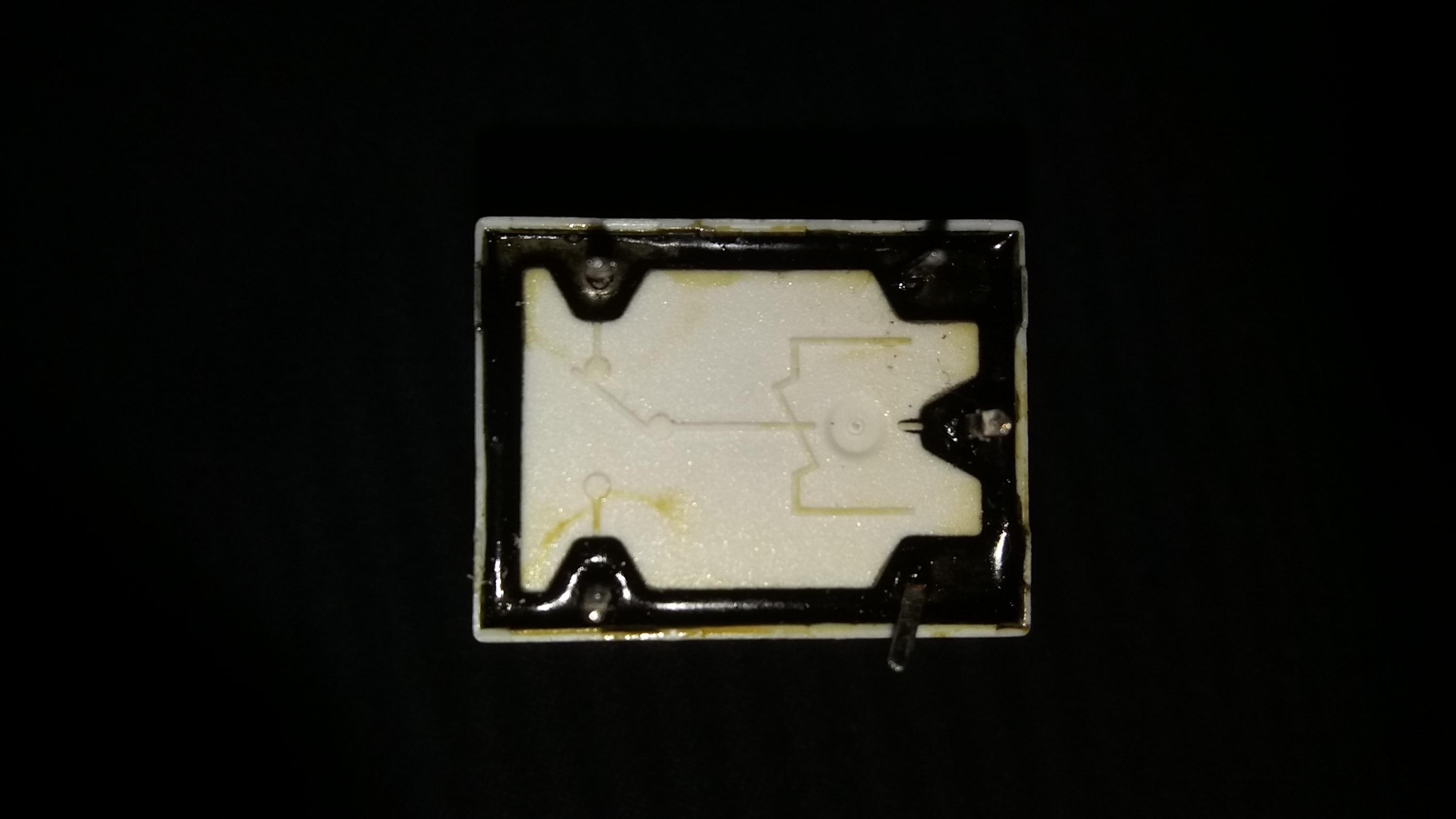

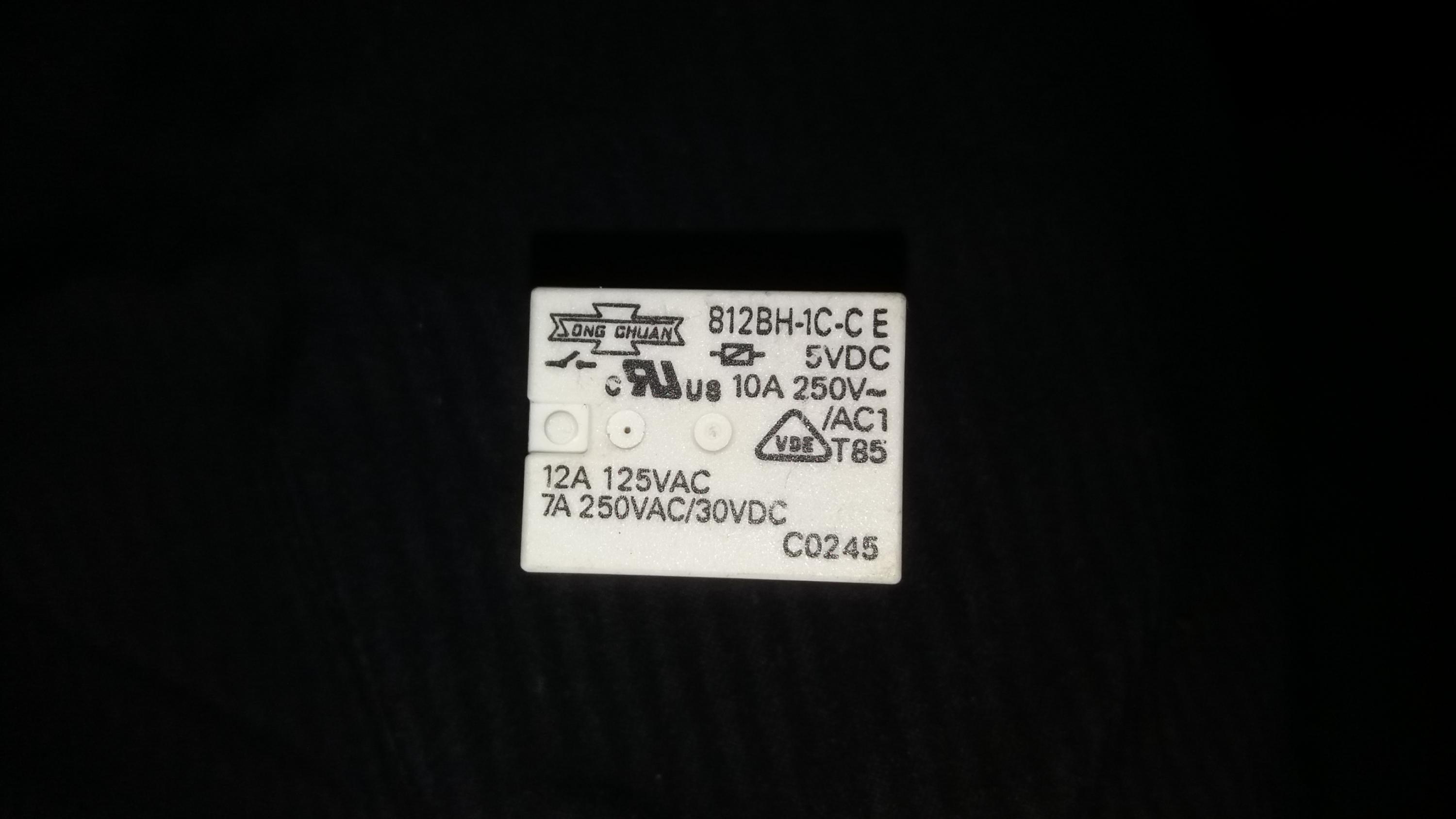

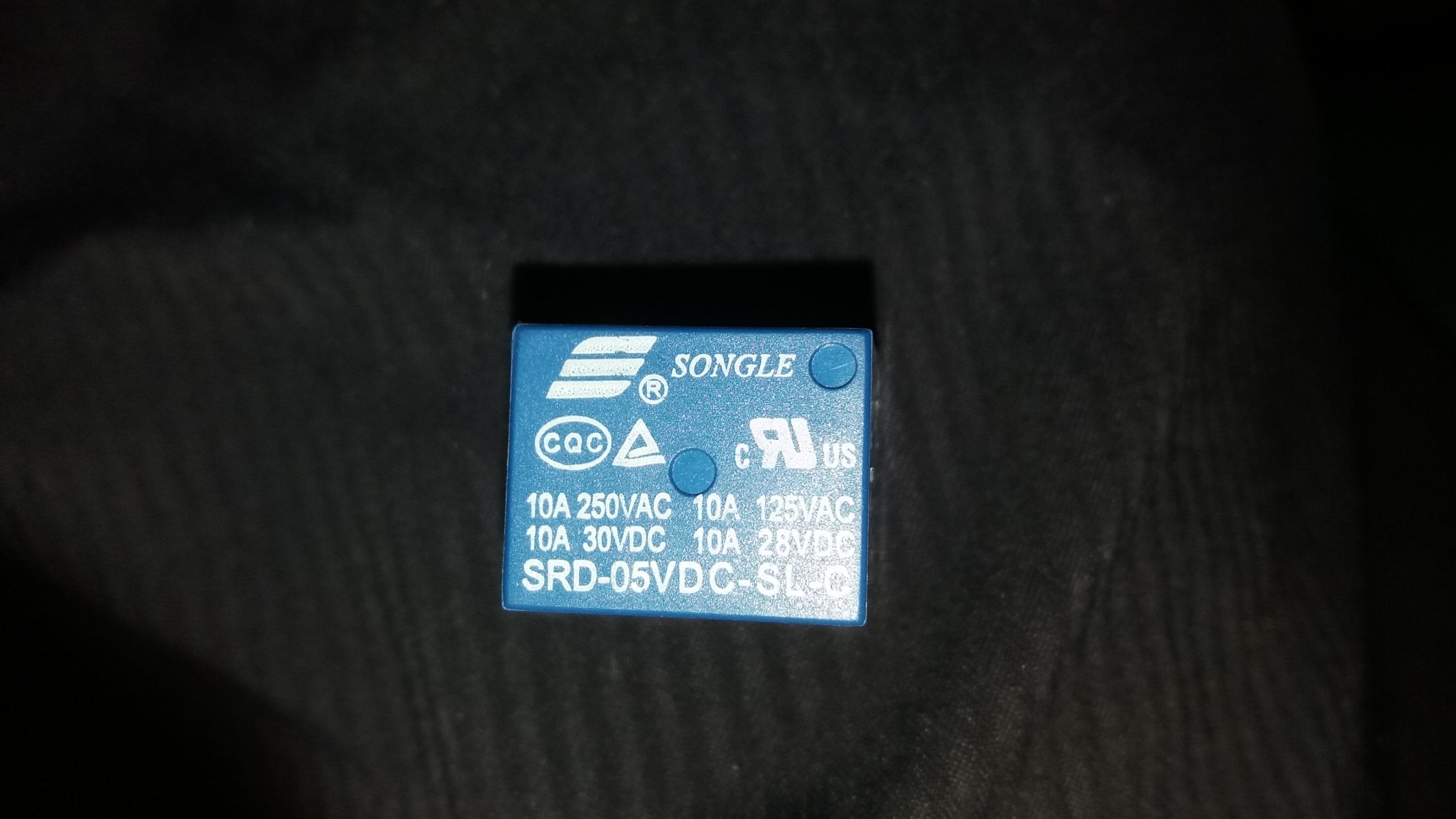

    Found the circulation motor pump relay stuck in its normal state so replaced it with a spare from my parts drawer.
    Is the blue relay a suitable replacement?
    What possible problems could have been caused by the relay being stuck in its normal state, in this instance normal state is running the motor via the 8uF starter cap.
    Does the illustration on the white relay indicate its normal state i.e when not energised

    i think the blue one is better.
    try it - nothing to lose.

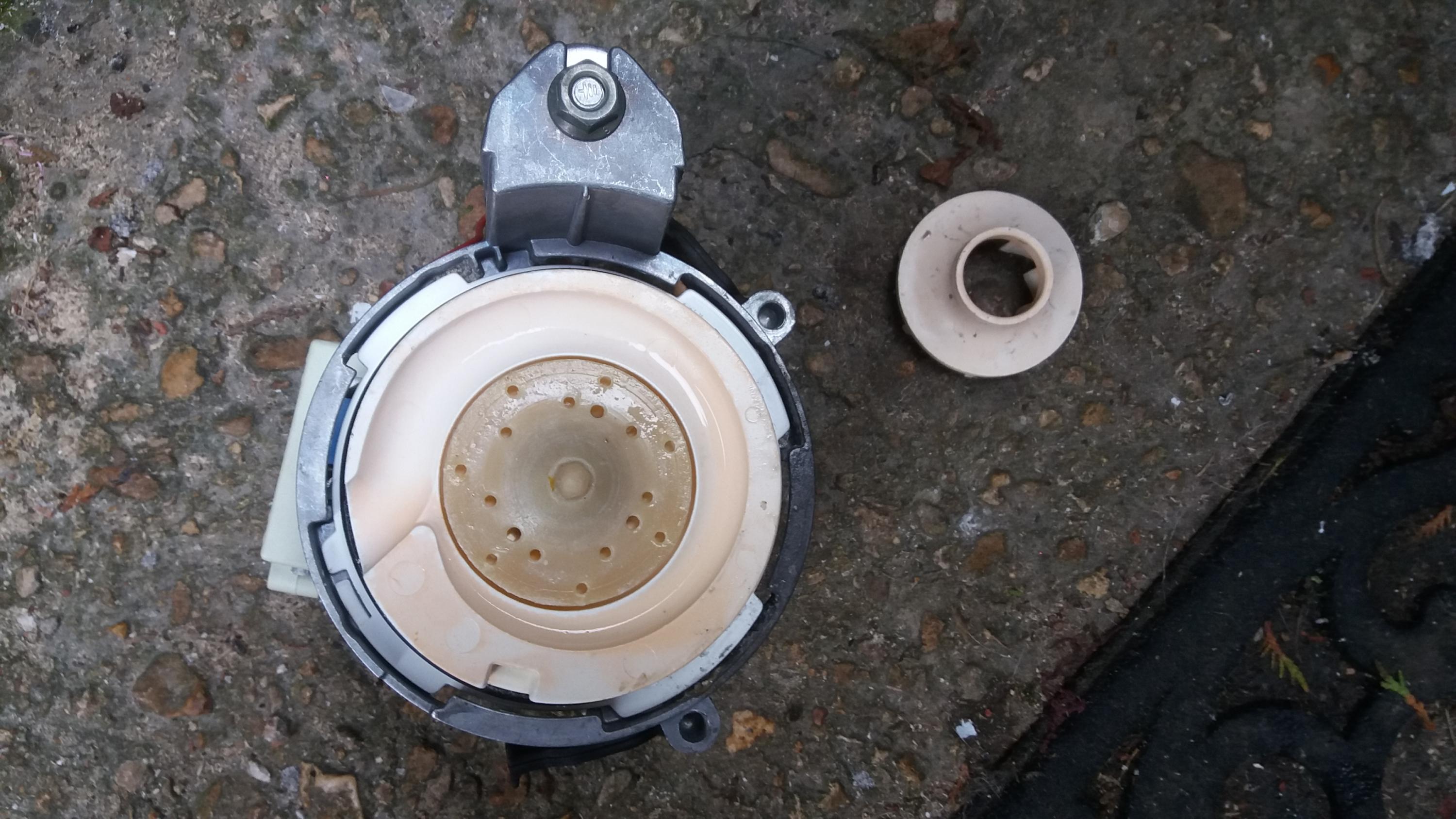

            I think stripping it down is the only way to be sure but having had another look at the motor, limited access whilst assembled, it would seem the impellor is in 2 halfs.

                well it would seem the impellor is in 2 halfs. the impellor half has separated from the screw on rotor plate ( one half is blue and the other white, the blue impellor half has little lugs that locks into holes on the rotor plate, the lugs have worn down and no longer stays on the rotor plate properly)
                it was kind of 'locked' into position but obviously when the motor spins up it was throwing the impellor off the rotor plate and possibly only sometimes locking into position
                as a temporary measure I have glued the impellor to the rotor plate, blobs of glue on the lugs, put back together and hey presto, pressure back and spray arms rotating again!
                replacement recirculation motor seal kit incl the impellor is £43 incl postage, (if that one fits my model) so that might be a good investment but will have to strip it completely down again, no leaks yet which is common when reassembling.

                  are these "lugs" on the edge, or more inward?
                  maybe you can drill them out and put metal in instead - like grubscrews for example.

                    i did consider that but happy to settle for the glue for now, not sure if or how long it will last especially with hot water but may consider that if it fails again.
                    the lugs, theres about 14 of them, are actually on the fins so might not be possible
                    this is the only photo i took, stoopid me, should know better!

                      it almost looks like an epoxy, like it had the fins held in it while it cured!!
