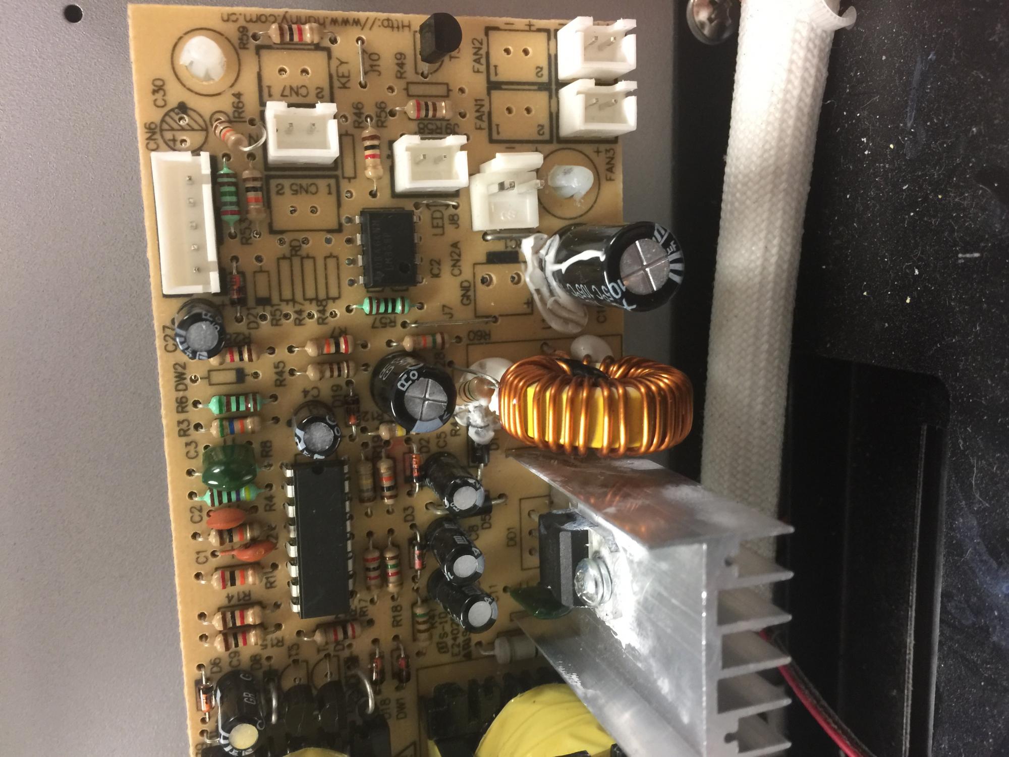

        Re: Cuisinart wine cooler P/S board problems
        Here is a picture of the secondary side.
        • CapLeaker
          Leaking Member
          • Dec 2014
          • 8228
          So there are two choices:
          A: The secondary on the PSU can't handle the current. - Do a load test.
          B: There is something wrong with that front board (shorted?) and it loads the PSU down.
          Personally I would go with B. Check the resistance between the positive and negative pin on the front board, unplugged from the PSU.
          Is that high pitched ringing still there when the PSU is just powered up by itself without any boards connected to it?
              I powered the front board by itself with a bench power supply. It works perfect. I did this to eliminate the front board.
              Yes ringing is still there with everything unplugged from the board. So the issue has to be in the secondary side? To be honest with you guys I am not sure how I would load test this board. The two IC's on the secondary side are a PWM controller and an opamp just in case you are wanting to know.
                What is the PWM controller part number? KA7500? TL/DBL494?
                Get datasheet and check voltage going to the Vcc pin of the PWM controller. If okay, check all of the small caps near the controller.

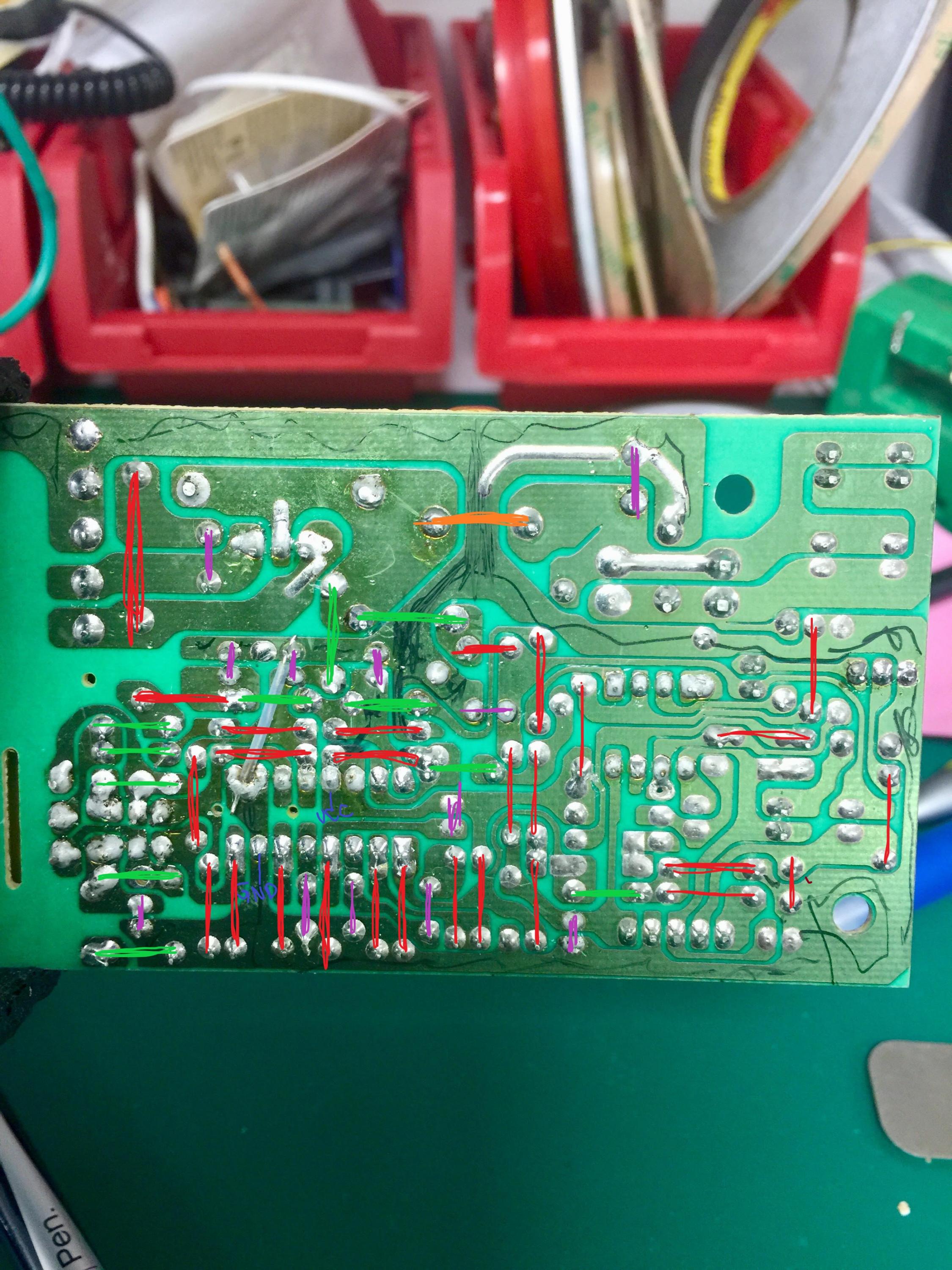

                                #35
                                Hey guys SO I tested all caps Electrolytic and ceramic on the secondary side. all are showing correct capacitance. I am getting a little lost in following the VCC trace. Would love some help with that. I took a picture of secondary side of board and drew in the areas where components were.
                                Red is resistors. Green is DIODE's , Purple is Capacitors. I didn't do Transitors or jumpers or connectors. The BLACK scribbly mark is the ground plane.
                                I did measure voltage on the Schottkey Rectifier I believe I did it correct. Negative on center pin "K" as the data sheet calls it and then measure both sides. I get 8.7v for a1 and 8.7v a2. I don't have any experience with these so excuse my ignorance. The heat sink on the Primary side does get warm. Just felt I should include that.
                                I did double check the transistors and the diodes they test good. Doubled checked the BJT's and the diodes and caps again on the primary. all tests good as well.

                                  #36
                                  Correct capacitance doesn't tell the full picture. For electrolytic capacitor, you can have correct capacitance and bad (high) ESR. This doesn't usually happen very often with the big caps but is a fairly common failure mode of small caps. So if you have no way to test the ESR, it's best to replace the caps. If you don't have any caps in stock with the same voltage/capacitance as the ones in the PSU, just add a few in parallel to the ones already in the PSU - particularly with the output filter caps: that is C28 and C10(?) (the cap next to the output inductor - I can't see its designator on the pictures).
                                  Also, for ceramic caps, you can have high leakage current, especially when they heat up. That's why I suggested changing ceramic cap C17 as well (the snubber cap), as it looks a bit darkened from heat.
                                  No problems! Thanks for providing that marked image - made tracing just a bit easier for me.
                                  So first off, it looks like you have Vcc mis-labeled on your image. It should be the pin to the left of the one you labeled "Vcc".
                                  That said, half-bridge PSUs usually have two supplies for the Vcc, and hence two paths. But I only see one path... though that is probably due to the fact that this PSU doesn't have a stand-by transformer. Regardless, let's follow it and see: you have a rectified (but unfiltered) voltage coming straight from main rectifier DD1 and going into diode D5 anode. Electrolytic capacitor C8 is the filter after diode D5, and that is what feeds the PWM's Vcc pin *once the PSU is up and running*. Since your PSU does appear to run correctly without a load, we can safely assume that whatever is powering the PWM before the main PS has started, is working fine (otherwise the PSU wouldn't start at all). To remain functional, the TL494 PWM IC must have at least 7V for Vcc *at all times*.
                                  Now if cap C8 is bad (which I suspect it is), a sudden demanding load on the output of the PSU can cause a the voltage at rectifier output DD1 to drop quite a bit before that coil. If C8 is bad, the Vcc voltage for the PWM IC could drop below the minimum threshold and cause it to shut down, followed by a restarting of the initial power-cycle. But if the heavy load on the output of the PSU is not removed, it will cause the same condition to re-occur again shortly after the PSU starts - hence why the PSU may be stuck at 7-8V on the output when it is loaded.
                                  Of course, we can't know for sure if that is what is happening now, unless you have an oscilloscope and can scope out the PSU output and PWM Vcc rail. So the better solution is to replace C8 and the rest of the caps on the output of the PSU.
                                  Or alternatively, there is another test you can perform to verify if that is the problem, but this test is a bit dangerous and can blow up your PSU again. Essentially, you connect a 10-15V power adapter to the output of D5 / positive leg of C8 / Vcc pin of the PWM IC. This will keep the PWM IC operational even if the voltage on the output of the PSU drops. However, as this is a very simple h-bridge PSU probably without any protections, it likely relies on the output dropping low (and consecutively the PWM IC's Vcc) to make the PSU shut down in case of a short-circuit or overload on the output. So with the power adapter, the PWM IC can continue to drive the PSU even with a fault, and thus make the primary transistors blow up again.
                                  So I don't advise you try that test. Or if you do, put a 800-1200 Watt appliance (toaster / mini oven / sandwich grill / hair drier / heat gun) in series with the PSU's mains. That should allow enough current to flow to the PSU even under load, but limit the current quickly in case of PSU fault so that nothing blows up.
                                  But better yet, just replace those damn caps on the output so we know they are not at fault for sure. Otherwise, I'm not sure what else to suggest for you to test if you say there are no other bad parts and everything checks out fine.
                                  Though not exactly a correct way to check a diode... given the voltages you measured (8.7V would probably be AC, which multiplied by the square root of 2 gives approx. 12.3V for the output), that schottky diode should be okay.
                                  Now, the correct way to measure a schottky diode/rectifier like that:
                                  Put negative/black (-) multimeter probe on the cathode (K - typically the middle pin for standard rectifiers) and the positive/red (+) multimeter probe one one of the outer legs of the rectifier. With the multimeter set to "diode test" (should have a little diode symbol on your multimeter's dial), you should see a voltage drop of 200 to 800 mV (on some multimeters, it will display as 0.200 to 0.800), depending on if the rectifier is schottky or regular fast rectifier (fast rectifiers have higher voltage drop.) Now do repeat the same procedure for the other leg.
                                  Once done, repeat that entire procedure again with the multimeter probes reversed. If the diode/rectifier is okay, you will get nothing/no reading on your multimeter's screen (i.e. either an "OL" for auto-range meters or a "1" on the left side of the screen for manual-range meters).
                                  Of course, all of that above is how a rectifier will measure **outside** of a circuit. Inside a circuit, you may have various loads give you a reading no matter which way you place the probes. So do beware of that. But typically you will still get a normal diode reading in the forward directions (i.e. black probe on cathode and red probe on anode). A shorted diode/rectifier will show 0 or near 0 voltage drop regardless of the orientations of the probes.

                                          #40
                                          OK I found a 10ohms and 2 ohms resistor that is bad next to the NPN transistors on the primary side. I must of missed them before.......
