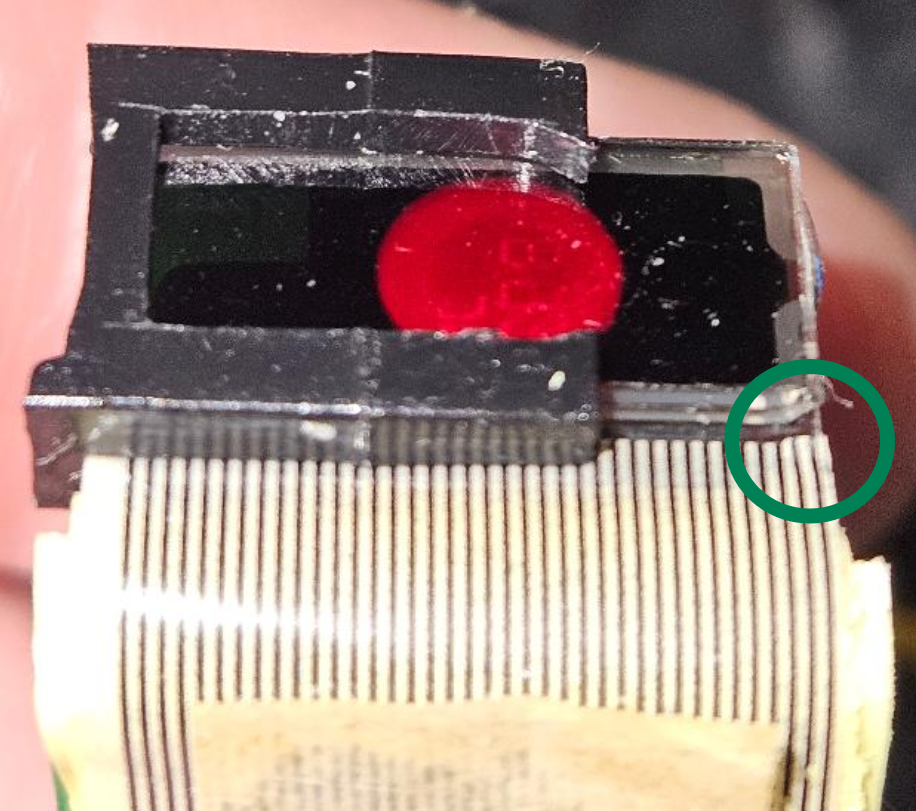

    alarm clock radio Oregon Scientific RRM320P, it projects the time on the seiling.

    However only part of the segments is lighting up. Any idea what could be behind this issue?
    Note I'm NOT talking the main display here.

    I think it has something to do with this band/cable peeling off of the glass. Manipulating with it I can see the segments going on/off. However, even when pressing on that peeled off part, I was not able to get all the digits displayed.

      What glue is being used for these types of cables? Any chance of undoing and re-gluing it back in properly?
        • 31283
        is a special conductive glue.
        we had a thread about it years ago when samsung tv's started failing in large numbers.
        there was also a thread at eevblog about the displays in fluke scopemeters.
        i think you can use heat to re-bond it but people did that on the pcb end - probably more difficult on the glass part
