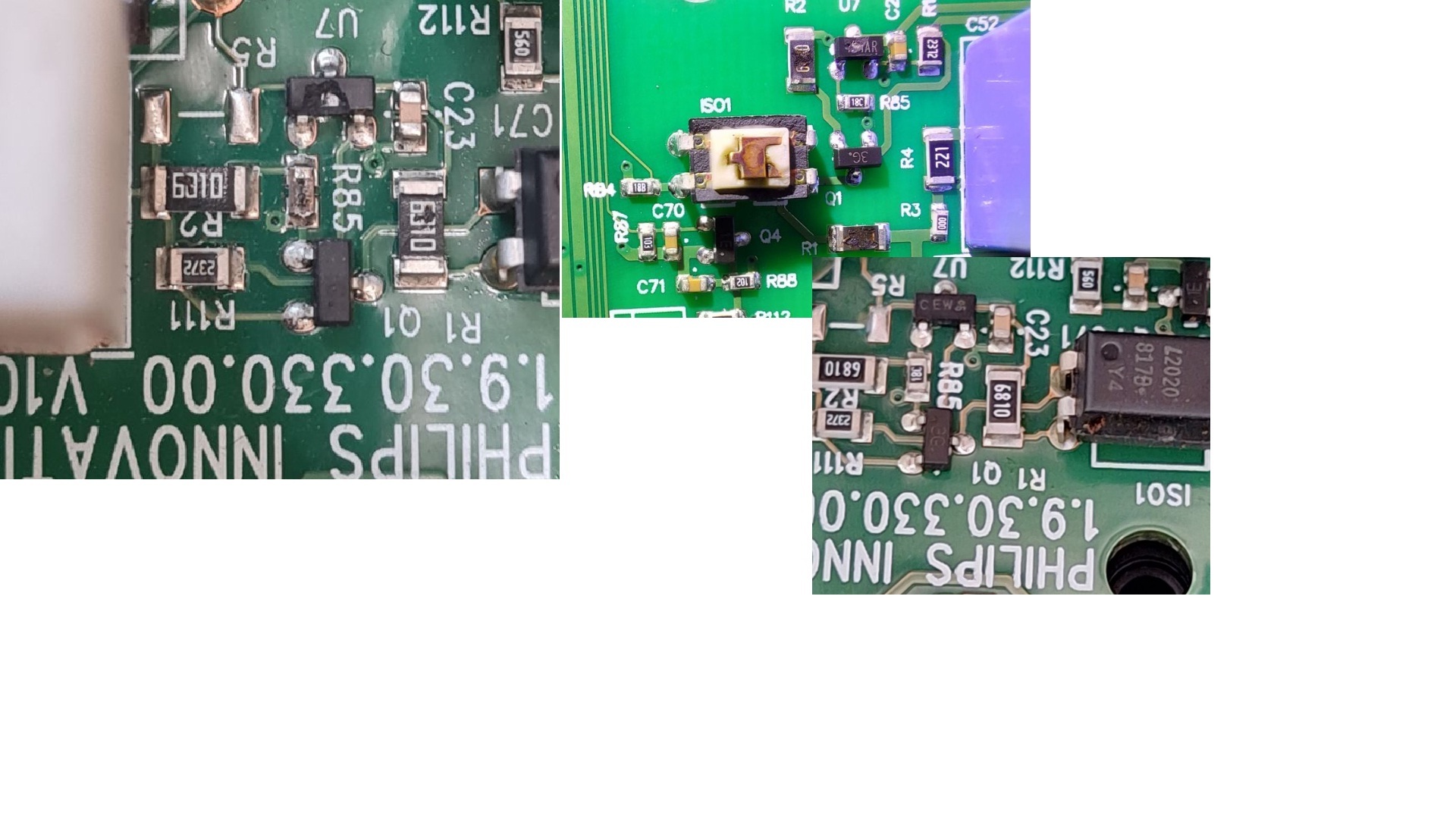

    philips ep2231 40 Q1 U7
    Which MOSFET do I have here? Is it an N-channel or a P-channel?
    I have two defective ICs, Q1 and U7. What are the names of these components?
    Thank you.​

    Q1 I read as marking 3G- = PNP transisor BC857C
    That’s not a mosfet

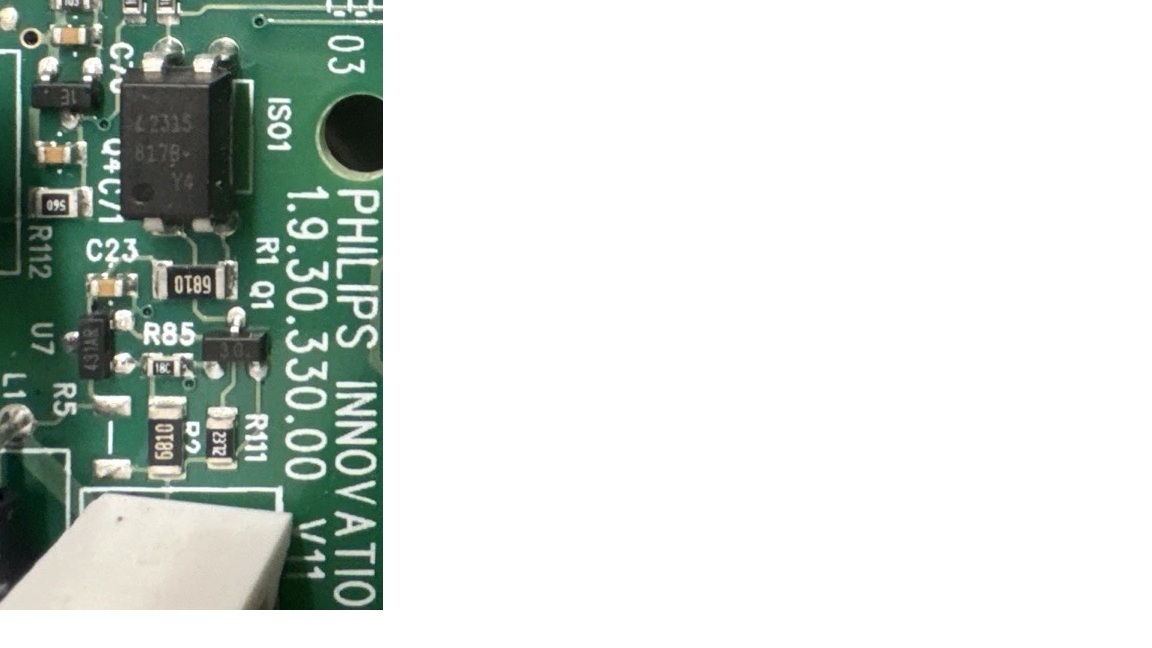

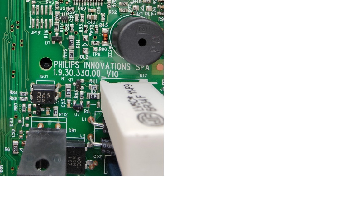

        Before
        After turning on the coffee maker, it immediately rinses, and the water flows into the tray. Then the indicator lights for no water, coffee grounds, and the triangle start flashing simultaneously.
        ich frage mich
        was ist das jetzt U7

          Dunno. I think you got to take U7 out and see if it behaves like a MOSFET. If it is a MOSFET, it isn’t shorted and you can turn it on and off with your DMM in diode mode, it is o.k. Yours doesn’t look blown, so it should work.

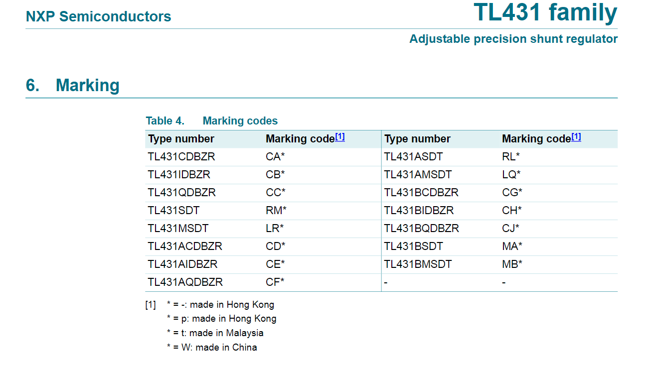

            U7 = CEW = TL431AIDBZR

                I also came up with the CEW may be a TL431, but the other options didn’t provide a cross match. So testing it is. Are you sure this circuit isn’t working?

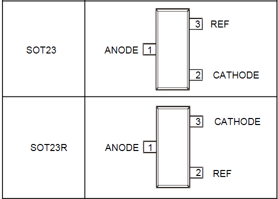

                        Originally posted by samtron786
                        I found part 431AR.
                        Is it the same, right?
                        Yes, it's the same thing (different manufacturers), just look at the pinout, it may be different for them.

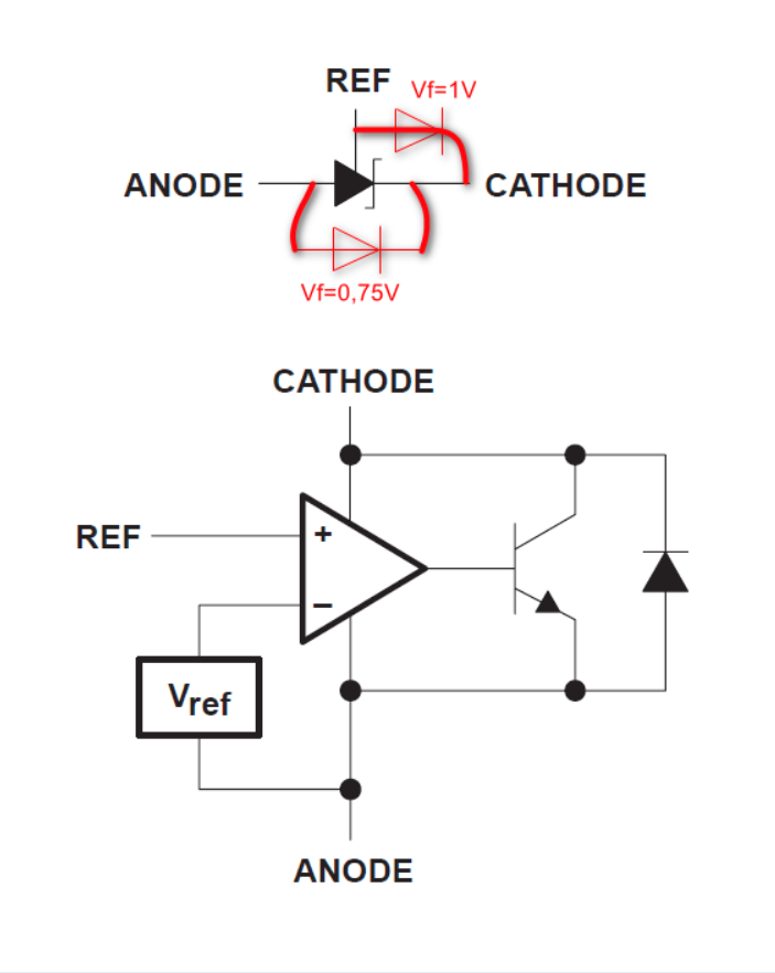

                            TL431
                            Premium supporters get full download access and other benefits.

                              It is also better to replace the optocoupler IS01 (817), after the breakdown of TL431...

                                  Ok, if your ordered TL431 does not correspond to the standard pinout, then just turn it upside down, carefully lower the leads down and solder it and everything will work.
