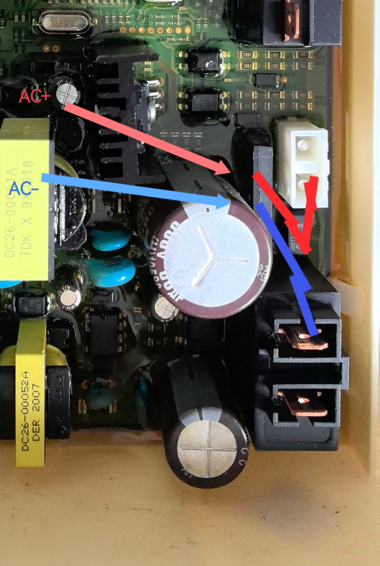

                                  I've been checking voltage on mainboard connectors, used the CN1 live line for plus (it's the main ac input for the board) and RY7 negative for minus (seen it has continuity against N line of the mains plug), got stable 245v there. I think everything goes through filter before it reaches the boards?
                                  Spade terminals (the ones I'm aware of and I can somehow access) look brand new.
                                  • CapLeaker
                                    Leaking Member
                                    • Dec 2014
                                    • 8352
                                    #37
                                    Make a picture and draw or circle on it.
                                    • mrsith
                                      • Mar 2021
                                      • 146
                                      • Wielka Brytania
                                      #38
                                      Think I've found the problem. The N line goes through one of the main relay pins - confirmed via continuity against plug's N pin, relay's leg and the bridge rectifier leg. When I measure A voltage with CN7 L pin L and the relay plug (there's enough space to shove a probe between the plug and the relay when it's connected), I have stable 245v, but when I take the measurement using the relay leg on the other side of the board - which has continuity against that plug - I have same jumping voltage as measured on rectifier itself.

                                          Well I've made a mistake, it's the other pin of that relay that's supplying the N ac line. And it's normally closed so that relay has to be switched on first. This means there's whole another route of power here.
                                          Starting with DF06S rectifier, I'm getting dc output of circa 50 volts, raising steadily (~10v at a time) to circa 110v,then drops again to 50s and raises again. Is that normal?
                                          Edit: also found a tiny T4 marked diode, just next to the relay (looks like it's connected to the relays coil), which is open, doesn't conduct anything any way.
