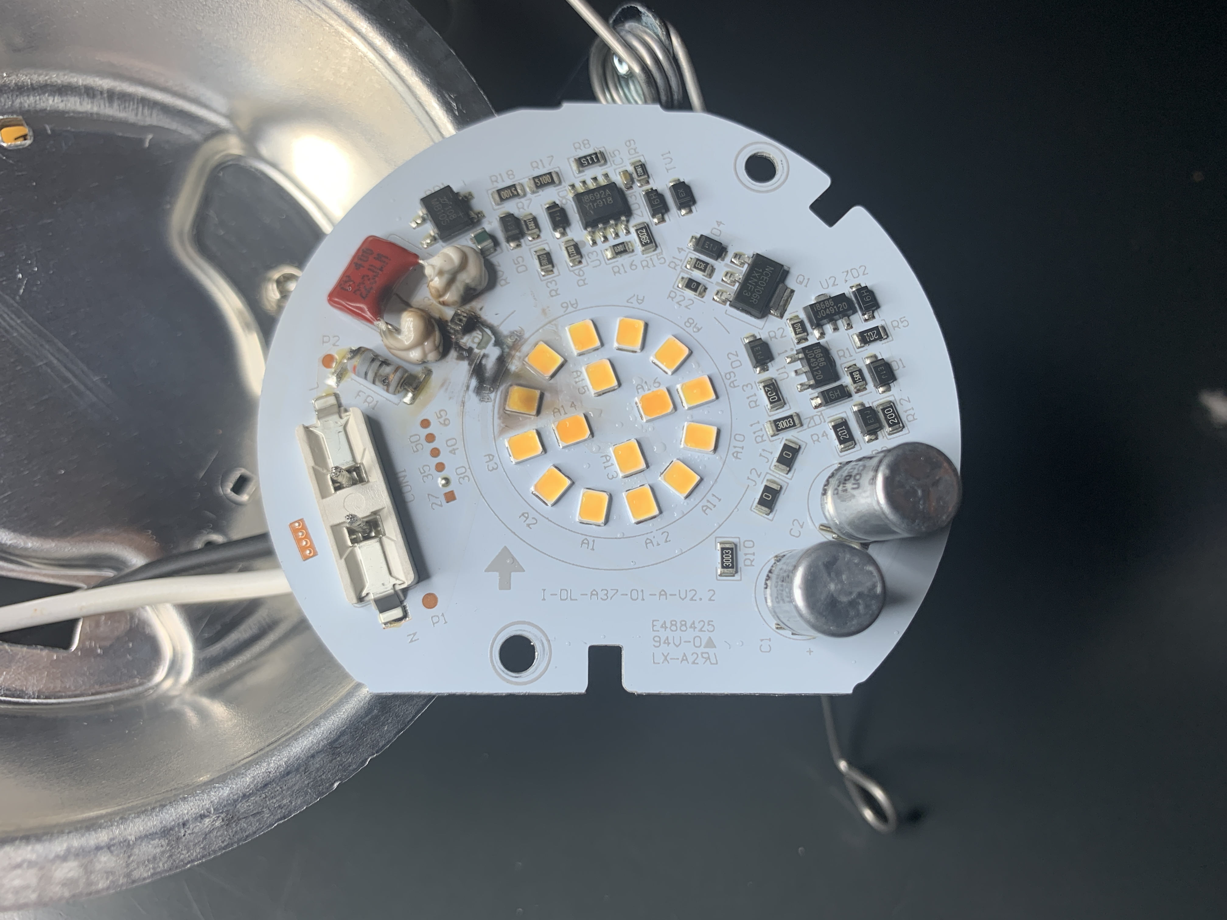

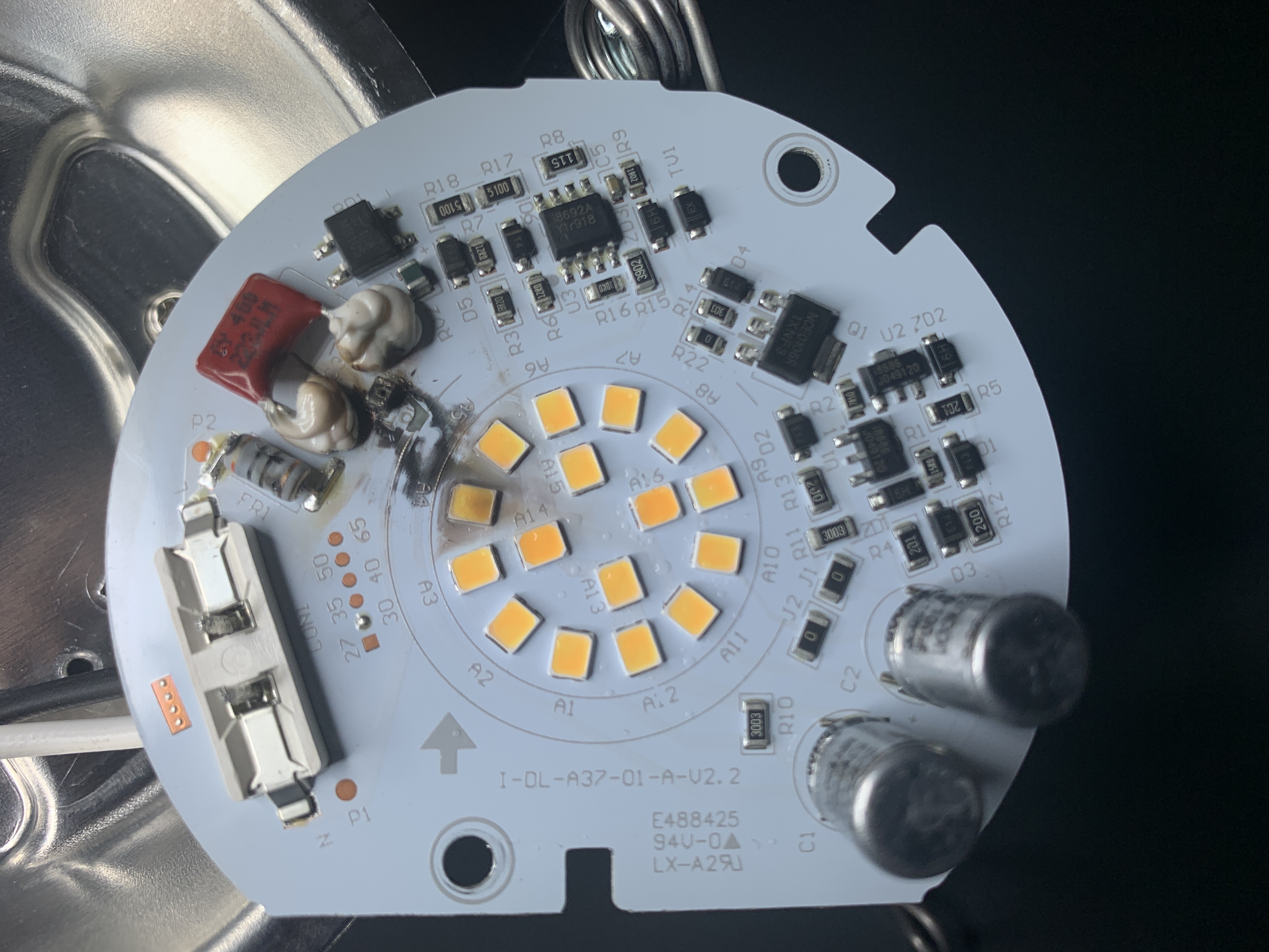

    Hi all, I am on a 100% diagnostic spree and need some more assistance.
    I have looked at the board of this poor light and it appears I have an fuse/resistor combo.
    I have isolated what I believe are RV1 (destroyed by the surge) and you can see RV2, so I am assuming they are same or similar.
    Can you tell me what the name of the component, amperage/resistance, so I can order from DigiKey?
    And now I noticed the light went up $10 Canadian, to $46.
    Any help in this regard would be greatly appreciated.
  • Per Hansson
    • Jul 2005
    • 5895
    • Sweden
    FR1 has a hole in it: that is a bigger problem.
    RV1 and RV2 are probably varistors, they will clamp when the voltage is too high, board will work fine without them for testing (if there are no more voltage surges).
    You can replace FR1 with a small incandescent light bulb, 25 to 60W should be enough: if it is on fully bright it means the fuse (FR1) did it's job and the fault remains.
    If neither the incandescent bulb nor LED switch on then you have an open circuit, possibly there is a hole in capacitor C3, hard to tell.
    I would be spending my time with the insurance company instead.

      Hi again, I tested the varistor its open circuit at that point RV1, and I noticed FR1 after I posted I am going to check it soon (FR1 is a fuse/resistor correct?).

    • 31068
    R5,R13 blown, R4 maybe blown
    so the semiconductors are in question.

    Hi all, as for what Per Hansson has said in earlier post, I connected a light bulb across FR1 (blown). and it did not light up. The C3 appears to to give me a reading in ohms .441 and reversed .414 I am thinking its still good, but could be wrong.
    Looks like more components failed, then FR1 blew.
    Thanks for your time all, this one is going in the garbage!

      Ok, I agree with stj here, the SMD resistors he mentioned look like they could be damaged.
      If you want to use the thing for learning you can measure the AC voltage on the bridge rectifier, up to that point everything should be ok.
      Then after the bridge rectifier you should see DC voltage, with 115VAC on the incoming side it should be √2 x 115 = 162VDC
