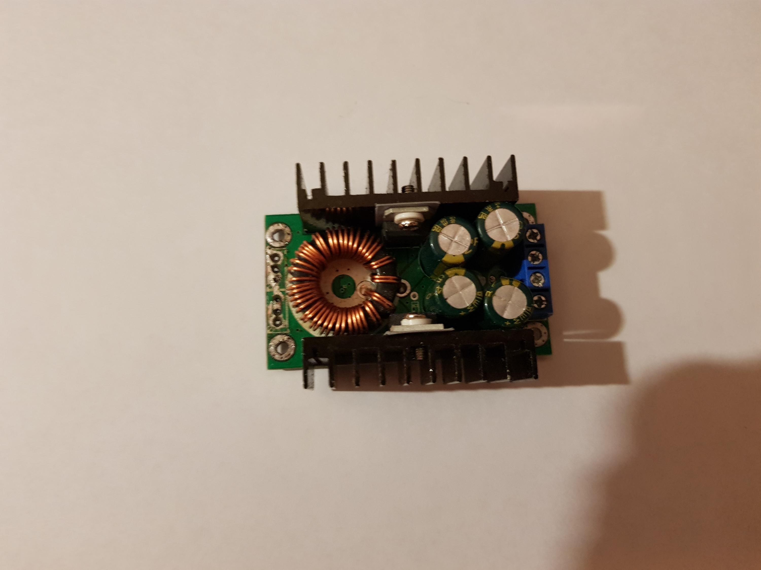

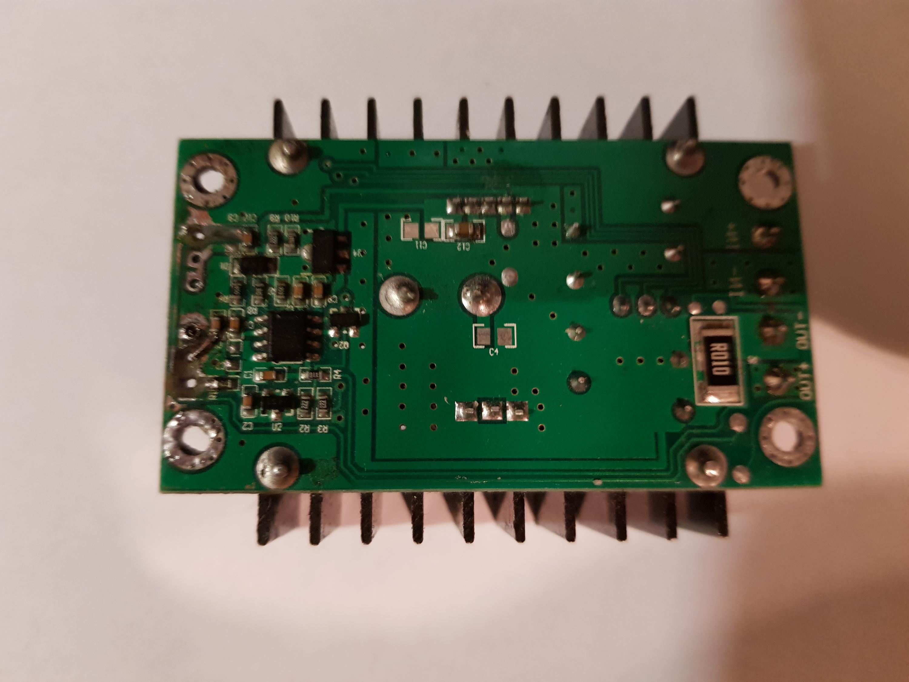

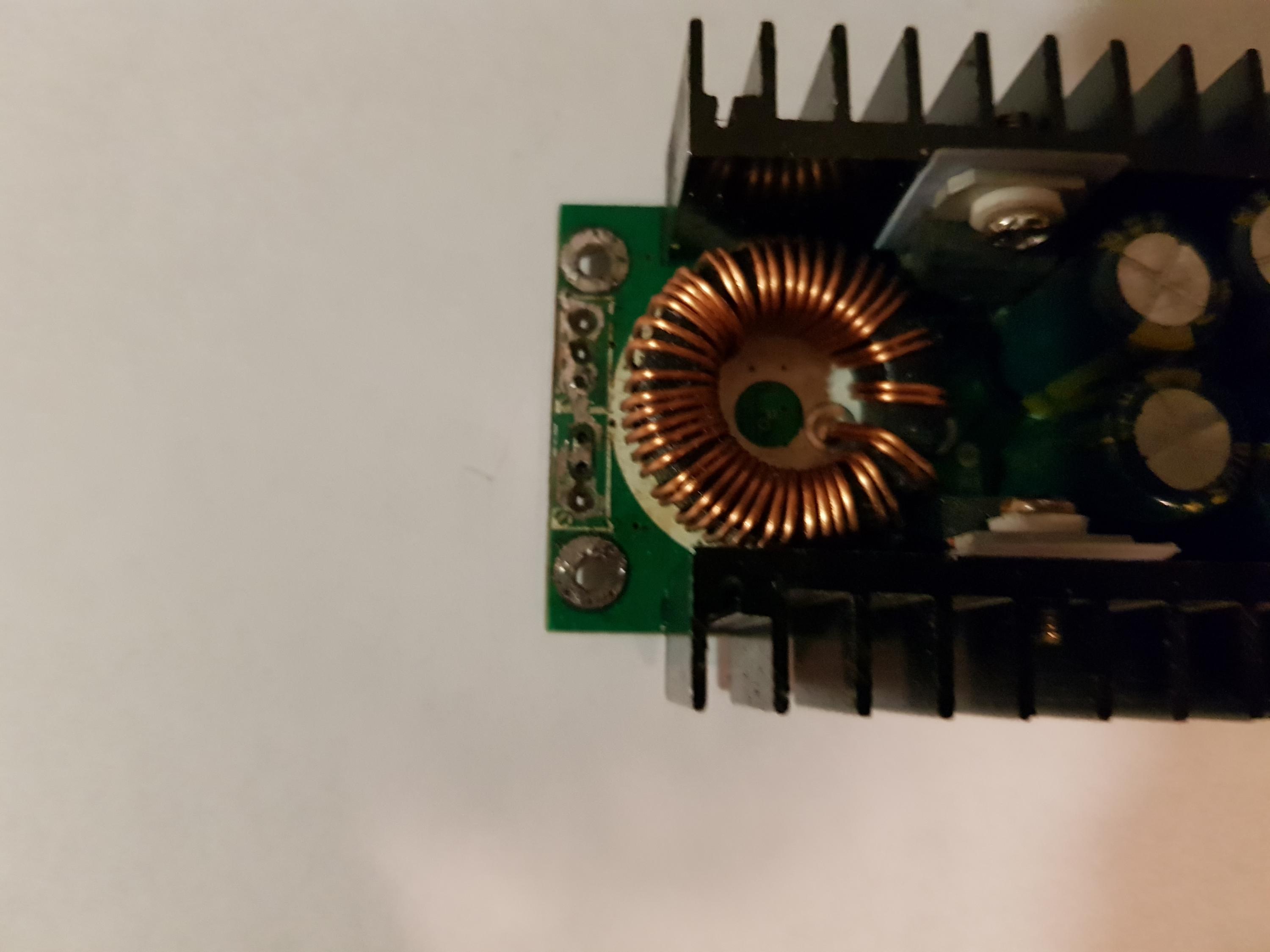

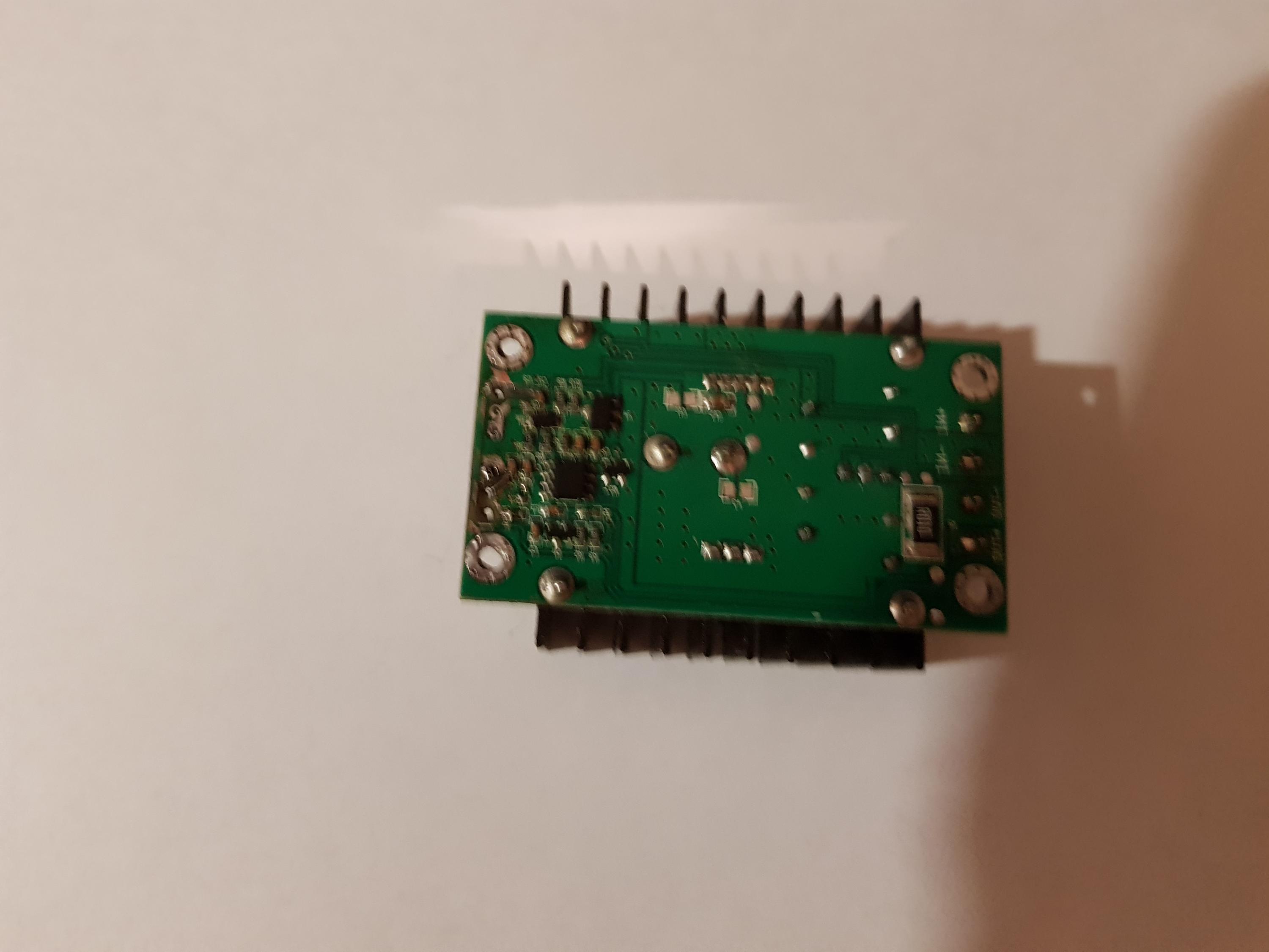

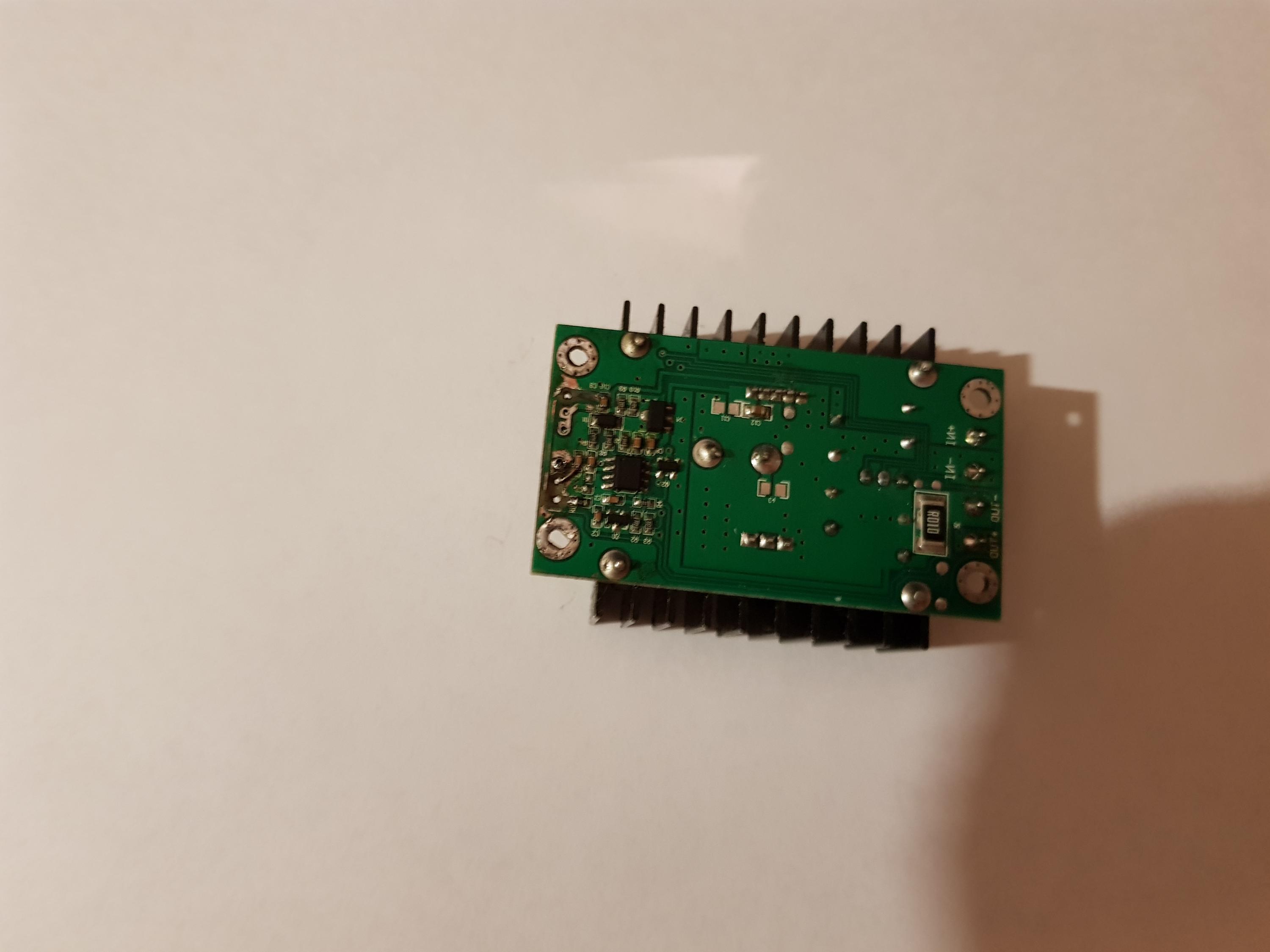

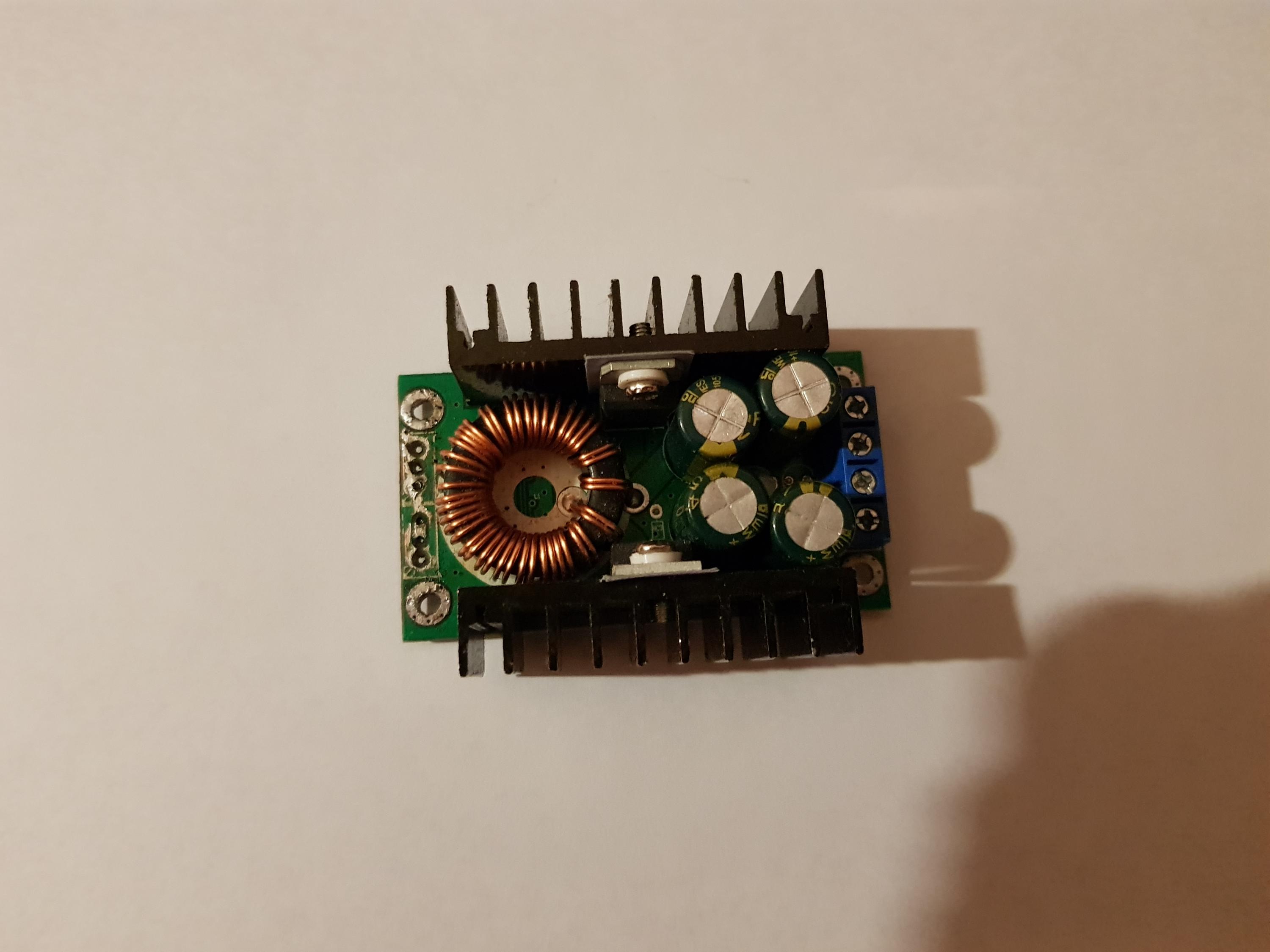

Hi I have destroyed the tracks to both the volt and amp connector is it possible to solve this problem and maybe find another way to connect them. see the pictures and the disaster that I did
Adjustable Buck Converter V/A potentiometer traces destroyed

Can you please tell us how this happened I have several of these this is the reason I am asking you to go into some details about how this happened
Thank you for all the detailed pictures that shows the damage that happened to this board ( the last picture is the best one of them all to see the damage )
The only real option that you have is go to the component pins and to the output pins and hard wire them together but you are going to have to clean all of the solder from the connector pins on the other side of the board this is the first thing that need to be done before you start with this type of repair
This is very time consuming to do but I have done this in the past with very good results so it is doable
But a better option would be to buy a new one and resolve what cause this to happen in the first place and use this one for parts
The reason I mentioned the better option is if the component leads are NOT long enough this is going to be very difficult to do because the only option then is to put wrapping wire on the component leads to extend the component leads so you have something to work with
If this issue happened because of high current then if you buy a new one you are going to have to reinforce the connector pads with wrapping wire to the component pin leads for better connections to carry the current
This is also time consuming as well but it might help you save the board from this type of failureLast edited by sam_sam_sam; 08-19-2022, 02:57 AM. -

Hi Sam and thanks for the support. yes how this has happened : probably a very bad soldering pencil without knowing it because I absolutely could not unsolder these blue Trimmer Potentiometer and I became obsessed to push them down with the soldering tip then it was a hell to free the holes yes that's what happened 2years agoCan you please tell us how this happened I have several of these this is the reason I am asking you to go into some details about how this happened
