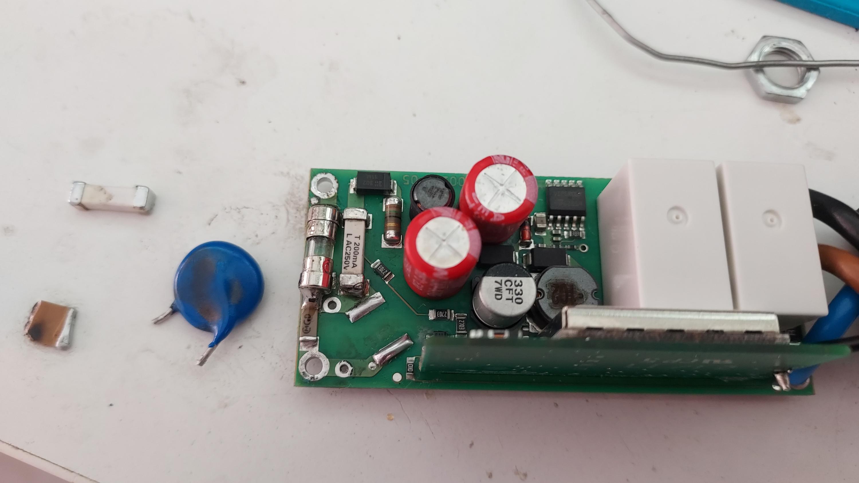

    This is the second time, an actuator from household blown up.
    This time, I will try at least to repair it and save about 200€.

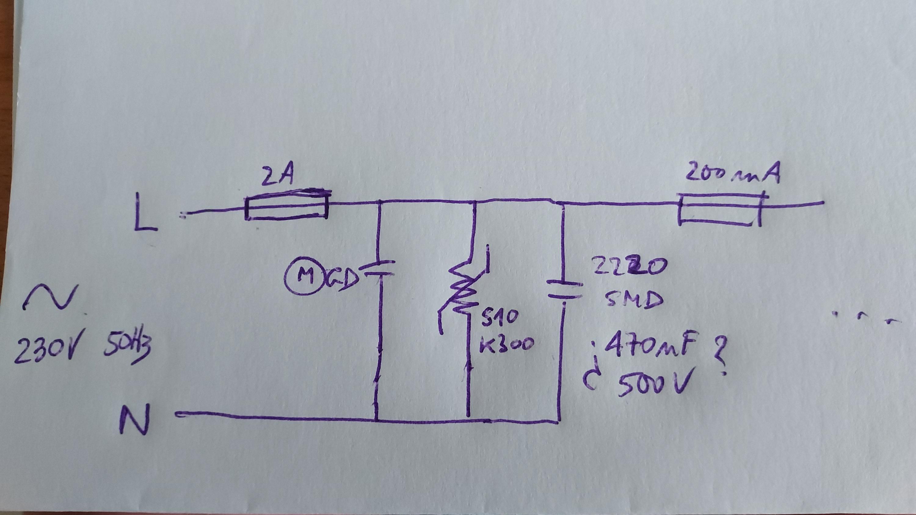

    I see the following. Did an schematic for a better understanding.
    - 2A SMD fuse blown. Replaced it with a "non SMD".
    - Varistor (S10K300) seems ok. Measures open circuit.....but it's not blue anymore. I will change it.
    - 2220 SMD Capacitor blown.
    Which capacitance value would you suggest in parallel with the varistor?. I've ordered 470nF 500V in the meantime.

    What is the part number of the surface mount ic chip

      The 10 pin SMD IC chip is a VIPER06X

        I’d go at least 630V or and something either 0.033uF or 0.047uF for a Viper in a buck design.

          Thanks you all for the feedback. I will get 33nF 1kV for this capacitor. I'll let you know the outcome.

                Material has arrived and it worked perfectly. Just capacitor replacement (used 33nF 1kV) has been necessary.
                I keep the VIPER and the varistors for next repairs........
                The shading actuator is back to life.
                Thanks for your support and guidance, guys.

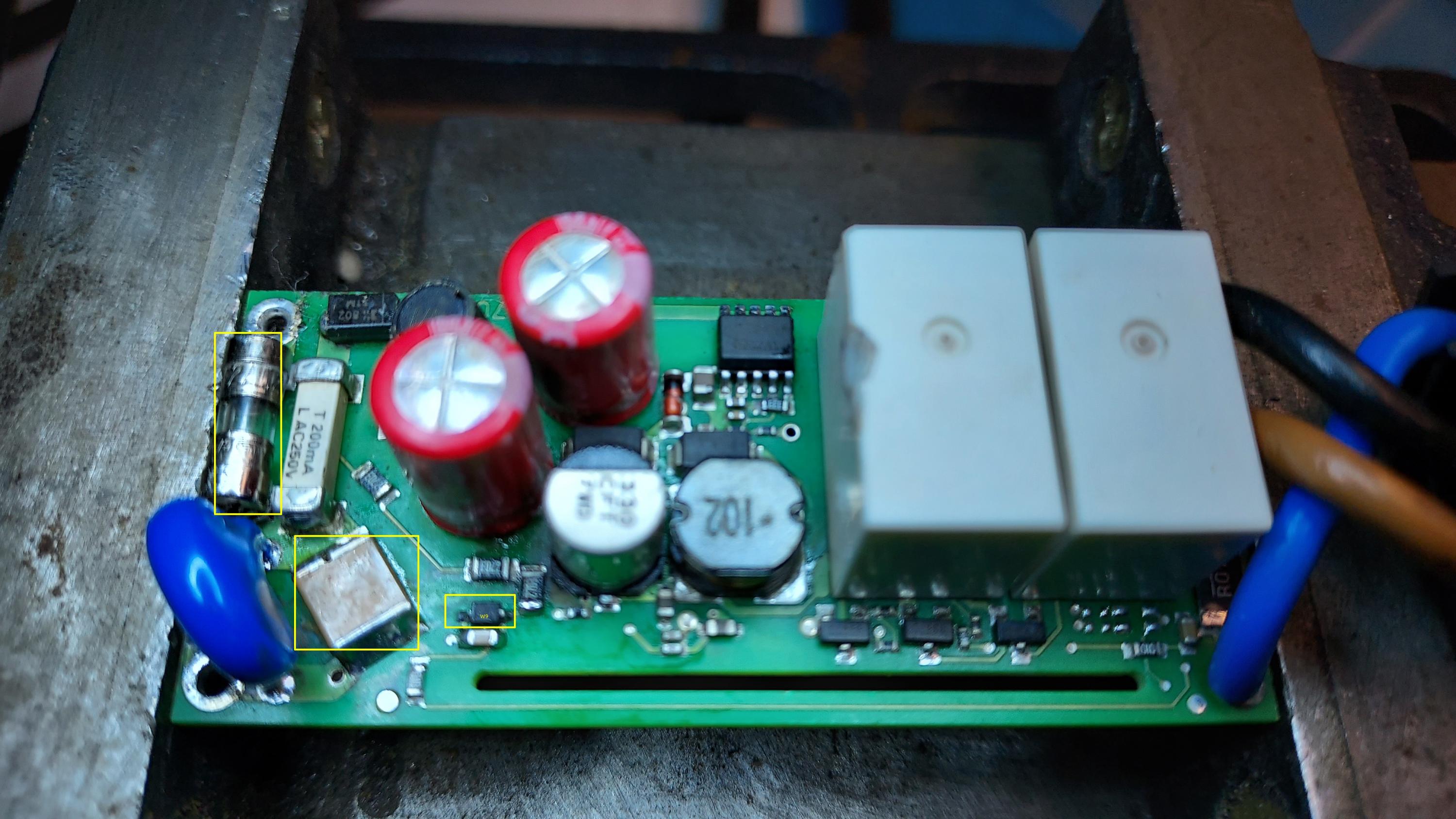

                    I decided to try to repair the first actuator that blow up. And I succeed. So now I will have 1 spare waiting for the next one to crash. It's a matter of time :-)
                    This one had more or less the same damage than previous one (2A Fuse, Big capacitor, and 5.6V Zener diode).
                    It's important to mention that between big cap terminals you must read about 5M ohm resistance. In this one I was reading a few K........and it was because the Zener was damaged.
