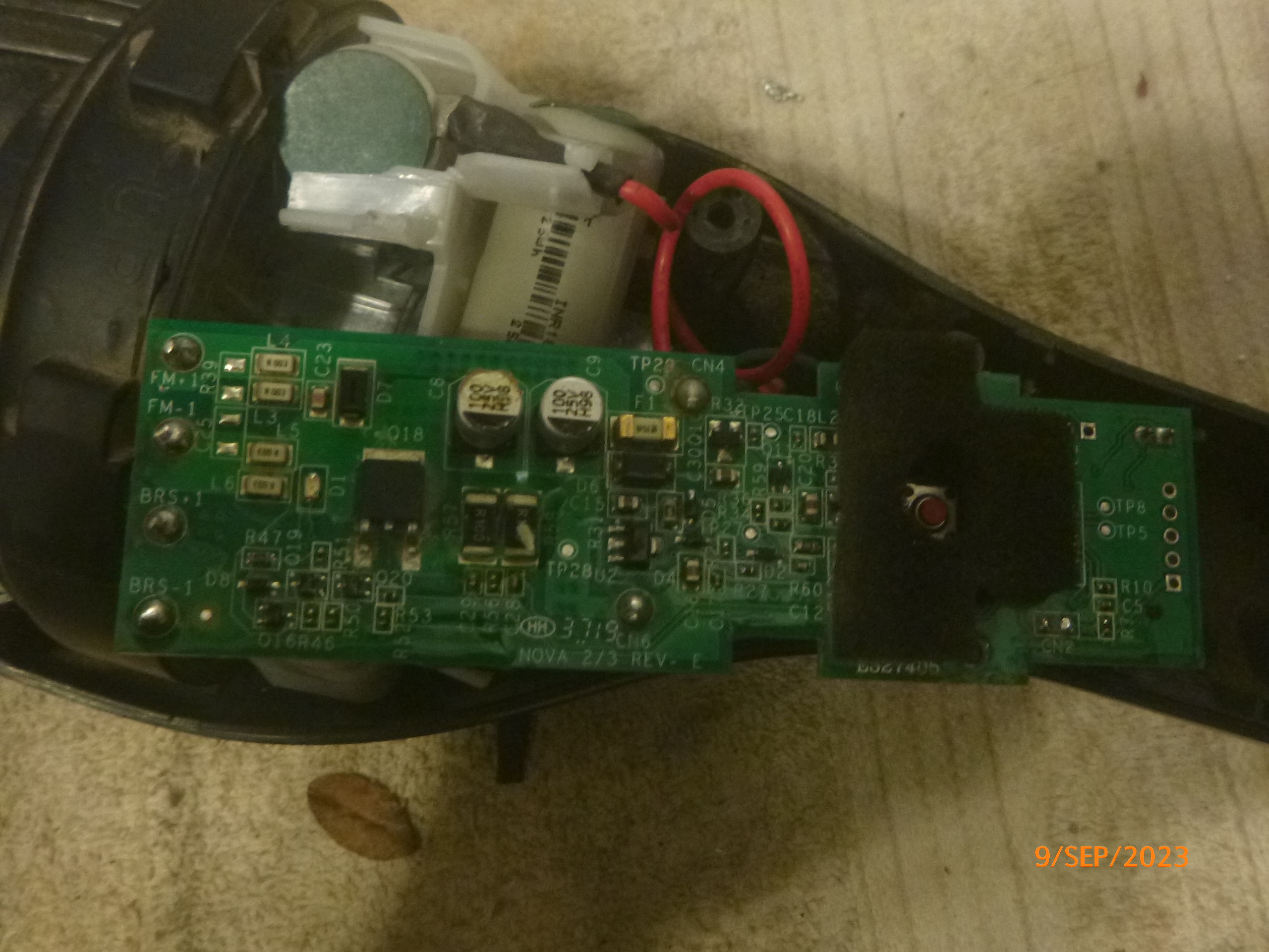

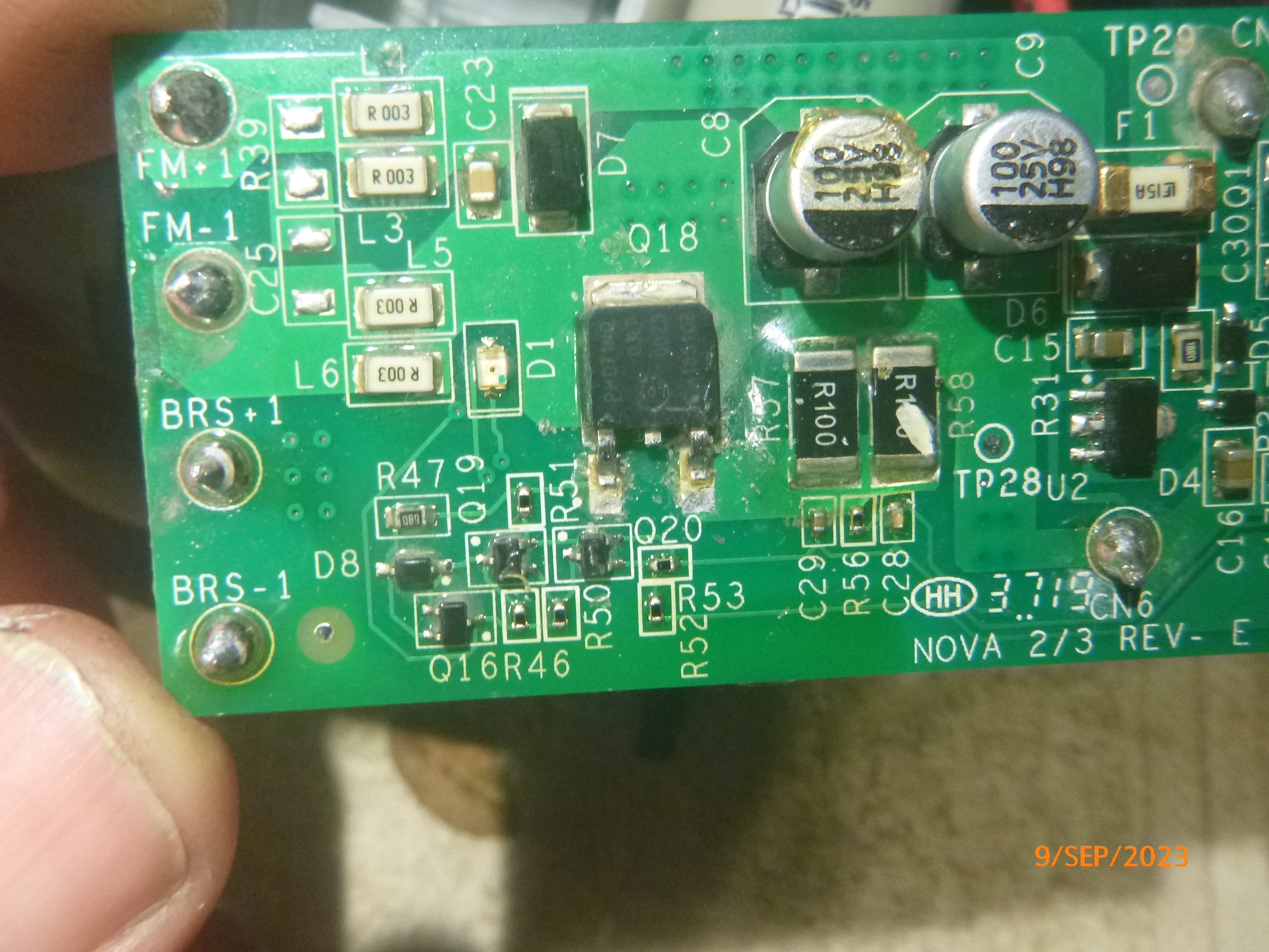

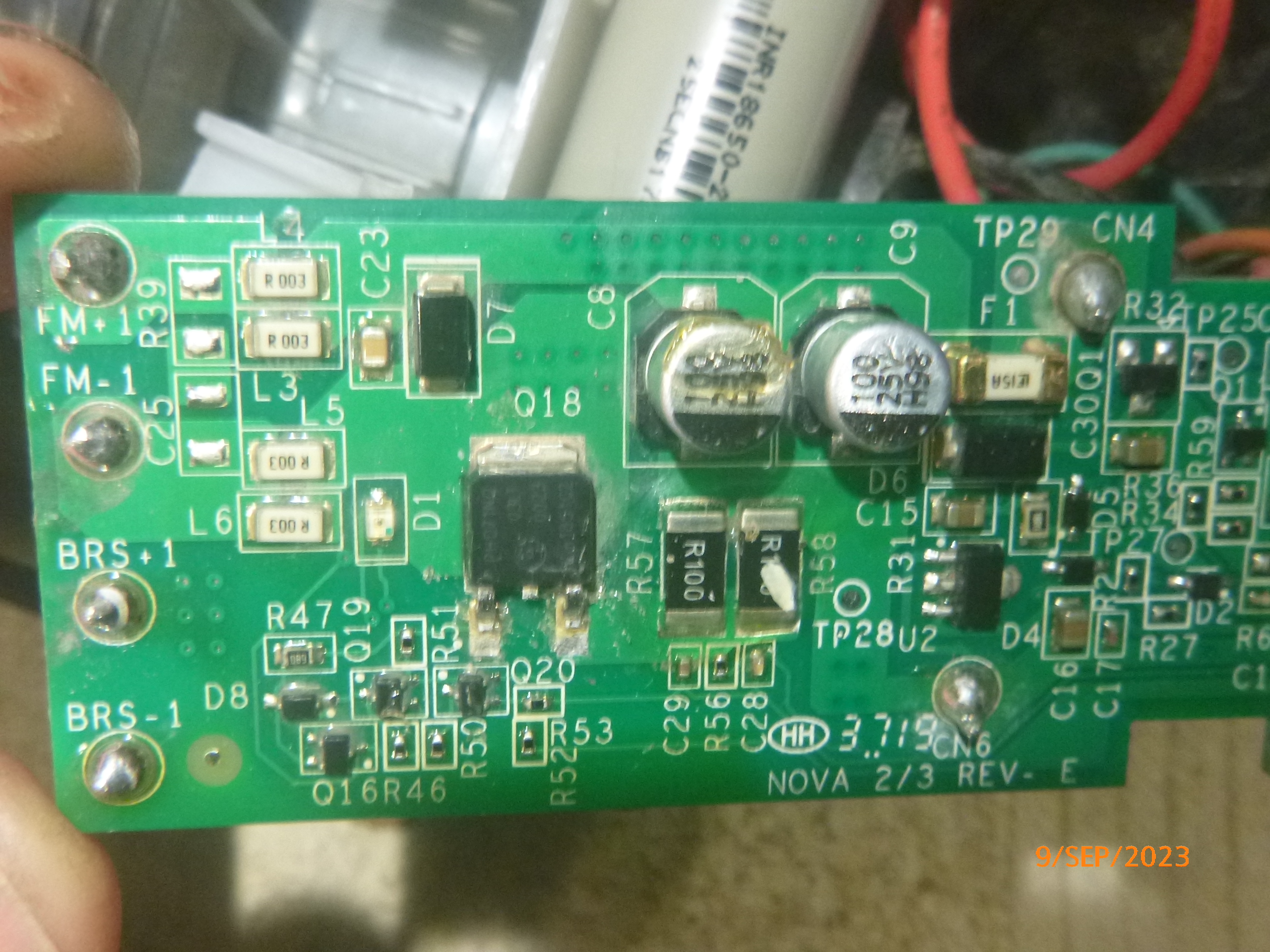

    So, I have this Electrolux vacuum which had the batteries revently replaced and now it won't work.
    The voltage from the batteries is arriving to the board without problem (+/- 12v) @ CN4 & CN6.
    The motor works fine when voltage is applied to FM+1 & FM-1. The switching on and off is made in the negative line between CN6 and FM-1, and all components have been tested as fine apart from a FET.
    The problem appears to be that the PHD71NQ FET (Q18) isn't switching when the power button is pressed.
    I say this as when I started to connect my component tester to this FET, the motor fired up.
    The exact situation was that one clip was on the Gate, and when the second pin was touched to the Drain, then the motor kicked in, nothing was connected to the Source.
    Should also mention that there is the 12v on both the Gate and Source pins at all times. Drain connects via a couple of inductors (L5 & L6) to the motor supply.
    I don't have the most experience with FETs but seems to me that I need to test the FET out of circuit and work my way back to the power switch if it tests bad.
    Does that sound about right?

    Not only that, but you CANNOT test components in circuit using resistance test or diode check or continuity when there is voltage in the circuit or a battery connected. ALWAYS remove all power sources when trying to test a component in circuit. Otherwise, you risk doing more damage to the board and also your multimeter (especially the case with circuits with higher voltages.) Also, those component testers are often inaccurate for in-circuit readings, so I don't recommend you use it for that.
    So to be sure about the MOSFET... yes, remove it out of the circuit and test it.
    If it's an N-ch FET, you should get a diode reading (~500-700 mV range) between Drain and Source when red multimeter probe is on Source pin. Reversing the probes should give no reading (open circuit.) Next, connect black MM probe to Source and touch the Gate pin with the red probe while using diode test. Then move the red probe to Drain. The MOSFET should now be turned on and you should see a low or almost no voltage drop between Drain and Source (as if the pins are shorted together.) If you touch the Gate pin with your finger, that should discharge it and the Drain-Source connection should disappear back into an open-circuit. Note that this test only works for testing MOSFETs out of circuit.
    For P-ch MOSFETs, these tests above are the same, but just switch the positions of the red and black probe for each test... or use your component tester, if you prefer.

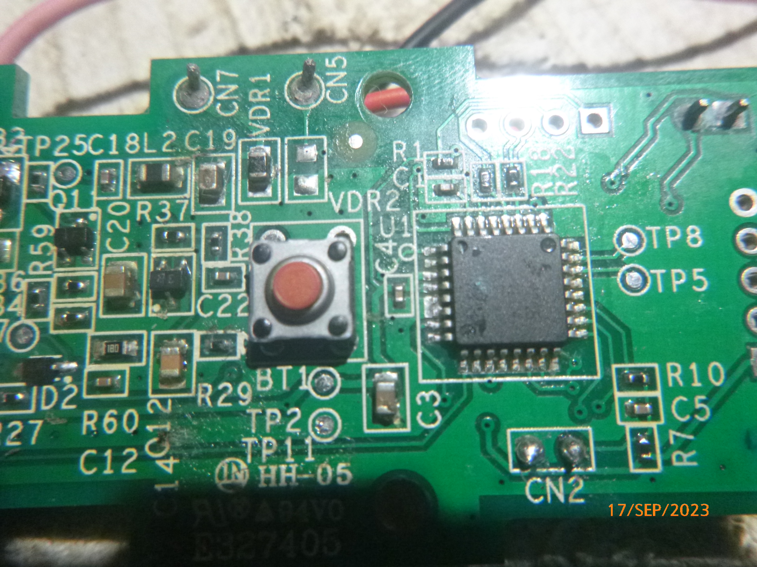

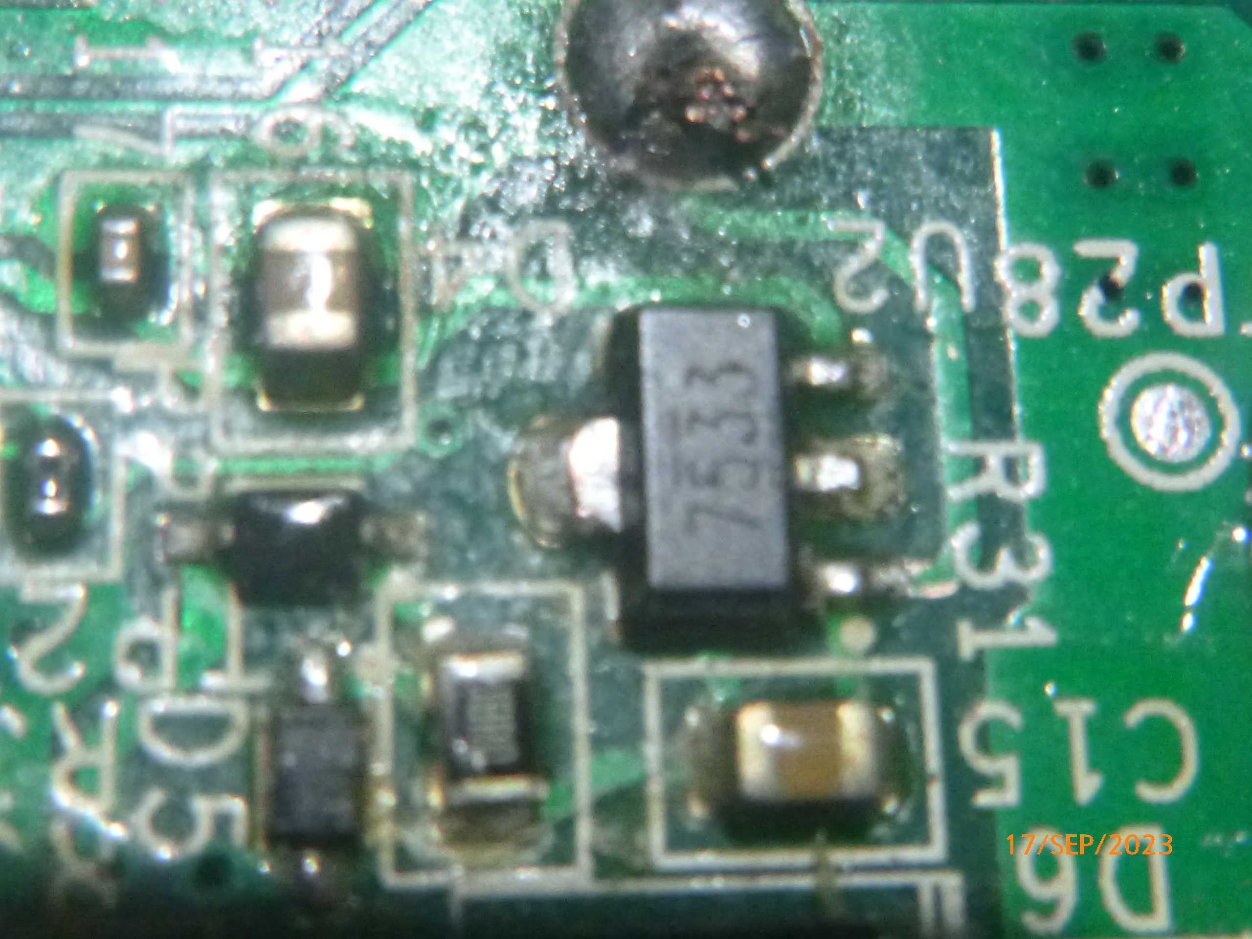

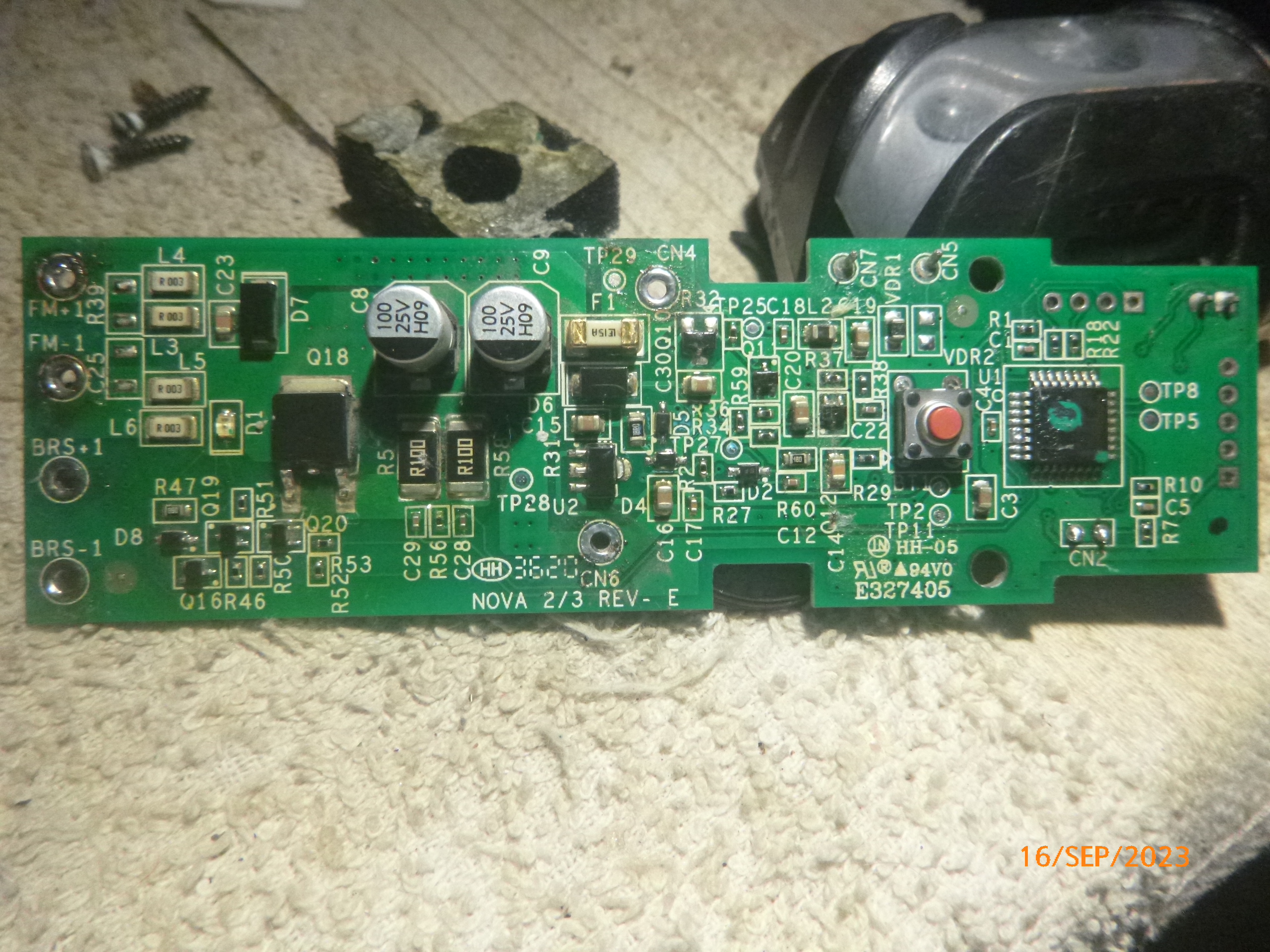

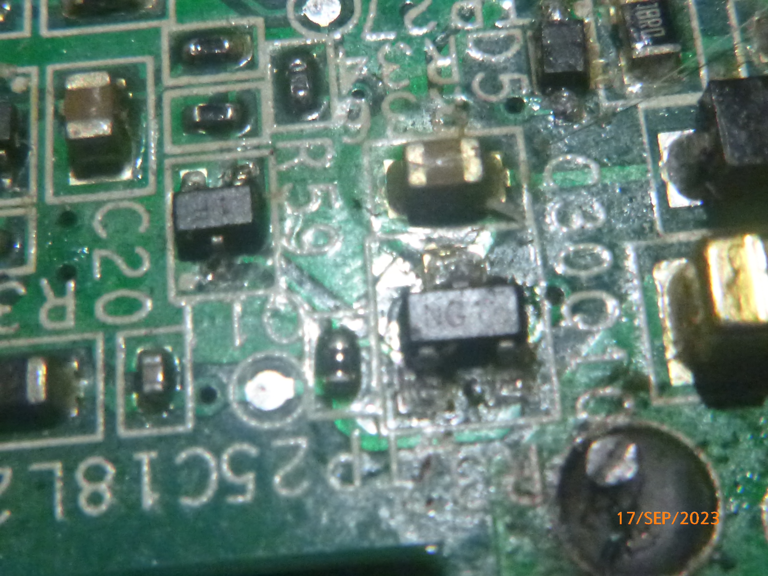

                Finally got a chance to have a closer look at the circuit, and there is an HT7533 3.3v sot89 voltage regulator (U2) which has zero volts on the 'in' pin.
                Tracing the circuit back, it goes to the lower right hand side pin of an sot23 device (Q10) which is marked 'NG1N'. So far haven't managed to find out what kind of transistor this is?
                The single pin of NG1N, then connects to an M7 diode (D6) which is connected to the board fuse.
                A quick recap as to the situation. The owner bought three 18650 replacement cells and without any shorting, the unit stopped working.
                The power from the battery comes into the board at CN4 (+ve) and CN6 (-ve).
                The +ve line goes through a fuse and a couple of inductors straight to the motor via terminal FM+1.
                The -ve side is switched through button (BT1) and a mosfet (Q18) before connecting to the motor negative terminal FM-1.
                Obviously this FET isn't receiving any 'turn on' signal.
                That comes from U1, an M2Q5VLC4 (MKE02Z32VLC4) microcontroller, however that isn't reveiving the 3.3v from the HT7533 due to the fact that nothing is coming from Q10 'NG1N'.
                Need to find out what the NG1N is?

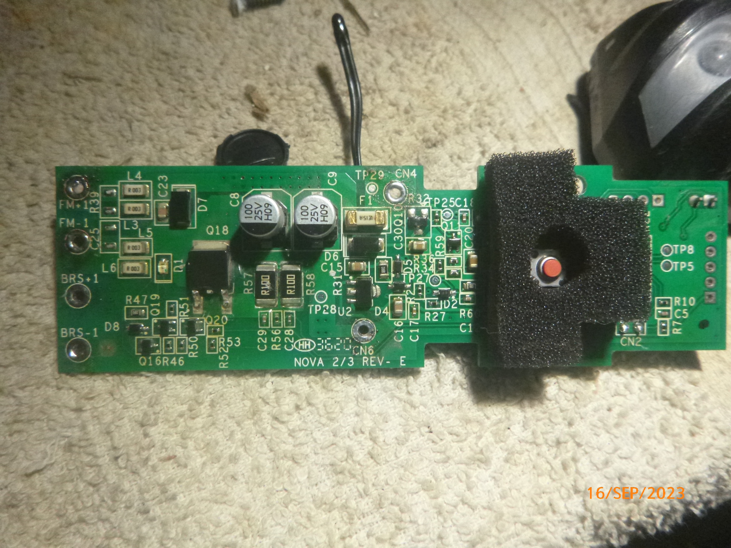

                      Trying to work my way back through the circuit with the intention of creating a rough schematic although drawing electronic pcb schematics is far from my forté-
                      I had thought that the button merely switched on the motor in the negative line, however I have just noticed that yes, one side is of the button at -ve potential, however the other side is at the battery positive of around 12v.
                      I wasn't expecting that
                      It might get to the point of just removing components and testing them off the board.
                      This absolutely has to be fixed...

                        Thanks to R_J for identifying the NG1N as a PNP although that hasn't helped me understand any more how the circuit should be working.
                        The circuit has a three pin HT7533, 3.3v voltage regulator which has zero volts on the 'voltage in' pin.
                        Following the circuit back it arrives at the emitter of the above mentioned PNP. I would have expected an NPN on that circuit.
                        I've never fully understood PNP transistors but had always been under the impression that the base must be negative to the emitter in order for the current to flow between the emitter and collector.
                        So how is a positive voltage supposed to arrive at the 'in' pin of the HT7533 if there is no voltage on the PNP?
                          • 31260
                          Re: Electrolux ERG22 vacuum cleaner pcb fault
                          clean the flux off ffs.
                          it's leading to q11
                          ultimatly it probably goes to the button so when you press the button it latches on and the microcontroller probably relaeses it after your done
                          try jumping the power across it to see if the mcu does stuff under poer.
