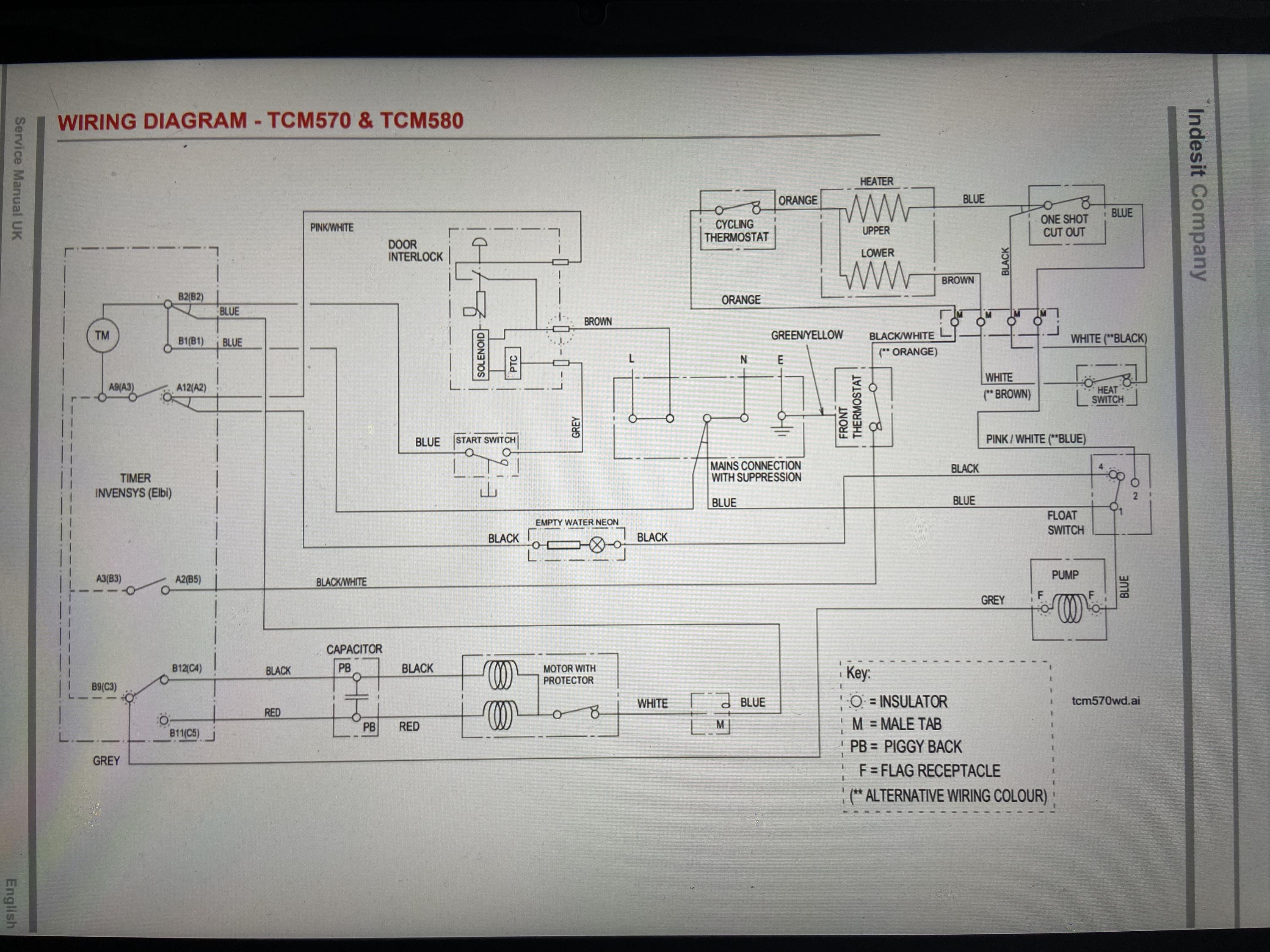

    I have an indesit IDC75 condenser tumble dryer and everything appears to be working ok
    press start button and it starts spinning
    does it reverse tumble at periodic intervals
    heats up ok (heat switch toggles between high and low heat and working ok)
    timer switch rotates as time passes by
    However, there is one issue, it does not switch off when the timer goes back to "0', or 'off' if you like. Just keeps going. It will only stop if the door is opened, then closing the door requires the 'start' button to be pressed again to get it started.
    I dont know the history of the machine so unsure if its a genuine fault with the timer switch, which I believe is the issue, or perhaps previous owner maybe changed the wiring to the timer switch.
    Any ideas? thanks
    No other electronics involved (so no relays) only the basic components:
    water pump, flood switch and neon lamp
    motor and run start cap
    heating element with thermostats
    door interlock bitron type switch
    drum vent thermostat
    heat hi/lo switch
    momentary start button
    timer switch

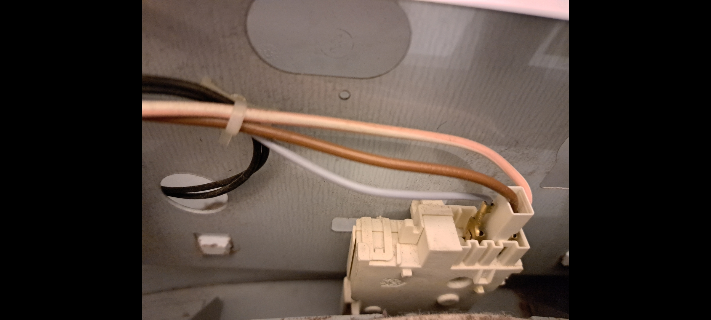

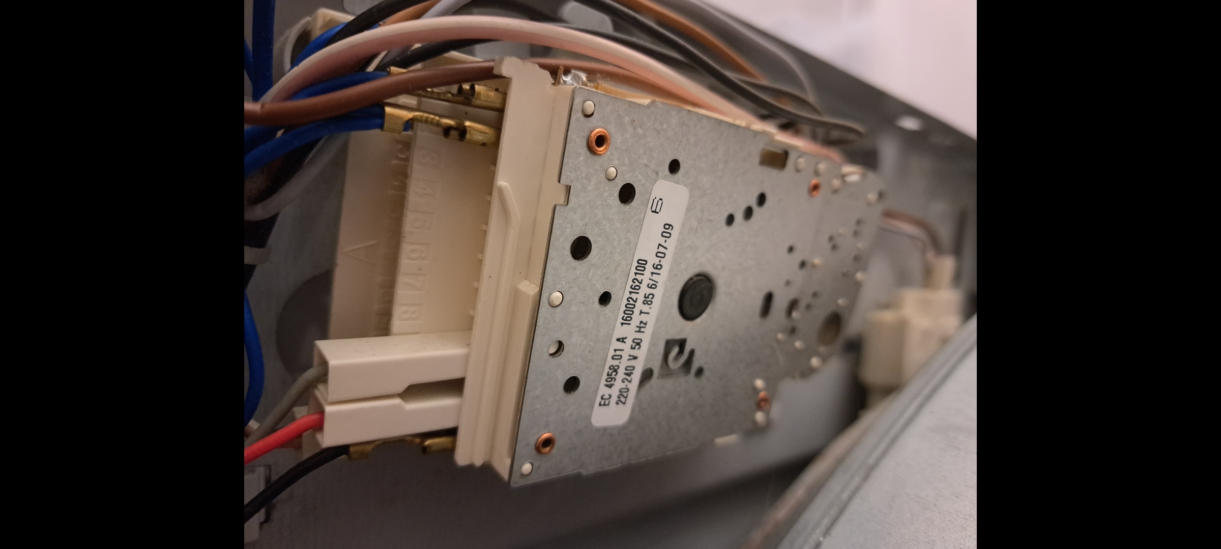

    Photos of door switch and timer.

          The start button is a momentary switch needed to start the cycle and the door switch possibly has a latch, its not a simple on/off switch with 2 wires, there are 3 wires.

                          • R_J
                            • Jun 2012
                            • 9594
                            Re: Indesit IDC75 condenser dryer not stopping

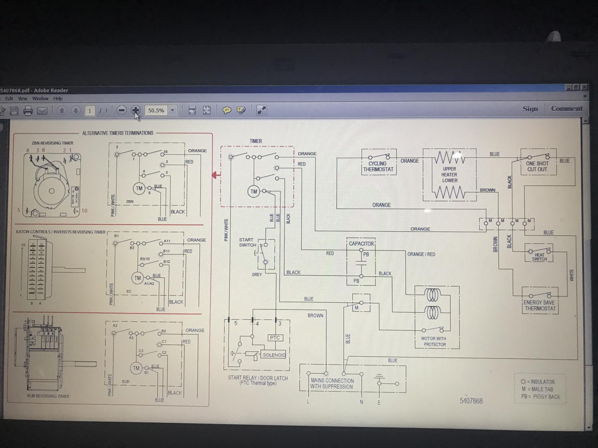

                            I found this, it might explain some of the issues
                            The door interlock wire colors match the numbers
                            If you look at the eaton timer, my guess is that the switch between B1 and B3 is bypassed and the wire (pink/white) is connected direct to B9/10.
                            B11 and B12 must be ok if the motor is reversing
                            A11 is likely ok as well
                            I can't tell which terminals are used on the A side, It may be that there needs to be an additional jumper wire needed

                              • R_J
                                • Jun 2012
                                • 9594
                                If you look at the diagram I posted, there is a switch between B1 & B3 that should close when the timer starts and opens when the timer ends. this turns off the heat, the motor and the timer itself. There must be one switch you can identify on your timer that switches when the timer is at 0 and when it is turned on.
                                This switch should be between the start relay/door switch pin 5 and mains neutral that supplies the rest of the timer switches.
                                Where does that wire pink/white wire from the door interlock pin5 go? is that it connected to A12 on the timer?

                                  • notallbad
                                    • Oct 2012
                                    • 1190
                                    yh, I have come to the same conclusion as cant see how it would shut off otherwise. I felt that the wiring to the timer was as original due to the fact the wiring is so tight they couldnt have connected any other way really and just looked untouched, just intuition!
                                    I have contemplated disassembling the timer but perhaps should wait until I have found a replacement first as at least its working at the moment and wont matter if things fly around the room like a firework display.The bbrass/copper dowels will need drilling out and replacing with nuts/bolts I guess.
                                    As per photo A12 is mains 'L' via start button/door lock and B1 is mains 'N'.
                                    • R_J
                                      • Jun 2012
                                      • 9594
                                      I assume you have a meter, so check the switches without taking it apart
                                      So the pink/white wire from the door interlock pin5 goes to A12 on the timer? correct?
                                      It might be that there are switch contacts between A12 and A9 and they are stuck closed?
                                      • R_J
                                        • Jun 2012
                                        • 9594
                                        This diagram seems to match you configuration, and there is a switch between A9 and A12
                                        On your timer I suspect it is not switching, (contacts may have arced closed or the plastic actuator is broken) Give it a couple lit taps in the off position to see if the contacts open.
