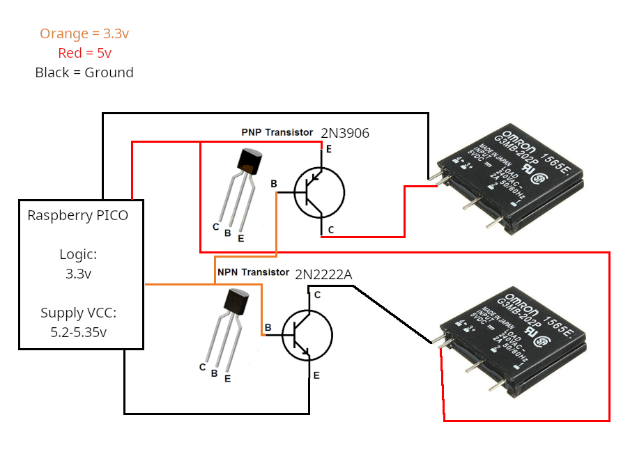

    resistor values for 2n2222a w/ SSR
    So if I take a 2N2222A transistor and a G3MB-202P relay and 3.3v logic controller
    What resistor value should I be using for the base? Normally i would just take a ~1k resistor and go, but i need to work every time and not fail
    The problem I am trying to solve: my dad hates 3 way switches (he is not even the one wiring them) and insist on the only way to get through a room at night is to turn the light on, go to the other side of the room and turn that light on, go back and turn the 1st light off, then go back again and turn that light off, screw that I'll make a software light switch that uses door sensors (more reliable than a motion sensor working)
    second question if i use the same logic wire can i make a double throw SSR switch by using 2 of these one on a 2N2222A and a P2N2222A or would i have issues with overlap there both are on/off at the same time (not sure if that is even a issue for my thermostat)

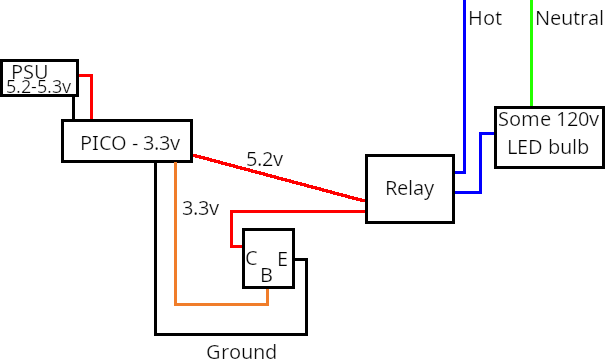

        Re: resistor values for 2n2222a w/ SSR
        The relay pulls 7.5mA when wired to my usb port, so what resistor range/value be?
        i know there is a formula, but i am not sure what values to use
        note that my final circuit will be using 5.2-5.35v, however there will be around 25-30 ft of telephone wire to the relay
        as for the second part of the question, it seems i have 2N3906 for PNP, would (would have issue with a double on for state for a moment?) this work see attachment
        maybe i need a schottky diode on the PNP base?
        again not sure what resistor value to use

          It looks you're just using common ground level shifting you need NPN transistors and the PNP probably is not useful here if you can't get the shifted voltage elsewhere.
          Since the relay is only 7.5mA (and will be even less current with the 30ft wire plus transistor saturation voltage) you don't need to current limit collector, and you don't need much base current to keep the driving transistor on. A 1K base resistor should be sufficient for even weak 2n2222a's and you can do 470Ω if you want to pound the transistor even more.

            The Omron G3MB-202P DC5 relay is an SSR, which is basically an LED and 440Ω resistor inside (for the 5V model) and roughly around 10mA load.
            With a lazy 2N2222 beta of 75, base-drive 2.6kΩ or lower would be plenty, and 1kΩ is fine. The RP2040 GPI/O's output 3.3V and typ. 4mA but note their are settings gpio_set_drive_strength can also move it from 2,4,8,12mA in software.
            You need an NPN to keep the higher SSR voltage away from the RP2040.

              Thanks, now i know what resistor to use for my DIY smart light socket
              Now as for that dual relay setup, i want to emulate the logic of my mechanical relay (SPDT)
              PNP and NPN transistors have opposite switching characteristics
              i have access to my data pin, 3.3v, 5v, and ground and very little pcb space

                Use another npn transistor as an inverter... or use another gpio pin and do the same except write it with the opposite phase...

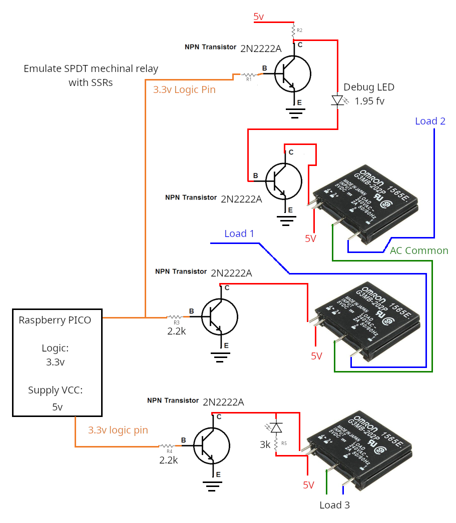

                                This should work in theory, still not sure about about the resistor values, but there are some issues
                                • debug led has 1.95 fV, maybe i should just put 1 led in the 3.3v logic (or the 5v logic), with a mechanical relay i could just put it in parallel with the relay, but with a SSR i would only expect the device with a lowest forward voltage to turn on
                                • not sure about resistor values
                                • when logic goes high i think both relays will be on for a ~250ns
                                  • off-off is fine
                                  • on-on could be a issue, not sure if my HVAC cares but it could (even if it does i doubt that is long enough to be a issue, but idk)
                                2n2222A has a turn on time of 35ns and a turn off time of 300ns

                                  That would work, I tried to do it with two transistors but it would be finicky so I did not post the idea.
                                  The debug LED's lose too much voltage though, so the SSR does not get enough voltage. You have 5V subtract the debug LED let's say 2.2V and 0.1V for the transistor on, and that leaves 2.7V but the SSR minimum is 4V. So you would move the debug LED to be in parallel with the SSR drive (adding a resistor for the LED like 1k).
                                  The intermediate transistor can use high resistor value say 10k on the base, and no need for the second R2 at the base. R2 to 5V still around 2.2k

                                      i want to make a SPDT out of 2 SSR relays for my thermostat that has had a few of those mechanical cheap blue relays die (so when the next one fails i can permanently fix it)
                                      I would suggest the following
                                      What is the voltage to the blue relays I am guessing that they are 5 volts if they are you can use a 4N25 with a drop down resistor for each relay coil power and then use the 24 volts from the transformer of the air conditioner or use much better relays or a SSR on separate board in an enclosure
                                      Do not be tempted to use the power of the thermostat electronic output directly to power your up graded relays or SSRs this not good idea because these thermostat boards are very easily damaged by voltage spikes and static electricity and some of these thermostat are not cheap sometimes over $100.00 depending on the features that it has
                                      One note if you go this route please make sure that the thermostat still function correctly before attempting to do this upgrade
                                      I had a customer that had one of these electronic thermostat that had a relay issue but also had an issue with the outside temperature sensor not reporting so they want to replace the thermostat so I got them a replacement thermostat but unfortunately it would not operate the defrost function correctly because this one of those air conditioning units that has to use a special thermostat
                                      But a few months later the compressor would not turn on now the real issue was that the thermostat wires were so full corrosion that wires were coming apart after running new thermostat wires I was able to get back the outside temperature sensor function and the heating issue and the cooling issue with there original thermostat that I thought was the issue because I know about the relay issue that these thermostat have
                                        wait i can put it in parallel and it work? i forgot i am not trying to use a common resistor, though in the interest of saving board space how about this? [attached]
                                        i should not really need 2 LEDs assuming my 5v wire is working and if i cared about that i would have a power led on the board (clearly i do not have this, but if i did there is no need to make that function part of the relay circuit)
                                        ** added my single throw relay to the image (also have a input pin from the tubes, a DS18B20, and a LED)
                                        the top double throw does heat/cool and the bottom does more heat
                                        BTW i have those snubber caps on by board (for the mechanical relay), should i remove them? when i do this modification, would it hurt anything? would it help anything?
