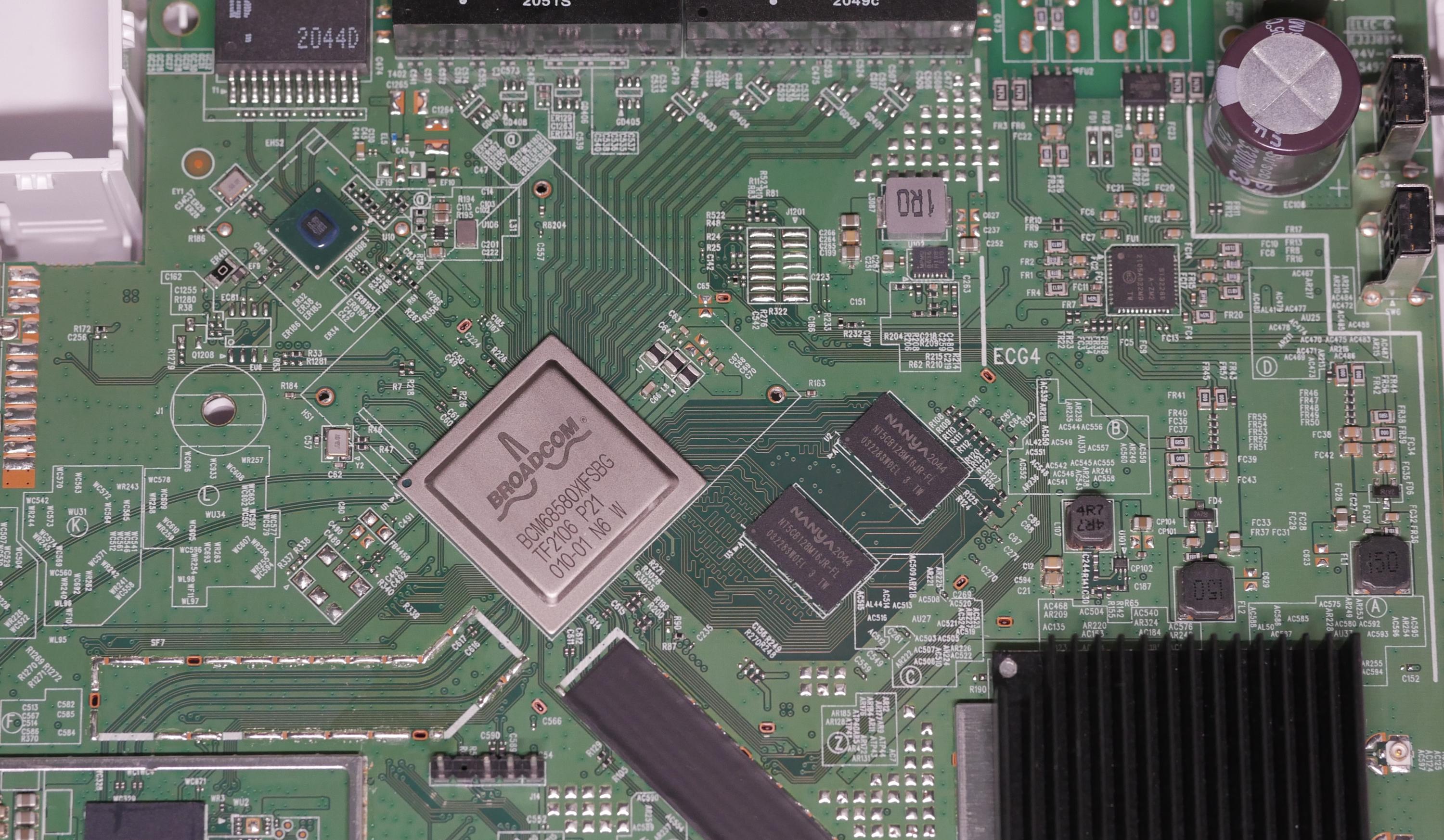

nand bad block with an RT809H, didn't boot

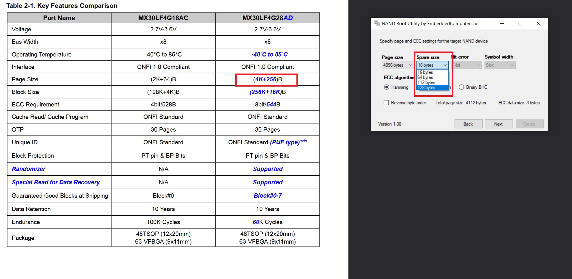

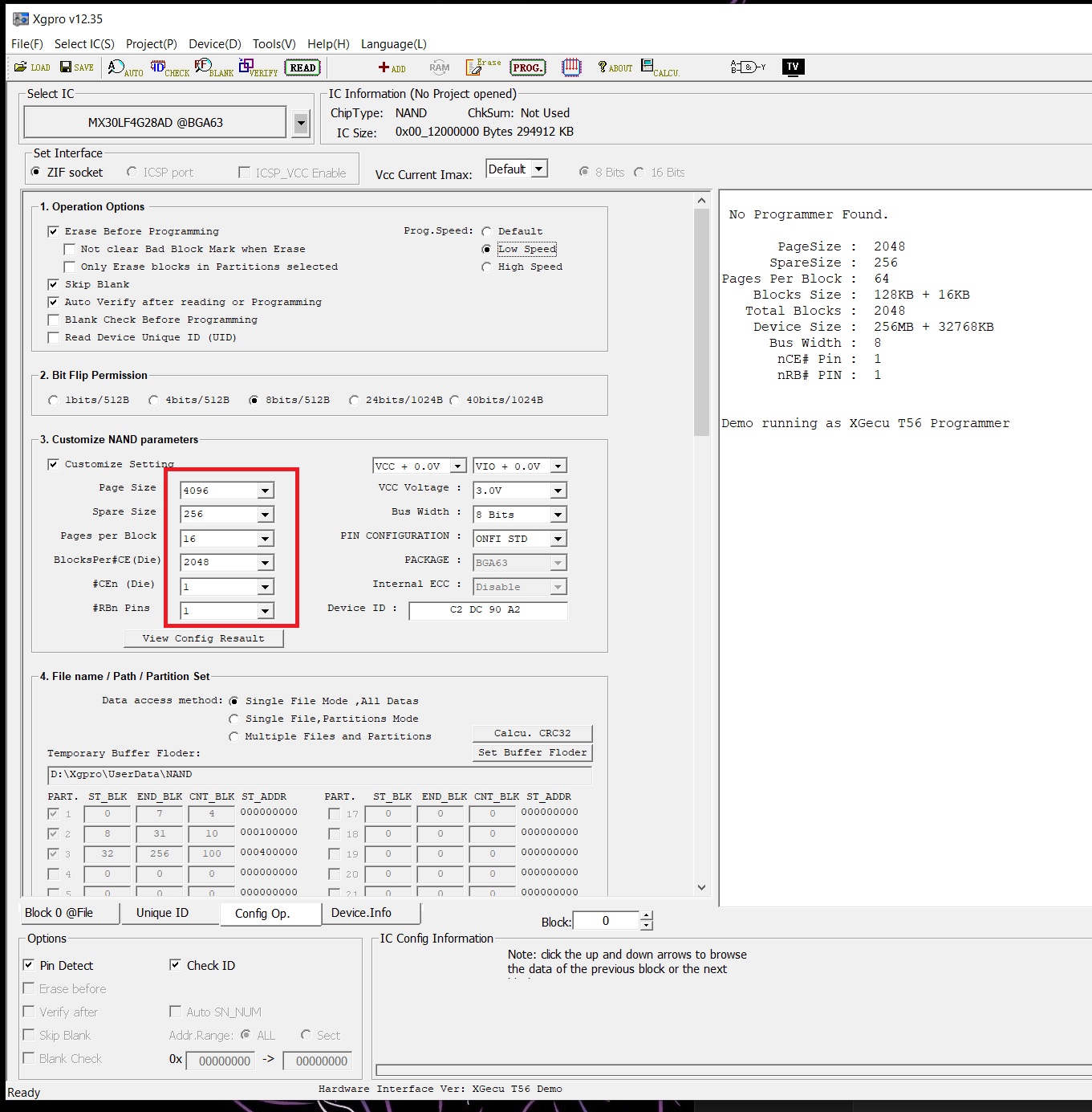

          Think that flashcat mach1 also can't handle it. Any other recommended programmer?
          Maybe you right Lotas, i found a custom parameters on Xgecu util.
          If take the Xgecu t48 model which cheaper, may use the adapters from the RT809H? or also for t56...

            Some adapters are not interchangeable. I’ve got the TL866 II and the RT809H. Some routers have an emergency / recovery mode. I’d play around with that. I remember years ago recovering bricked routers by uploading the firmware without an programmer, using UART and FTP instead. I never took the flash off the board ànd using a programmer as it is just too much work plus needing a dump.

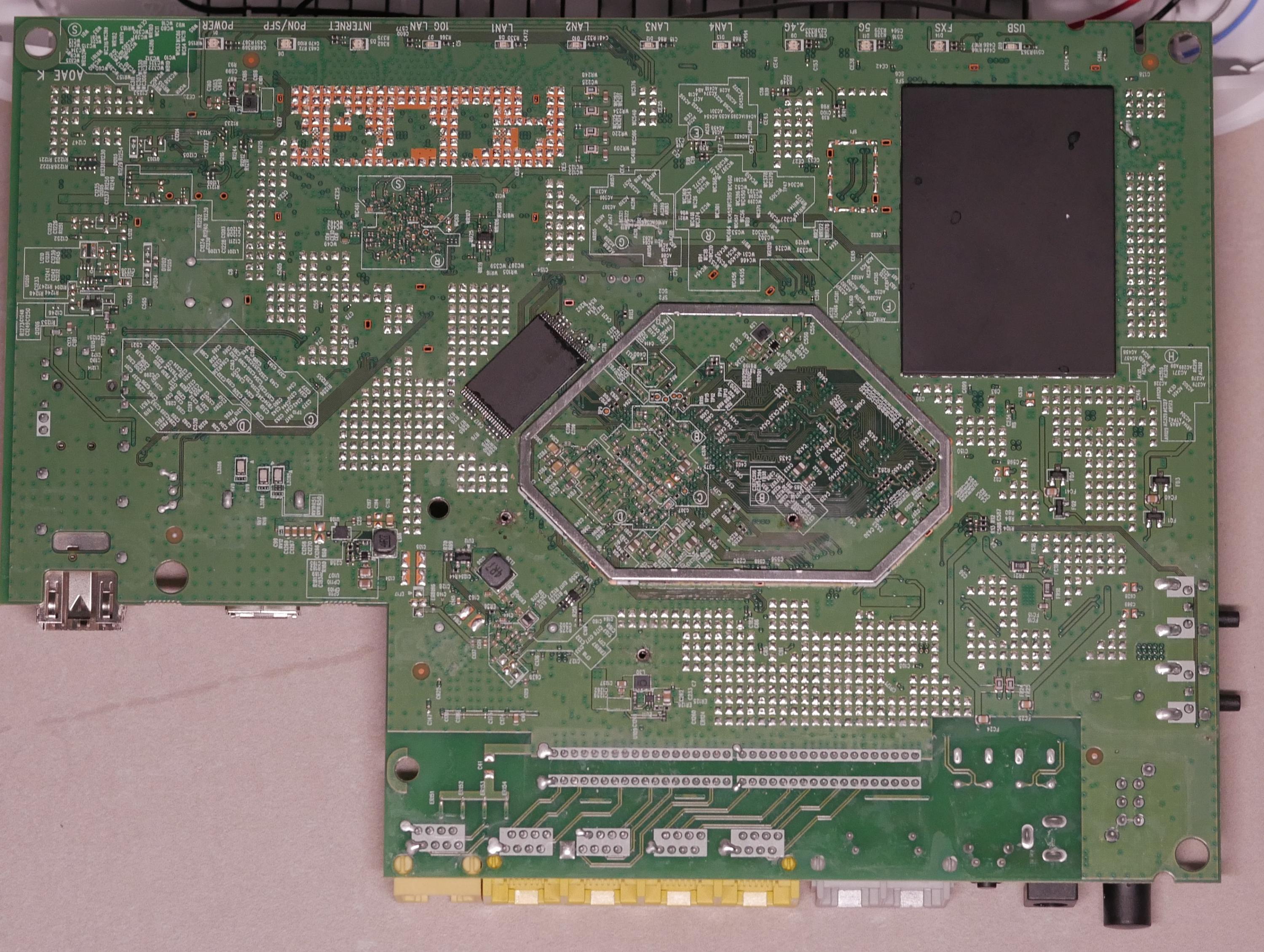

                Re: nand bad block with an RT809H, didn't boot
                Thank you CapLeaker! I already tried this method's before bricked the fw, saidly all service ports was filtered, while it was an ISP version of the router.
                Now won't boot up. Thinking to make a dump from a working one official Zyxel, but the chance are big that is S/N restricted. Maybe can do it someone who are good in reverse engeneering.

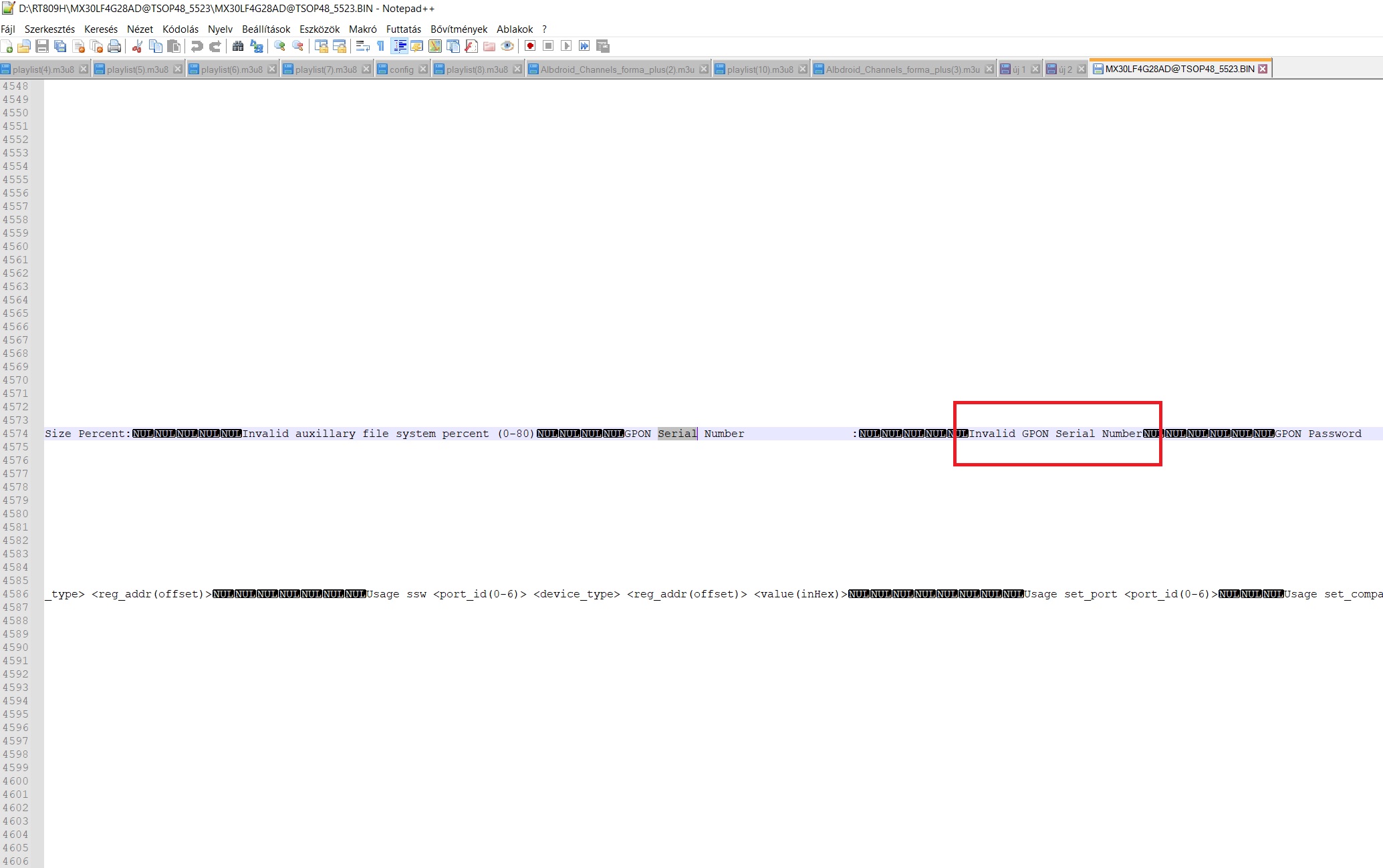

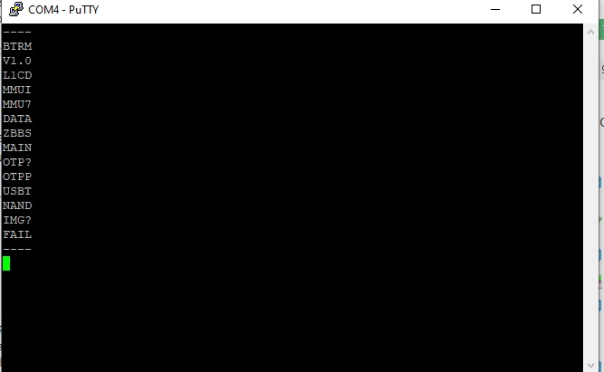

                    Checked all the avaible ports with NMAP before bricked. Every service ports, ssh, telnet, ftp was firewall filtered. The problem is now via uart clear nothing life signal. Bootloader dont stay up.
                    I found this row in HEX: pictures below, hex and uart log
                    but this is maybe only for stricted gpon connection. I ordered an xgecu t48, hope doing well with my tsop48 adapter and take another zyxel router to dump correctly the nand.

                      The T48 has its own adapter for Nand TSOP48.

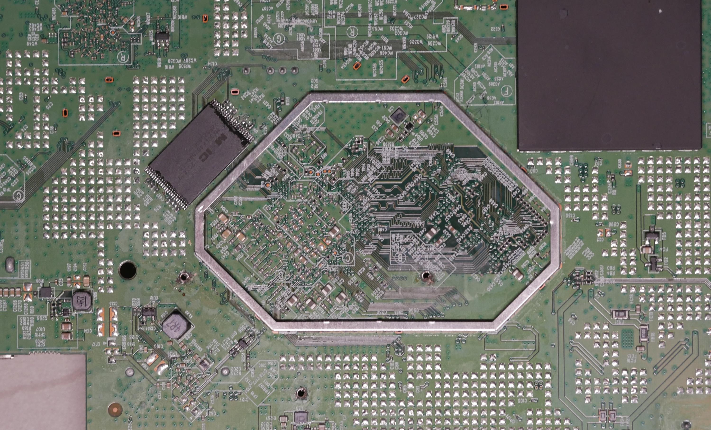

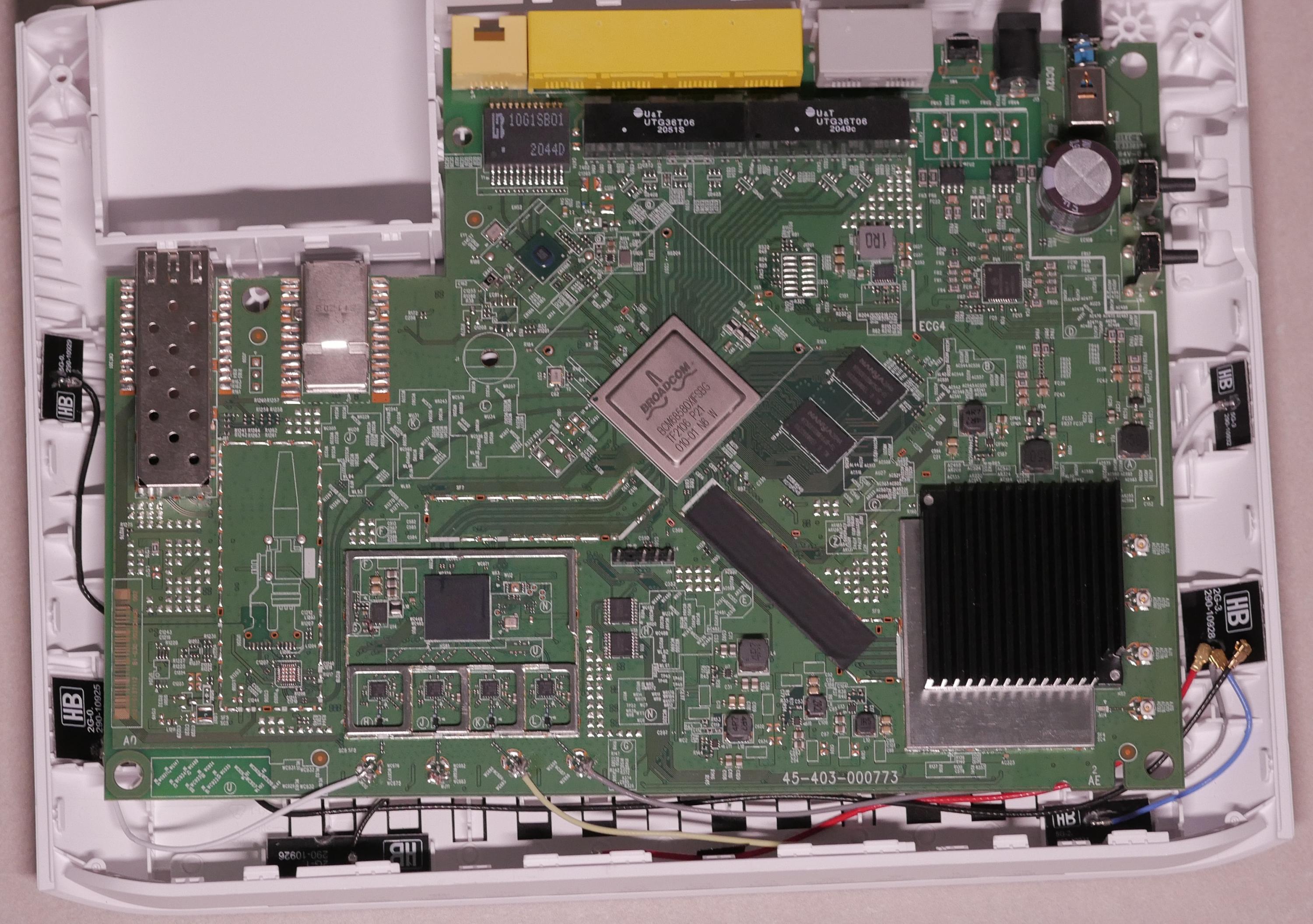

                            Some pictures atttached. Found this firmware too and I also see that uboot is missing to boot, but no idea how can be restrored. Specially from the original dump.

                              Everything is done through the TTL. I am not sure if the officially firmware (66MB one) contains a full flash or not. Can’t hurt to flash it like it is and see what happens. After all you don’t know what the ISP flash contained. There should be a few ways flashing this router, via TTL and some serial terminal program (probably slow) and via FTP.
                              At this state I don’t think the router knows anything much as it looks to boot from something. But as long as the TTL works the router can be saved with the correct file(s) loaded up to it.

                                Already tested the official fw, no luck. My theory is too, if got the boot, than the device saved. Because I can't reverse engeneer this broken fw and also can't build the u-boot from zero for this Broadcom 6858 cpu, still waiting for the Xgecu programmer, than take a similar router to dump correct the nand. Hope with some luck.

                                  There is a way to send uboot via serial terminal. Maybe try that.
