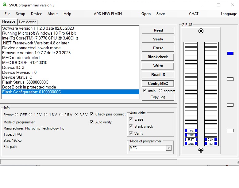

    MEC5050 Boot Block Disable needed
    hi
    please help to know how can i unlock Boot Block in MEC5050
    M.B LA-7731P
    THANKS

    Re: MEC5050 Boot Block Disable needed
    Originally posted by menshawy
    hi
    M.B LA-7731P
    THANKS
    When you active JTAG connection,you can shift registor R824 to R836 try this metho.
      thanks friend
      it's working
