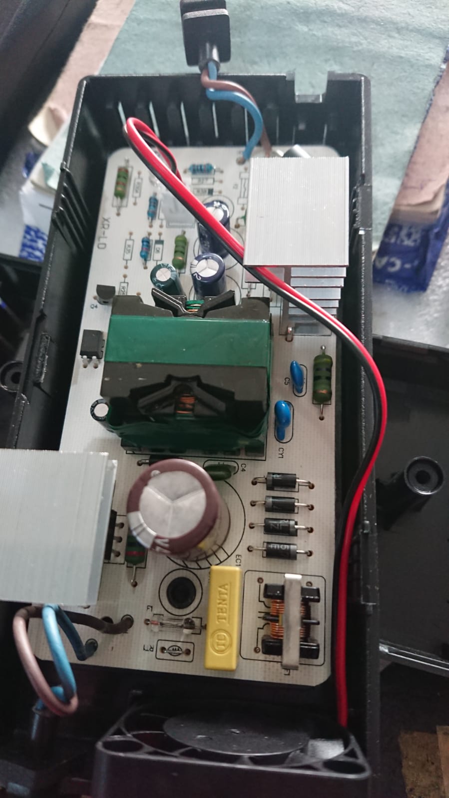

    I brought a made in china Li-Ion Charger
    7S - 29.4 V to charge my Ebike battery. unfortunately i accidentally chage the + and - and powered on the charger
    this got burned, i replaced it with a 0.1phm resistor. but now only voltage goes up. battery does not hold much charge.
    i could not find this on aliepxress or local stores
    any ideas?

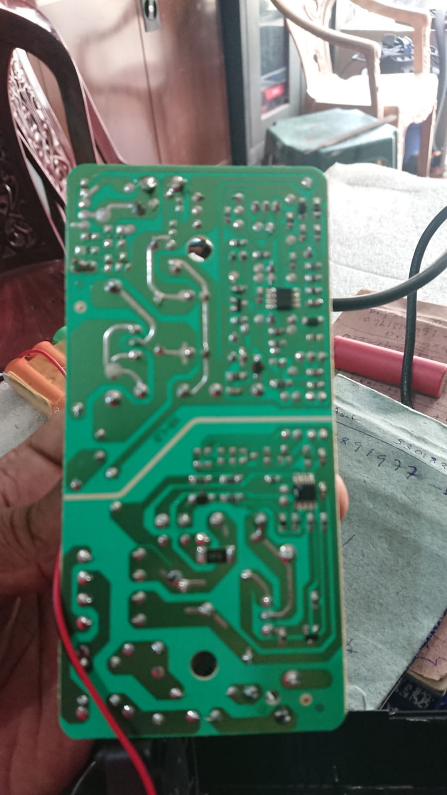

    Your pictures are too blurry, focus on the board, not the chair
    Where is the resistor located on the board? Some green mark you drew?

      looks like a resistor behind the heatsink.

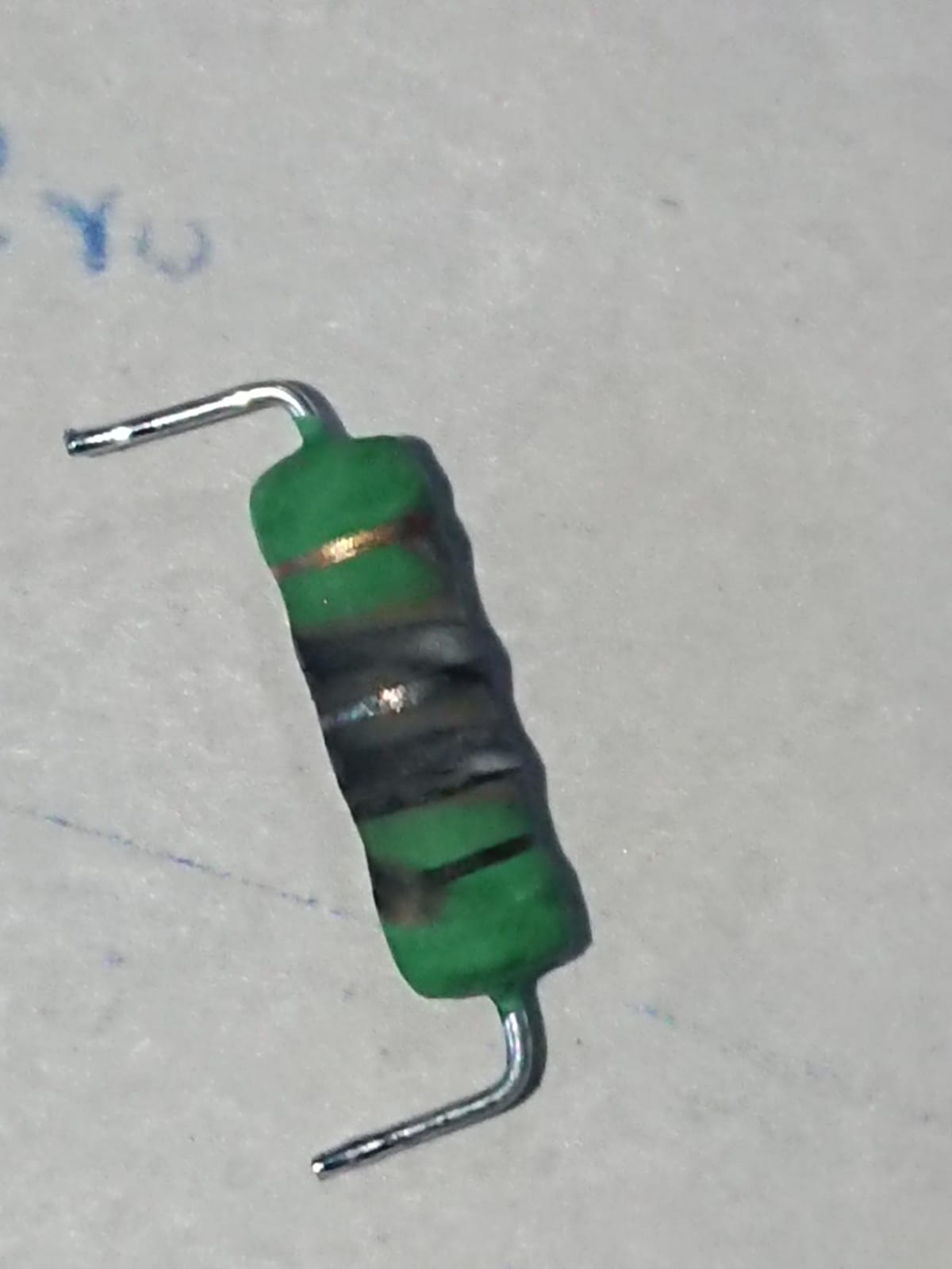

        If the resistor colors are:Black, Brown, Silver, Gold it would be 0.01Ξ© 5%
          I will post a good picture today.
            yes it is

            is BLACK BLACK SILVER GOLD i think, now resistor shows .8ohm resistance

              Originally posted by oxygensys
              Voltage goes up. and stay without dropping, it was made out old laptop cells, I ave to reassemble battery today, but it alll start after changer incident.
              That color code would be 0Ξ© 5% Short your meter leads together and subtract that reading from the resistor value, part of the resistance reading could be lead resistance.

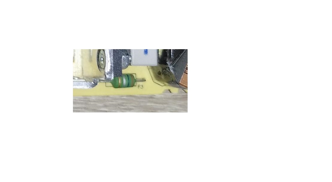

                    The resistor looks very similar to F3 on the ADP-240AR power supply which is a 0.16Ξ© 2 watt
