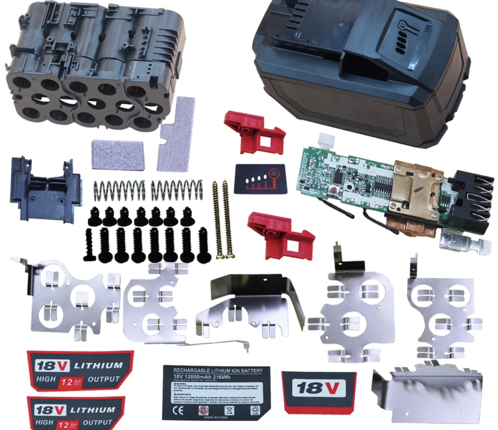

        I ordered from this seller “Shop3686085 Store”
        https://www.aliexpress.com/item/3256...xx__1662589135
        The items have been shipped now wait for about a month for it to get here so we will see how this works out with these new batteries that I just bought and been testing

            Here is a picture of what is supposed to come in this repair kit

            This picture is from the AliExpress website page with the picture cropped so it only shows what is in the repair kit

                  why does the board have a copper heatsink?

                    When I get the new ones I will carefully remove the heat sink and see what is under it I was wondering the same thing

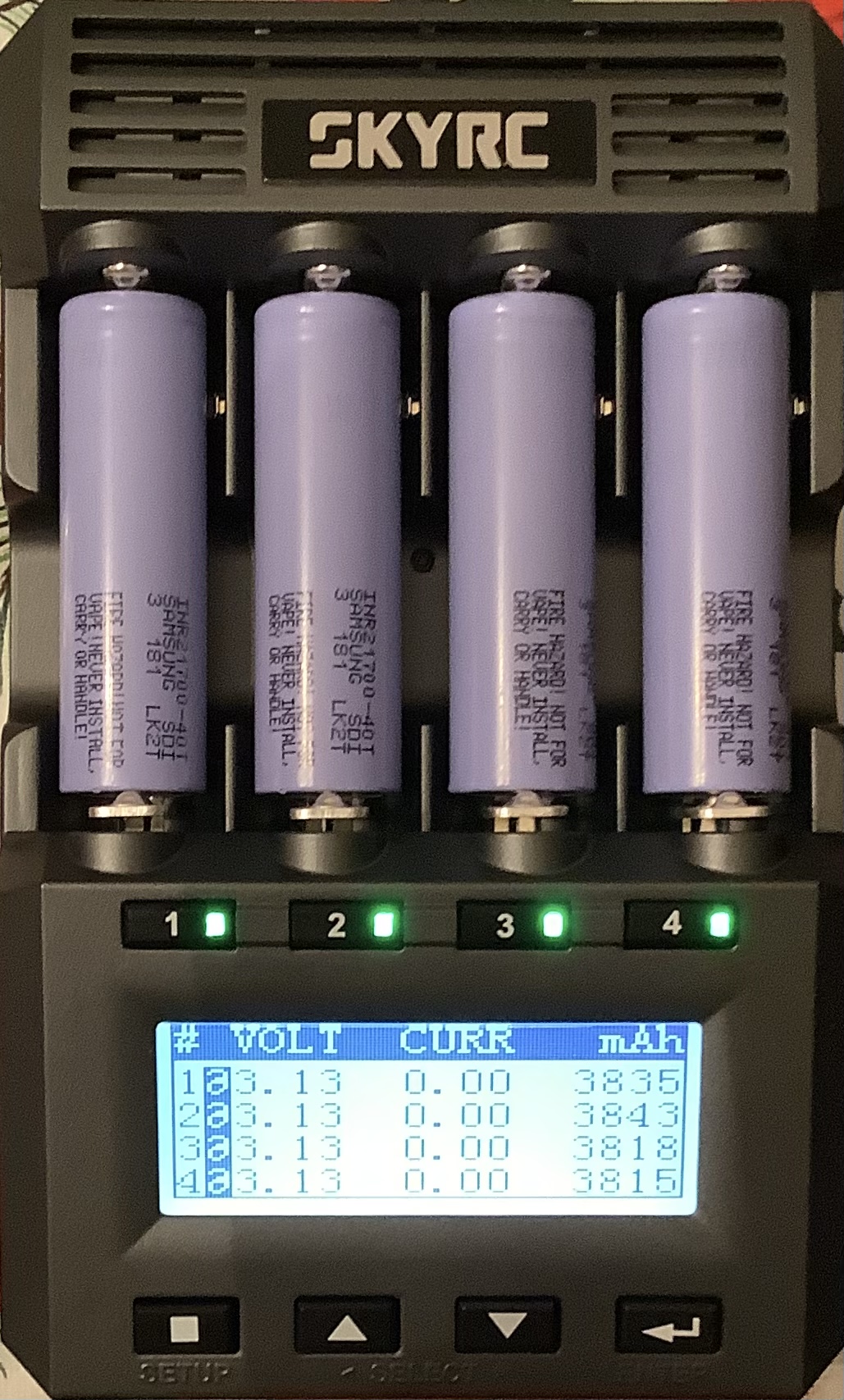

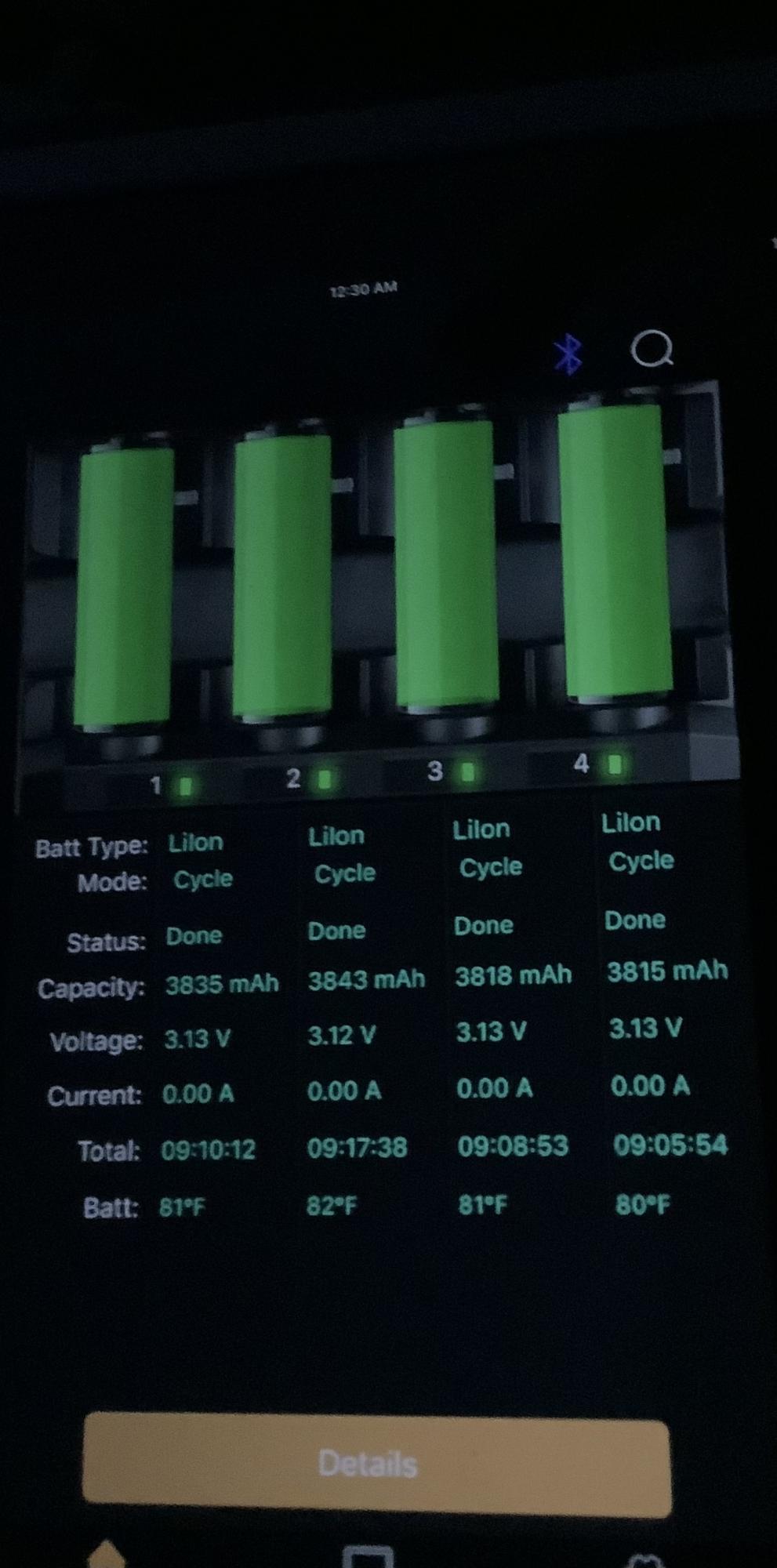

                      I posted the results on the new SkyRc battery tester that I had bought

                            There is an update on the taking used unbalanced battery cells 21700 power tool the amp hours are all over the place even if are they not showing signs of self discharging so you really have to test them several times when they have sat for a month or two and retest them again for the best results
                            I am going have to use the battery testing machine that has the best graphics that shows the results over time where you can move the results line and see the exact roll of voltage of each battery cell use the best ones for the best results out of the battery pack
                            I have not decided on what to do with the battery cells that have a higher self discharging issue meaning that the battery voltage goes down close to 3.0 volts or a little bit lower than that
                            I will have to see what kind of amp hours they have after sitting for a couple of months and see if it is worth the time and effort doing this type of project if they are half decent I might build a solar powered LED light fixture that uses these battery cells
