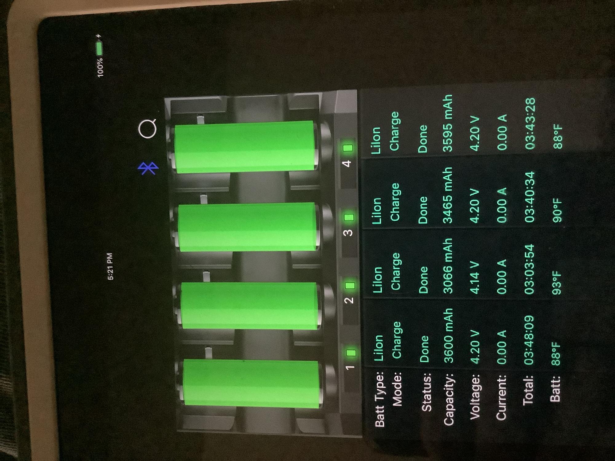

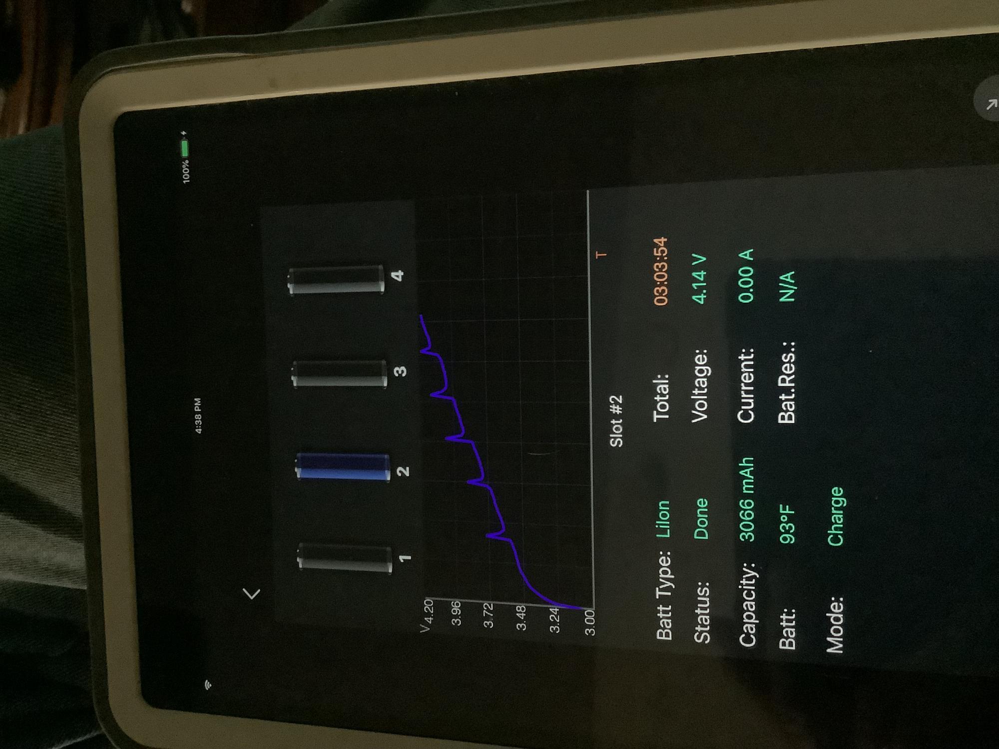

      Here is an example of a battery cell that has issues when the battery became unbalanced this charging curve looks like shit I would not use this for a power tool anymore the discharge curve drops really fast at the beginning when the load is turned on it should not look like that this is other reasons why I would not use it for a power tool anymore it will cause it to trip the BMS protection board earlier than normal
      The parameters are as follows
      4.2 cutoff voltage
      1 amp charging rate
      Temperature cutoff is set to 40*C

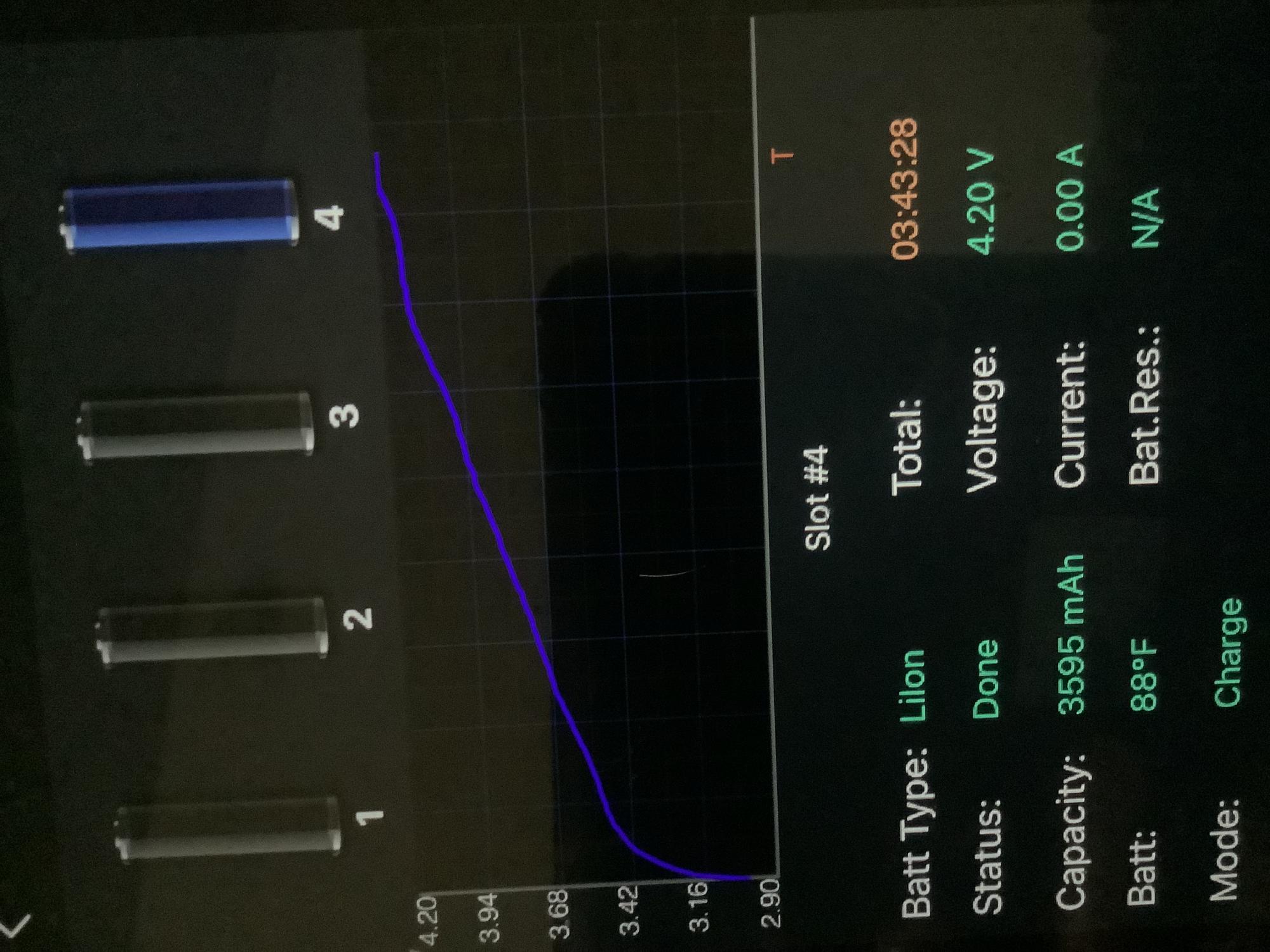

      It suppose to look more like the second picture but even this one does not look real great but it is still useable for lower amp hour battery cell usage what is wrong with the second curve is it is too steep when the charging cycle starts it should like a slight increase in voltage but not like you see it
      The reason I am using this battery testing machine is because I want to make sure that these battery cells do not have a temperature issue because I am not babysitting these batteries while they are on charge
      But now that I have cycle them a few times I will now use the other battery testing machine for a more accurate view of graphics curve chart to determine which of these battery cells I can reuse for a power tool battery pack
      (If any of them are still good enough for this purpose or not ) where I work they have a couple of Milwaukee battery packs that are 6 amp hour that the battery charger can not charge correctly anymore and I am sure it is that they are very unbalanced as well
      The second battery cell is the first graph curve the second picture shows the curve graph is the fourth battery cell

        Hmm… yeah I can see the grinder chewing up some power specifically if you lay on it. Damn that radio should last forever on a 12 Ah battery with a 30min per day usage. A fiend of mine has the same 12AH battery using it for his weed eater and blower. It lasts a very long time. However up here it isn’t that hot like it is down there.
        Now looking at your cells on the last pic, #2 and #3 definitely have a problem with internal resistance. So yes, these are screwed.
        Many years ago I was active on a different forum that was about resurrecting / rejuvenating batteries. I’ve did so many times with lead acid and NIMH. I had no interest on NICD, and the LI-ION were still newish. The idea was to pulse the battery with spikes. So we build all kinds of chargers to get these old cells going again. Some successful some not. It depended on far the battery was gone and what chemistry it was. Since I didn’t have a bad LI-ION at the time I never tried to build or modify for these. After that we had a few health emergencies and I never got back to it and I am still playing catch-up many years later.
        One guy used something like a mixture between “Bendini” and re-emf with promising results. I’ve made all kinds of different desulfators and chargers for lead acid batteries and I still use them. So far I had good luck with LI-ION and all I really try is to keep the temperature of the battery down if I can. Since then I never got back into it building a new charger.
        With your fancy charger you can identify bad cells easy and Frankenstein something together, by replacing the bad cells somehow. Nice rig!
