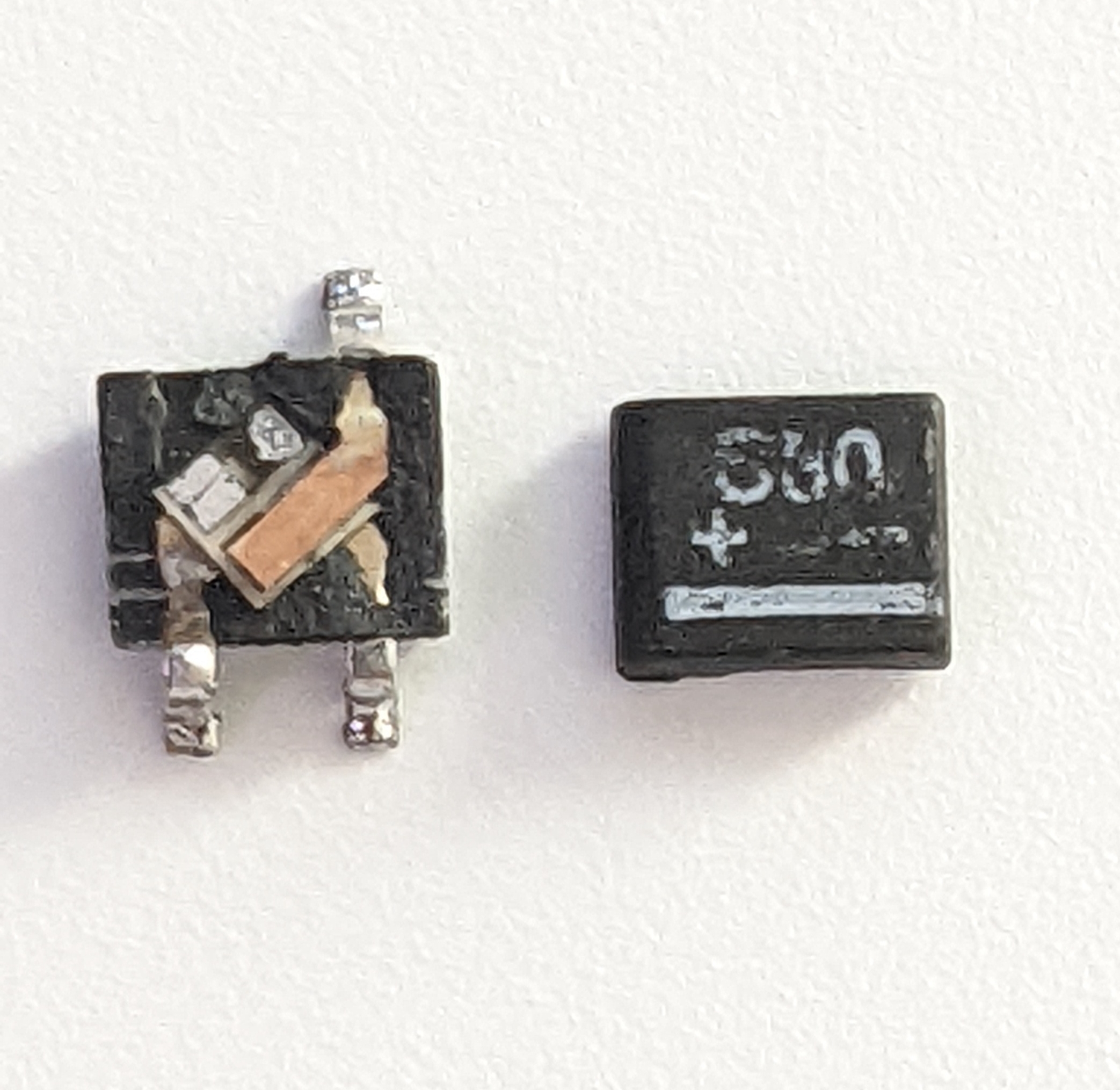

    Hi guys,
    I would be very grateful if someone can help identify the component in this picture.

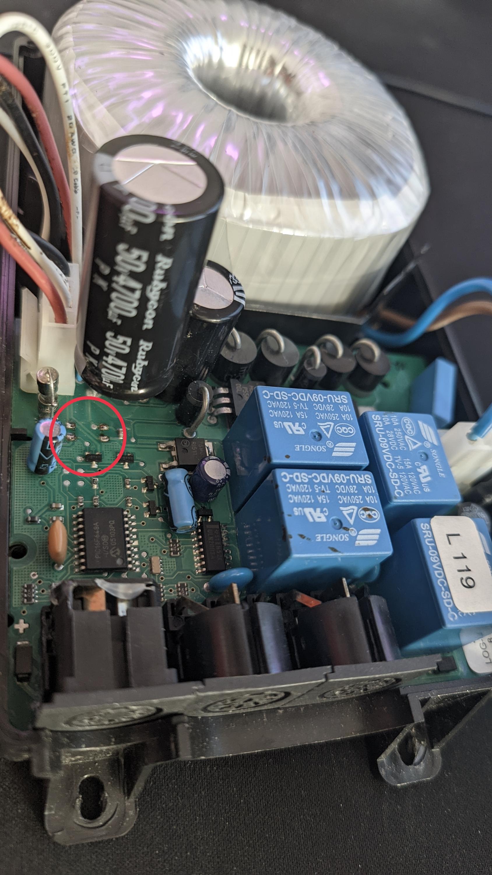

    it has 4 pins one of pins gone off while removing it from the PCB, the PCB is a Motor controller for adjustable Desk.

    looks like its a rectifier

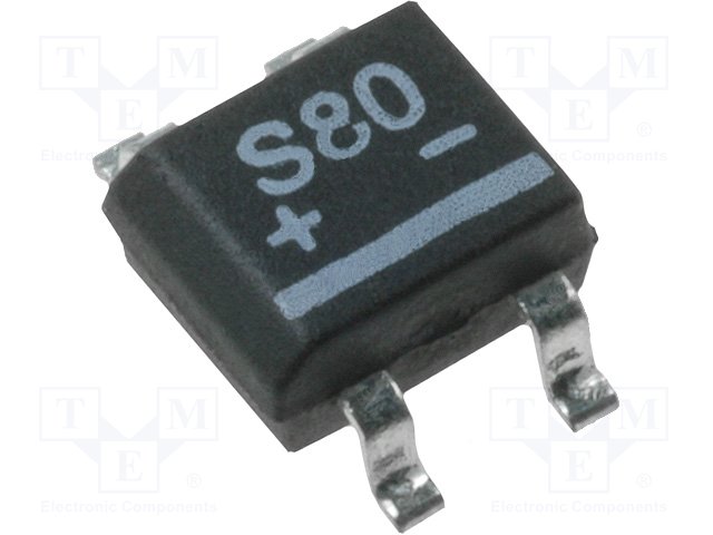

      Re: Identifying a Component
      SMD bridge rectifier, looks like diotec S80
        My guess is a DB-S SMT bridge rectifier, like a DB103S is 200PIV. It's about 8x6.2mm. The S80 is smaller 4.7x3.9mm. You'd have to measure the part size.
          Thanks for the help guys, it does look like S80 SMD bridge which I did order some from mouser.com
