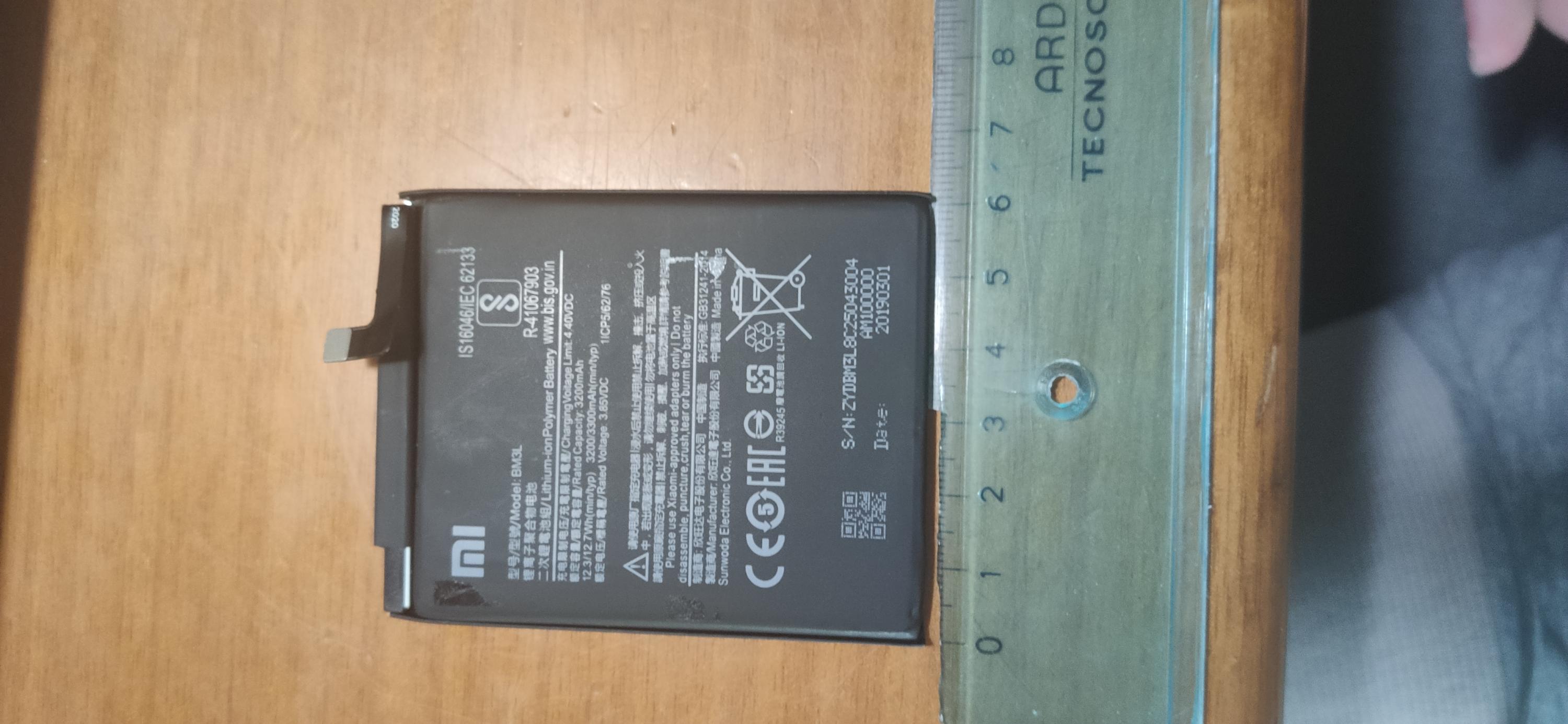

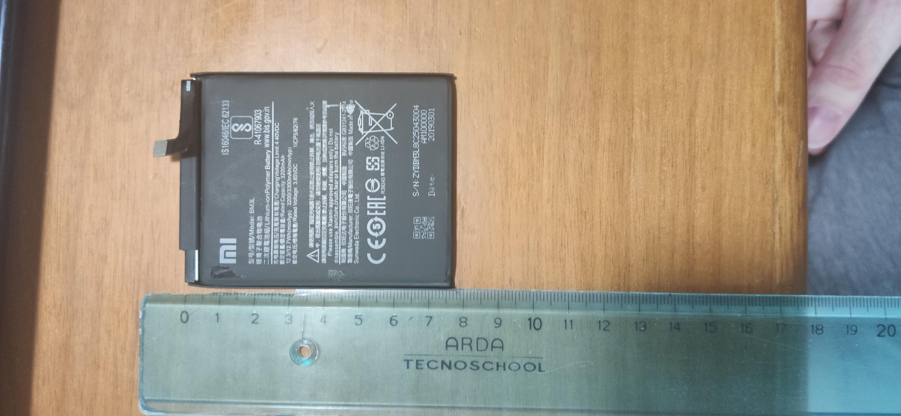

                              The phone is a Xiaomi mi 9. the battery is a BM3L. Here the pics. The BMS circuit you are talking about is the one under the tapo on the top of the battery?
                              Thikness 4,1mm

                                This does not change what I had said earlier about the connector and the BMS protection board issues
                                Yes it is under the tape and you need to be very careful removing it because it can be easily torn off of the battery cell depending on how the battery is made or you will tear the plastic circuit board and it would be very hard to repair if it can be repaired
                                Start on the back end of the battery first then work your way up to the front end of the battery where the connector is just take your time doing it and do not be in a hurry for best results
