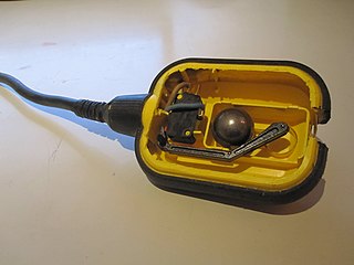

    That float has a ball inside to give some hysteresis I believe.

      So, there are different types of float switches. One can use a limit switch as a float switch. If you think about the float in a toilet bowl. The float goes down until it gets low enough for the value to turn on and then continues to operate until the float turns off the valve. Instead of a valve one can use a limit switch. So, the float would go down to a point that the limit switch opens. The limit switch would be on an arm to the float. The upward pressure of the float would have to overcome the arms force to close the limit switch. This then has a predictable on and off measurement and would not be subject to unstable condition of the water.

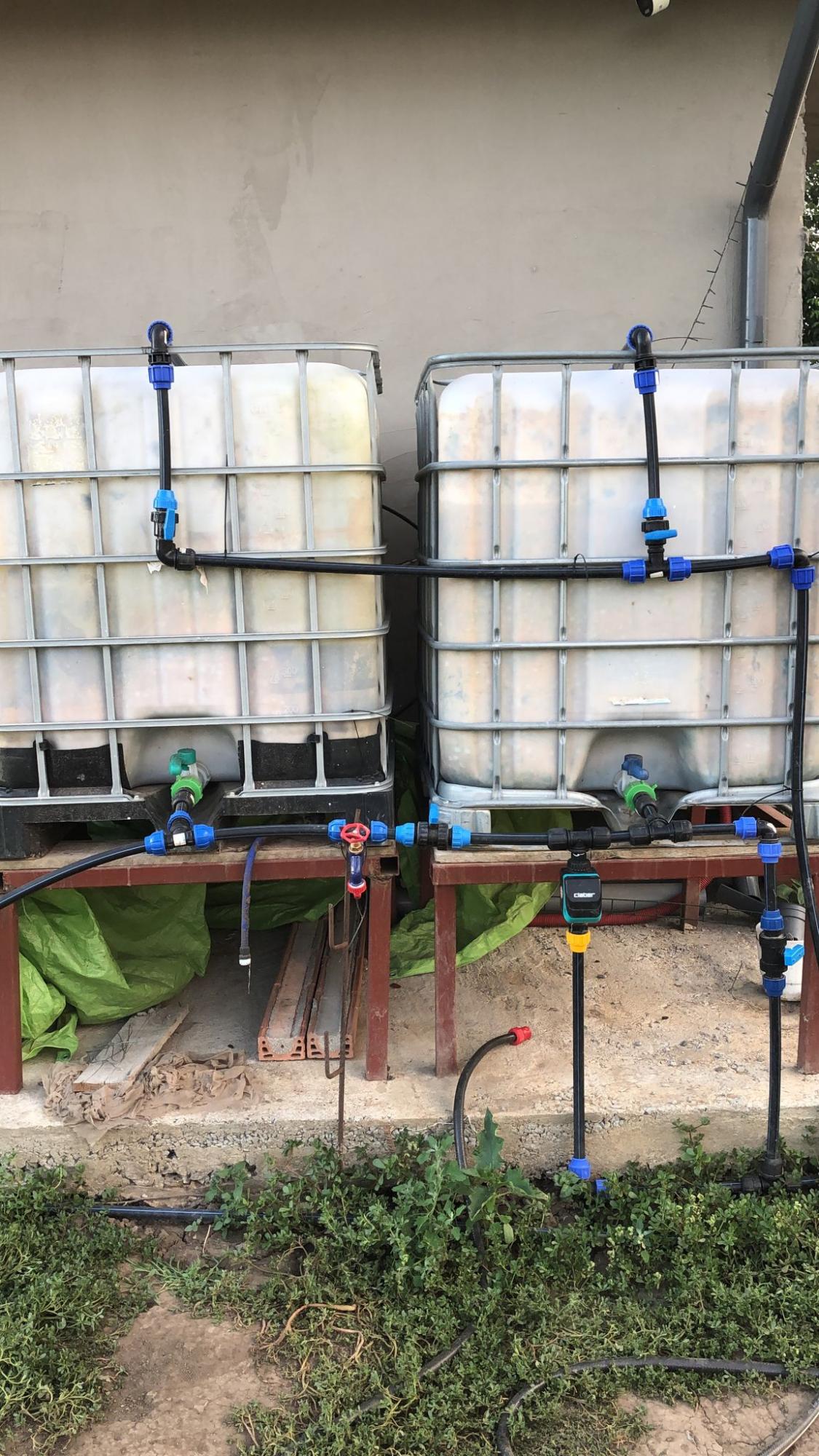

          From OP's pic, it's a submersible pump in the well, with solenoids to divert flow to either of the two tanks. Usually there is a backflow valve to prevent siphoning/water running back down into the well.
          One hassle is the tank filling can make a lot of turbulence, sloshing waves etc that make the float sensor malfunction.

            No, I don't think so: even though I haven't actually seen the setup myself, the guy told me the water inlet sits above the tank, so it's never submerged.
            Correct. Said check valve may have already been installed by the guy.

                In this case, we're not going DIY though, since the guy already bought (and possibly installed) the float switches I showed.
                One possible issue I see with your idea is that it only works for small-ish tanks. If the tank is very deep, at least some part of the mechanism would have to be impractically long to reach the top (since you can't install a microswitch at the bottom of the tank underwater)

                  About what size are the tanks? As I mentioned, as long as the incoming water cannot pour down and hit the float sensors, or if there is not a lot of swirl and turbulence, they can work.
                  They are designed for sump pump applications, which do not have this problem. I hope this guy does not keep buying the wrong stuff.

                    THIS big. A common sight around here. I think they're 100L each. The valves shall go where those manual valves are, either before or after them. You can see how the fill pipes run to the top.
                    Did you go with a smaller relay for the latching aspect?
                    No, because I can't. Like I said: I'd need some way to UN-latch it and he only got 2 floats. I'd need 4 to do this, the way I picture it at least....

                        is it not possible to add a balancing pipe between the tanks ? then it should only need 1 pump and float .
                          That's how I would've done it from the very start, TBH: connect the two together at the bottom. Come to think of it, now that I look at it better, I think the same effect could be achieved by simply opening the bottom valves at the same time with no additional modifications....

                            so sealed, but hopefully vented tanks and they are outdoors and exposed.
                            that adds to the problems

                                I looked at the logic for the pump and fill valves and it's a bit weird.
                                It's like each tank has an empty/fill cycle, once empty the pump runs until it fills up.
                                But if you're filling one tank, and the other is 1/2 full, why not top it up too? Why not fill both until the FULL float switches trip on both tanks?
                                I still think you need a latch somewhere to stop the logic flipping out with noisy float switches. It's standard in PLC motor controls to use a latch function.
                                If both tanks were connected to make one tank, it would simplify things a lot.

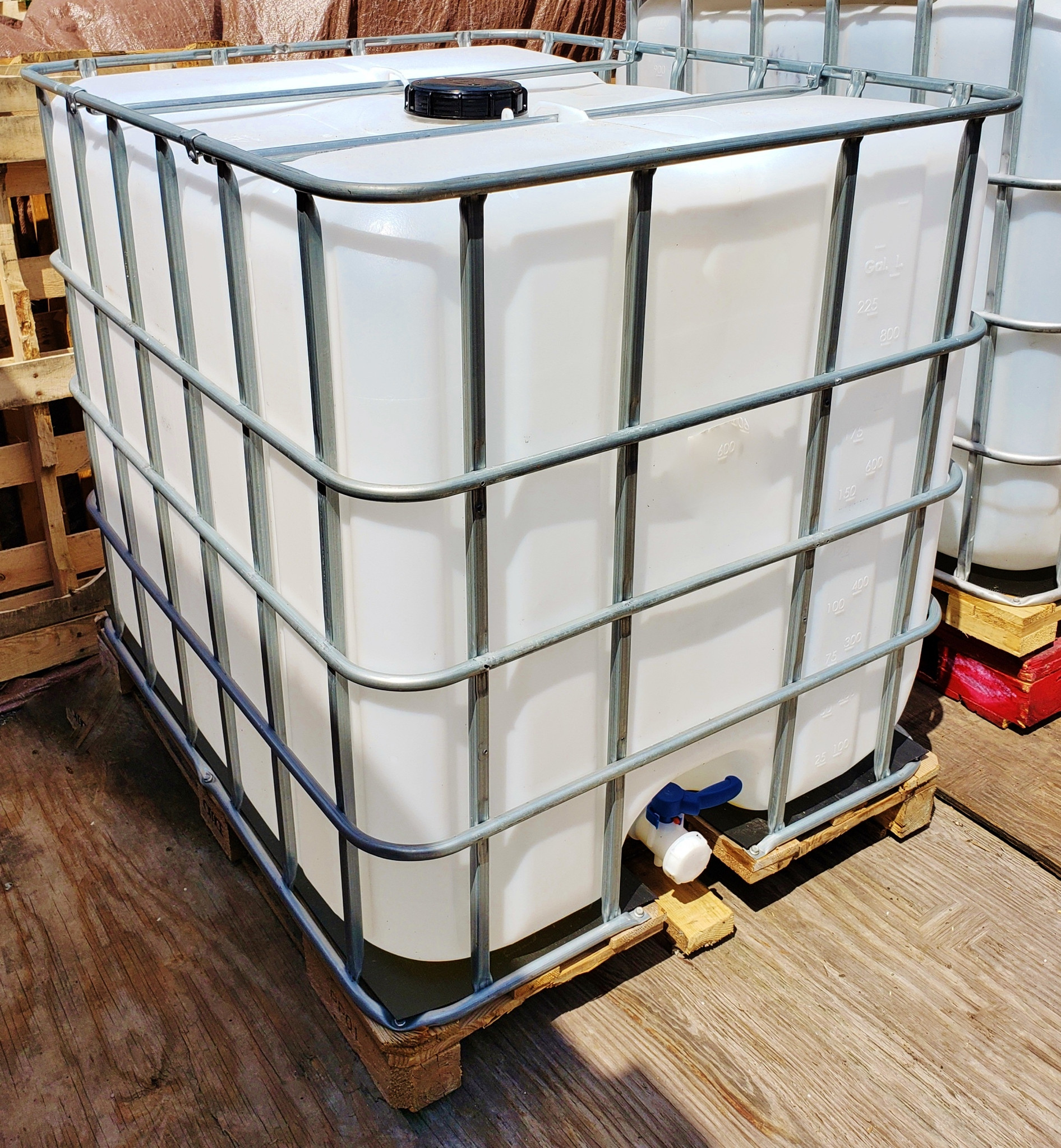

                                          Those water tanks at 1,000L/275gal are large weight up to 1,060kg/2,332lbs.
                                          But they have a small 6" fill cap lid which makes putting sensor and fill pipe inside a hassle.
                                          .. uh make sure the stand is good for a ton, the legs might sink into the ground and the tank fall over.
                                          I noticed the two tanks are connected together at their outlet, but a closed valve is between them for some reason. It would be simpler with them connected together.
                                          Did you finish the plan for the pump logic? An ESP8266 is really good and what I'd use for something small and low cost like this, with a webpage. Before, I thought you were doing something industrial in a plant where the tanks and pumps are much bigger and a PLC is standard use.
